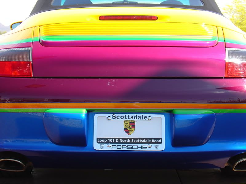

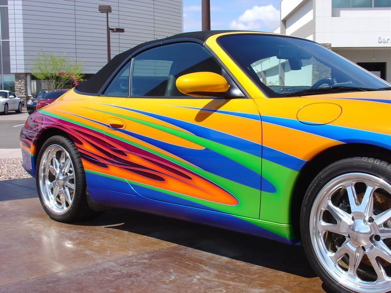

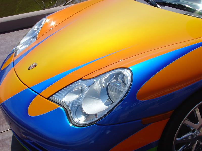

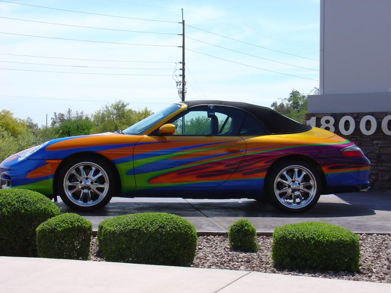

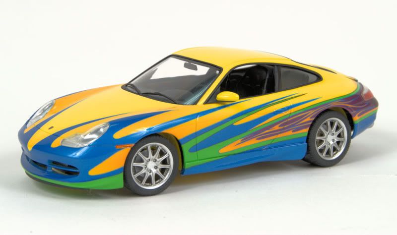

Driving by the Penske Porsche dealership in Scottsdale, Arizona, I saw what surely must make Porsche purists roll over in their grave! I immediately thought TamiyaCon and GSL!
Speculation among TamiyaCon participants was Mr. Tamiya does not like his styrene cut up; thus, no convertible replica as Tamiya does not produce a GT3 convertible.

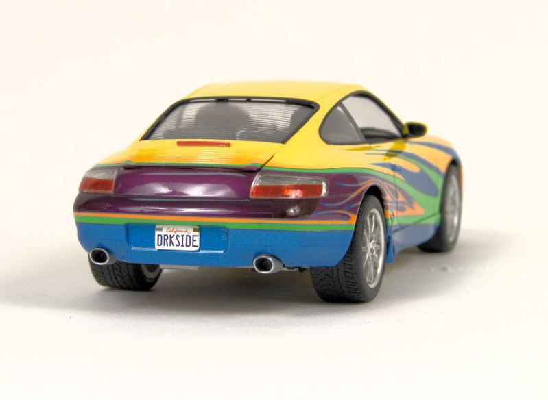

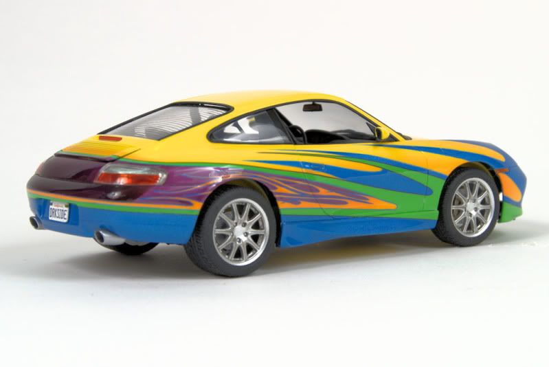

All flames were mask with Tamiya tape except the small purple flames. The fabric within the Tamiya tape prevented clean cuts with very small radii. Scale-Master cut the vinyl masks used to shoot the purple flames.
All colors were intended to be Tamiya. I held to this standard until the pin stripes were added. Tamiya TS aerosols resist all decal solvents known to this man, so Testors enamels were used for the pin stripes. All the pin stripes were cut from painted decal film with two single edge razor blades. Yes all the flames have pin stripes.
Clear coat is three-part PPG series 800
