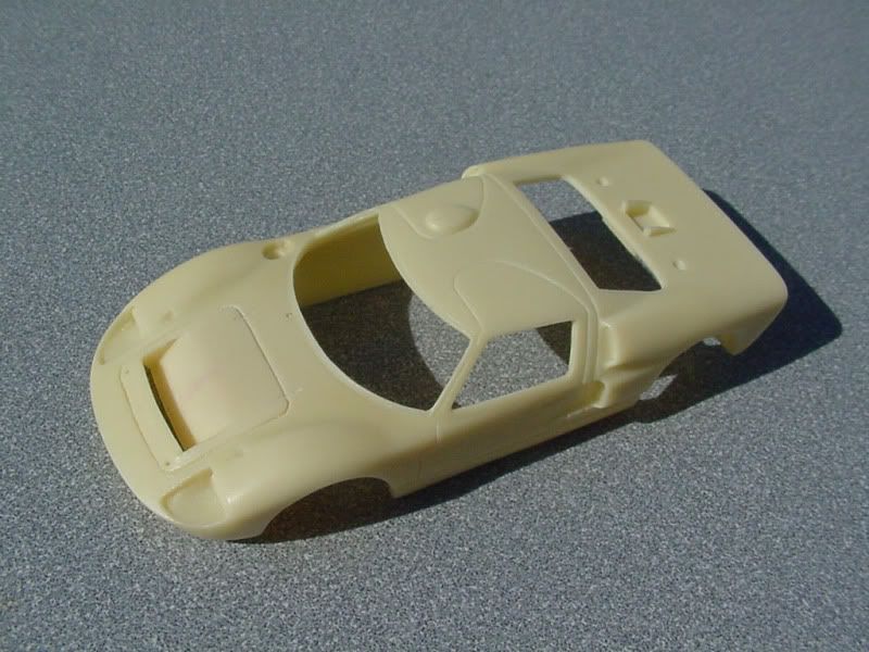

Scale-Master Posted September 1, 2011 Posted September 1, 2011 This will be the gold Holman-Moody car with the pink flash. Body is resin; the locating groove for the splitter in the hood vent needs to be filled for this version, (the kit builds one of two versions), and the lower rocker panels also needed some filler. Otherwise it is a relatively nice and thin casting.

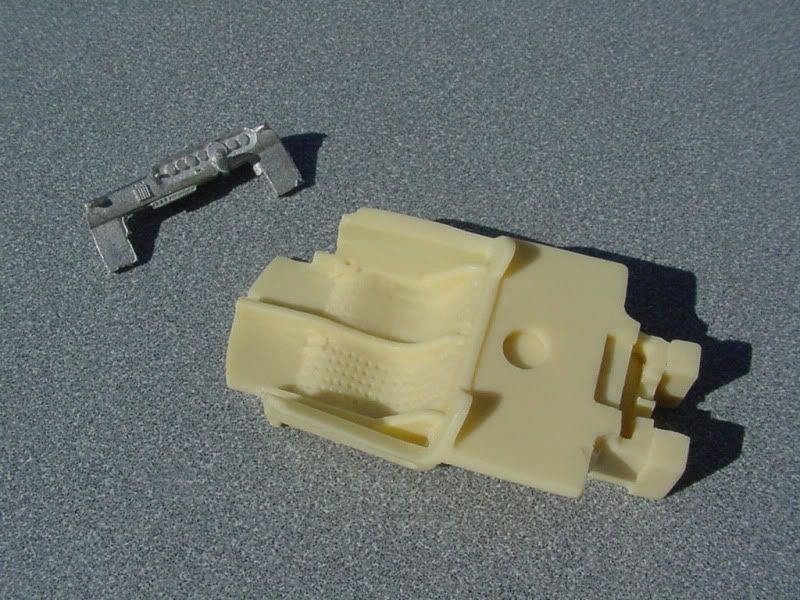

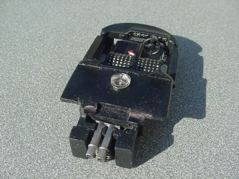

Scale-Master Posted September 1, 2011 Author Posted September 1, 2011 The interior is resin with a white metal dash. The seats look a little uneven, but they supply decals that hopefully will address that.

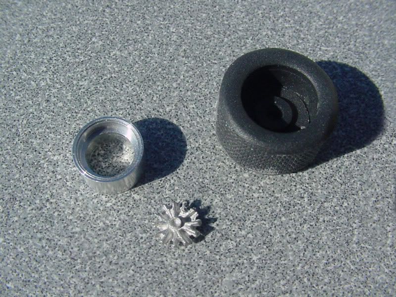

Scale-Master Posted September 2, 2011 Author Posted September 2, 2011 The tires are resin, the outer rims are machined aluminum, and the centers are cast white metal.

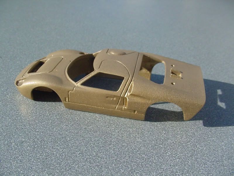

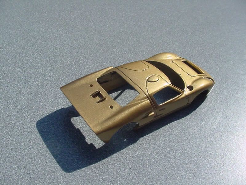

Scale-Master Posted September 3, 2011 Author Posted September 3, 2011 After the body was cleaned up and lightly primed, I shot a tan base coat then built up the gold in very light coats using Tamiya paints. The first couple of passes were done from the can, but the more than half of the paint was applied by airbrush, the finish and metallic came out finer that way. Once the base coats were built up I could see I would not be happy with the flake and texture. I color sanded the body with 1000 grit wet. (It smelled like sanding aluminum metal, must be a lot of actual metal in TS-21.) A few more rounds of airbrushing the gold and color sanding filled in the texture and very light coats proved to be the key to achieving a uniform and smooth finish.

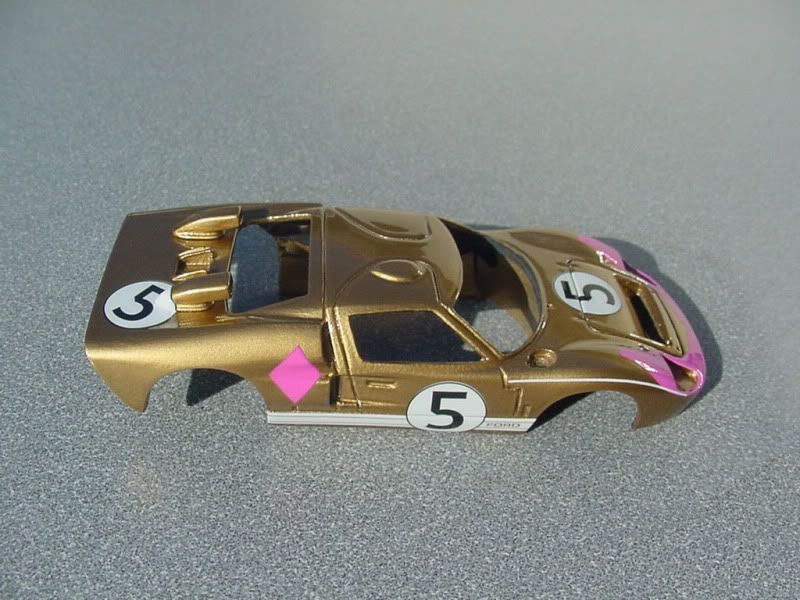

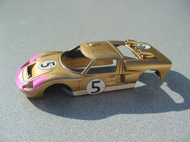

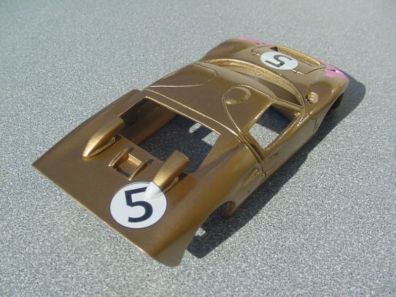

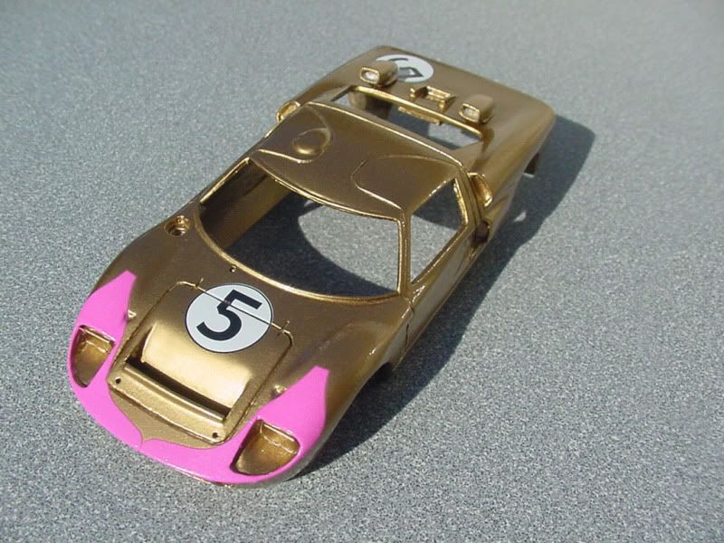

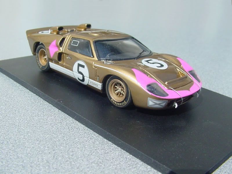

Scale-Master Posted September 4, 2011 Author Posted September 4, 2011 (edited) Here I have started applying the decals. You can see the gold looks smoother and less grainy now. The roundel for the rear that goes over the rear edge of the scoop was not made to fit over the scoop. So I hand painted the white and the fine black pinstripe outline by hand. (Too bad my “registration” is better than the kit’s decals, that issue didn’t jump out as much to me before…) Edited September 4, 2011 by Scale-Master

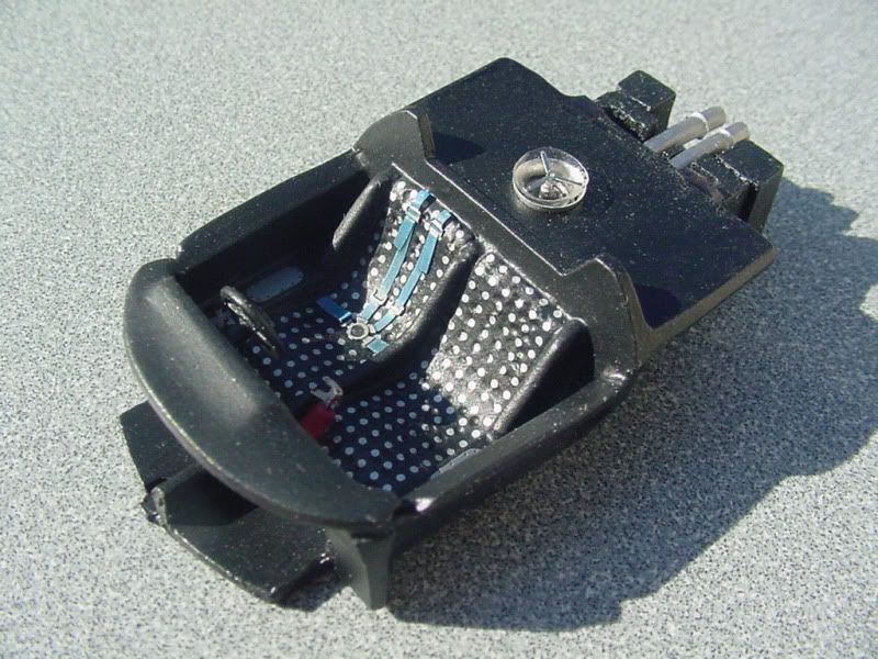

Scale-Master Posted September 6, 2011 Author Posted September 6, 2011 The interior did benefit from the seat decals. If I do another one of these I’ll fill in the molded seat dimples. At least through the windows and inside the body it looks good. The kit even provides a fiddly little vac-u-form piece for the intake as well as two white metal parts and one PE.

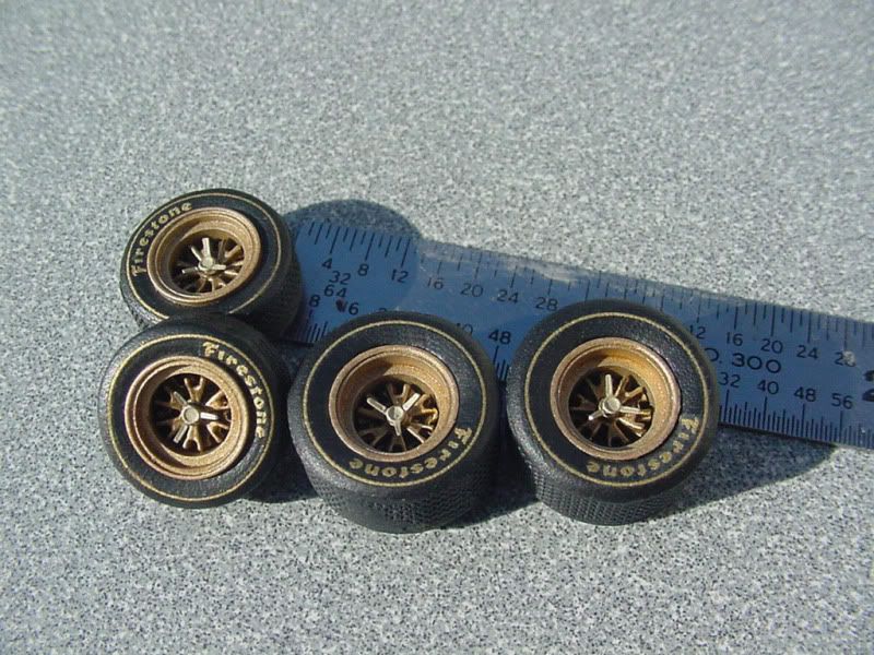

Scale-Master Posted September 6, 2011 Author Posted September 6, 2011 Not exactly the best rendered wheels, but then it is an older kit. Did what I could with them… Kit was missing the tire decals, but the Ferrari 330 had an extra set, but a tad small in diameter for these tires, so I cut the pinstripe and hand painted the gaps back in after they were applied.
Scale-Master Posted September 7, 2011 Author Posted September 7, 2011 The decals are on and the clear has been applied, time to let it dry for a while…
Crazy Ed Posted September 8, 2011 Posted September 8, 2011 Not exactly the best rendered wheels, but then it is an older kit. Did what I could with them… Kit was missing the tire decals, but the Ferrari 330 had an extra set, but a tad small in diameter for these tires, so I cut the pinstripe and hand painted the gaps back in after they were applied. WOW, what Great detailing! But I've finally figured out how you can do such amazing TINY detailed work!!! You've got 20X Eyes, Your Heart has been replaced with a constant flow pump and your Nerves have all been removed. Yep I'm on to you now!!!!
hossalimi Posted September 9, 2011 Posted September 9, 2011 Very nice work Mark, specially the stripes on the tires.
Scale-Master Posted September 10, 2011 Author Posted September 10, 2011 Thanks for the kind words guys. It is getting close to being finished... Those little details are proving to be time consuming.
