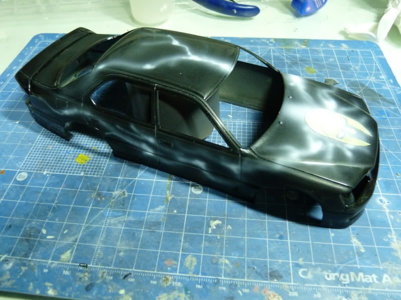

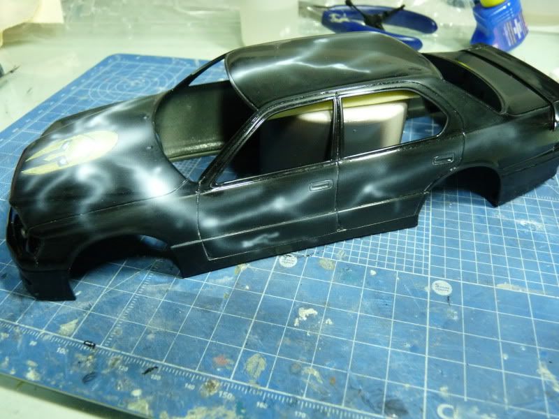

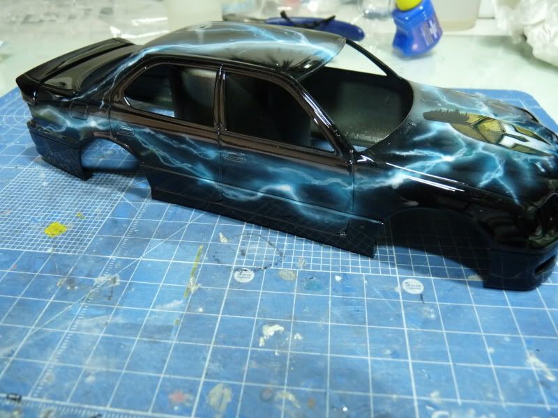

flyonthewall Posted November 24, 2011 Author Posted November 24, 2011 (edited) Masking over the helmet with the cut out set aside from the previous process I laid down the base or glow for the electricity. Lightly airbrushed streaks of white were laid down giving the appearance of emanating from behind the helmet. A heavier build up of colour was placed in areas to form 'hot spots' and glowing eyes. Edited November 24, 2011 by flyonthewall

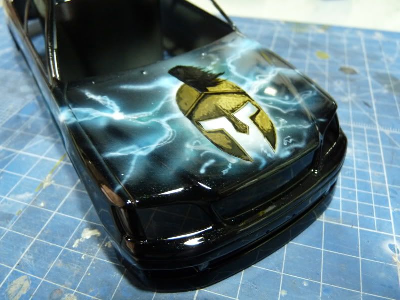

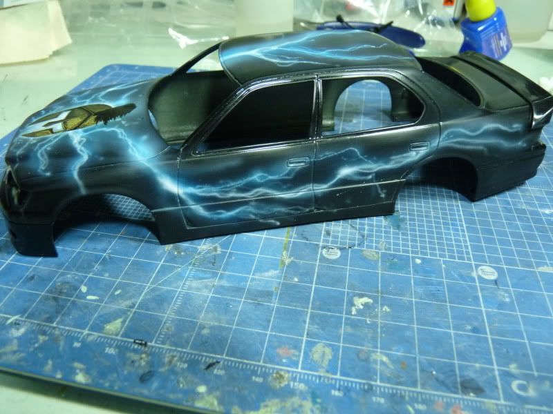

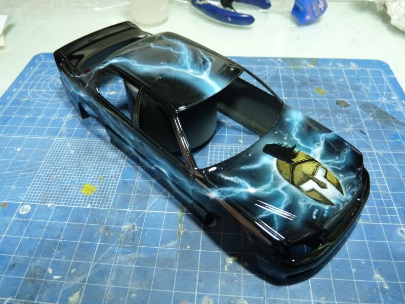

flyonthewall Posted November 24, 2011 Author Posted November 24, 2011 A light coat of Vajelo clear blue is dusted on to give bluish hue to the glow. A small touch of other clear colours was added around the helmet. Fine lines of white added for the streaks of electricity following the path of the glow.

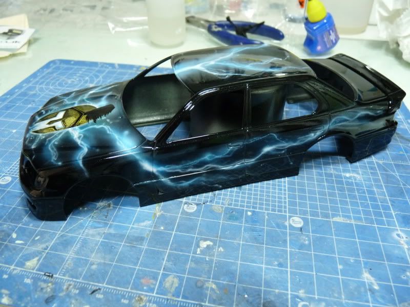

flyonthewall Posted November 24, 2011 Author Posted November 24, 2011 All comes together with the clear coat. I used 2K automotive lacquer

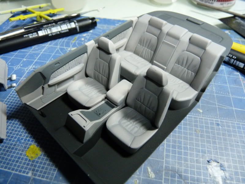

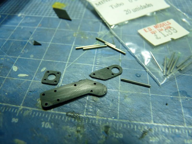

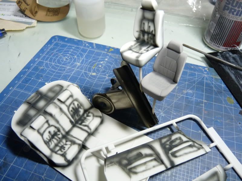

flyonthewall Posted November 24, 2011 Author Posted November 24, 2011 (edited) Preshaded the interior a la aircraft modeler style Scratchbuilt a typical Jap tuner drinks tray/phone holder type thing from plastic card and small metal tubes. Edited November 24, 2011 by flyonthewall

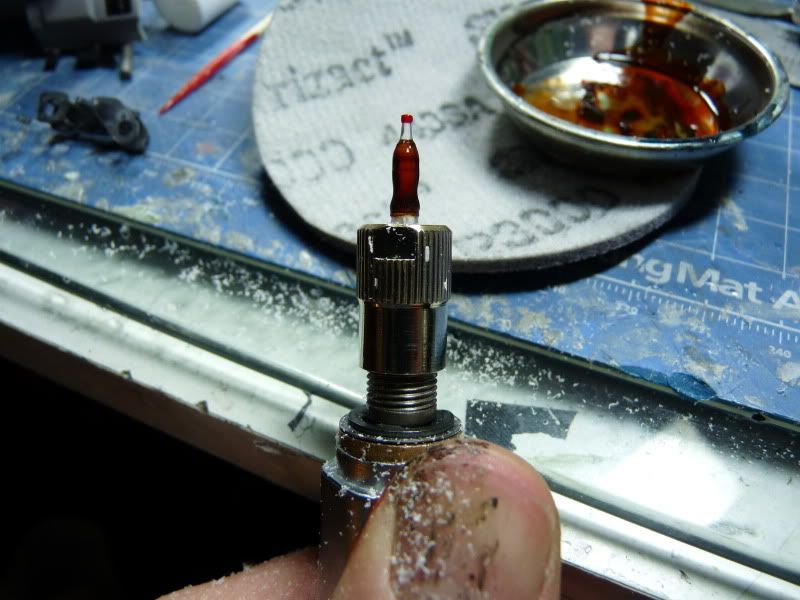

flyonthewall Posted November 24, 2011 Author Posted November 24, 2011 A coke bottle was machined from a piece of clear sprue The coke liquid is a mix of Tamiya smoke orange and red painted on Dipped into some Johnsons Klear for a nice shiny finish and a scribble in white with a fine brush to depict the coke logo.
Foxer Posted November 24, 2011 Posted November 24, 2011 Welcome over here, Chris. I do the Automotive Forum also. There's the same kind helpful people over here. The fine lines you added really made that paint pop! Very cool paint job.

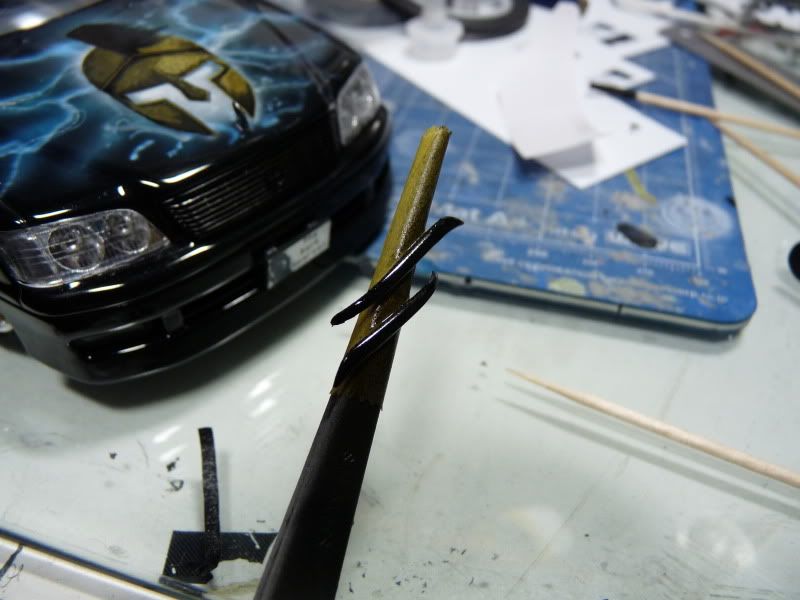

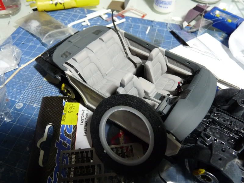

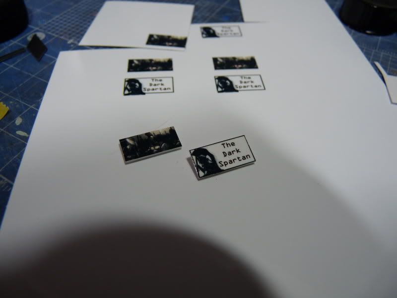

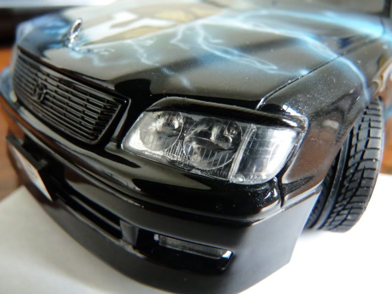

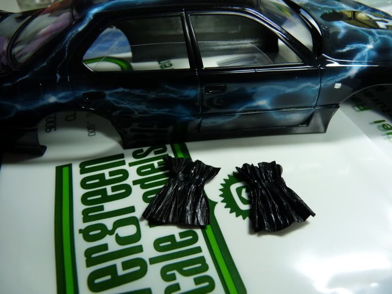

flyonthewall Posted November 24, 2011 Author Posted November 24, 2011 Some internet images resized for license plates Incidently the 'Dark Spartan' script on the back of the spoiler is hand drawn with a technical drawing pen before the clear coat was sprayed. Rolled down windows replicated with o.o5 clear styrene sheet Car curtains common with the VIP scene were made from strips of thin paper. Lots of scrunching and folding required to achieve the fine folds of the curtain to give it a natural drape look. Seatbelts made using 2mm black tape

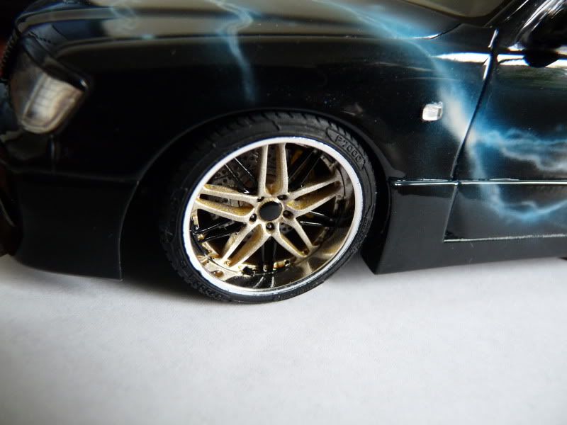

flyonthewall Posted November 24, 2011 Author Posted November 24, 2011 Added CF decal to the eyebrows and wing mirrors Wheels are Aoshima 19" Kranze Borphes painted with Tamiya Titanium Gold with alternate spoke detailed with gloss black
