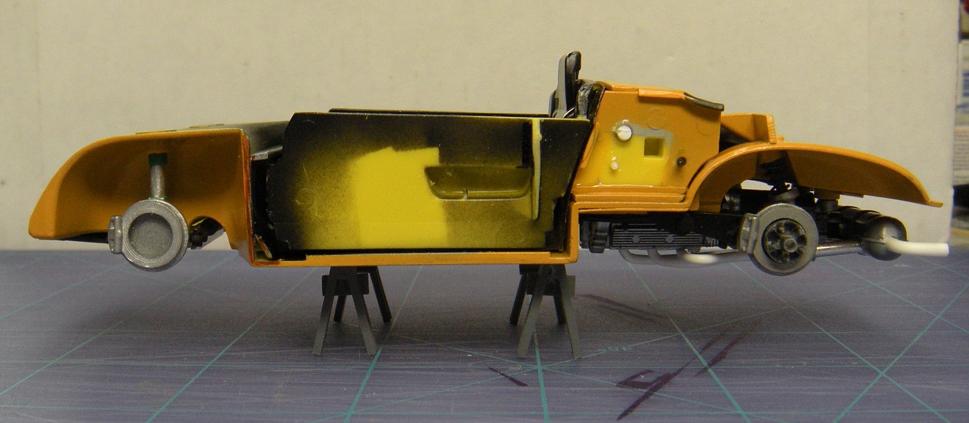

I like my builds to look good even when you turn them over. So I’ve covered the huge slots in front of the rear wheel wells with .010 sheet styrene. I’ve added .060 angle to either side of the engine bay. These will act as my motor mounts; I plan on using the 6 cylinder engine from a Fujimi Enthusiast 911 kit. I have also filled some locator holes and tabs in the floor plan.
I struggled to figure out on my 914/6 GT build why the operable engine cover and trunk fit and functioned so poorly. It finally dawned on me that the side panels that act as the hinge points for these panels sat to deep inside the body of the car. The top side chassis photo shows were I have .040 (!) sheet to raise these panel up. I then added .080 channel to act as a receiver to locate these panels since I have covered up the original mounting tabs slots. The strip styrene down the center of the chassis will fit inside the drive shaft tunnel of the interior acting like a blind cleat.
I have added .010 sheet to the back of the interior to represent a fire wall. The notch in the center will provide clearance for the front of the engine.

I had every intention of using the kit’s suspension but it just wasn’t working for me well at least the front wasn’t. So starting with Fujimi’s 911 suspension pieces I was able to modify and scratch build something I was more happy with.
This photo shows a comparison between the kit parts (molded yellow) and the modified parts.

On the 911 the transmission mount is attached to the bottom. On the 914 it is mounted on top. The picture shows an unmodified kit part compared to the modified part.
I added some flat stock to the floor pan to simulate a cross brace at the transmission mount.
