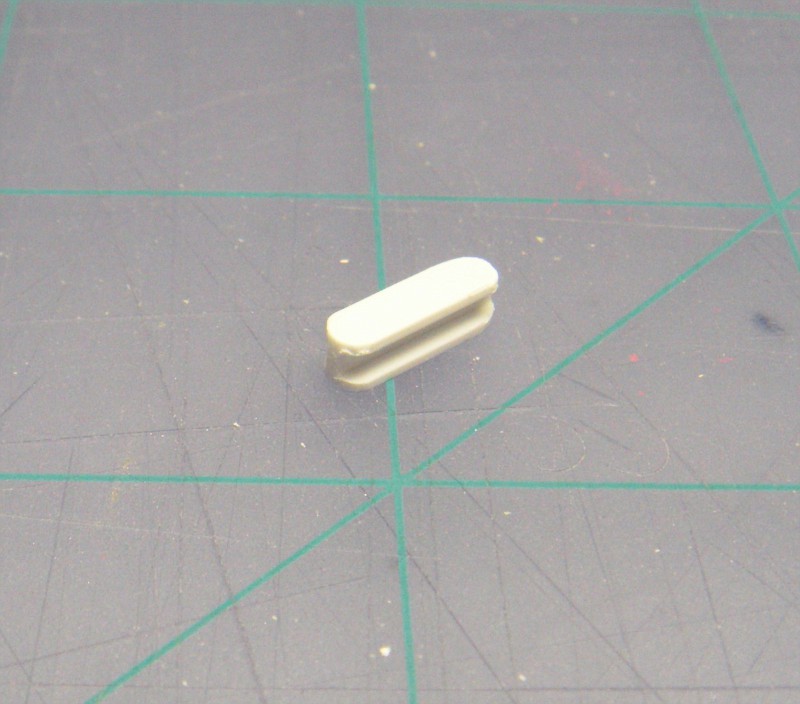

afx Posted February 7, 2014 Author Share Posted February 7, 2014 (edited) Cut a piece of beam to the desired length then file the ends round. Edited July 21, 2018 by afx Quote Link to comment Share on other sites More sharing options...
afx Posted February 7, 2014 Author Share Posted February 7, 2014 (edited) Paint the webbing of the beam black. I used permanent marker instead of paint. Cut a strip of your choice of screen material. Apply some glue to the edge of the top and bottom beam flange. Wrap the screen around the beam and allow the glue to dry. Edited July 21, 2018 by afx Quote Link to comment Share on other sites More sharing options...
afx Posted February 7, 2014 Author Share Posted February 7, 2014 (edited) Once dry trim the excess screen from the top and bottom the beam. Stack the pieces like a sandwich and there you have it. Edited July 21, 2018 by afx Quote Link to comment Share on other sites More sharing options...

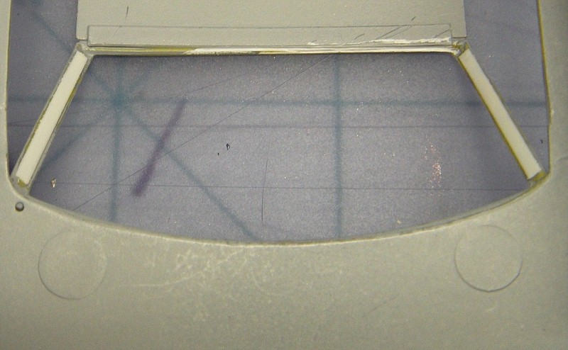

afx Posted February 22, 2014 Author Share Posted February 22, 2014 (edited) Well a mini disaster struck when the passenger side A pillar snapped in the middle. A glue only repair didn't last long. After some consultation with a few fellow modelers I decide to reinforce the pillar with .010 strips. It affects the windshield fit some what but it definitely strengthens the pillar and the repair. Edited July 21, 2018 by afx Quote Link to comment Share on other sites More sharing options...

Foxer Posted February 26, 2014 Share Posted February 26, 2014 It's looking good! I have a couple brass lined A-pillars on my shelf too .. Quote Link to comment Share on other sites More sharing options...
