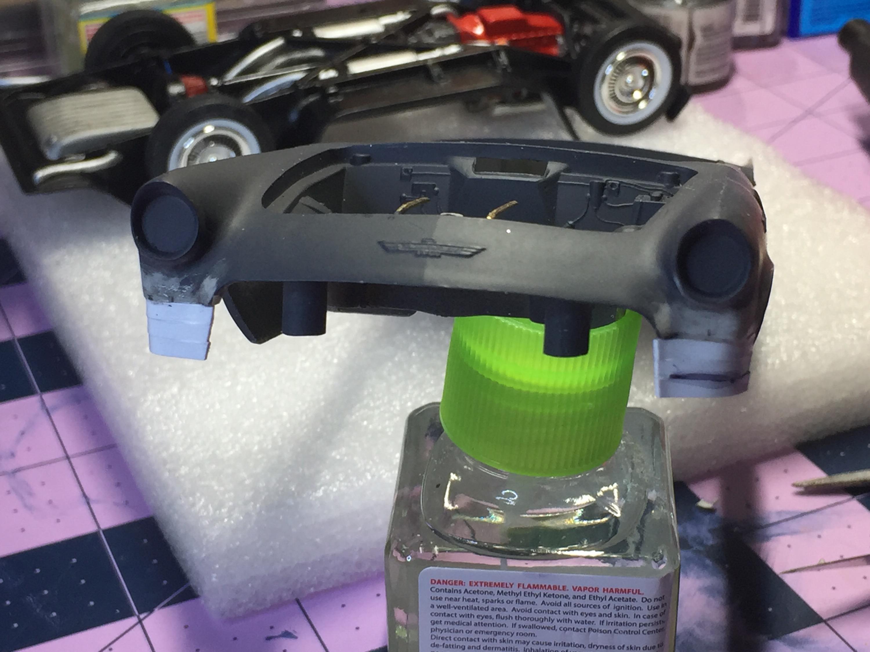

That little issue with the fan slicing through my top radiator hose was an easy one to fix. Monogram could have worked around it with an electric fan. That's okay, I did. And while I was at it, I figured a new aluminum radiator would be nice too. Here's the kit radiator ? Notice the molded-in horn and the half-a-pressure-cap. ? The electric fan I found in my "engine parts" drawer is a beauty. Not a clue where it came from but I'm sure glad I was able to find it. It fit the spot almost perfectly. The splash pan (?) had to be opened up a bit, enter Mr. Moto ? For the radiator, a little work with Mr. Moto and some scraps of Evergreen and I'm on my way to a nice new custom aluminum radiator! I removed the horn and air intake screen from the front side and veneered the support with .010 sheet to clean it up. I added a .040 x .040 strip across the top and some .060 angle for esthetics. Then I sliced off a piece of 7/32" tube and grafted it to a scrap of sheet that I cross-hatched with my #11. I glued some scrap strip pieces over the kit radiator tank and fashioned it to look like a custom aluminum item. I still have a can of MM Metalizer with a bit left in it so I'll hit it with that and buff up. An octagon cap will finish it off. oh... yeah.... and I cut the fan off the engine ? . Thanks for checking my work! -

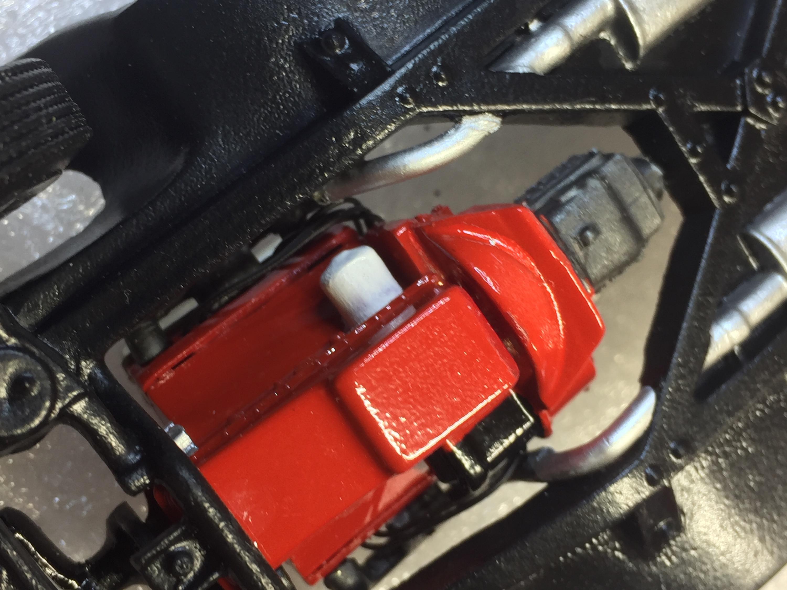

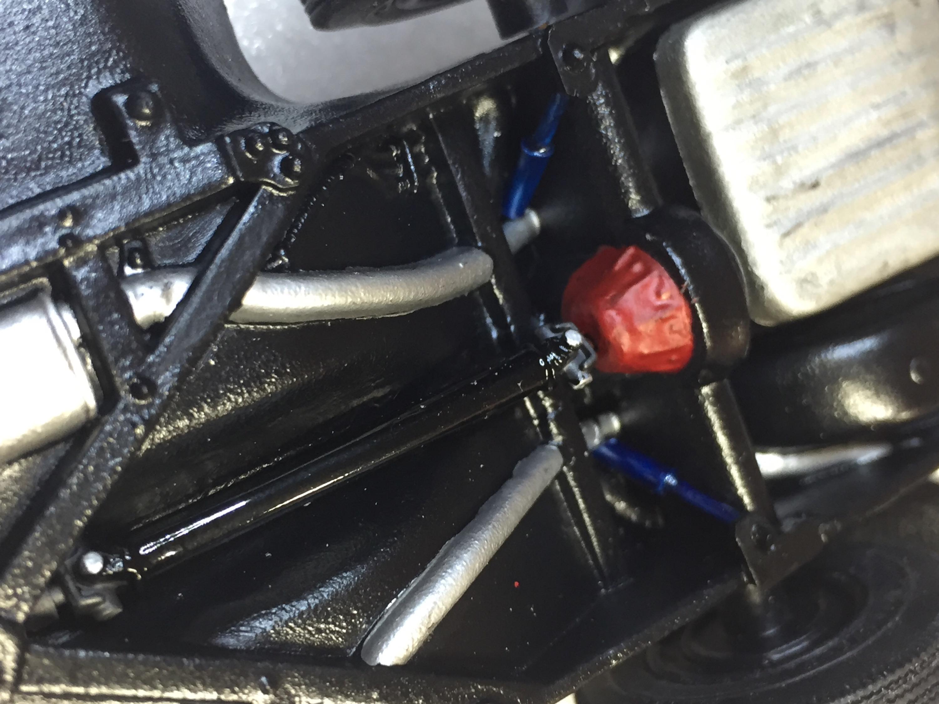

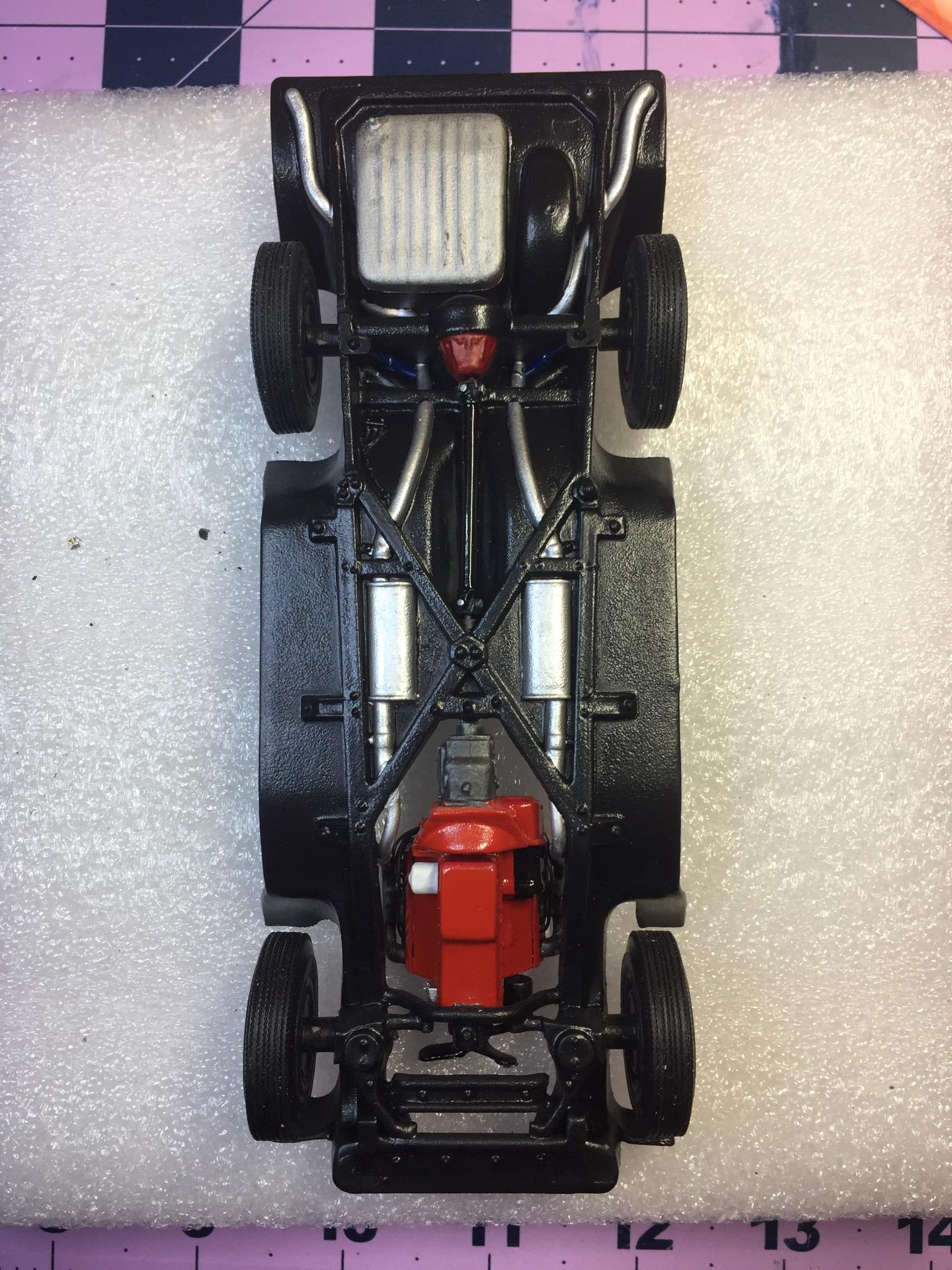

Today was somewhat productive. I felt like I should make a more serious effort on the rear suspension. This was triggered by realizing it would be quite difficult to paint the pipes under the rear end. I grabbed my chisel blade and removed the rear end unit and gaffed up some new mountings for the rear of the springs. I would call it a deep fake. It's not great but it actually looks like the shackle mounts. I was able to keep the lowered stance by maintaining the spring angle I had. Now, at least, it doesn't look like a total hack job. Also the shocks needed new, more functional mountings so I cobbled up the lower mounts that would hold the kit's optional coil-augmented shocks. The kit floor was a horrible, weird thing where the upper ends of the shocks would go. That had to go so I grabbed my favorite cutting tool and removed the offending plastic. I covered the holes with .010 sheet and added a length of .060 thick strip, sanded all around on one side to look like a reinforced section of the floor for the upper ends of the shocks and drilled holes to accept them. I also added strengthening beads to be more convincing. I don't have many options for wheels/tires. I have a set of rally wheels from some kit from years ago that I detailed but ended up not using. And then there's the kit wheels. Still undecided. Then it was time to finish the hood hinge install. The new firewall needed more attention so I got that out of the way. While mocking up to check some things I noticed my upper radiator hose may be in peril. Such is the nature of this kit I may have actually improved the stance as a result of the mods I made to the rear suspension today. I keep wondering why the kit includes a roll bar, a dual-quad tunnel ram manifold but no slicks. ? Thanks for coming by and sharing my nightmare -
