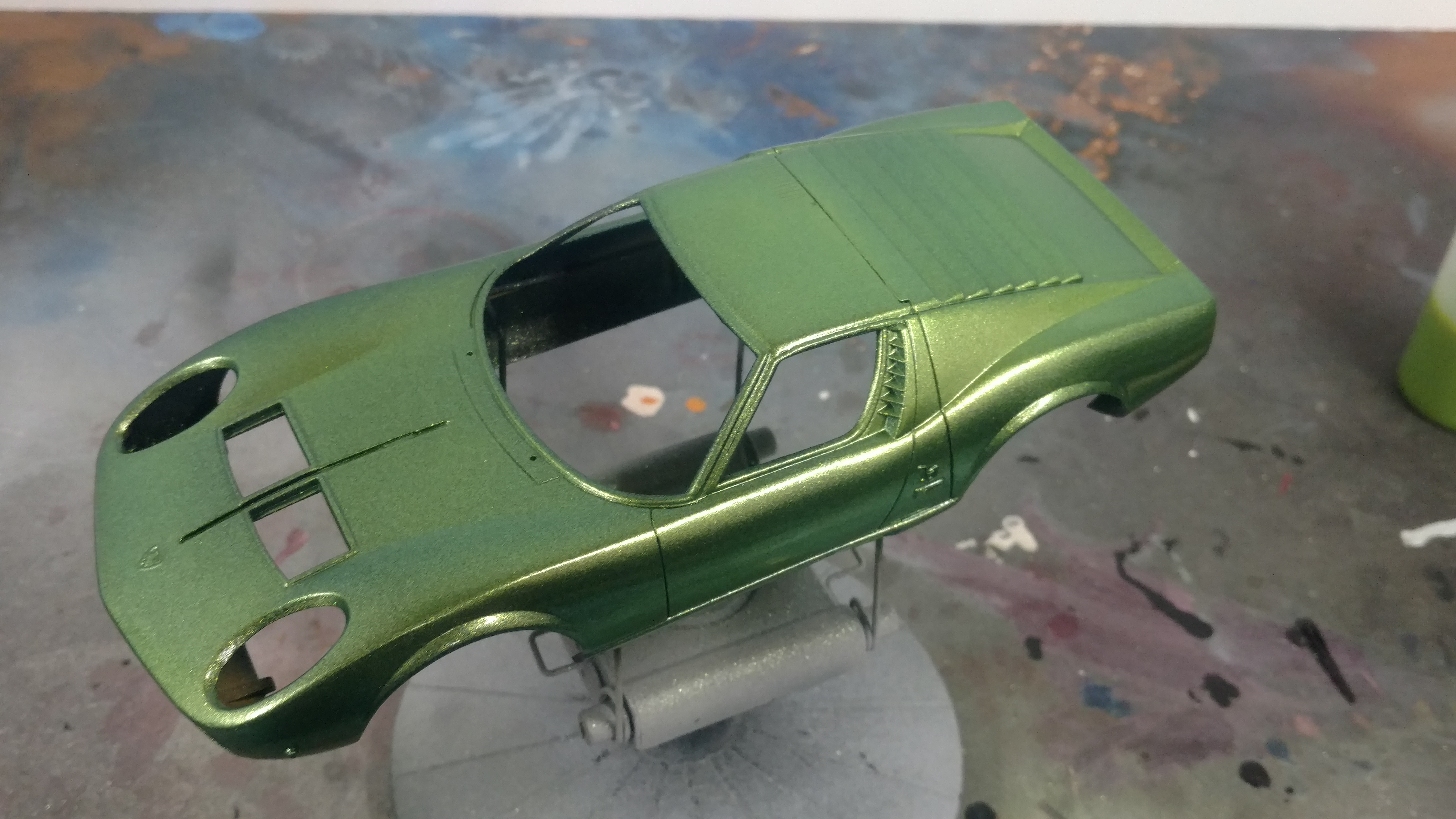

Another test paint job that turned out well!
rsxse240 replied to rsxse240's topic in WIP: Model Cars
I thinned this with a medium "temperature" lacquer thinner from Orilley Auto Parts. I have used the Kleen Strip brand but it was too hot and would dry before hitting the body causing a very grainy texture. Also it seems the Orilley stuff seems to mix into the paint as opposed to dissolving the carrier (if that makes sense), as the Kleen Strip brand does. The pressure is very subjective with nail polish. Most times you want a very low pressure and build up very thin coats, but with the size and quantity of flake in this paint, I had to crank up the pressure and REALLY open up the needle. I used a #3 needle in my Paasche VL at about 25-30 PSI to keep it wet and flowing until it was on the car body. -

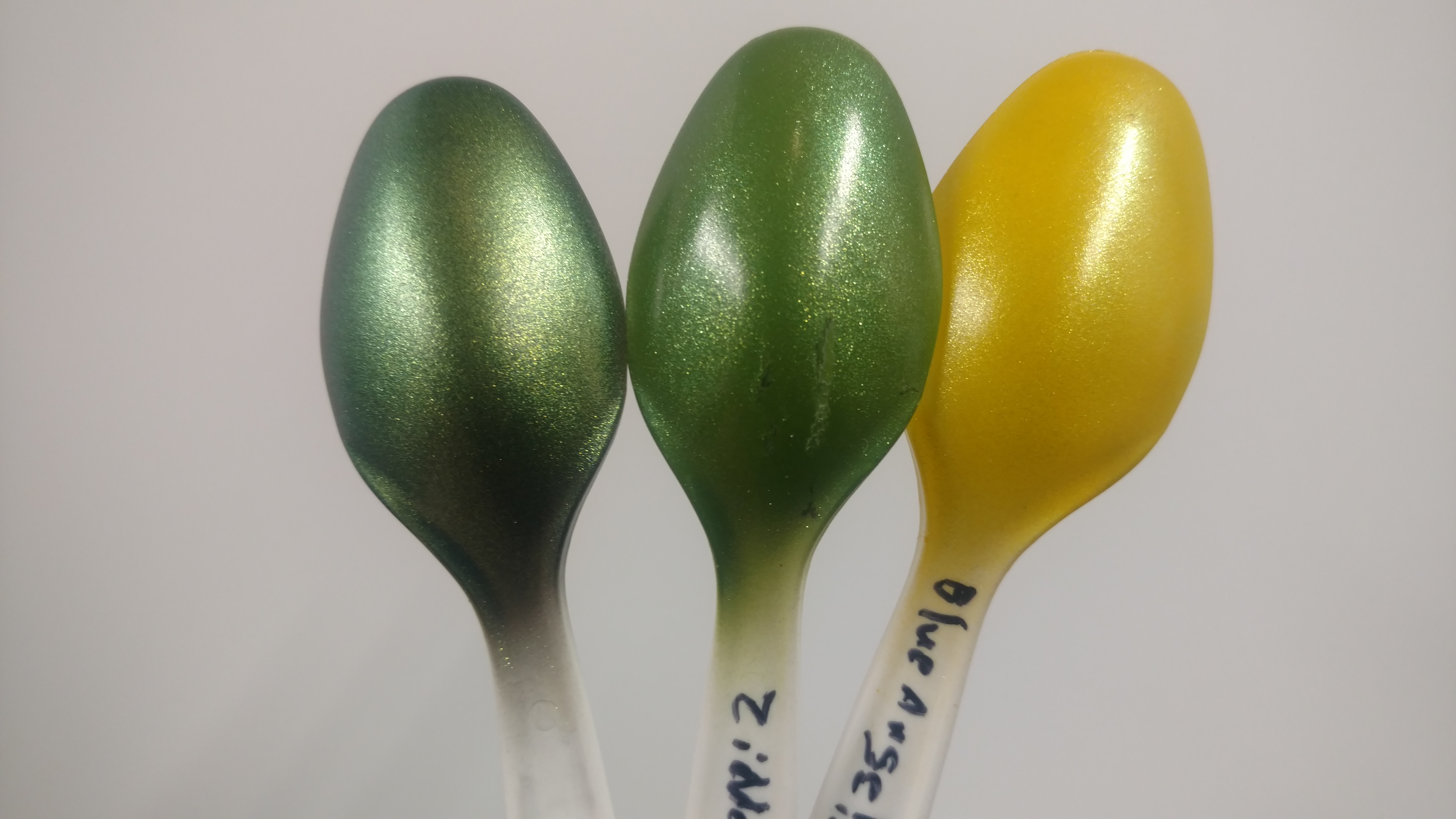

I liked a color of nail polish I saw at the store while waiting for the wife to gather her H&BA goods. It was pretty cheap, at $1.50 for 1/2oz jar (or there about). It was called Sassy Lassy (green metal flake) by Sinful Colors. I quickly found out that it was a clear coat with green metal flake and no actual pigment, but pressed on...lol I made a pun... So, green flake over Testors Flat Black, over Model Master Green Zinc Chromate, and over Blue Angel Yellow. The yellow, was first and OBVIOUSLY not green at all! The Zinc Chromate was second (the middle spoon), so I tried the flat black and loved it. So I mixed up the whole bottle about 30% paint to 70% lacquer thinner and shot at a very low pressure... about 15psi through my Paasche VL with #3 needle. Found a kit that needed this color and tried it out. This is what I got: VID_20190323_212858758.mp4

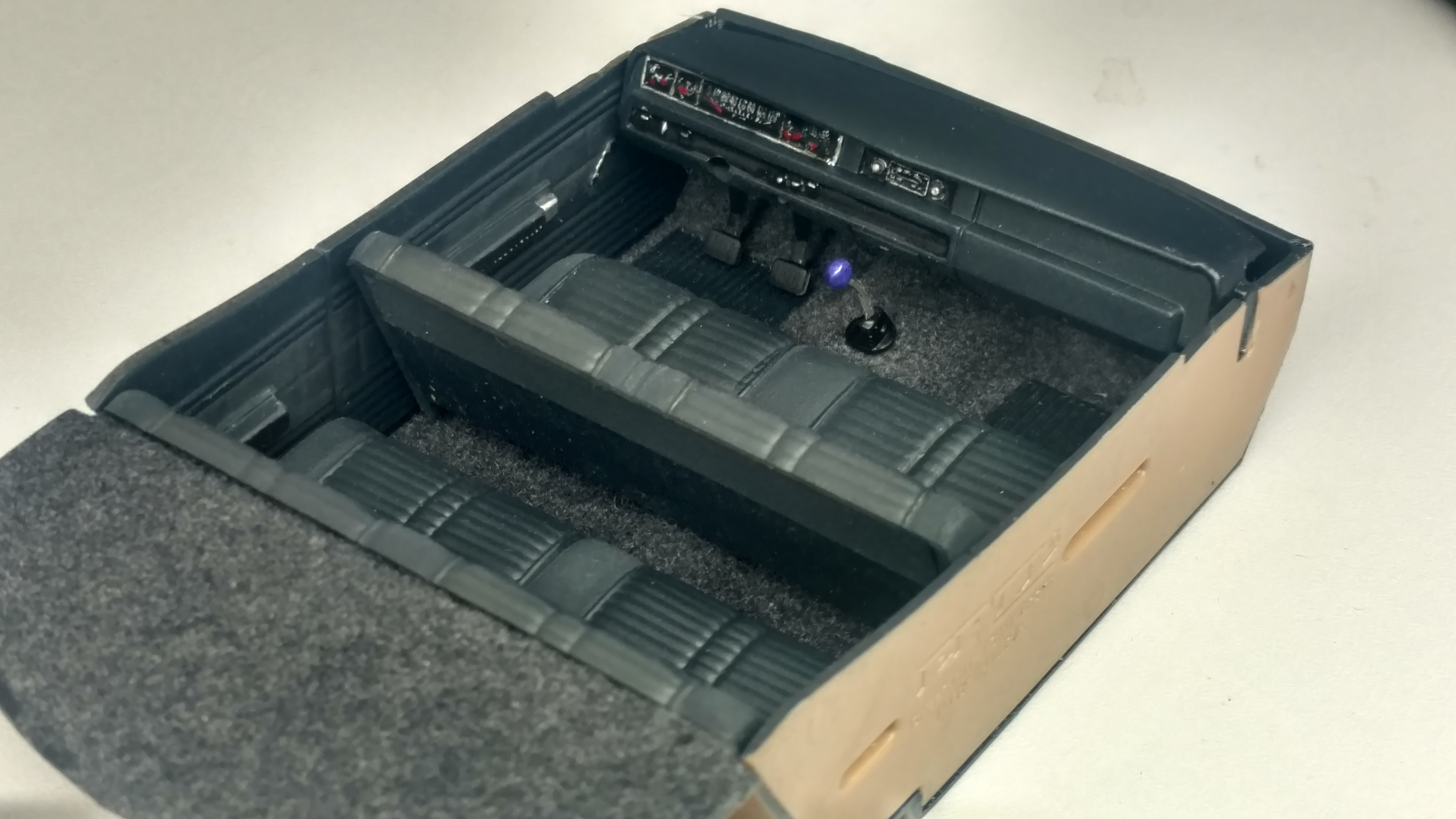

So far the interior is done. Black on black and some various dark grays. A very purple shifter knob will match the accent stripe. I will get pictures of the interior soon.

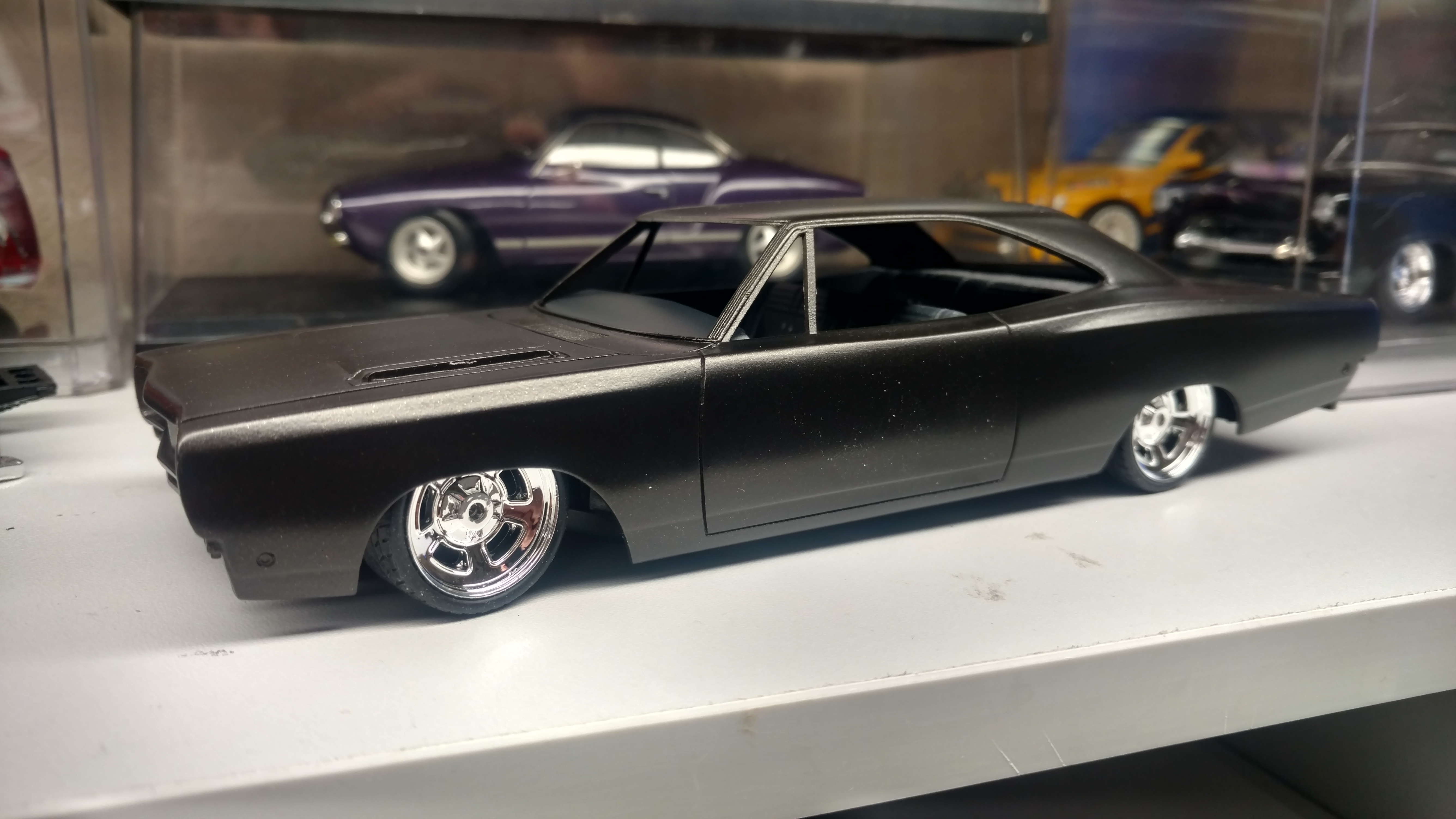

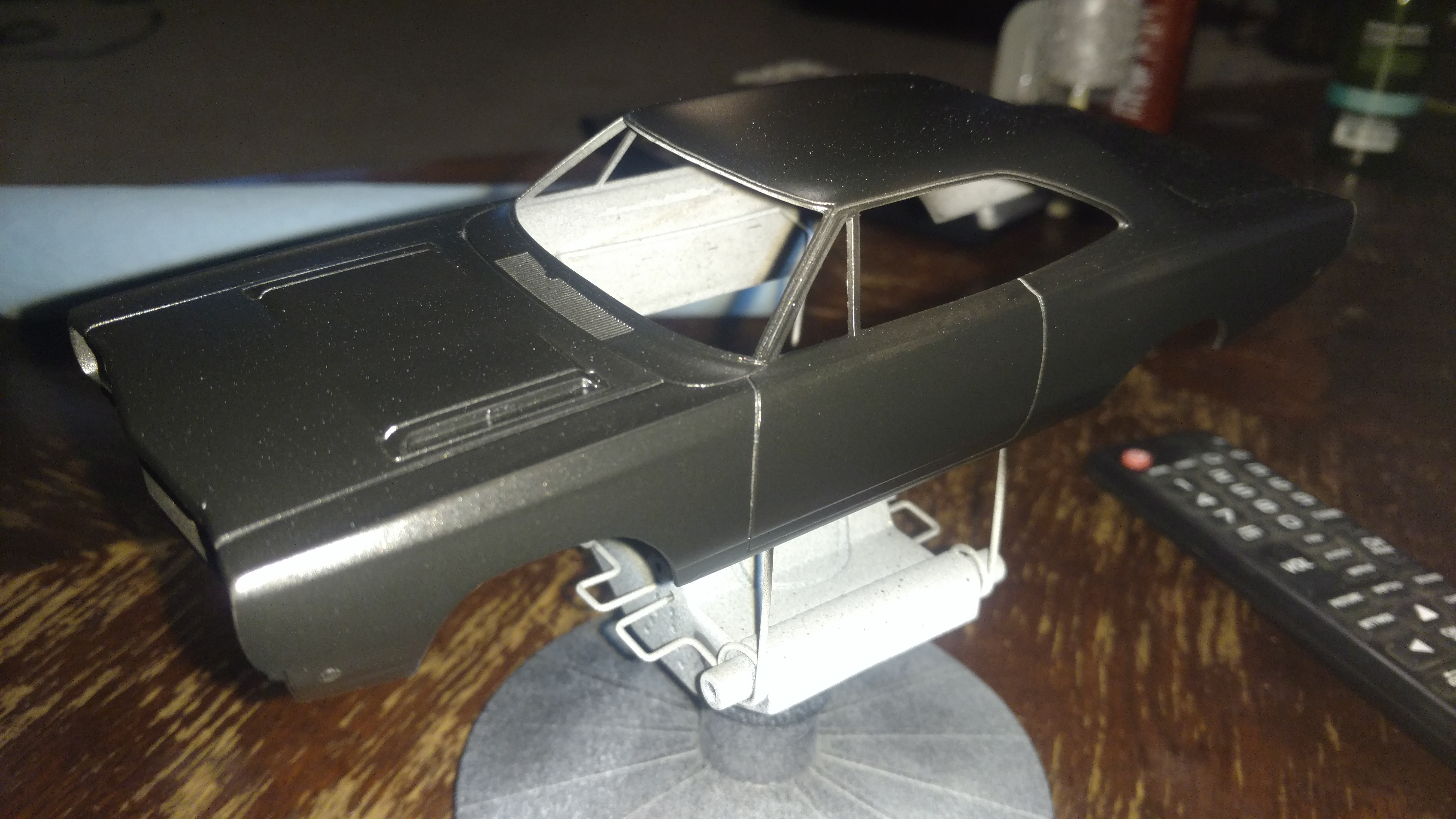

I have been trying to get this one painted for quite some time. This is attempt #5. I tagged this as "cheap paint" because I used Folk Art Craft Acrylic paint. The color is Sequin Black, thinned with Createx reducer and some balancing clear mixed in to help with flow. I need to wet sand some dust specks and then clear coat and polish, but at this point I am very happy with the results.

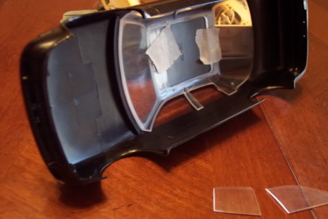

This is a very multi-layer question. Just painting a headliner, box stock build, I like Snake's plan. Covering mold imperfections and such, 89AKurt's plan would work well with any number of materials. I have used both of these examples and had great success. But there's no limit to how detailed you can get. I have used sheet styrene to build up interior details on a, b, and c pillars to give depth and dimension and used masking tape for headliner. I've used Bondo to fill in spaces to smooth out the inner roof. The thing is to find a 1:1 reference photo of what you wish to replicate, then through trial and error, asking for suggestions, and brainstorming, come up with a plan to achieve your goal. You see in this picture, I had a full bucket type "glass". I temporarily installed and scribed the door window opening to the bucket, carefully scribed out the door glass leaving the bucket minus the door glass to represent the interior trim plastics. I then shaped and polished things accordingly. I then used masking tape to cover the square hole in the headliner, did some creative masking and painting to create a very believable headliner and inner roof. Then I thinned and polished the door glass and installed them to be halfway down. All because I wanted to hang the seatbelts where they belong. Lol Here's the finished product. See how well the effort payed off? Oh, no, you can't see it, but it does look very good, take my word. Hahaha -
