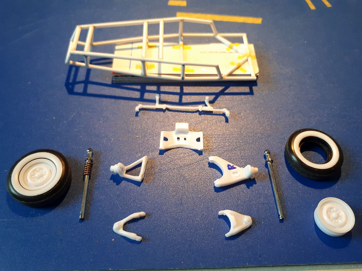

2018-07-25 Basically i have a rollin chassis, although its still taped to the pile of cards while glue is hardening. Since the last post i finished the front suspension (upper arms and coilovers not in the picture), made the rear part of the frame and added the rear suspension recently (coils not in the picture). I had some issues with the rear axle, but i hope it works now. Next up to fill and sand the frame's rear and the axe, then add the engine and make the drive shaft. -

2018-07-19 I made the first pair of upper and lower suspension arms (left) from the original chevy bel air front suspension (right). i think the look is much better! Coilovers also start to take shape. -

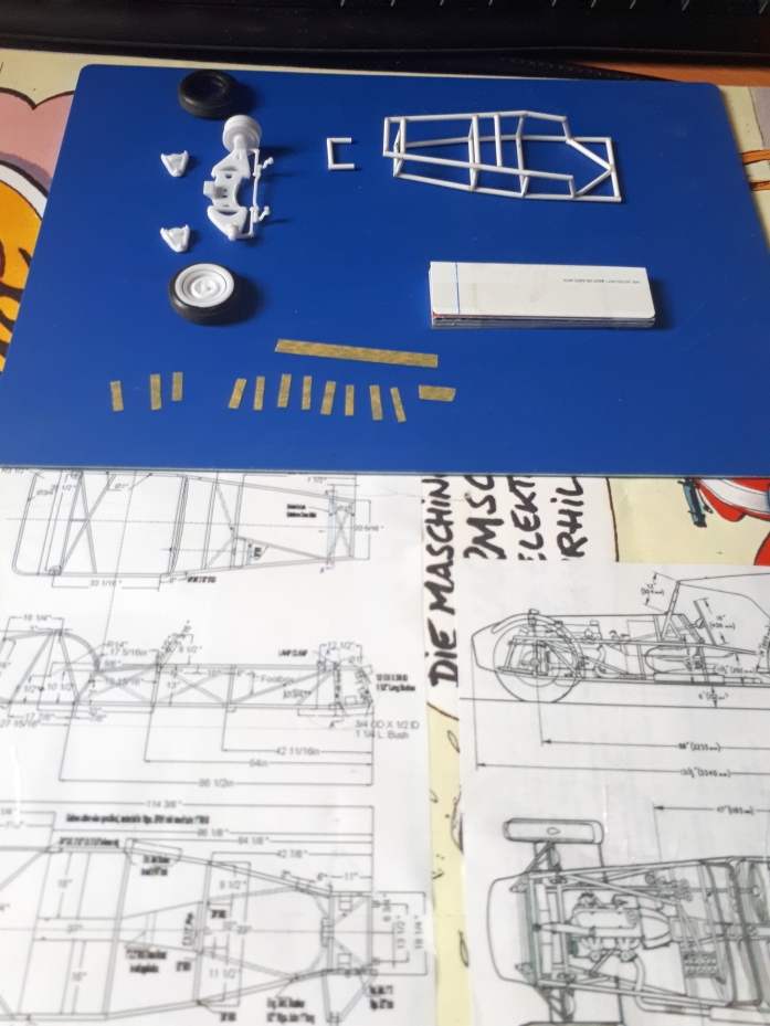

OK then, after some nice smalltalk back to business: 2018-07-18 I made the lower and upper parts of the frame. To make the cross members between these two i taped a pile of plastic cards together and taped them to top and bottom of the card pile. Doing so i ensured that the frame height will stay correct. Currently i am finishing the front end of the frame. Next step will be to make the suspensions. Therefore i already made the pile of plastic cards a little less high and i will tape the frame on top of it. This will simmulate the correct stance. I'll start with the front suspension. -

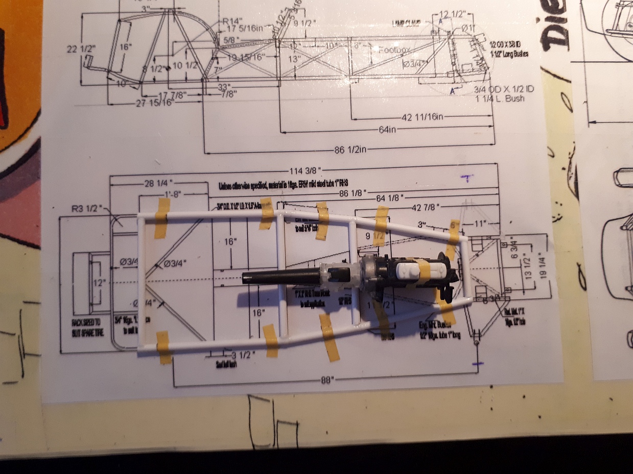

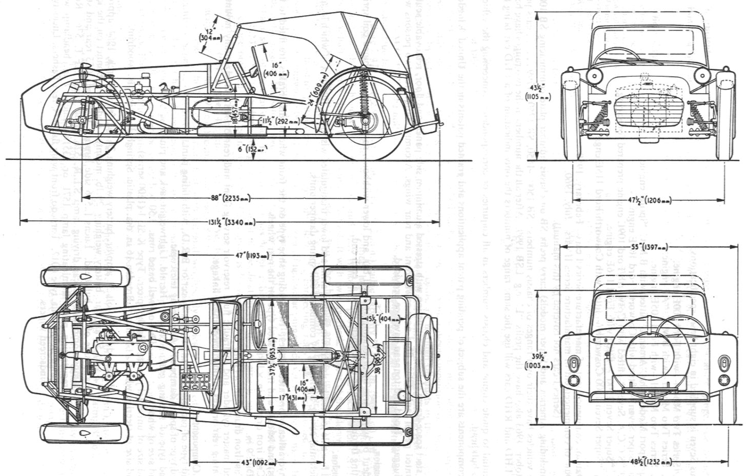

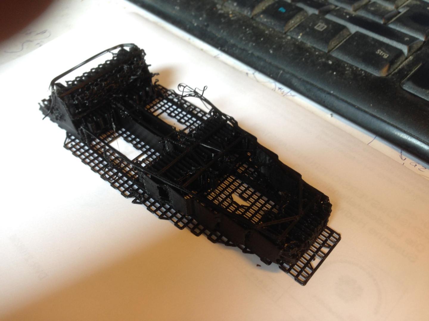

David, i have withdrawn the 3D option rather soon, as the result was not usable for me: The blueprints (printed out in scale 1/25, so 1:1 for my build) were very helpful indeed. Not only for the frame but also later in the build to get proportions of the car right. Michi -

Thank you for your interest guys. Here is my next post: 2018-06-26 I want to scratch build a tubular frame from 2 mm round evergreen. My approach is to print out the blueprints in scale and use them as my guideline. 3D print the chassis is an option, especially cause there are already existing .stl files on the web. But the quality of the result is questionable so i want to build it from styrene. -
