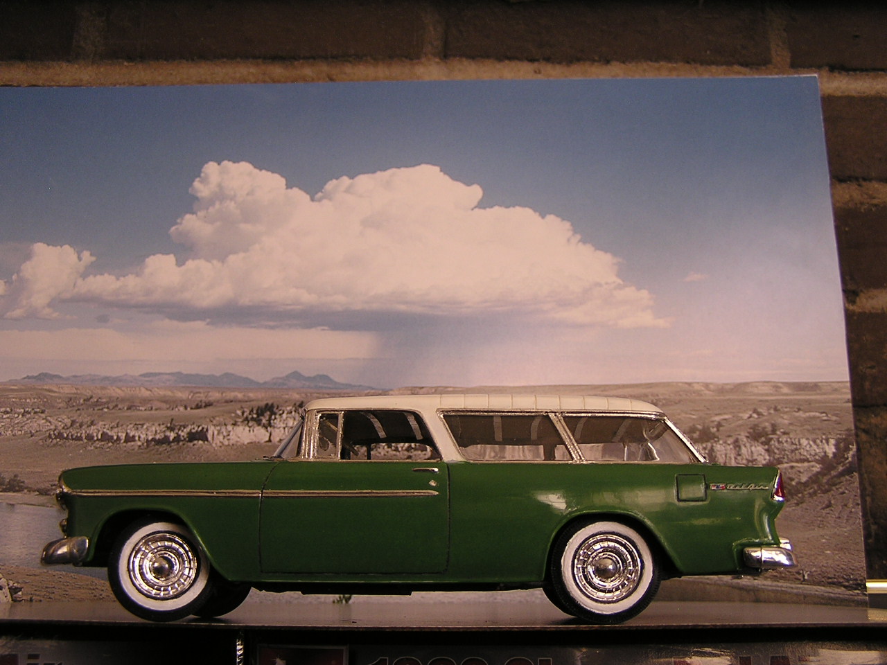

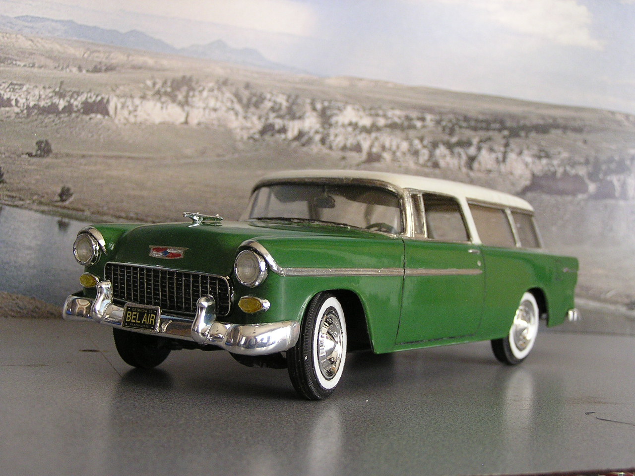

  4. This AMT Nomad kit was the second model car I have built. I like the older cars and I wanted to try a two tone paint job. I don't think this is a Chevy color scheme but this is how I remember a friends nomad was painted. I mixed the colors from liqutex artists acrlyics and Tamiya acrylic thinner. I used waterborne varnish for a clear coat. Along with two tone paint, I wanted to have the tailgate open and close. The kit had a broken hinge for the tailgate so I wanted to fix that. The tailgate hinge was a challenge, but I learned alot in the process of reworking it. I made a pair of hinges from brass wire bent to make a pair of small eye bolts to accept the plastic pins molded into the original plastic hinge. Overall, I am happy with the outcome. I have a two color paint job and the tailgate works. Now back to my 67 Camaro build with a swinging door and a jukebox.

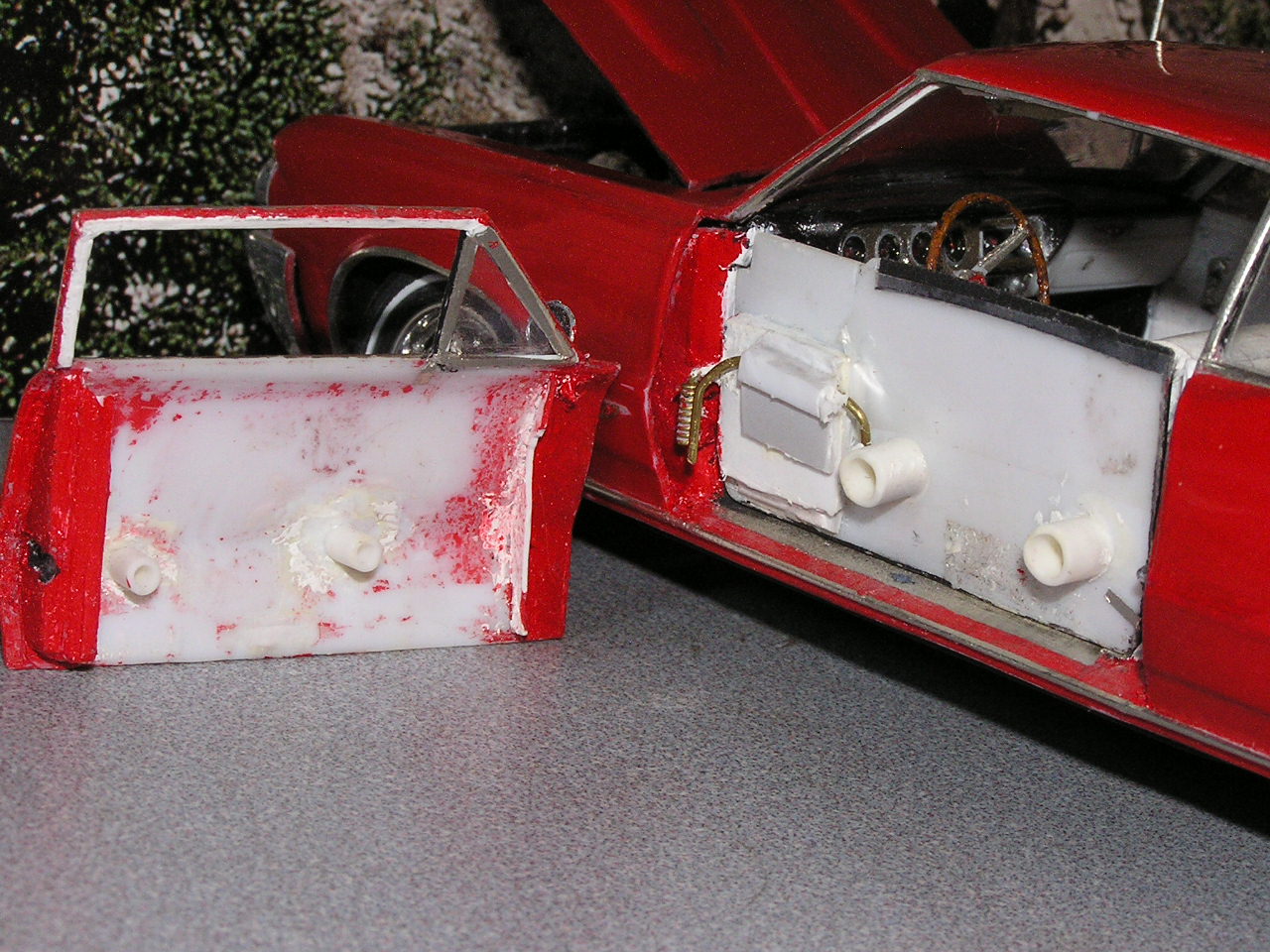

  6. Thanks Patrick! The only way to adjust the hinge for fitting was to have a way to get inside the door. The 2 door halves simply snap together on the two pairs of tubes that are sticking out.

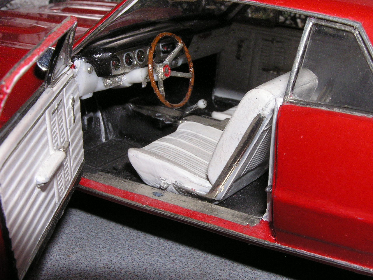

  15. This is my first plastic car model. I had a lot of fun building this kit. I really wanted to get into this car so I opened a door ha ha. I thought you should see the inside better so cutting the door open made sense. It made the whole build way more difficult to fit together. I came up with a pretty solid and easy to make hinge in the process which is a bonus. Anyhow thanks for looking.
