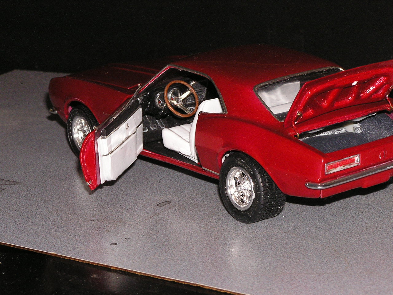

  2. I think I have the door, the trunk and the hood fitted about as well as I ever will. I had to remove the spring from the trunk. It held the trunk open just fine but when it was closed it was a tad bit high and I didn't like the way it looked. I think a bit of touch up on some of the BMF and maybe the wing window and I will call this one done. Here are a few more photos.

  5. Thanks Rusty. I have had enough time to work out a couple trouble spots since my last post. I had some problems with my trunk latch that I am still working on but I was able to work out the wing window to an acceptable version from an old blister pack cut to size. I'm not to sure I like the tires or not I don't have many on hand to choose from. I also need a door latch and a little work under the hood and she will be about ready to post in the under glass section. Yahoo!

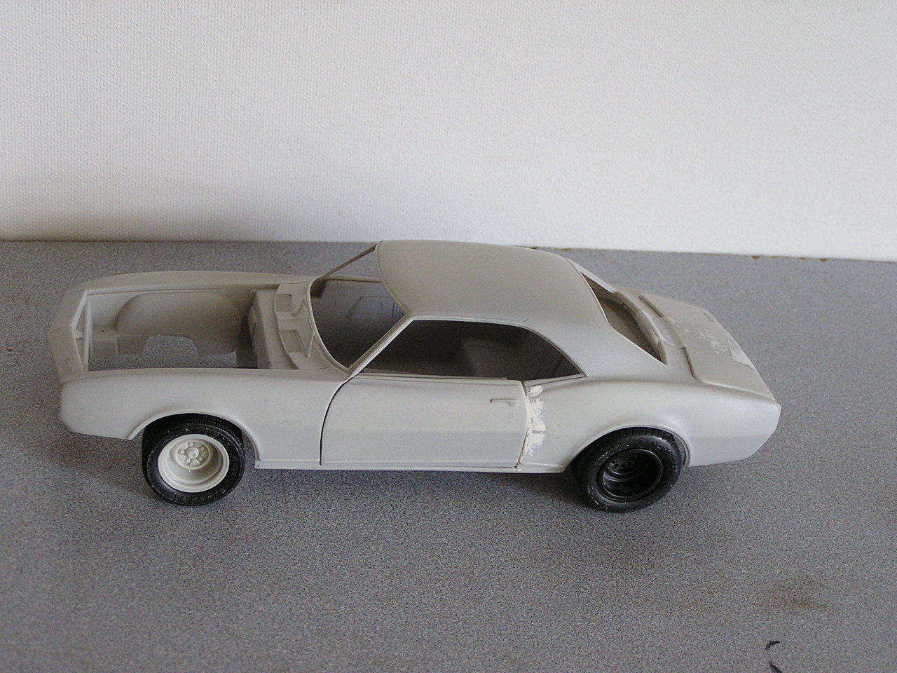

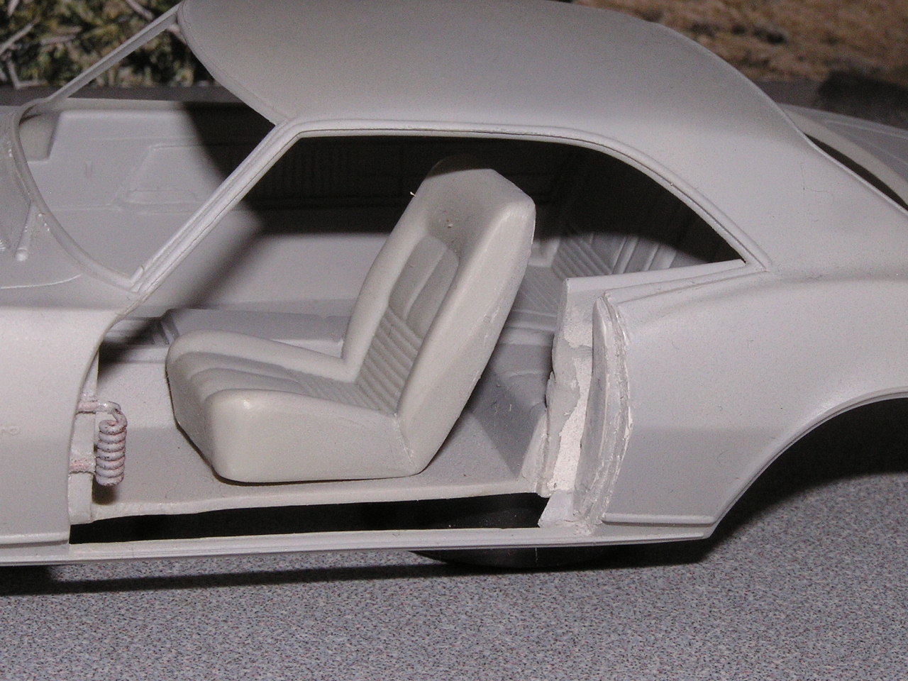

  8. I have been slowly refining some of the details of the trunk and some of door jam details before I painted the body parts. One glaring problem with the kit is the seats are too high to look right. The easiest way to fix that was to remove the floor from the tub which I did. Now the seat will have to be installed after the rest of the tub is installed. I figure some putty and some flocking should look get the floors looking good. looking at the interior with the door open the seats and the floor look better down lower.

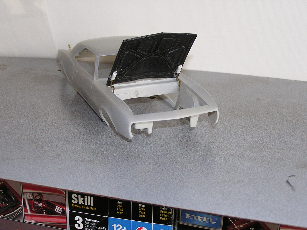

  9. I added a way to lift and hold the hood open. You can still remove the hood for photos by lifting it of the hinges. The hood in the photos is one of my extra hoods. I have been using this extra hood to test the fit. I think I can get a cleaner install on the next one.

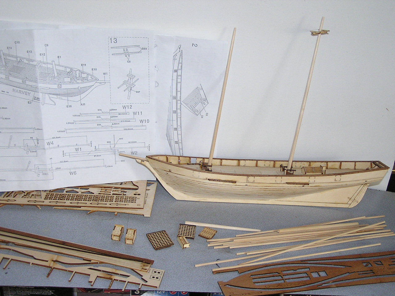

  10. This looks like a fun kit to build. The subject is much less complicated than your last one was. The scale is also larger with this boat than your ship was. The kit quality looks much better with this kit. The first wood ship kits were hardly kits at all. Most early wood model kits were not much more than a basswood plank, some dowels, a few spools of thread, a piece of cloth along with a drawing or two and that was your kit. They have come along way with the laser cut wood pieces in the modern kits. Most of the old kits just printed the shape of the piece on a thin piece of wood and it was up to you to cut the piece out. I have an old kit of the Santa Maria that has nice wood but is almost more like a scratch build than a kit. Using a small scroll or band saw is the only practical way to build one of these old kits.

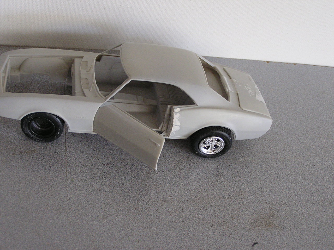

  12. Thanks Marty! The hinge is easy to make. This is my first hinge of this type that I tried. I did a cleaner install of a similar door hinge on my 64 GTO build. One thing about installing a hinge in such a small space is how to attach it. The nice thing about installing this hinge is you can connect the two ends of the coiled wire that forms the tube section of the hinge directly to the body of the car or to the door. The hinge is only two pieces. The door is made from two parts. The outer part of the door fits on the inner part after hanging the door on the hinge. The halves fit together on the two pairs of tubes that are glued inside.

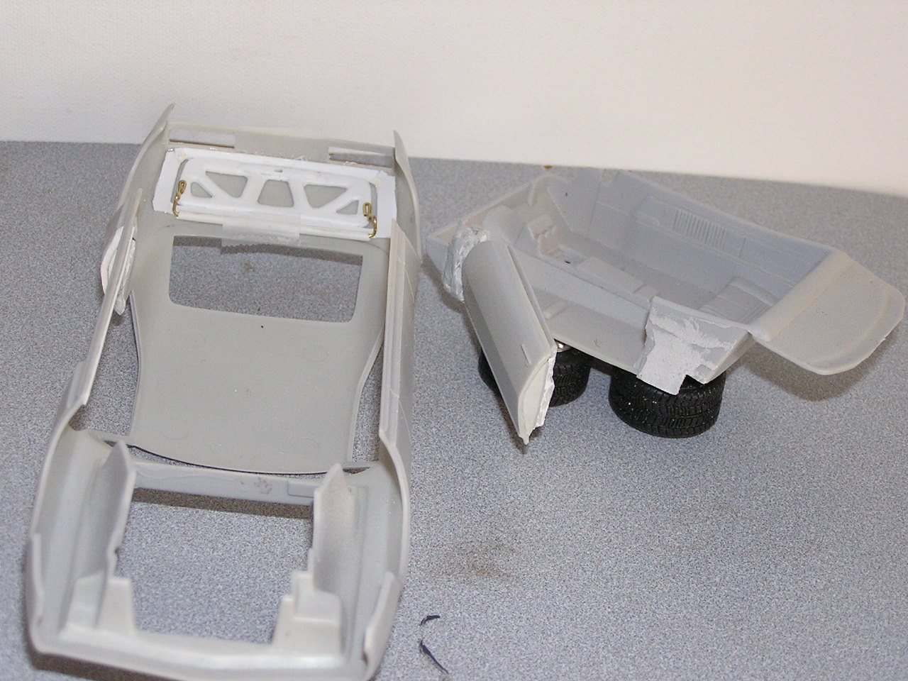

  16. I bought 2 AMT kits that were missing pieces and one kit was started. I thought that between the two kits I would have most of the parts to build a finished car. The wheels and tires were gone from both kits. I thought since I had an extra body I would try to open the door and the trunk. Here are a few photos of my progress so far. The trunk lines up better than it looks in the photos. I just taped it in place for now. I still need to do some work on the door jam before I can paint the body. I have a few sets of tires and wheels that should work but I am open to suggestions for those or anything else.

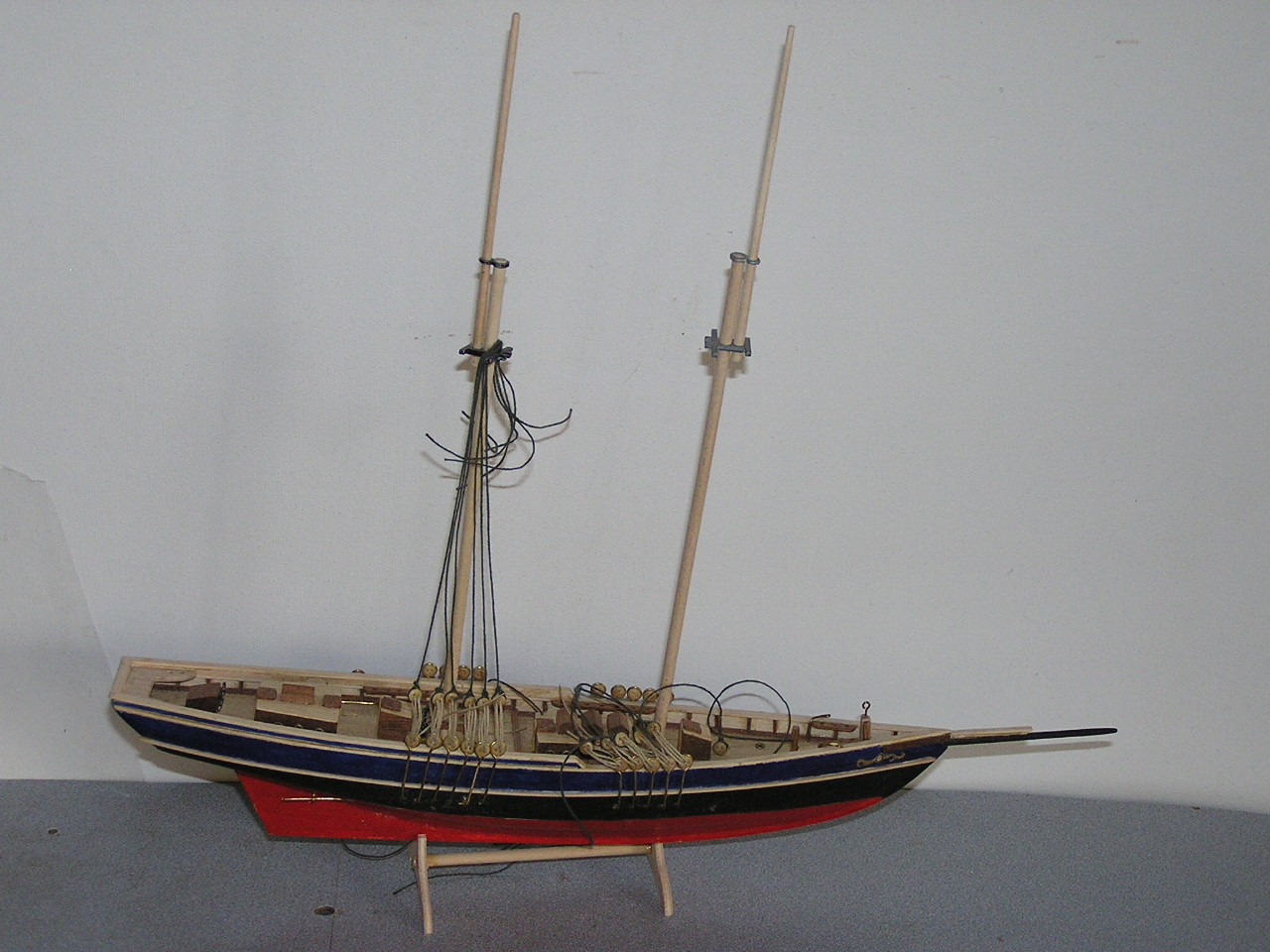

  18. I think your ship looks quite good and is very good for a first wood ship. The rigging looks a little bit off but you can always make changes later. To do an accurate representation of the sails and rigging you will need to have a better kit with good diagrams and instructions . Even on a larger model to get the rigging right is a tough thing to do. There is too much thread to get tangled around your fingers. If you look at some of the kits on Ebay they show a deluxe version of the kit. Some of the builders are very good and add every extra to the model that is shown. These kits from China are good for the money. To get a model like they show usually means buying or making extra parts that don't come with the kit. It also helps to have a photo to compare to. The model I have is the 1/96 Harvey. The example pics for the 1/96 Harvey are amazing in there detail with many features not found in the kit I got. So the pictures they show are a bit like false advertising.
  19. She is looking good! I found a picture of a similar ship on Ebay. It looks like a pro build of the same kit maybe.
  20. Ray, did you get an assortment of several sizes of dowels with your kit? The masts are made from the dowels and they must be tapered to look like the real thing. The dowels are also used for the yards which are tapered as well. The yards are the spars that are slung crosswise to support the sails. The yards need a good deal of rigging to support the sails. The first rigging you need to install are the shrouds. The shrouds hold the mast in place from side to side. The shrouds are made up of thread connected to the deadeyes. The deadeyes connect the shroud to the side of the ship. After you have the shrouds on both sides of the ship then you add the stays fore and aft. This is the rigging that holds the mast in the proper position. That is the standing rigging. Only after the standing rigging is on can the running rigging be added to mount and set the sails. It sounds rather complicated because it is. There should be some info in your book that covers the rigging process.

  25. It looks like fun Ray. I have a ship similar to yours in progress now. Model ships can have a lot of rigging if you want to have it fully rigged. There are different levels of rigging that can be used. For a first model you may want to have only the standing rigging. The standing rigging is only the rigging that holds the ship together. The running rigging is all the ropes to hold and set the sails. I don't see any dowels for your masts and yards. You should have some dowels that you will need to taper to match the plan.
