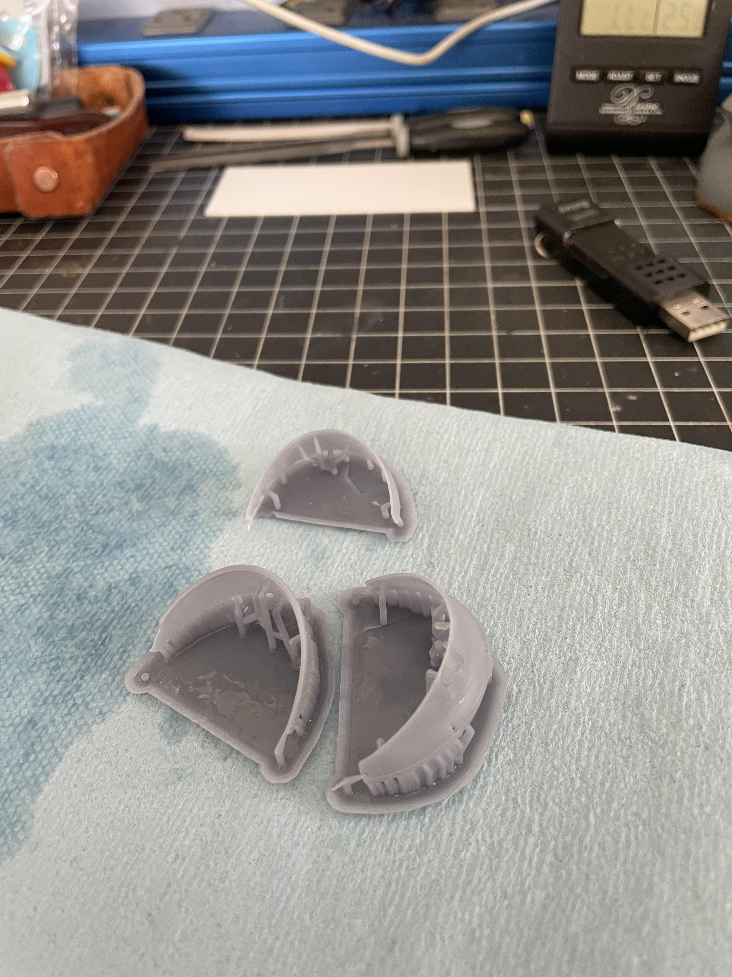

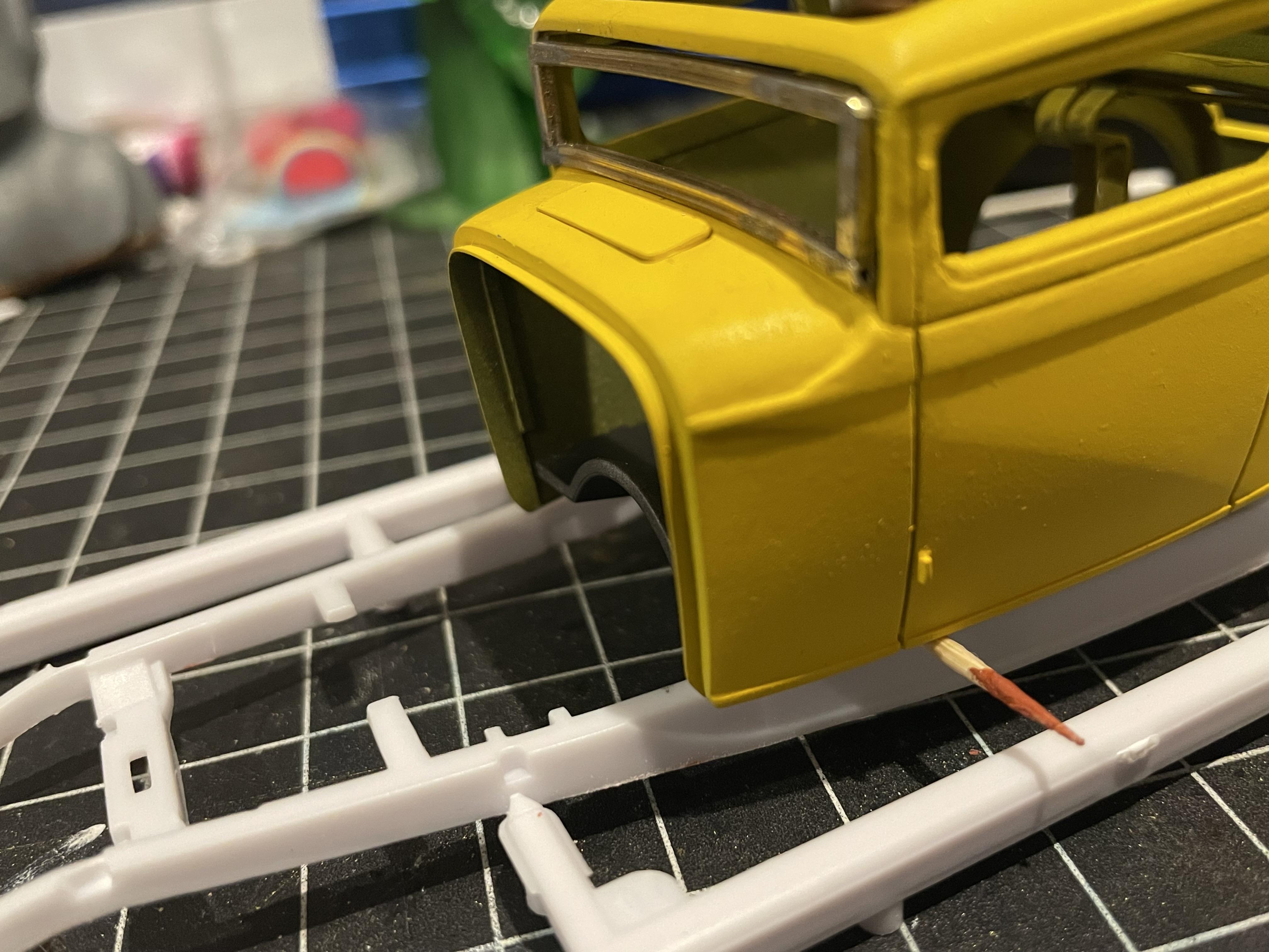

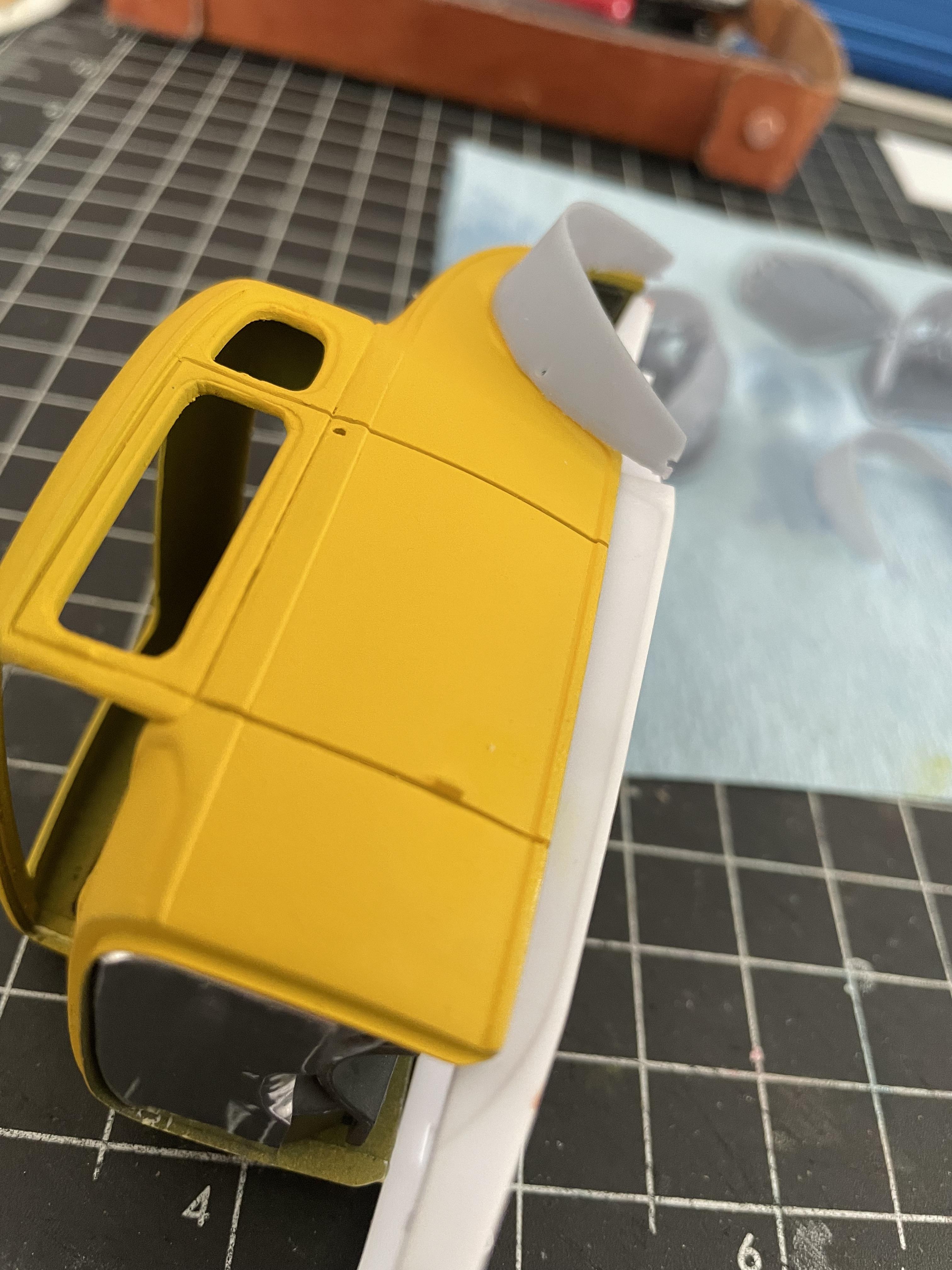

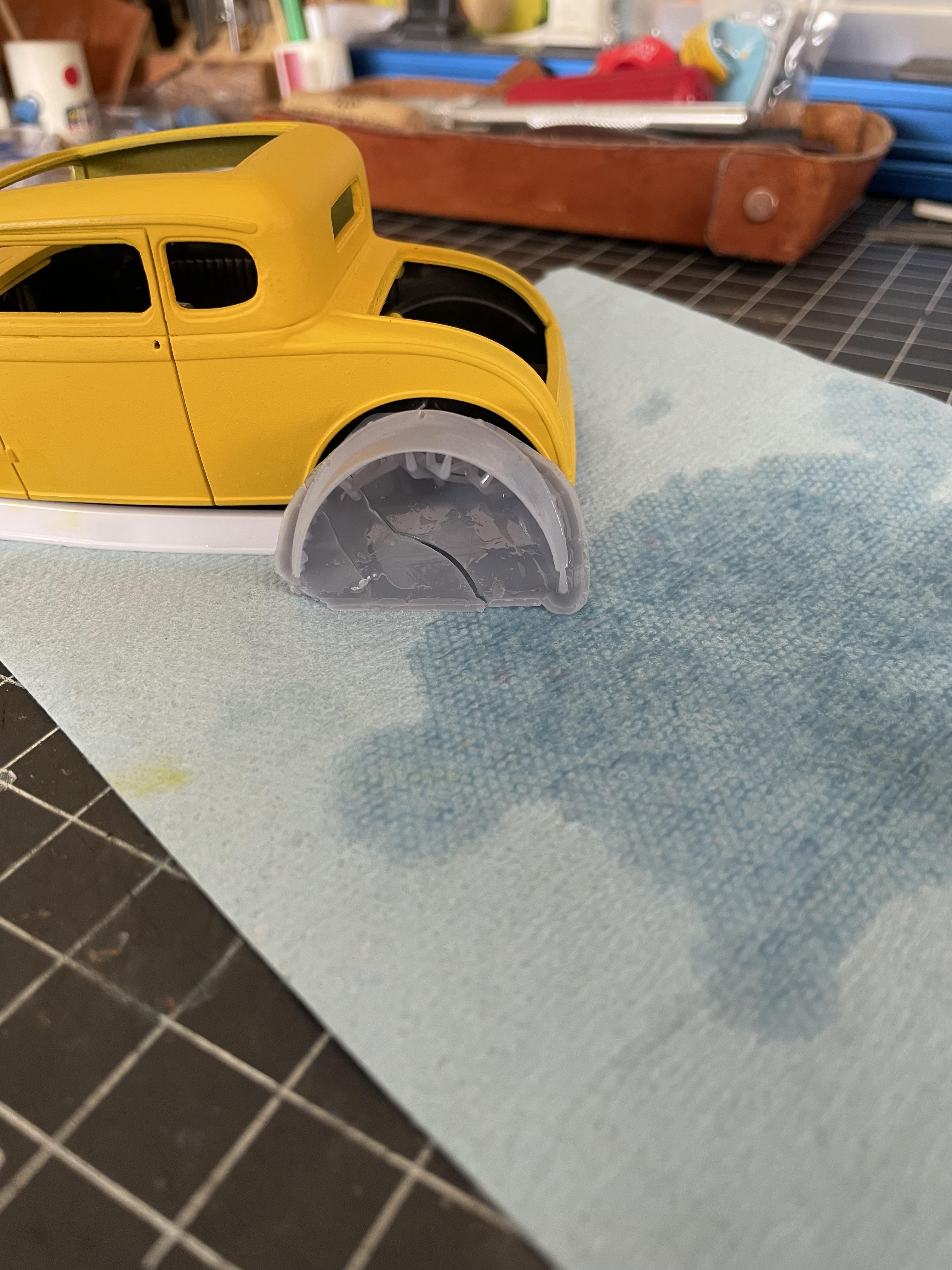

  1. These are cobbled together fenders from Revell Black Shadow motorcycle fenders Very fiddly

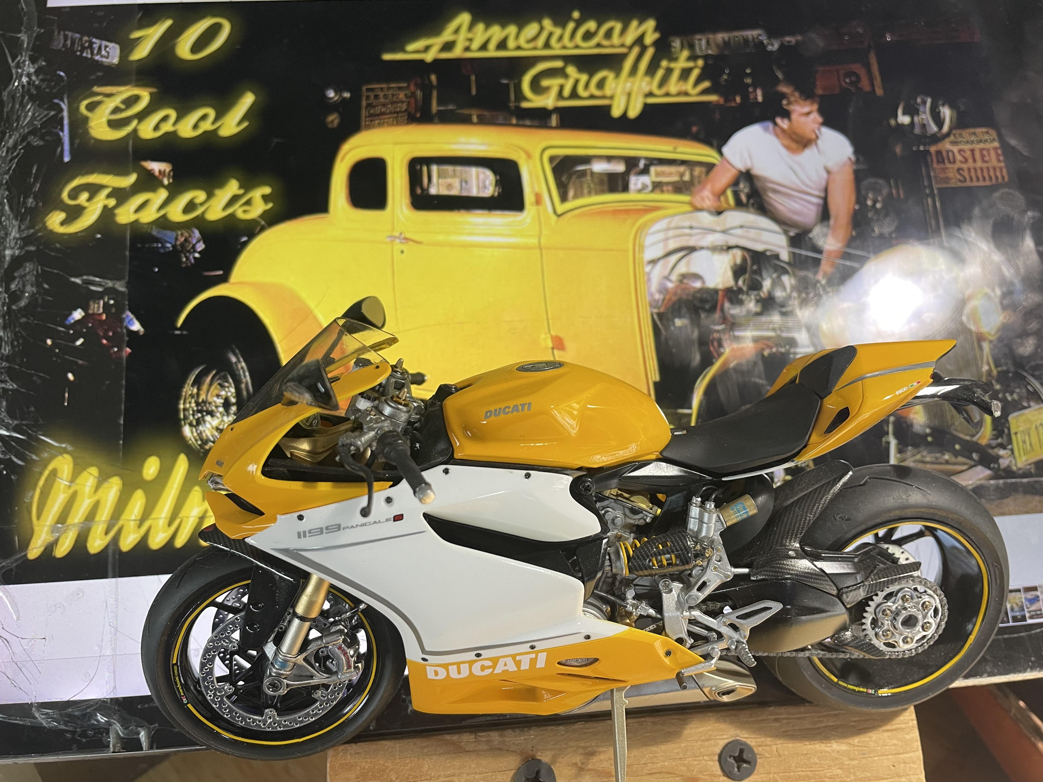

  4. That kit is $65 ordered online to my door $12.99 is an absolute steal. Love the red BTW 😎

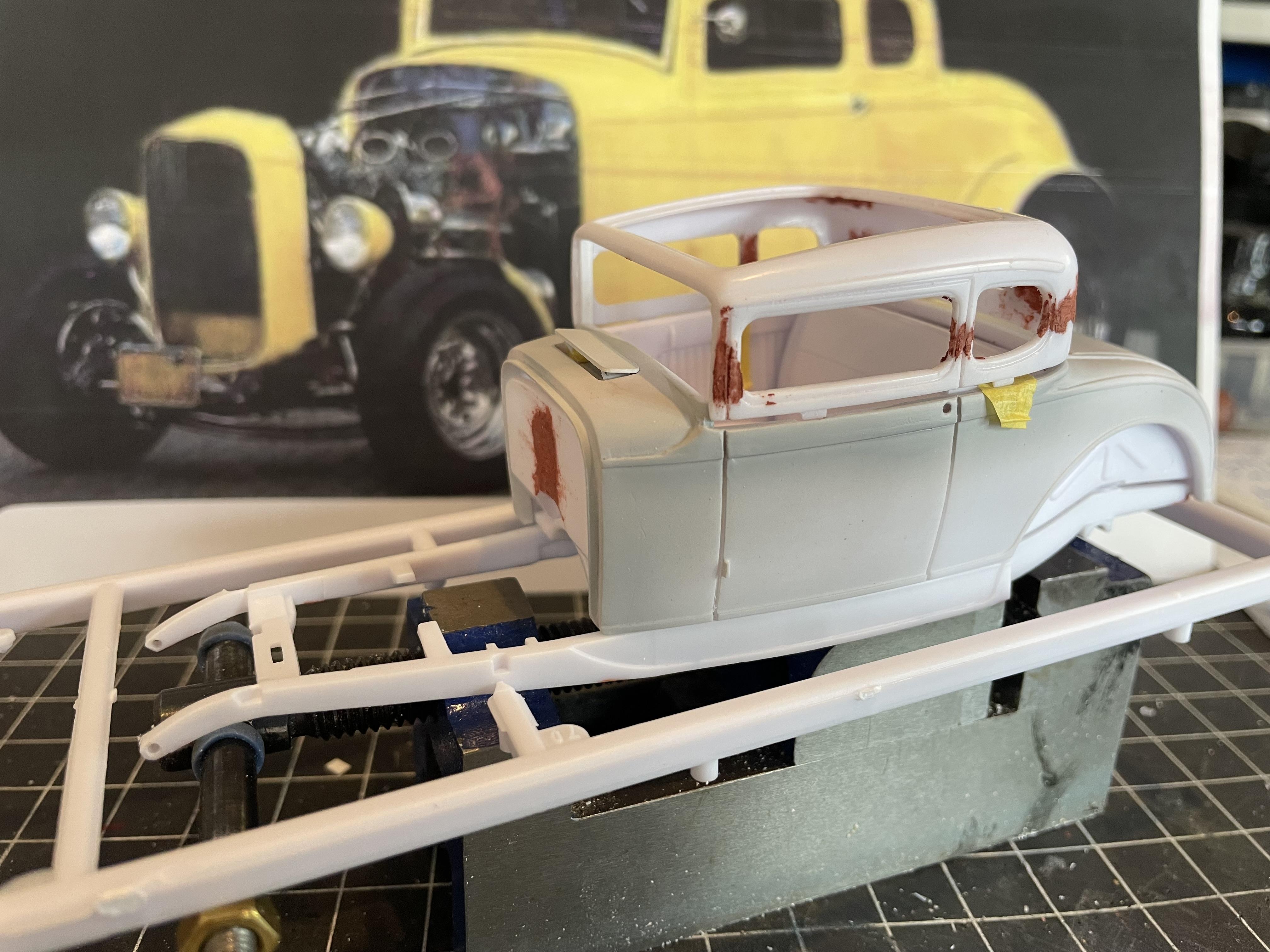

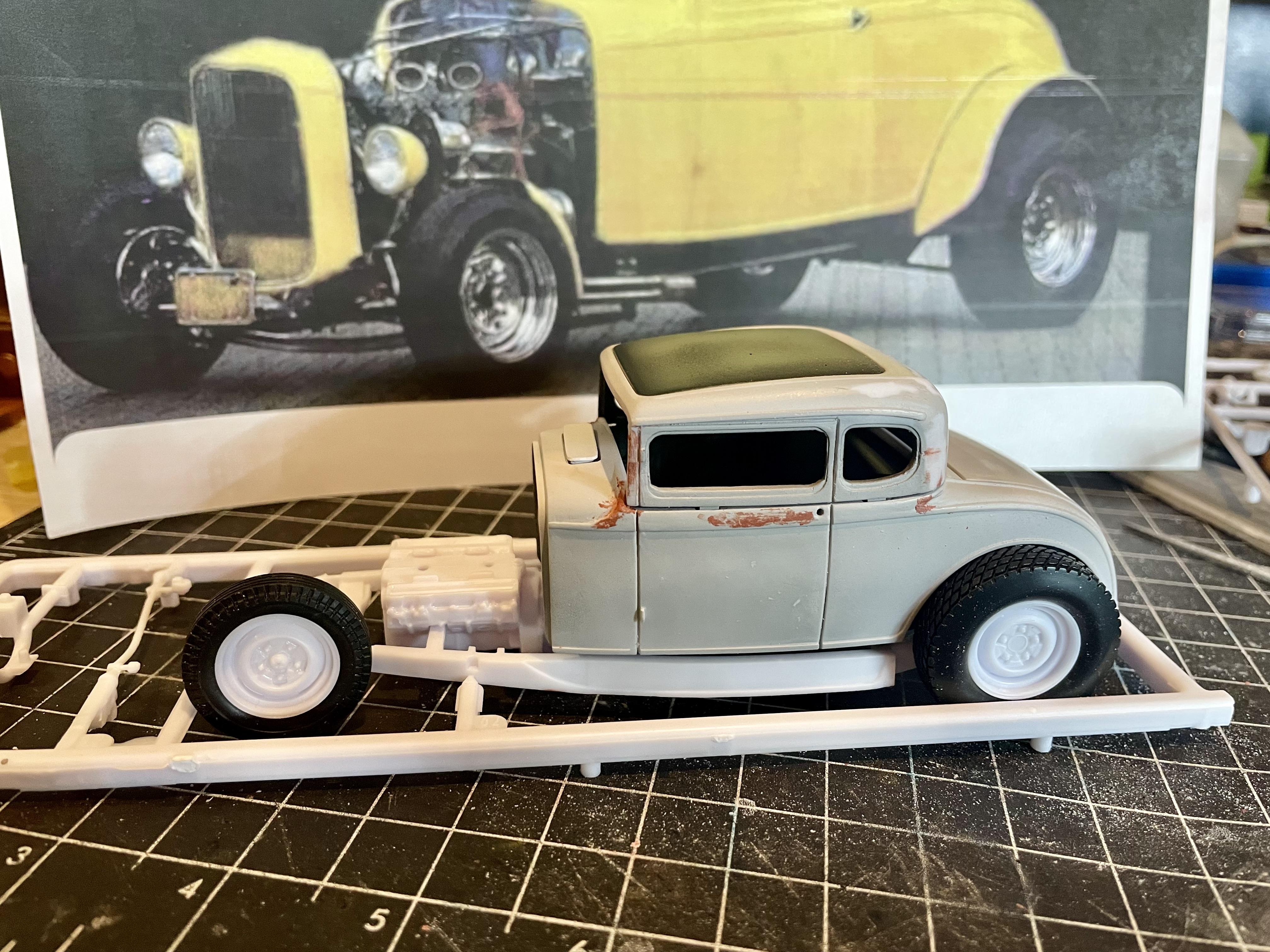

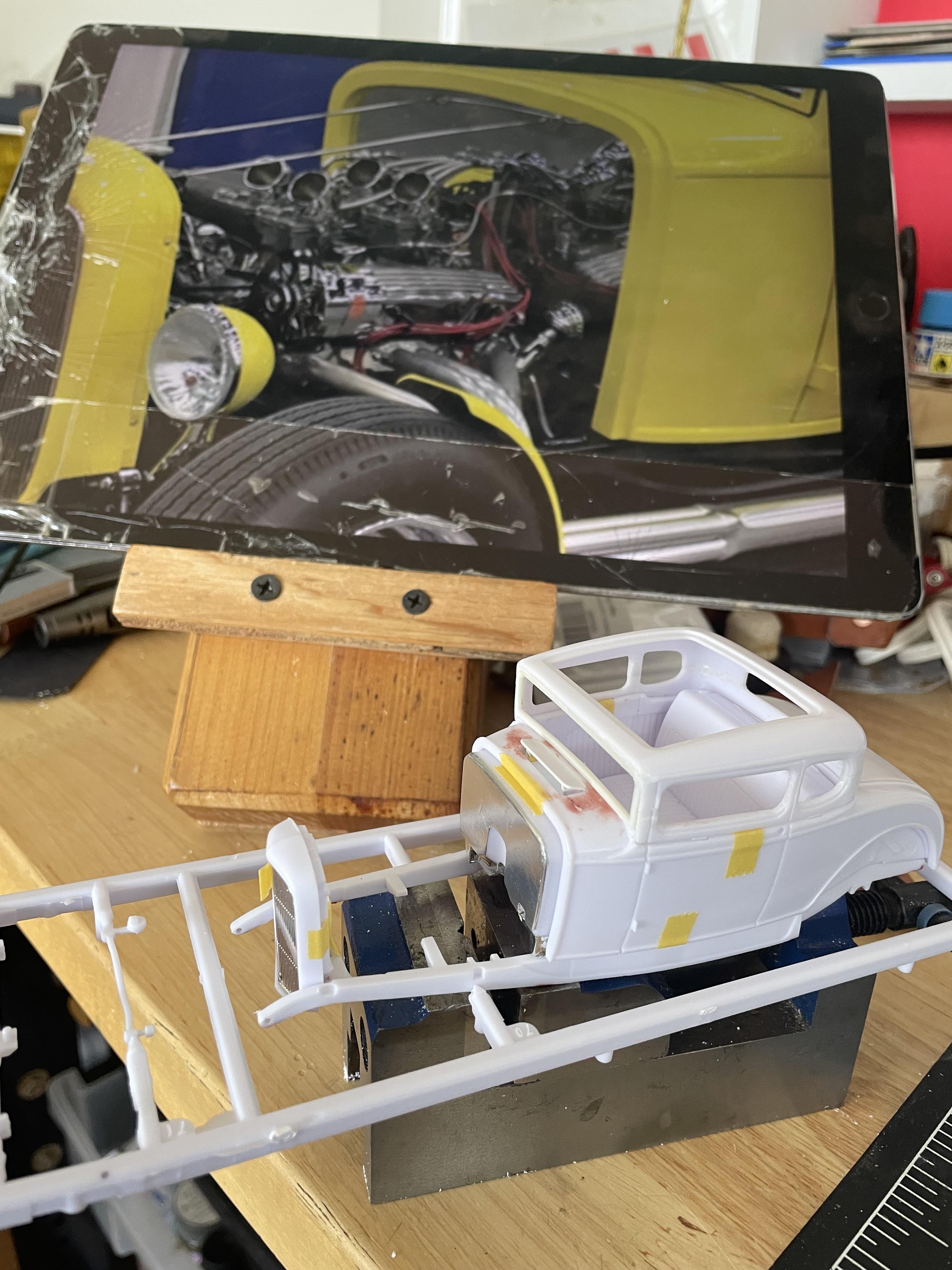

  5. In a long list of pipe dream projects, I came across this photo to inspire another build
  6. Getting close but still miles away from the finish line

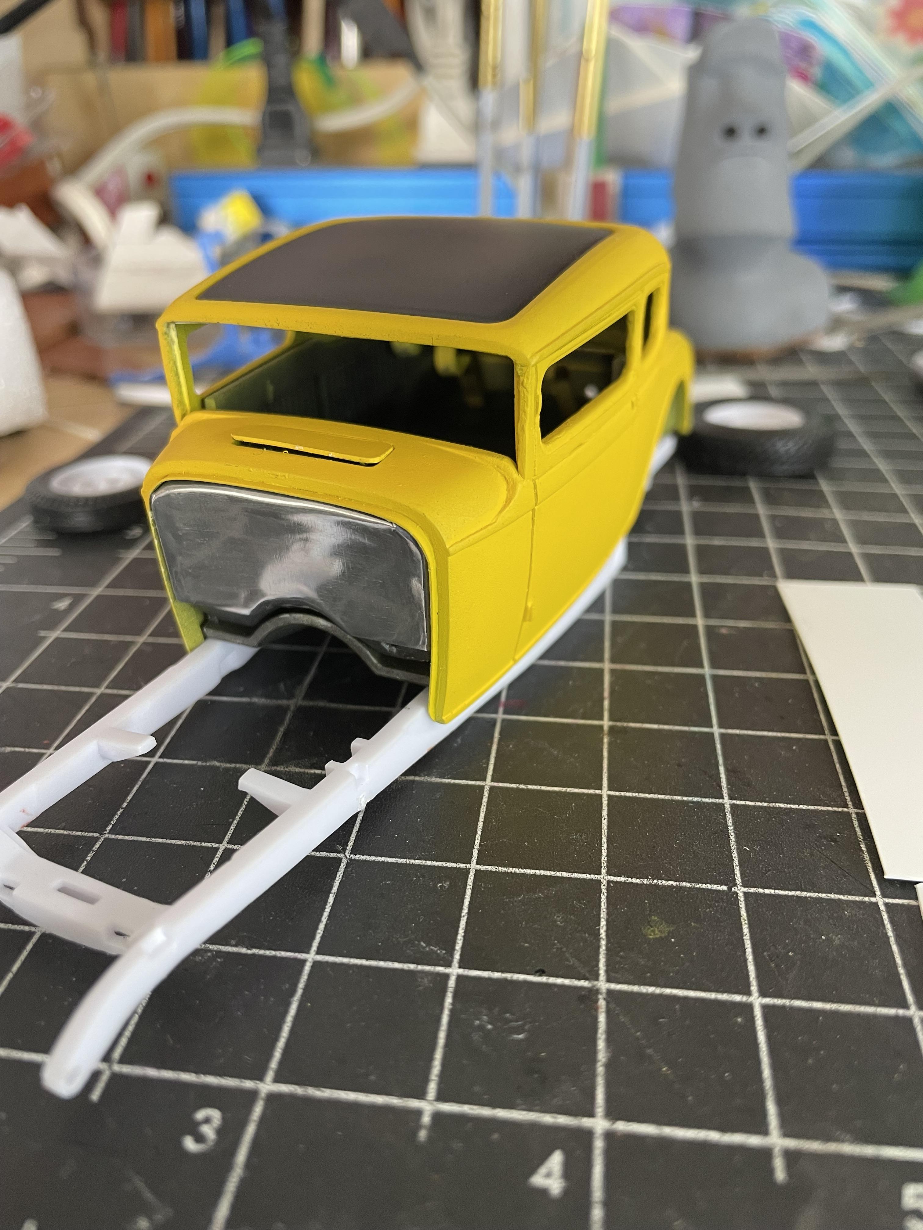

  7. I showed that way back before as well It is just fragile so needed to be done nearing the last steps so not wiped away or chipped I changed the fuzzy black around the windscreen too as it looked weird

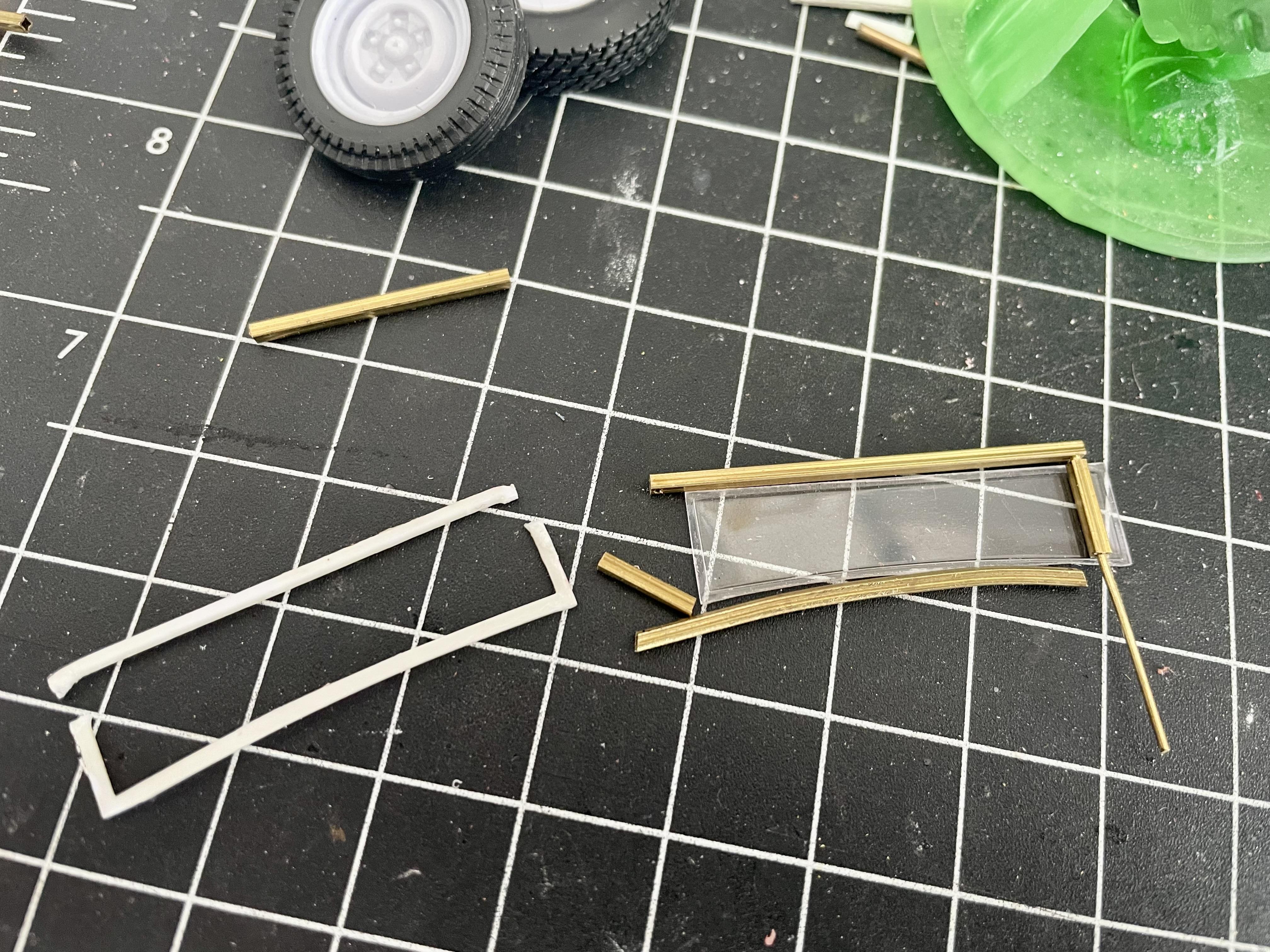

  9. Made new shocks for the front end to match the lowering Telescoping brass and soldered rounds saved the headlight mounts in styrene These will get Revell chromed some time today

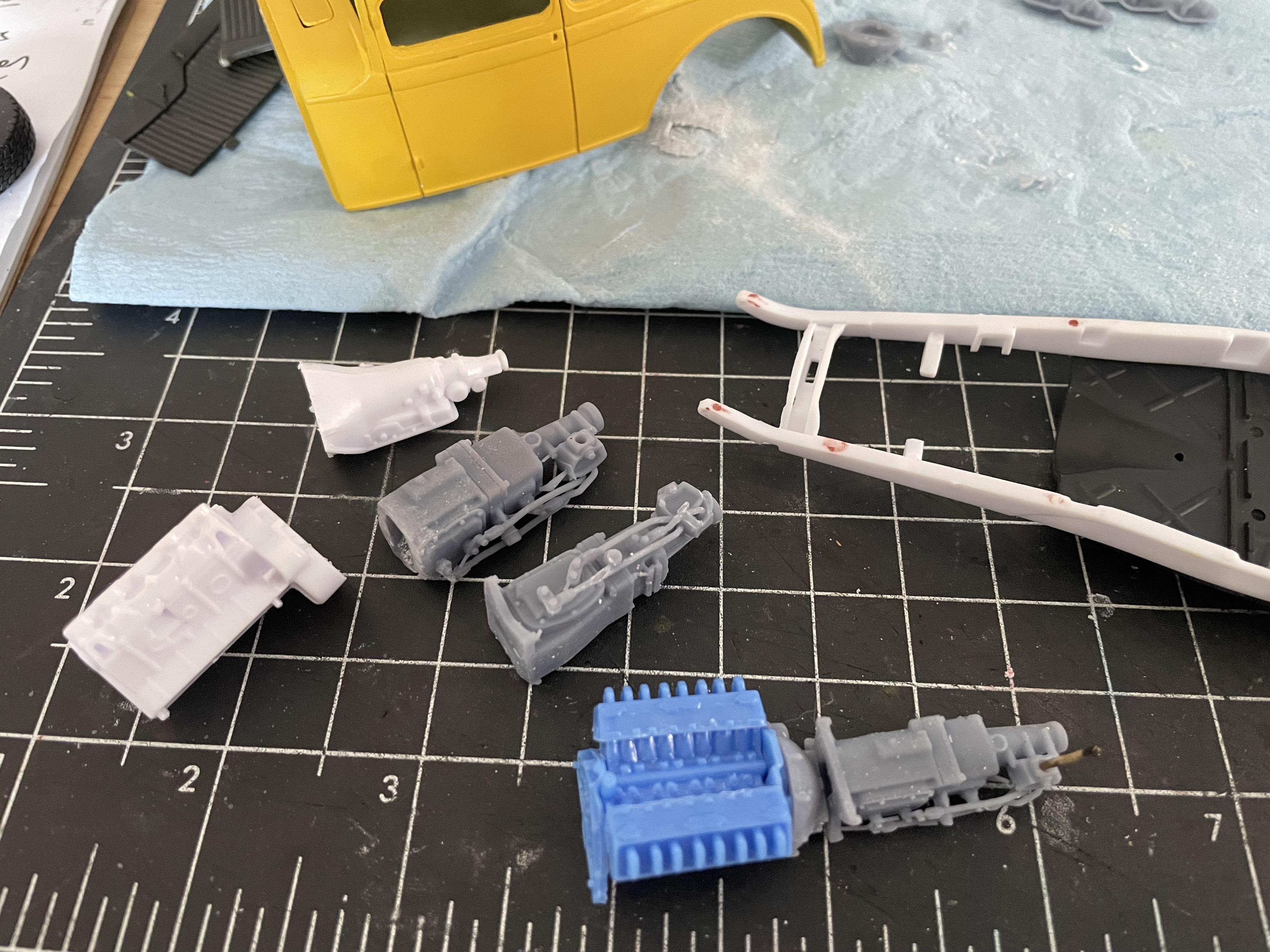

  10. Getting back on track with the engine and adding firewall details

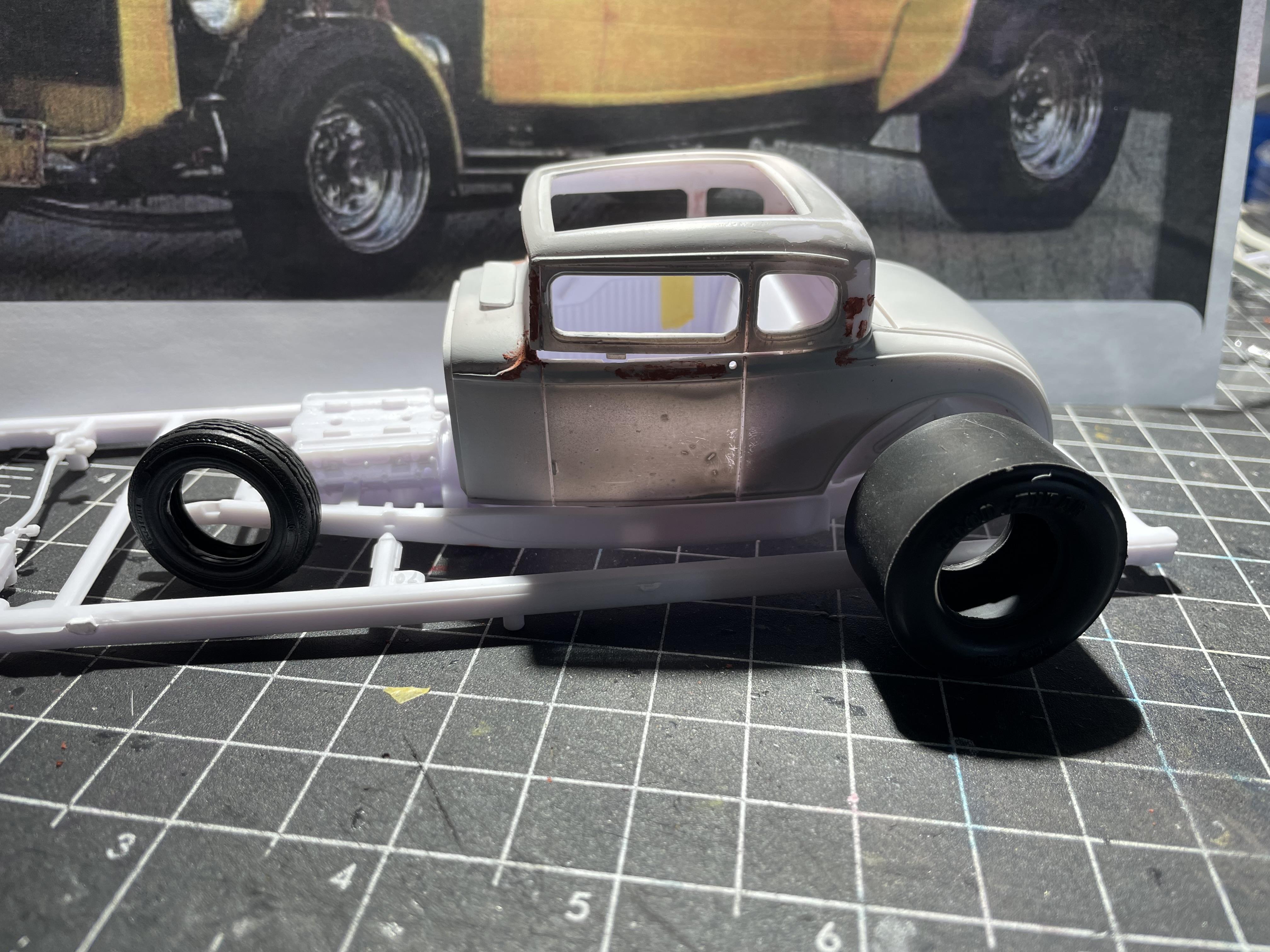

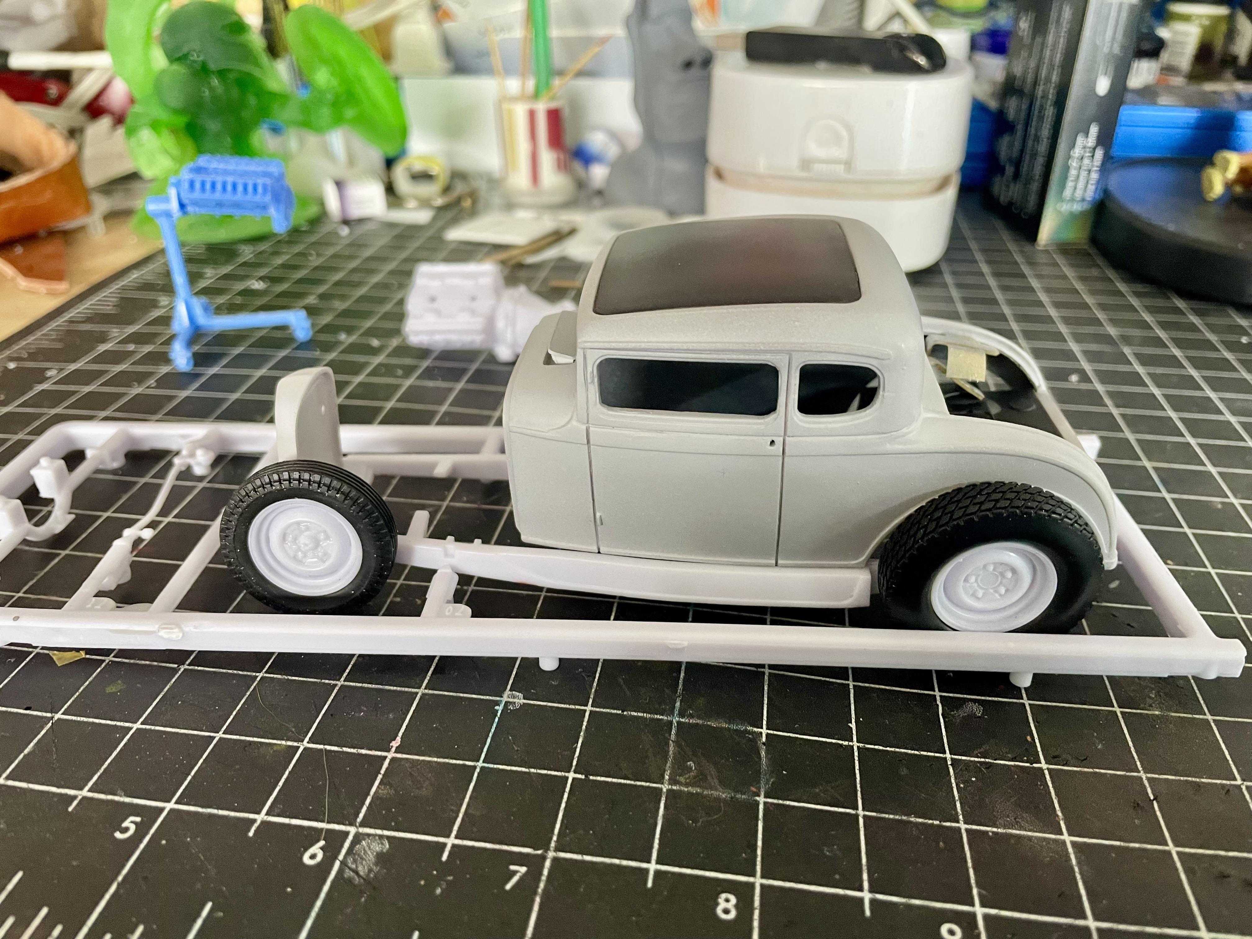

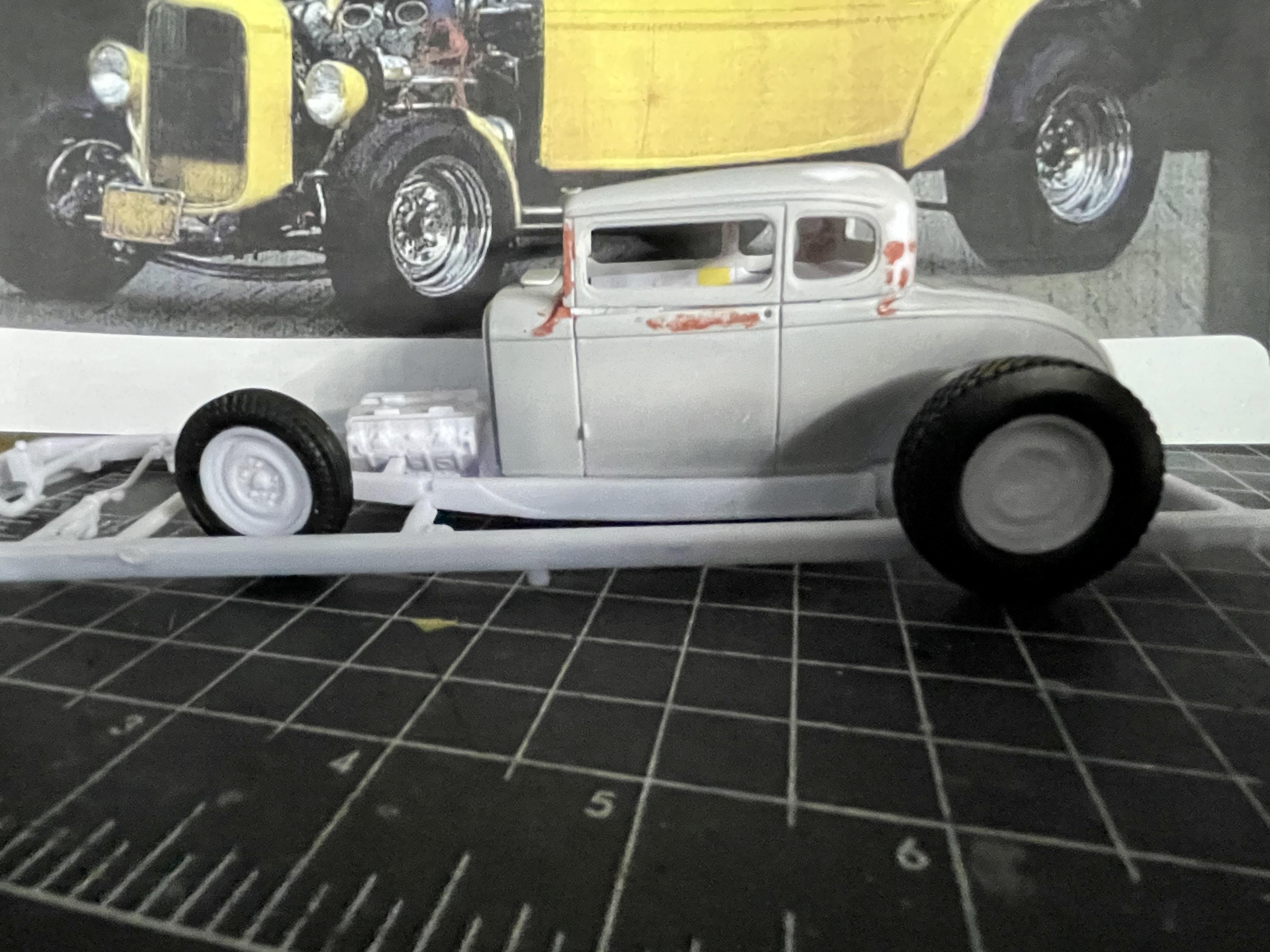

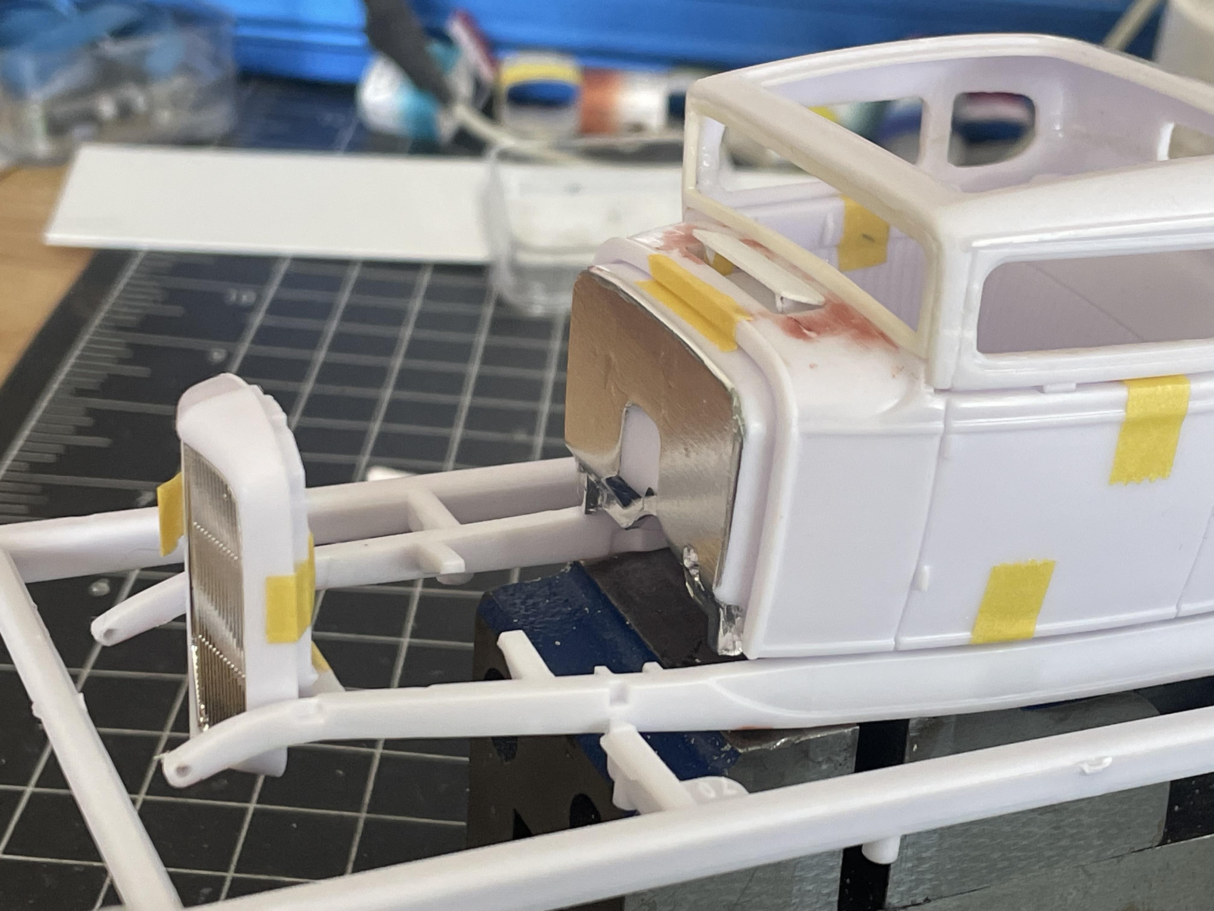

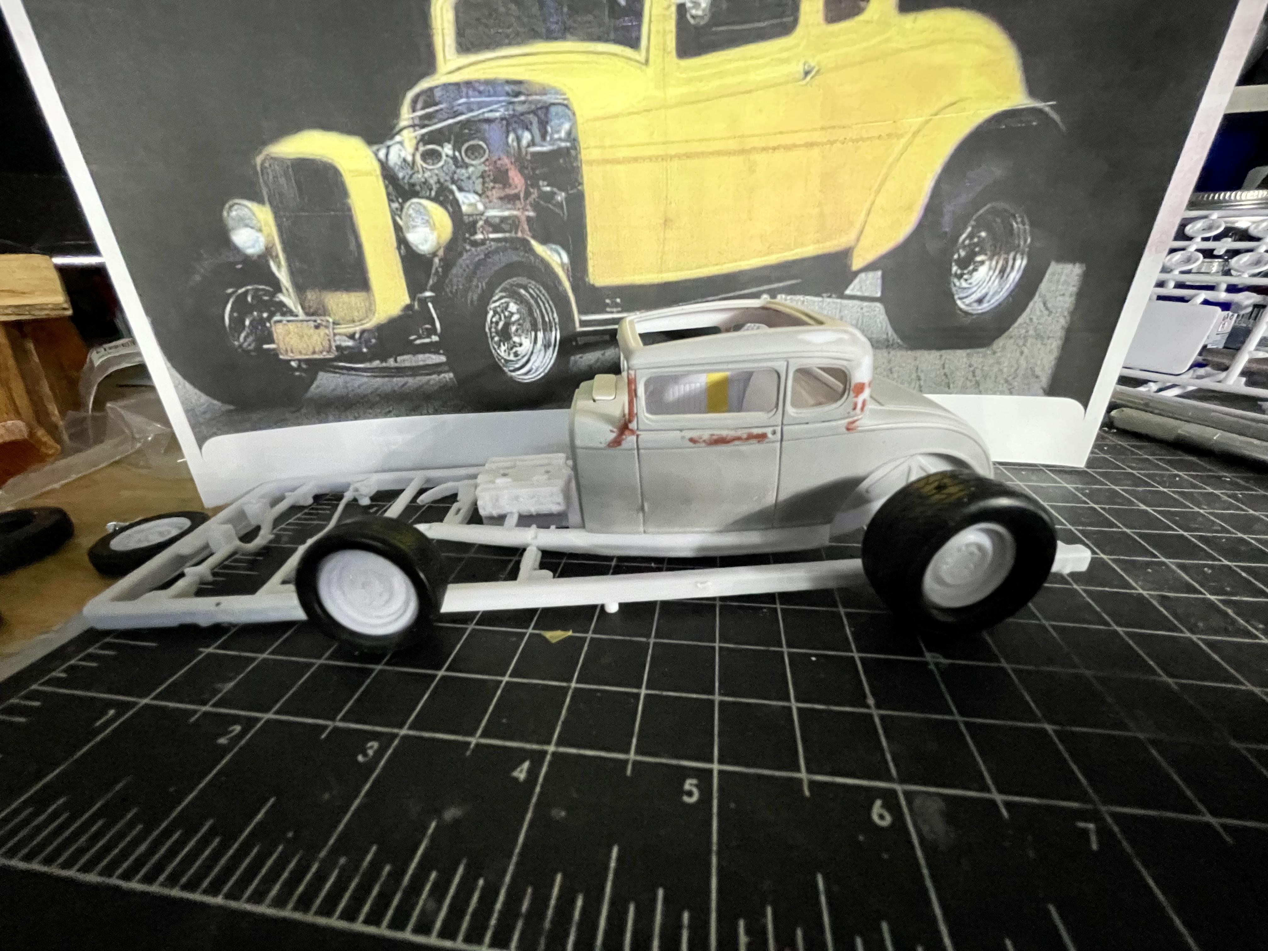

  11. Yes this is my process in pictures. Haven’t quite got the frame right yet

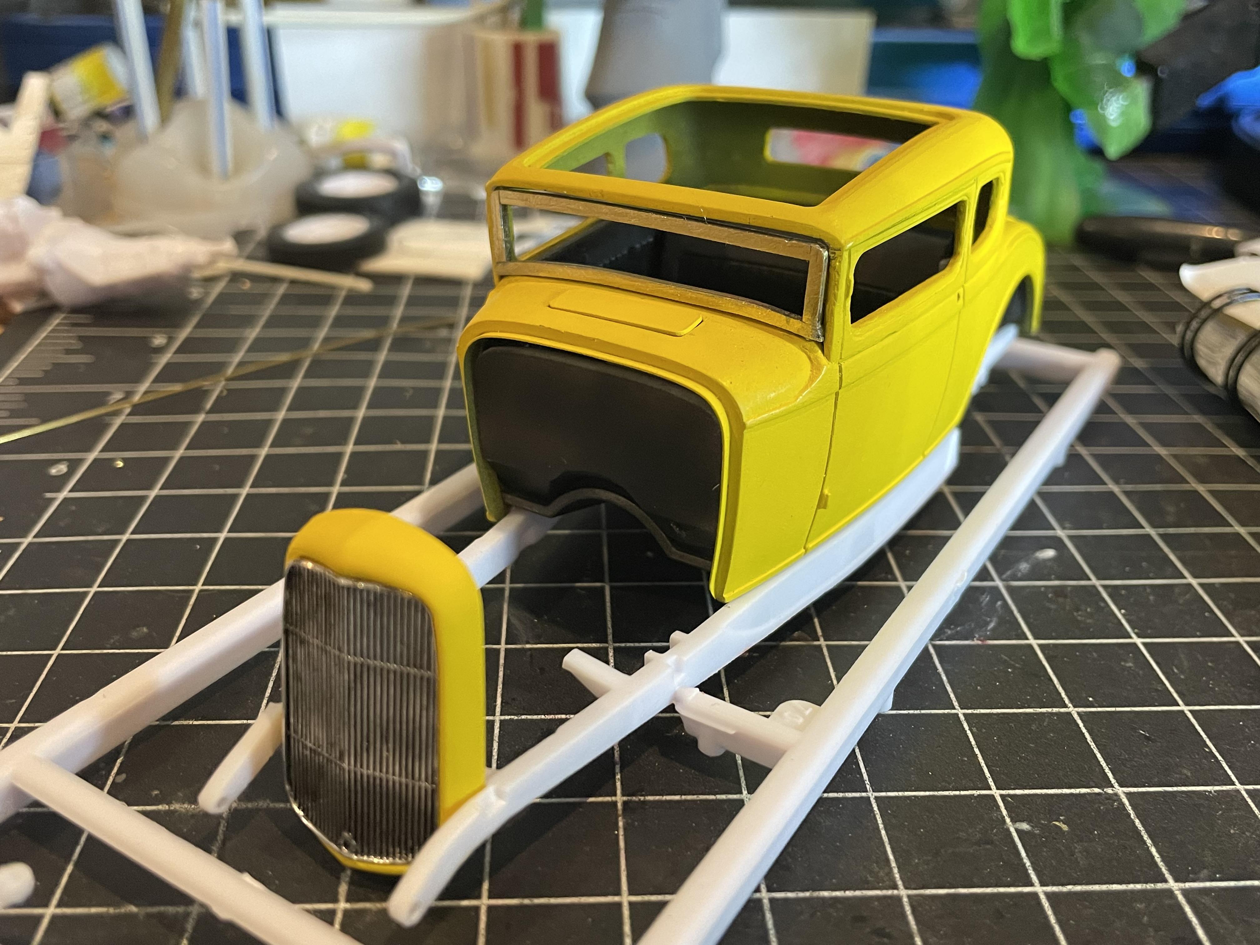

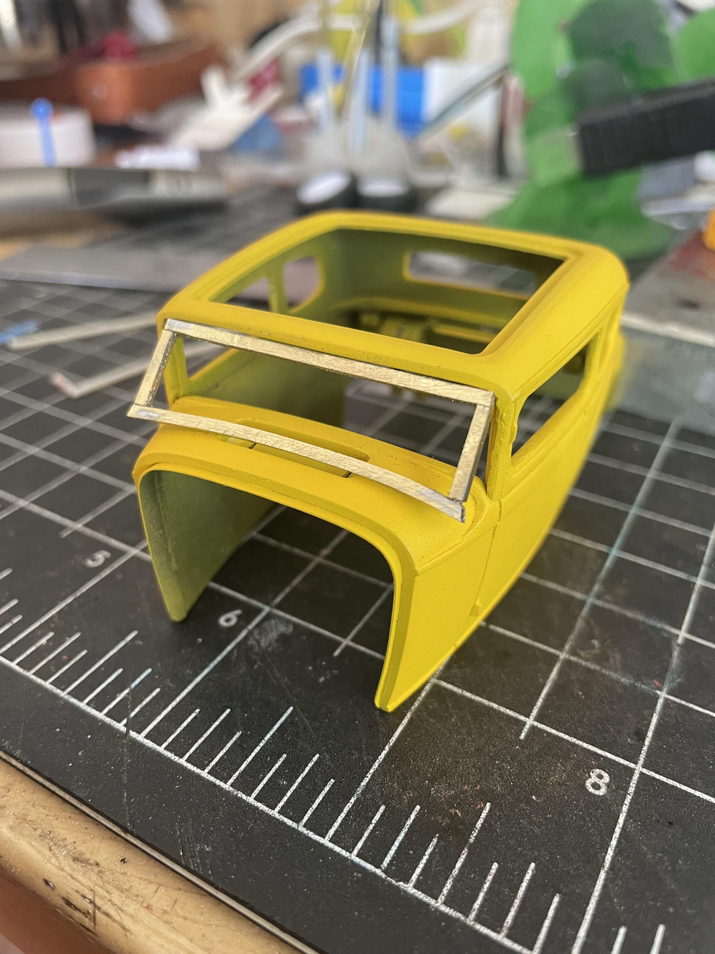

  12. Wasn’t digging the green. Switched it out for a tinted acrylic and I popped the hinged door off out of its support and broke the a pillar and one of the chop sections on the window frame
  13. Dashboard done and in Then some glass. I sprayed the kit glass Tamiya smoke which looks dark and cool….but the pieces fought me going in I remembered a birdie saying the glass was green tint and I have some acrylic sprayed different clears so green it is. A good complementary colour with yelliw I am still quite a ways off from finishing and there are lots of bits and boogers to tidy up

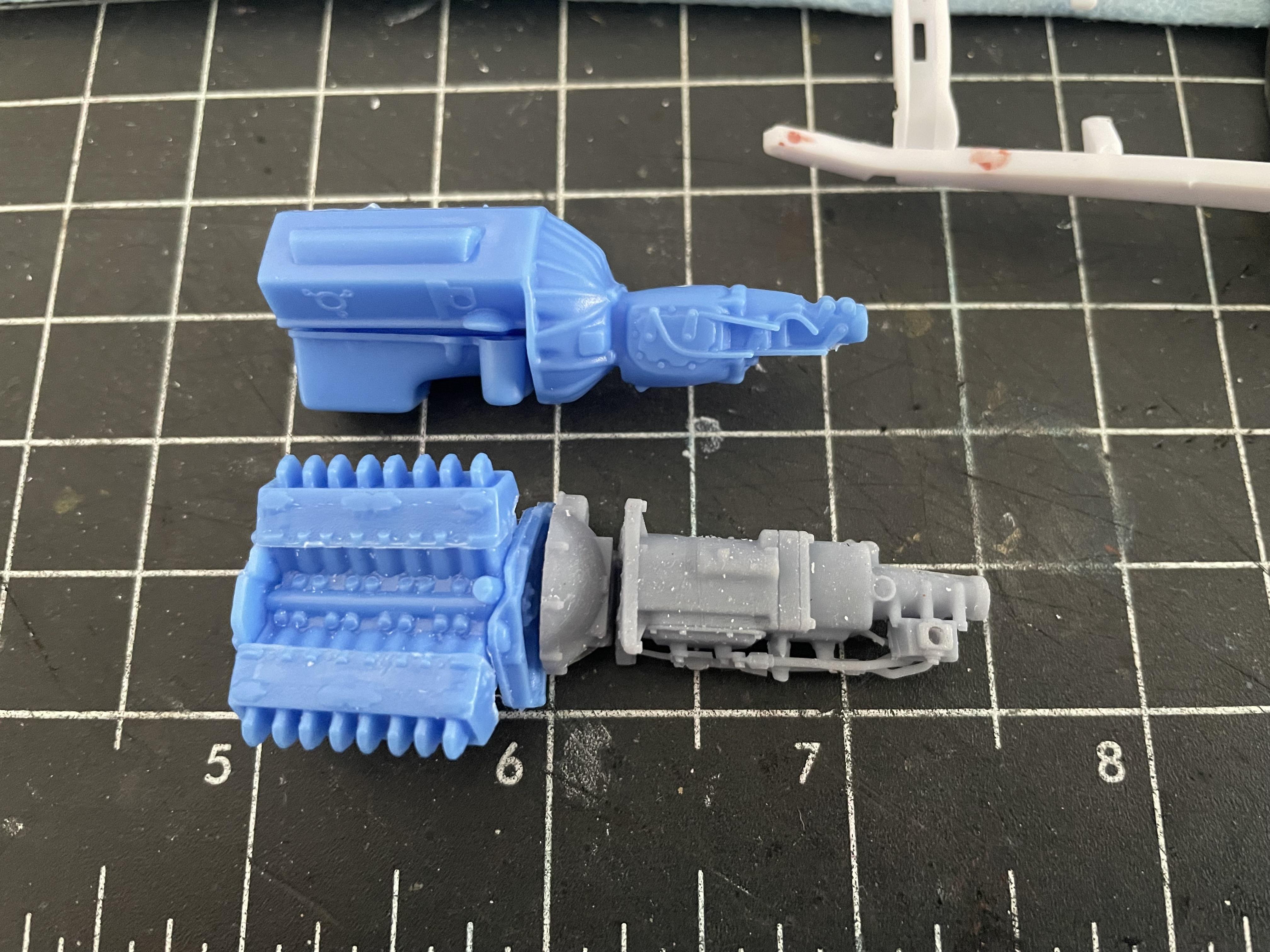

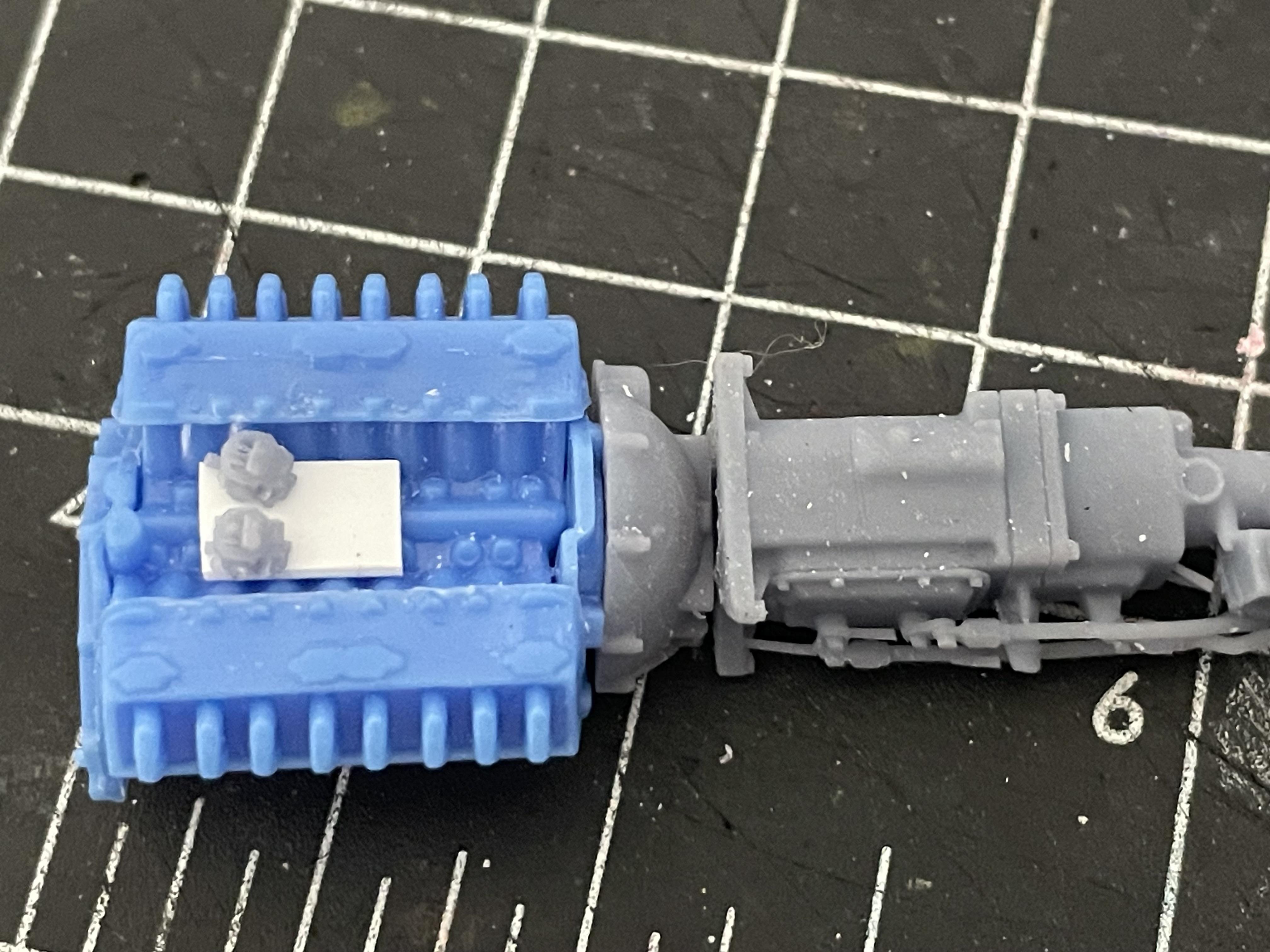

  15. Bit of an engine tear down to fit a brass alternator support Was having a hard time stabilizing it until saw this reference. The resin printed supports were too weak, the brass one screws into the block Tore it all back off and got some Revell chrome paint done, will be a couple days to dry solid. Now I hope to get back on track.

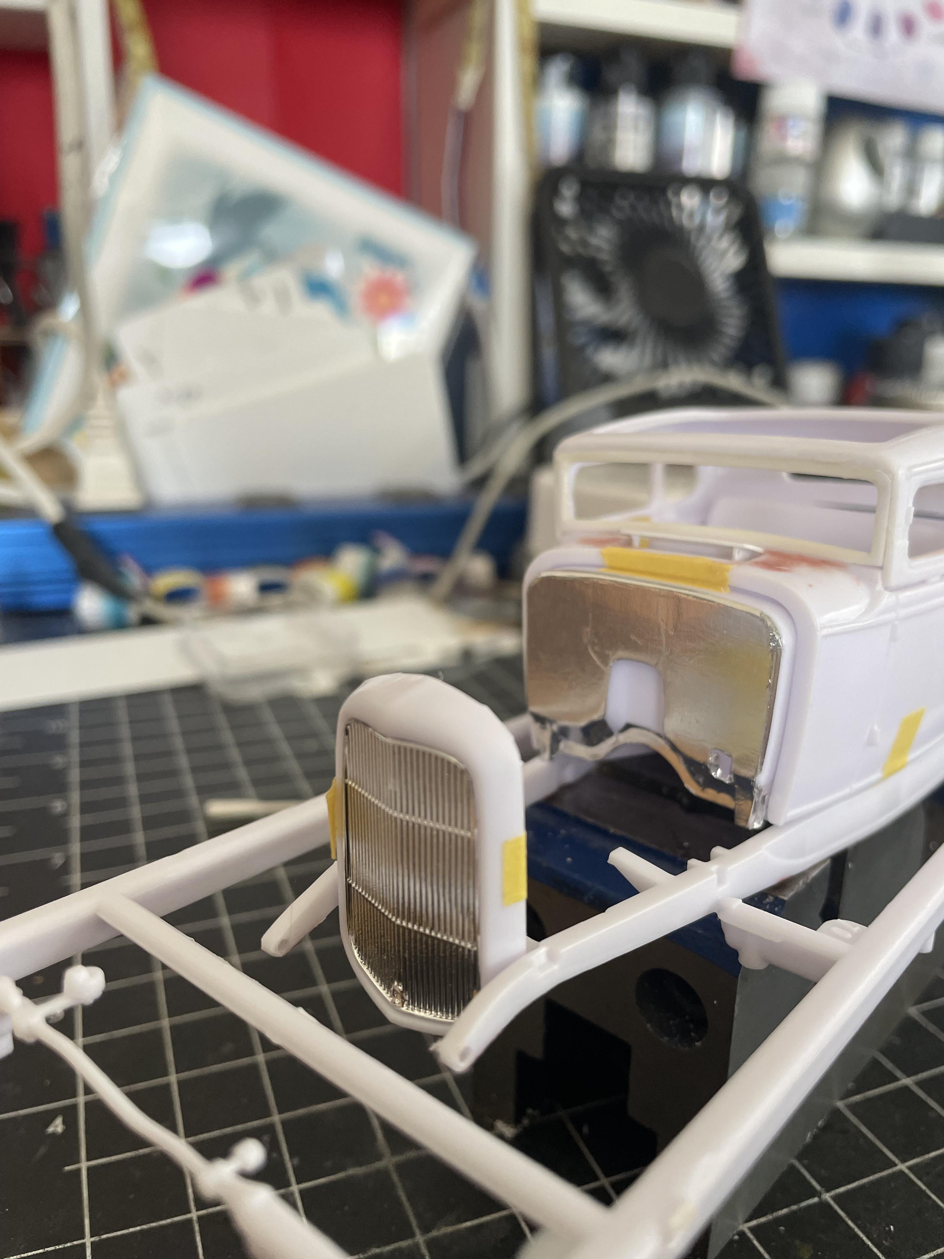

  18. Great idea Will cut the plate off the block and try that aluminum wrap for the frame…I have some thin pop can or shim stock to try 👍🏻😎

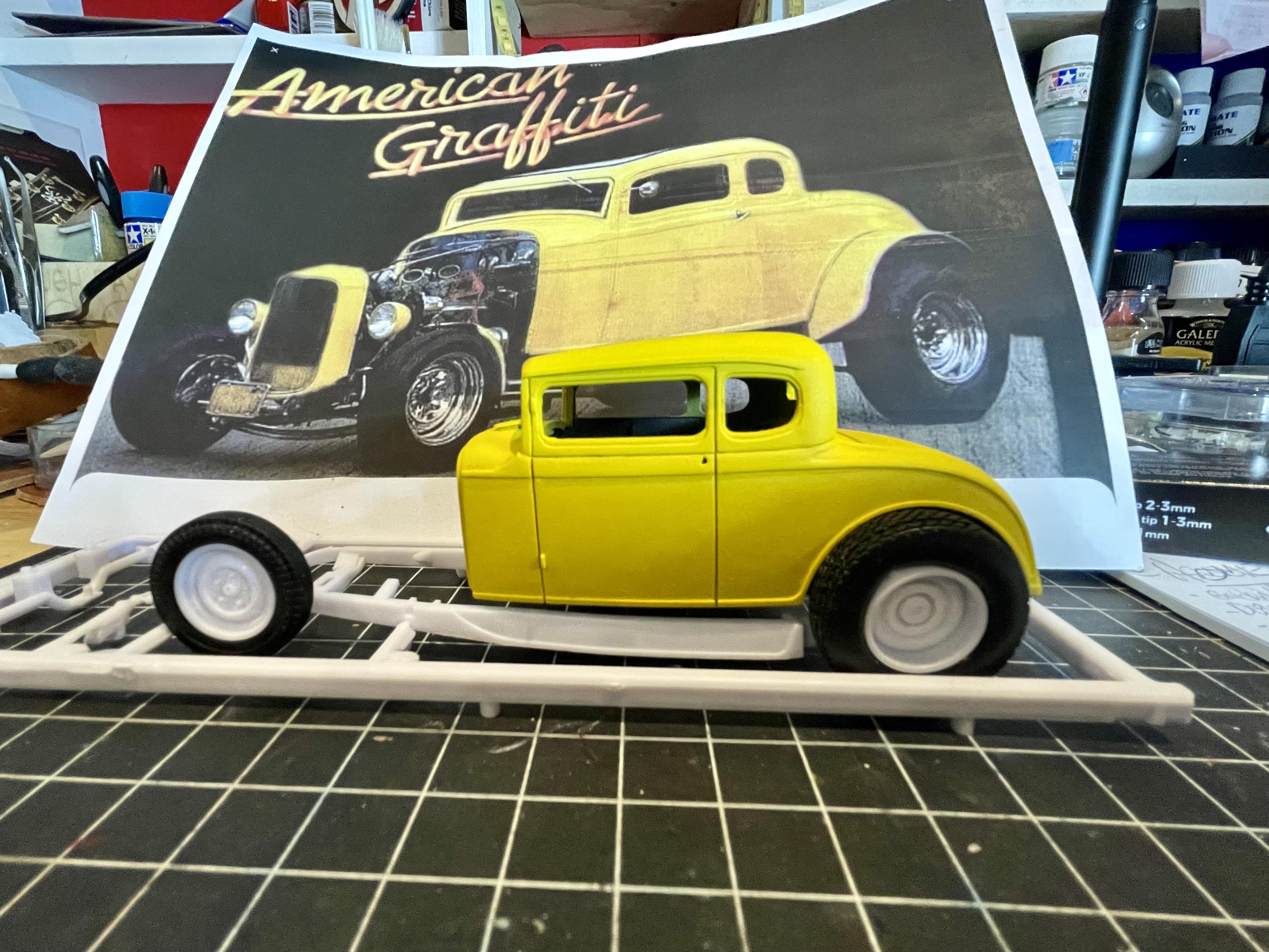

  21. One tried on the car. I think the paint colour nailed it. super hard to get that script right
