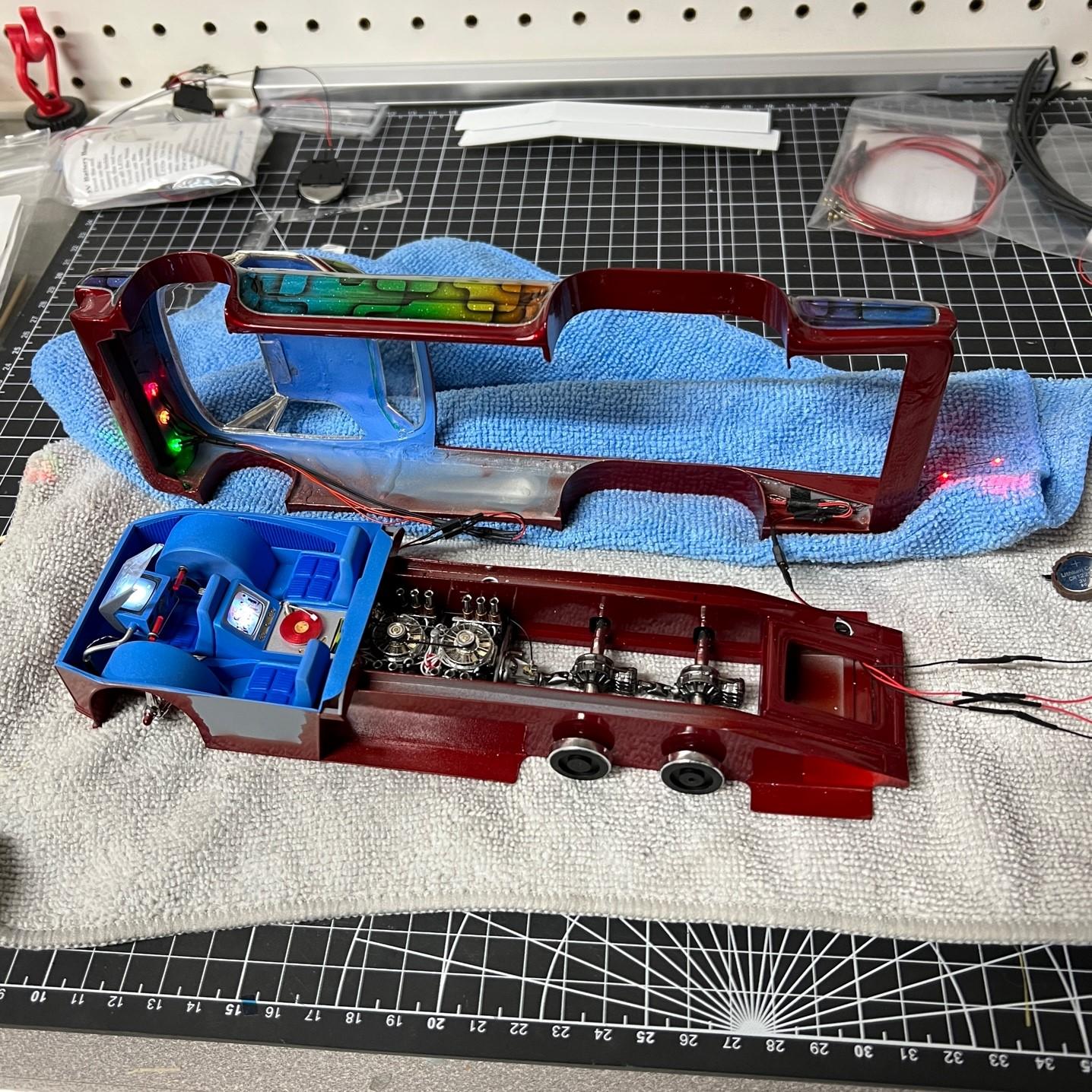

Thanks guys! The first show went very very well! A little issue did pop up... the battery life on the headlamp/tail lamp battery was not so great. While it somewhat stayed lit all day within a couple hours the color bar effect had dwindled to flashing off and on and only the red color working. (I assume this has something to do with each color frequency demanding more power to produce the color light, I think?... I'm not sure, its over my head) I still had room for one of the larger cells in the rear compartment, so when I got home from the show I swapped out the batteries and rewired. Now the larger cell operates the Head/Tail and the smaller is for the flickering interior screens. Initial tests seem better, we shall see how it holds up Sunday in Detroit! So last night I started playing with dragsters... I scoured the vendor side of the Columbus show looking for a Hemi-Sphere/Garlits dragster, or the Tommy Ivo FED with absolutely no luck. There was a nice build up of the Tommy Ivo kit there, and I realized the length of the rear body work is probably a bit long, as well as the overall length being way-way too long. So I returned home empty handed and started cutting up a "Young American" kit I had, figure I'll just fabricate the rear body work myself. First thing I realized is this is going to have to be pretty short... So I shortened the front body work, then pie cut it to narrow down the width, then angle cut the bottom off to make it a little more low profile, like my inspiration. (not going for any sort of replica, just trying to hit an era and look, gives me some freedom to be creative.) I did glue the windshield/cowl on too far back in this mock up, and that was resolved after the photos. And it actually fits! Lots more work to do.. but its a start!

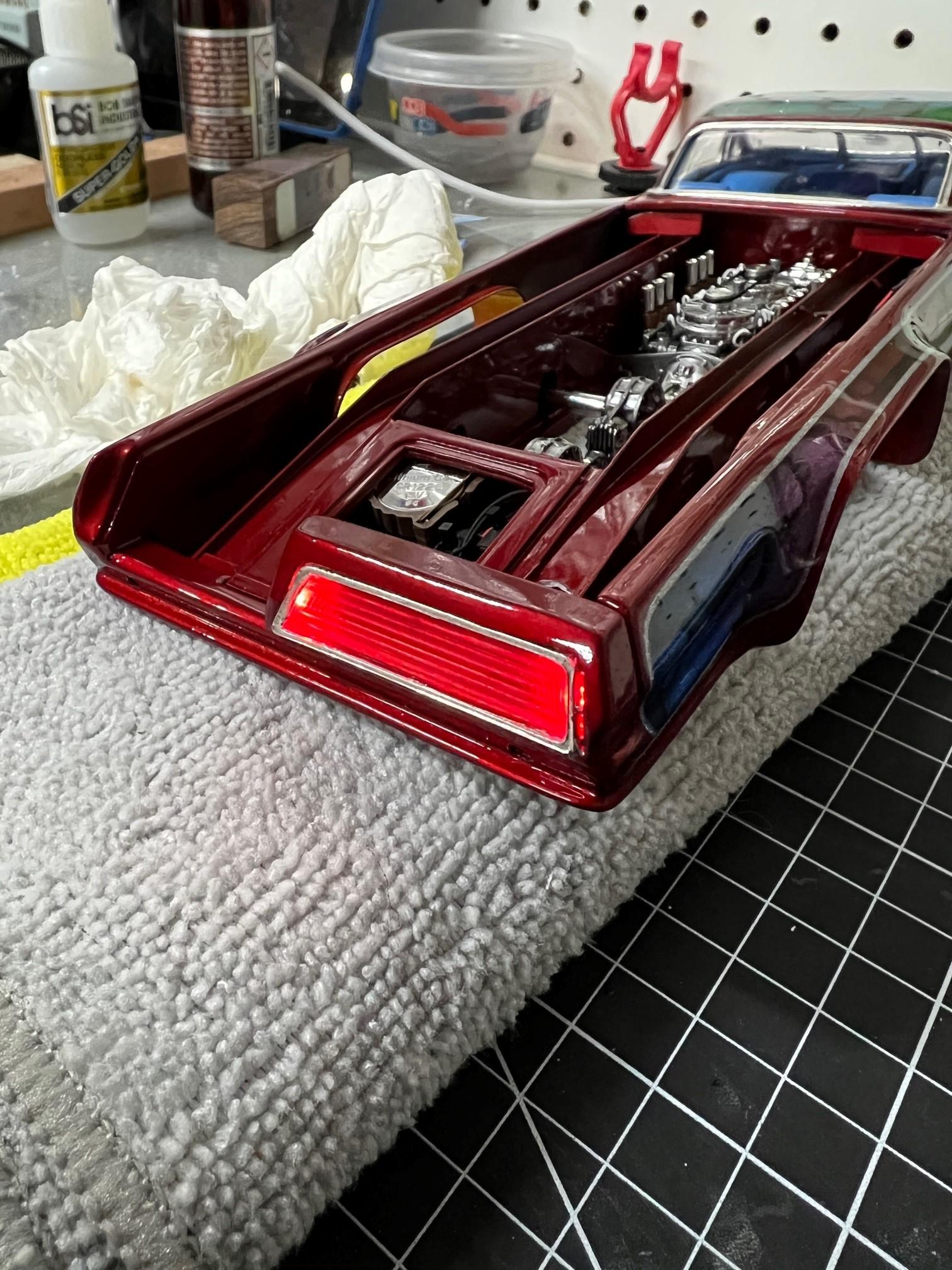

Plugging along... next Saturday is the contest and the list is getting shorter... Basically down to ramps, exhaust, headlamp lens... then permanently install the wheels and tires... oh and bumpers... I got them painted in Molotow chrome yesterday, but not in love with the finish.. My paint/ink may just be old... probably going to redo. Got all the BMF done, then started in on the wiring... Took a bit, but its all stashed away. I had to use two of the new smaller Lithium battery holders from Evans Design, One for the head and tail lamps, the other for the flickering interior screens. Seems to work okay so far. https://evandesigns.com/products/small-coin-cell-holder-with-separate-switch then worked on the tail light assembly and lens, these are two red "Pico" LEDS and boy are they tiny. The tailgate still swings up and has working lights, which was my goal/challenge. I made a ribbed styrene back panel and covered it with BMF, then put the lights on the edges to try and spread the light across somewhat. I used the same clear red film as the records to make the lens... but it looked a bit plain. https://evandesigns.com/products/chip-nano-pico-leds?variant=32158378885168 So I went ahead and used the scrapbook cutter to make an etched lens, and a .010 bezel... made it look a lot better and less plain.

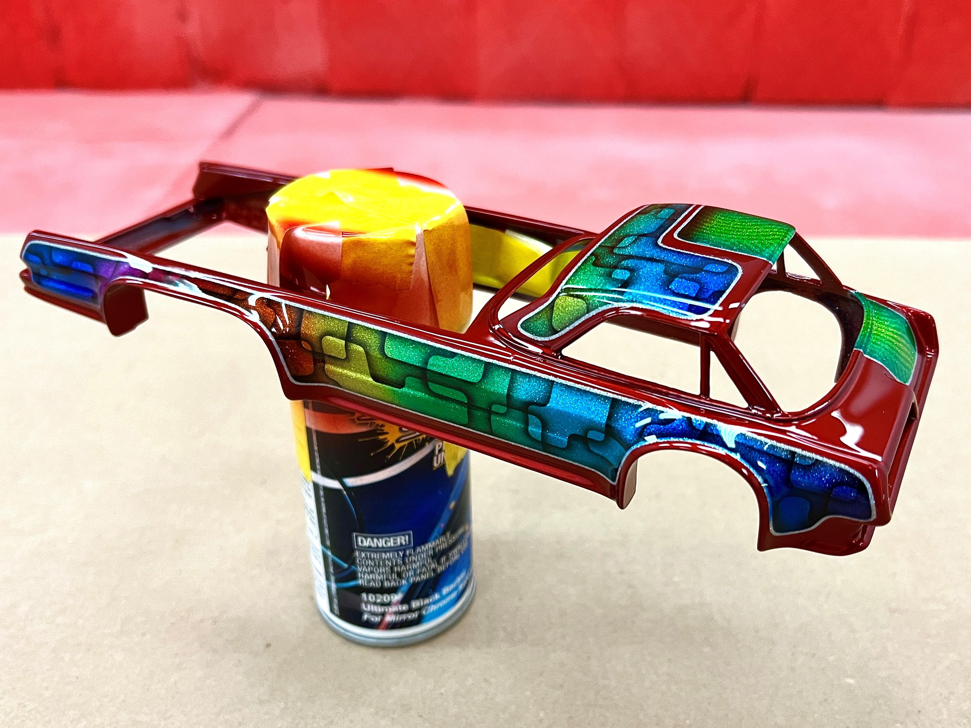

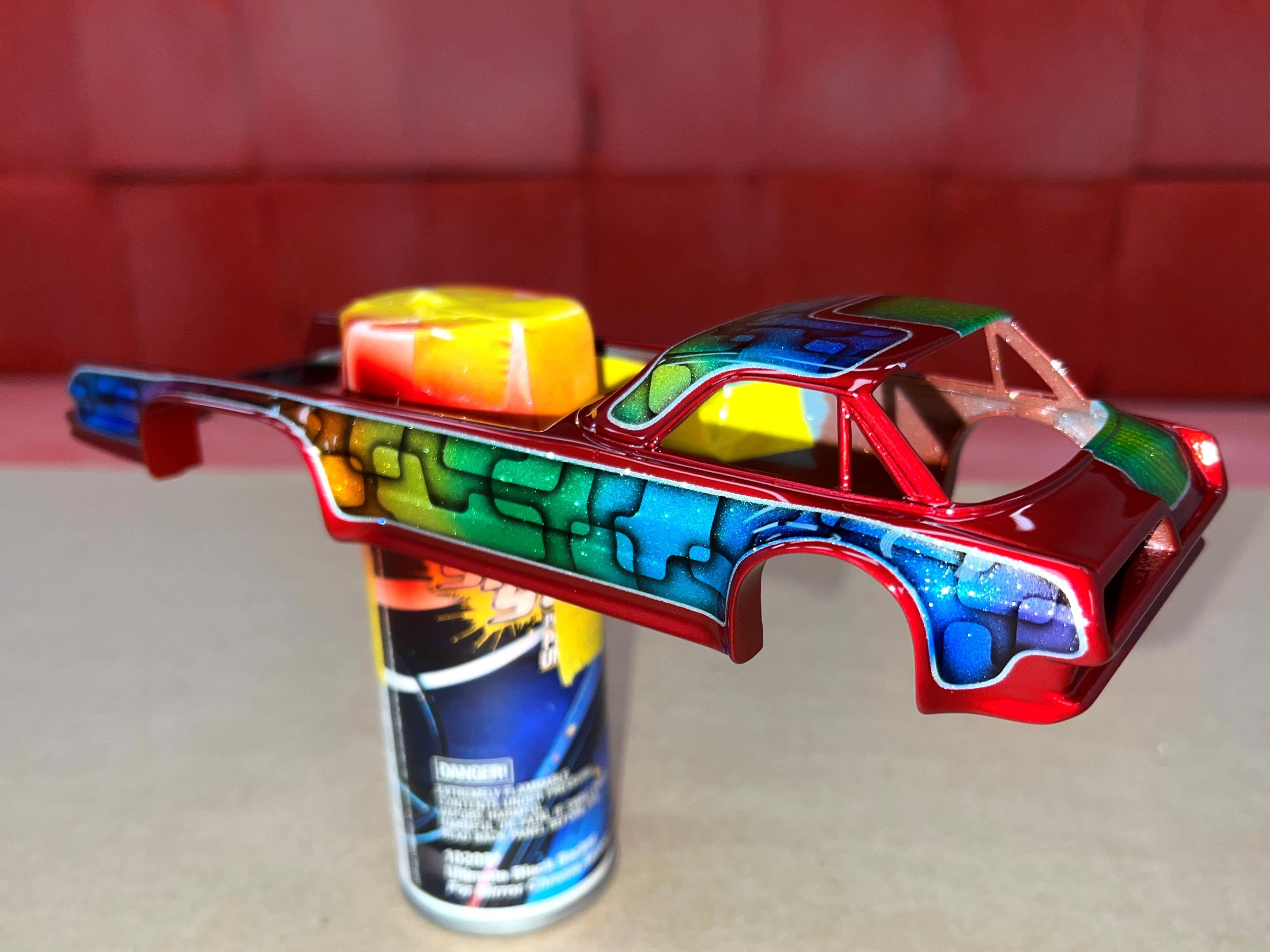

Remember this thing? I finally got back to the bench last night! Got it masked (again...?) I swear I have masked and unmasked this thing so many times now...haha. I had some extra time before bed so I did the little contrast-y panel on the front and top. I used old leftover fingerprint vinyl masks from my Gremlin, then sprayed Splash Paints Kandy Green. Then I removed the mask and sprayed Kandy yellow, Kandy green and Kandy Teal working from the inside out Splash Paints Kandys Hopefully getting the rest of it painted this week! Then finally no more masking... just BMF ??
