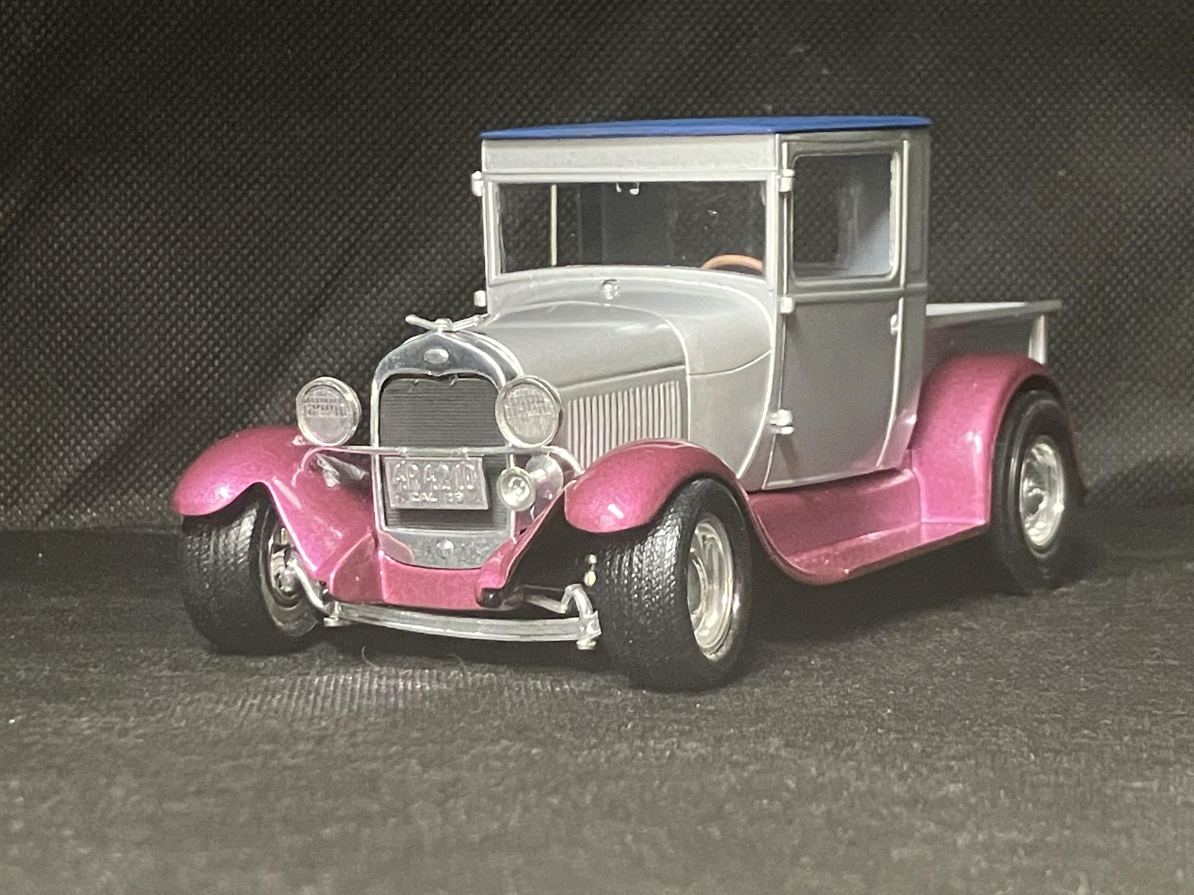

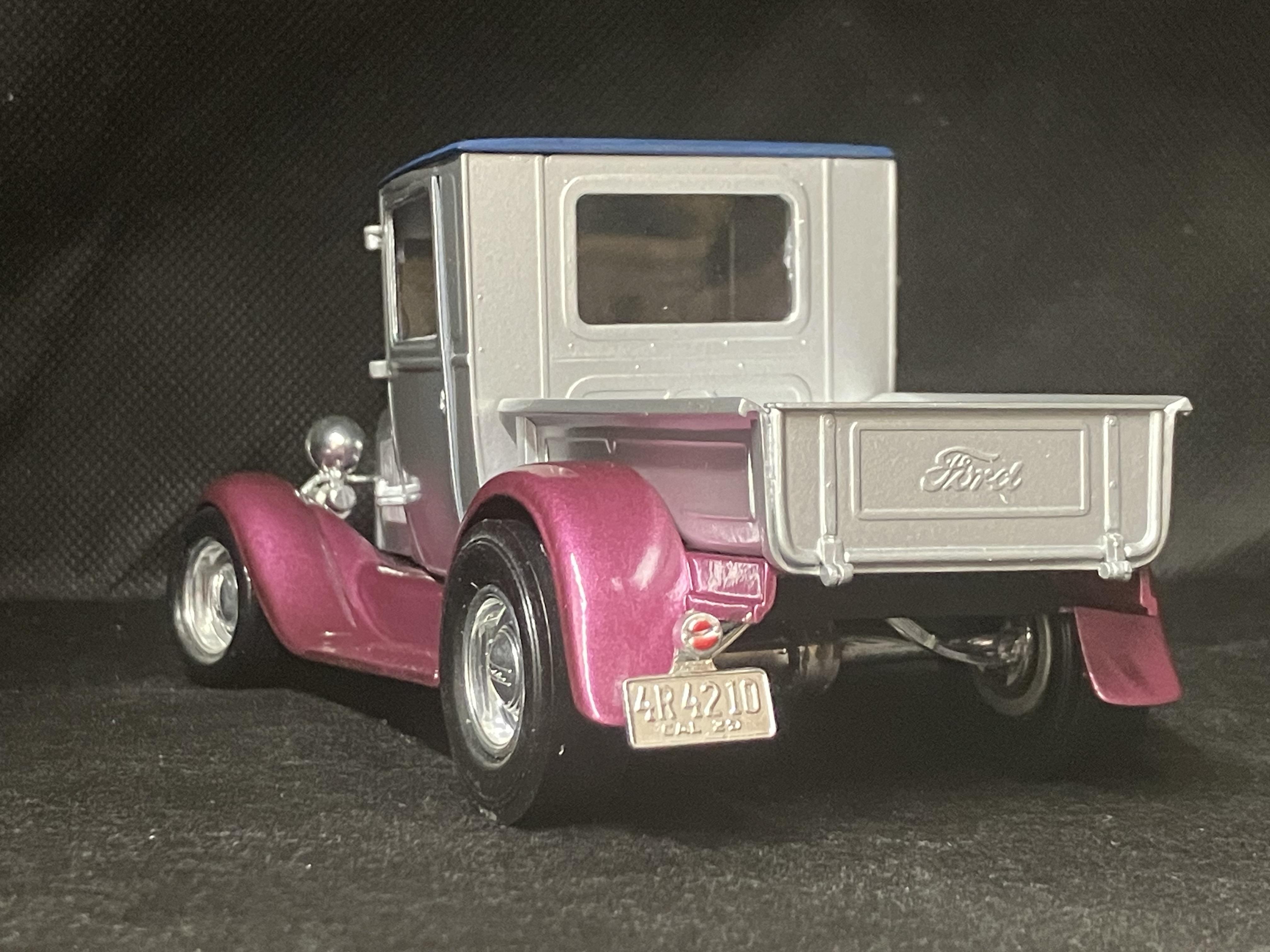

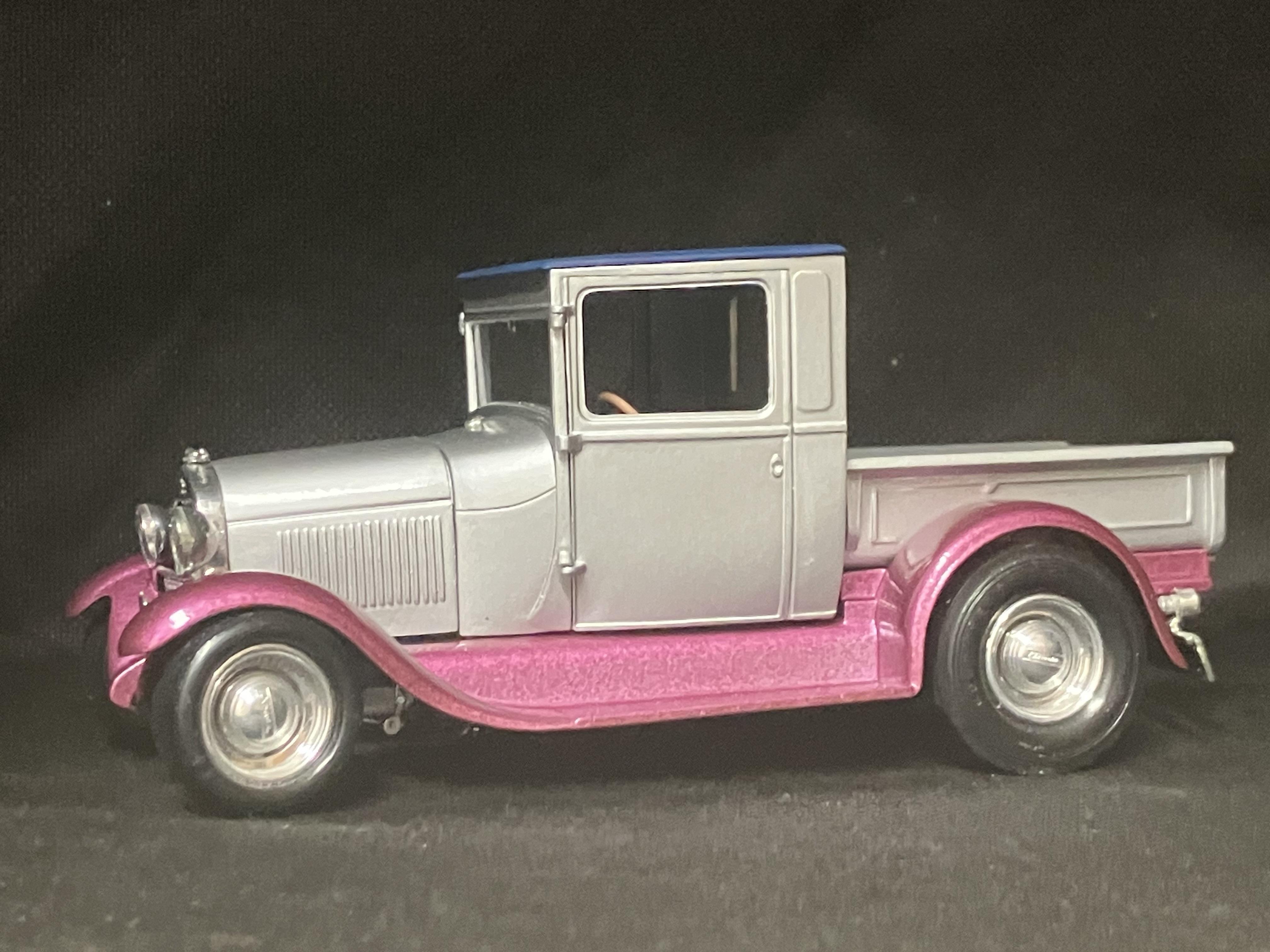

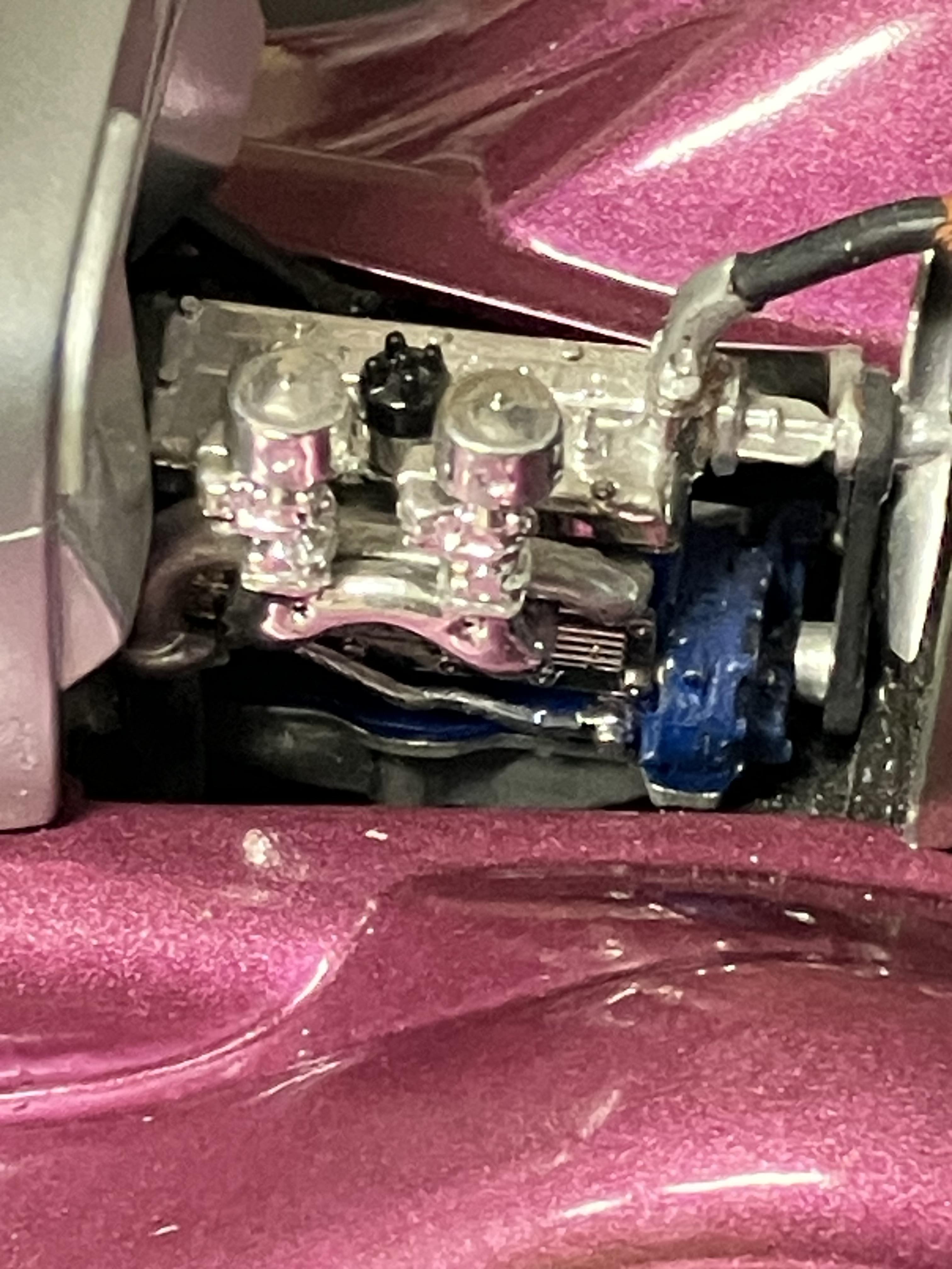

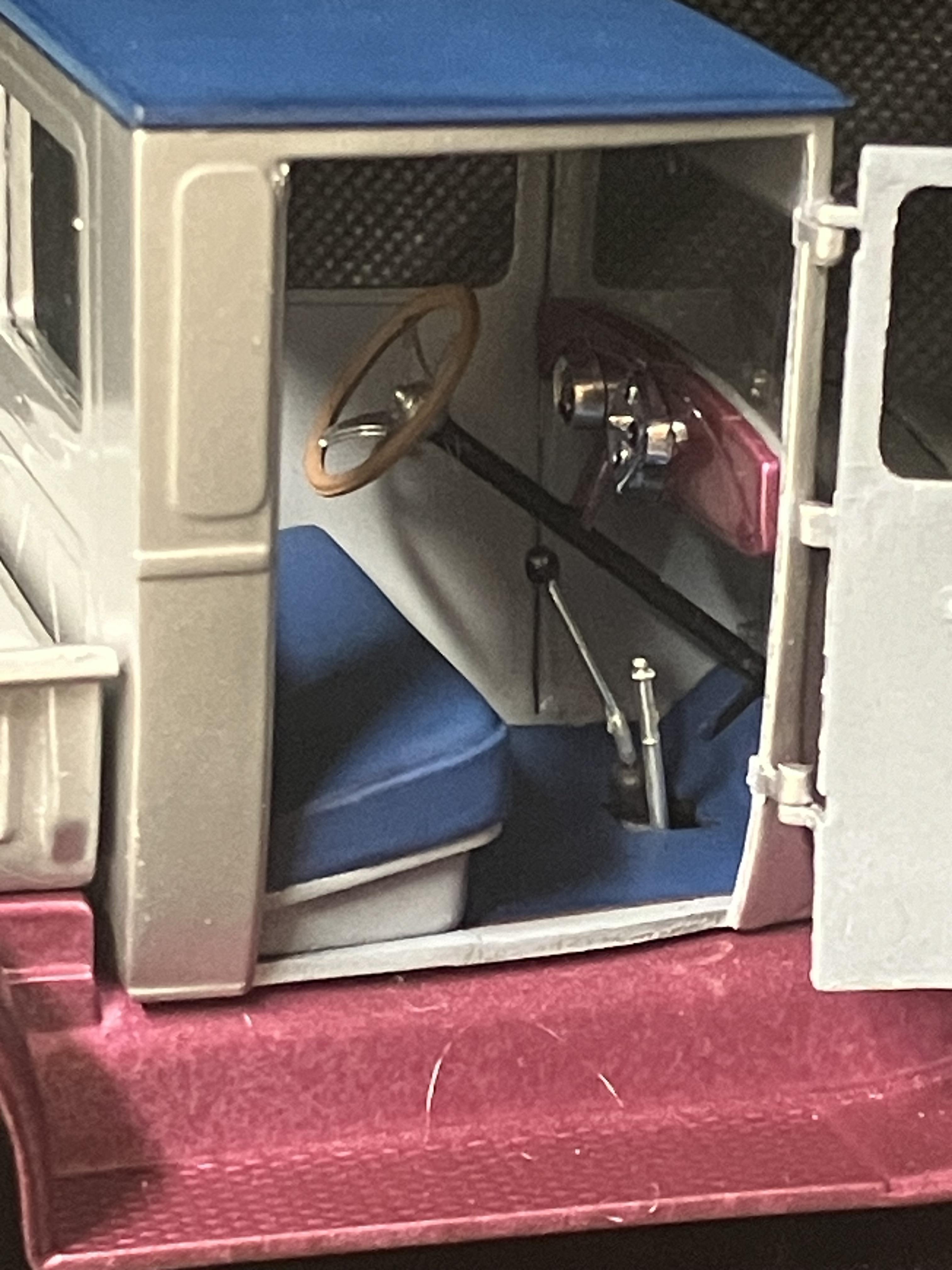

I originally built this in 1975 when I was 18. Over the years it deteriorated, parts fell off and the paint on the cab flaked off. It’s been in a box for at least 30 years now and I decided it was time to restore it and get it back into the display case. The wheels, tires, chassis, and engine are still the way I originally built it. Wheels and tires are AMT, chrome reverse from the ‘34 Ford pickup issued in the’70’s. And the tires and hubcaps are from the mid ‘70’s issue of the ’37 Chev Coupe. I stripped the body, bed, and fenders then primed them with Testors #1237. I painted everything silver with Testors #1246 like before. The fenders are finished like they were before with Testors #1631 Purple Metal Flake over silver. The cab and bed are cleared with Pledge Revive, they were not clearcoated before. The upholstery and roof are brush painted using Testors #1172 bottle enamel like I had done before.

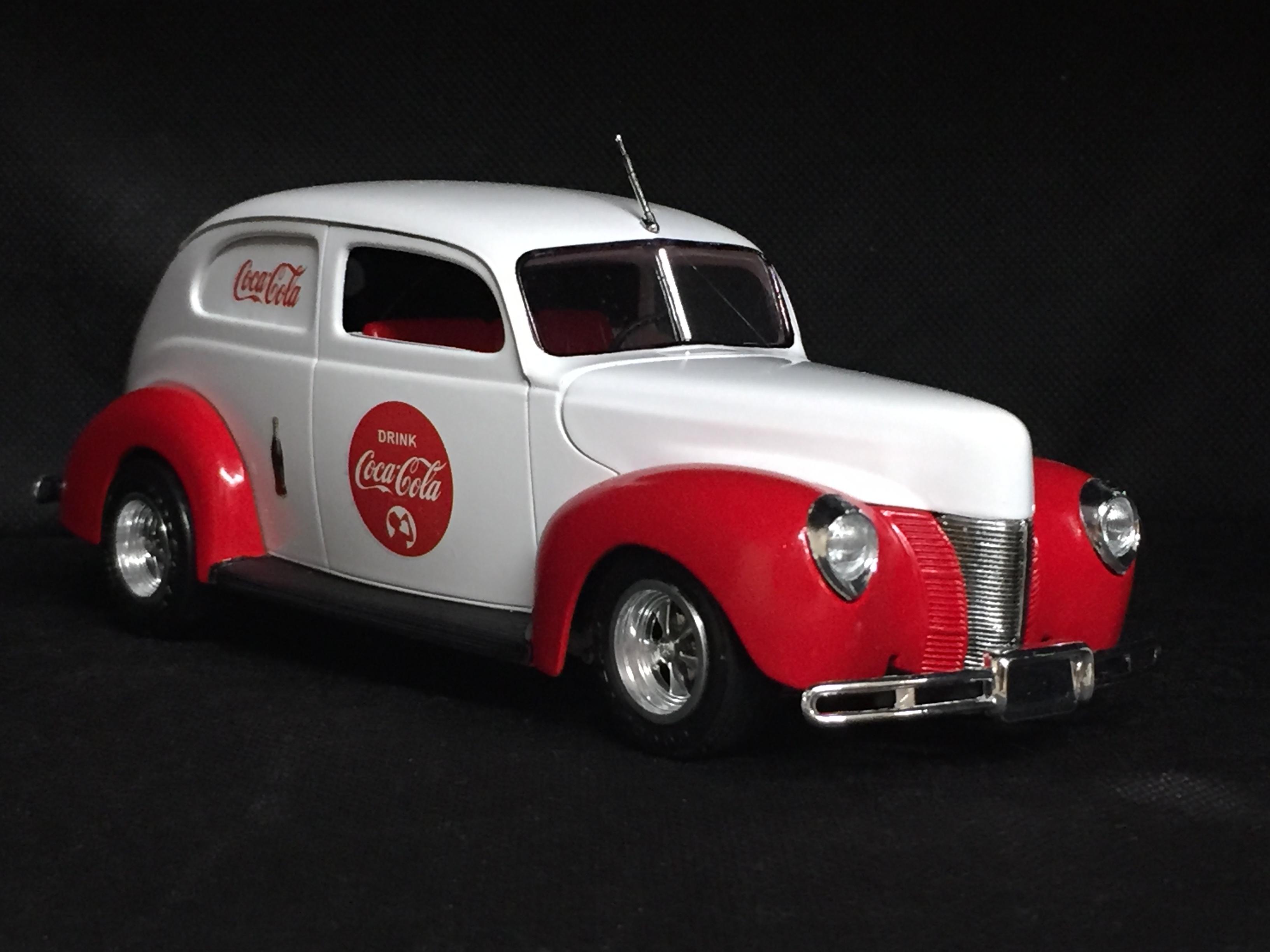

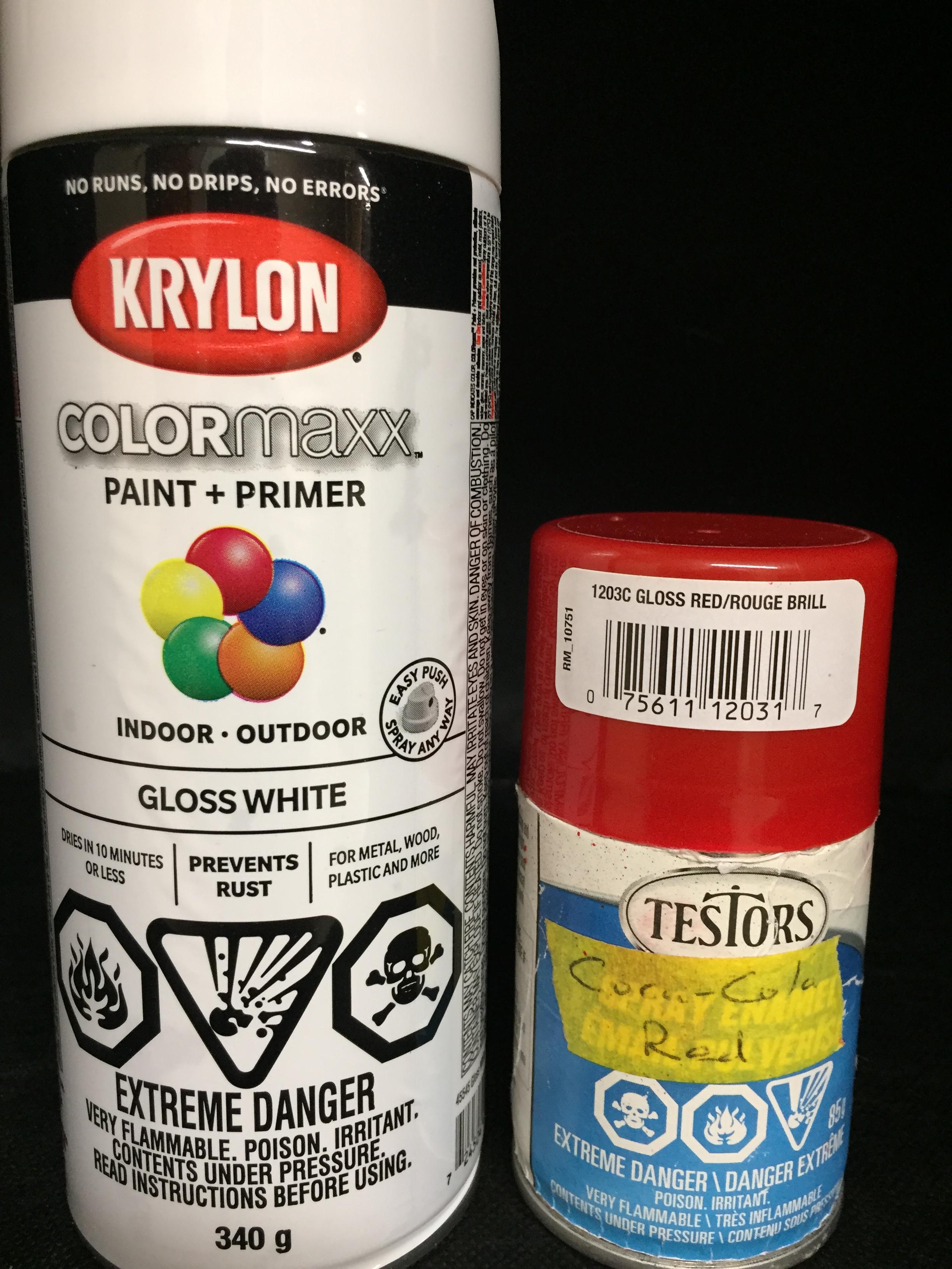

This is the stock version of the AMT kit #8215. Krylon and Testor paints with decals from the AMT Willys gasser pickup.

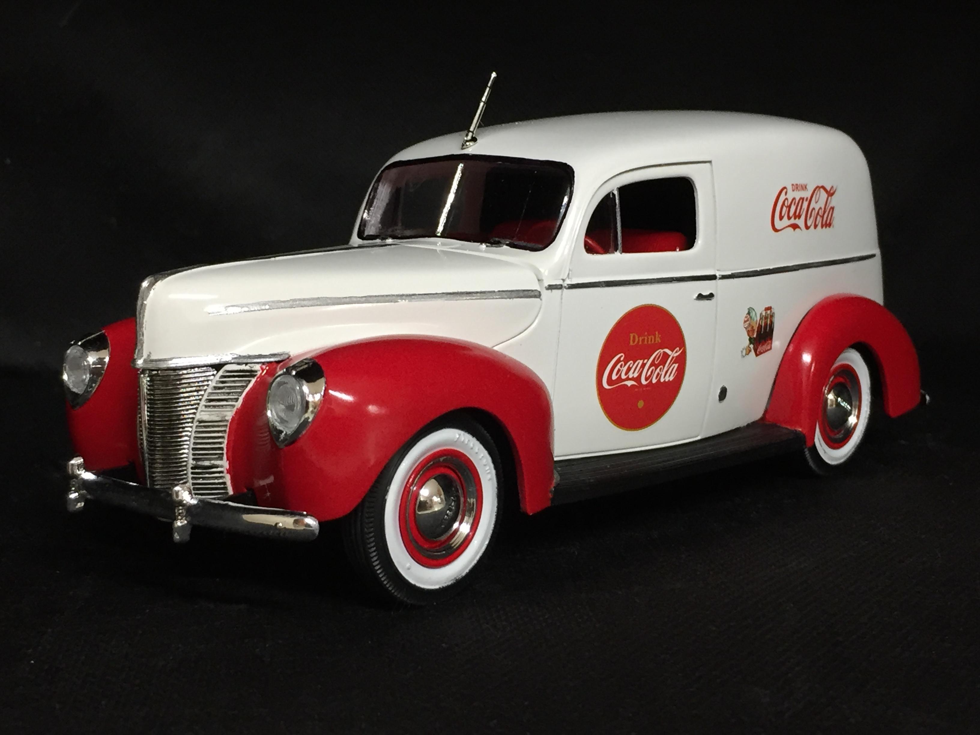

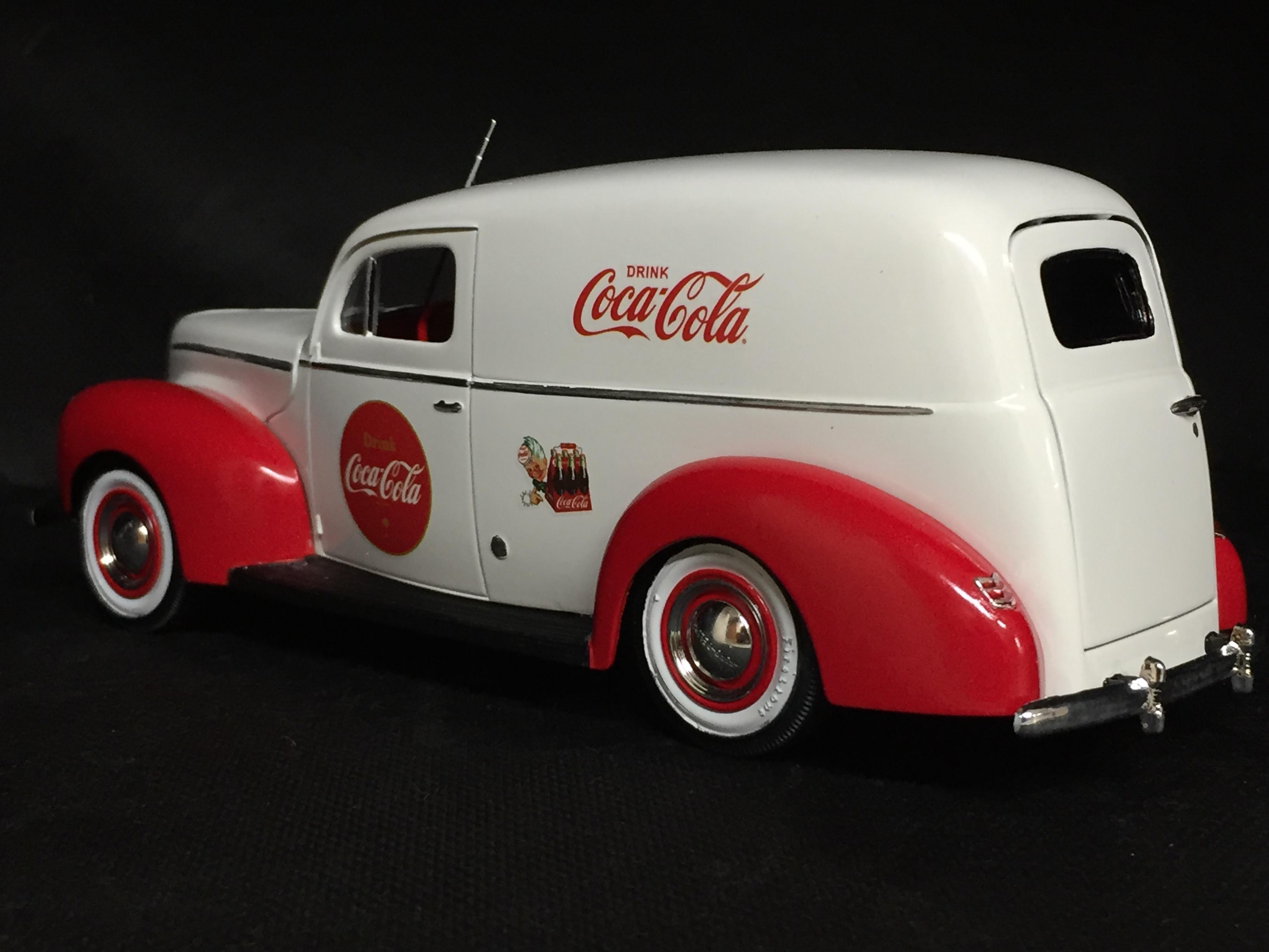

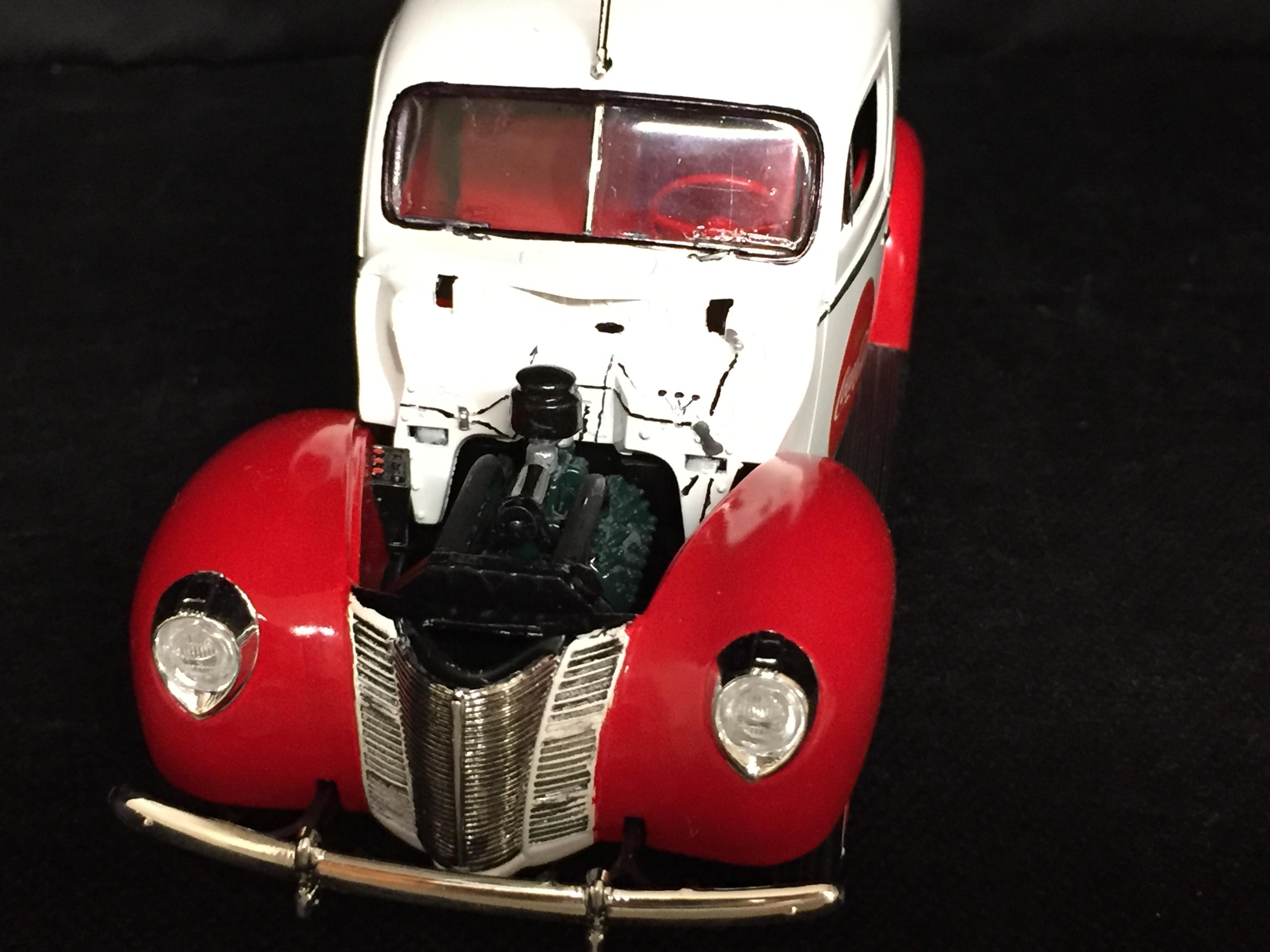

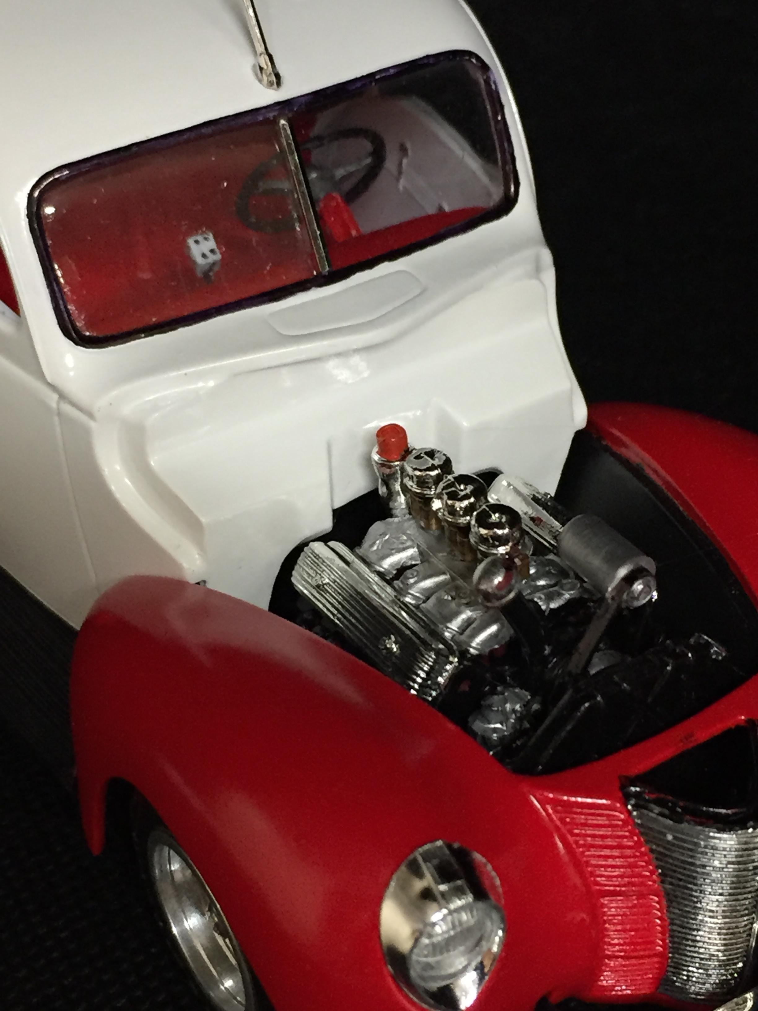

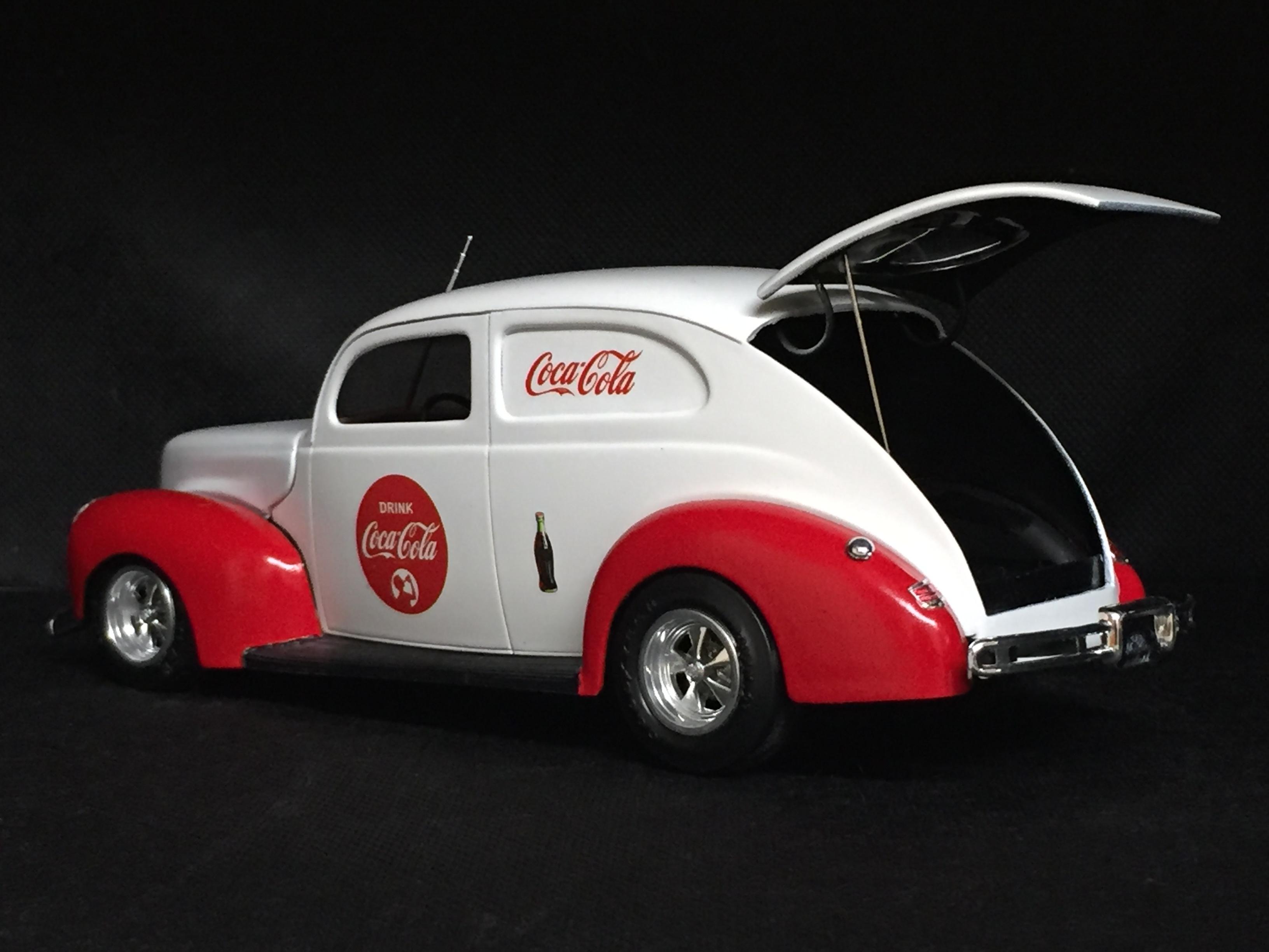

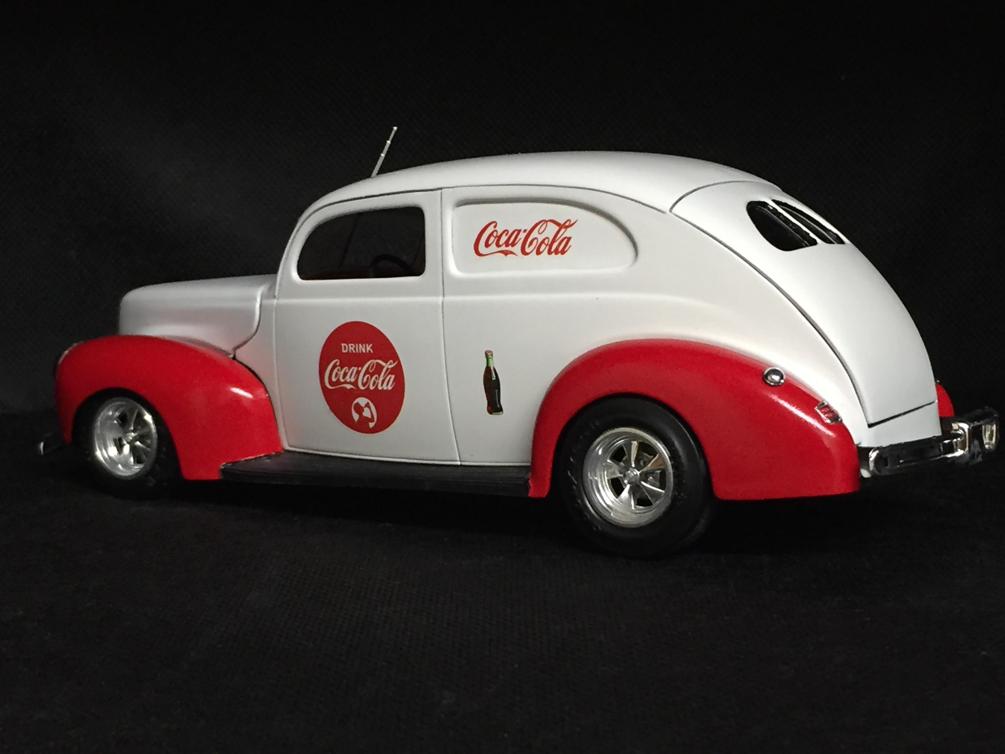

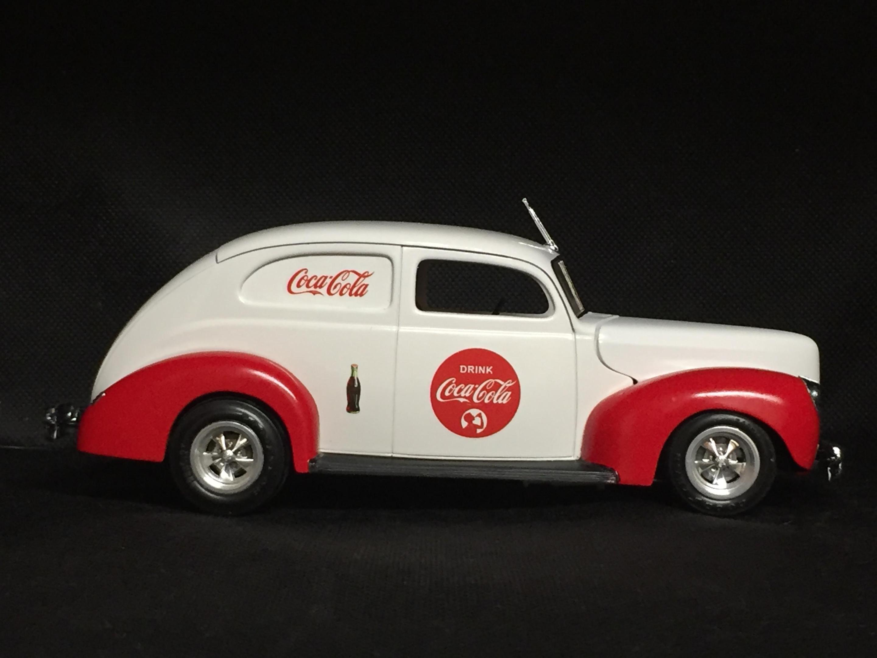

I wanted to do something a bit different with the AMT ’39/‘40 Tudor Sedan. I filled the side windows using card stock and filled the trunk seam below the rear window. I lined up the new seam for the rear hatch even with the ends of the side drip rails. I then cut the hatch open following the original trunk separation lines and added a homemade hinge. Krylon and Testors paints with decals left over from the Coca-Cola Willy’s gasser pickup finish it off.

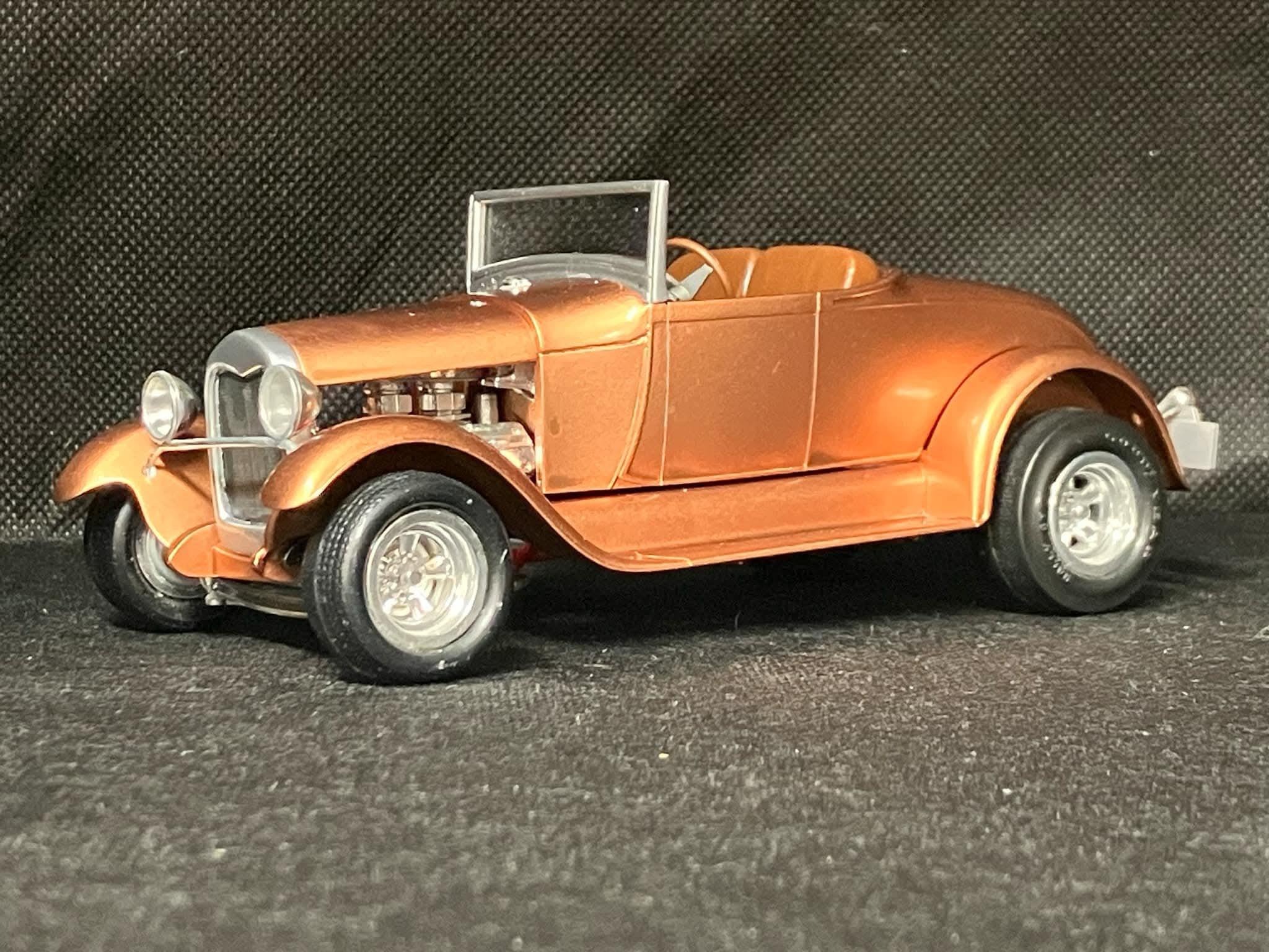

Revell 1970's issue molded in green metallic styrene. I chopped the top and filled the grille opening. I also glued the hood to the fenders then cut the fenders from the body. I intended to make a tilt front end, but decided to leave it as a removable one piece panel. Refinished with Testors Competiton Orange with Pledge Revive clearcoat.

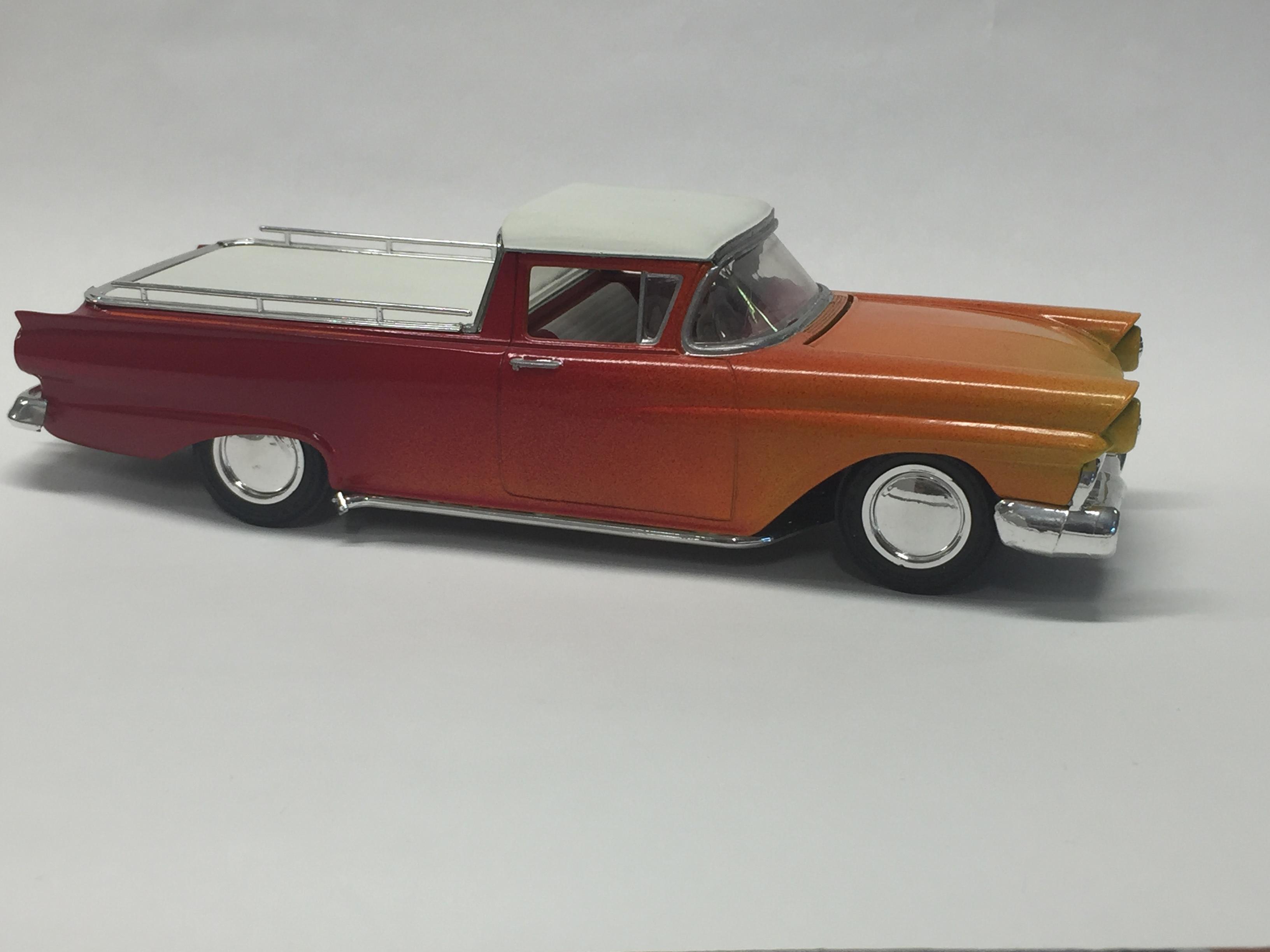

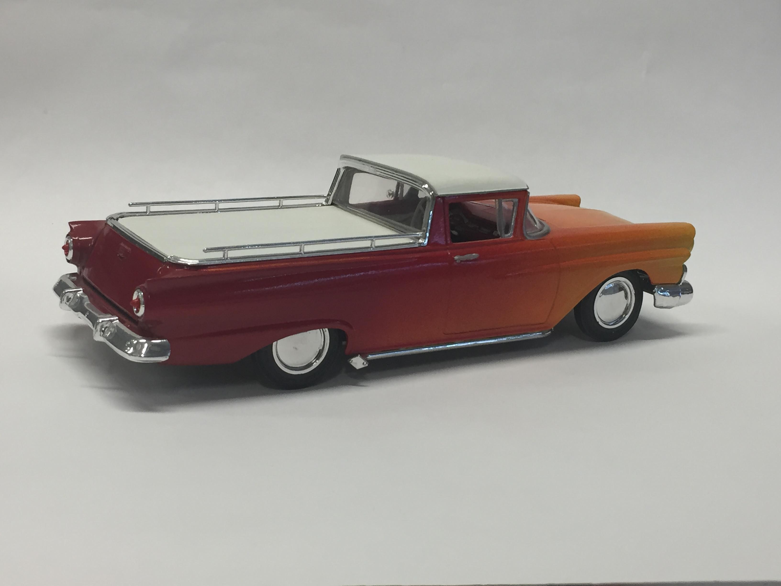

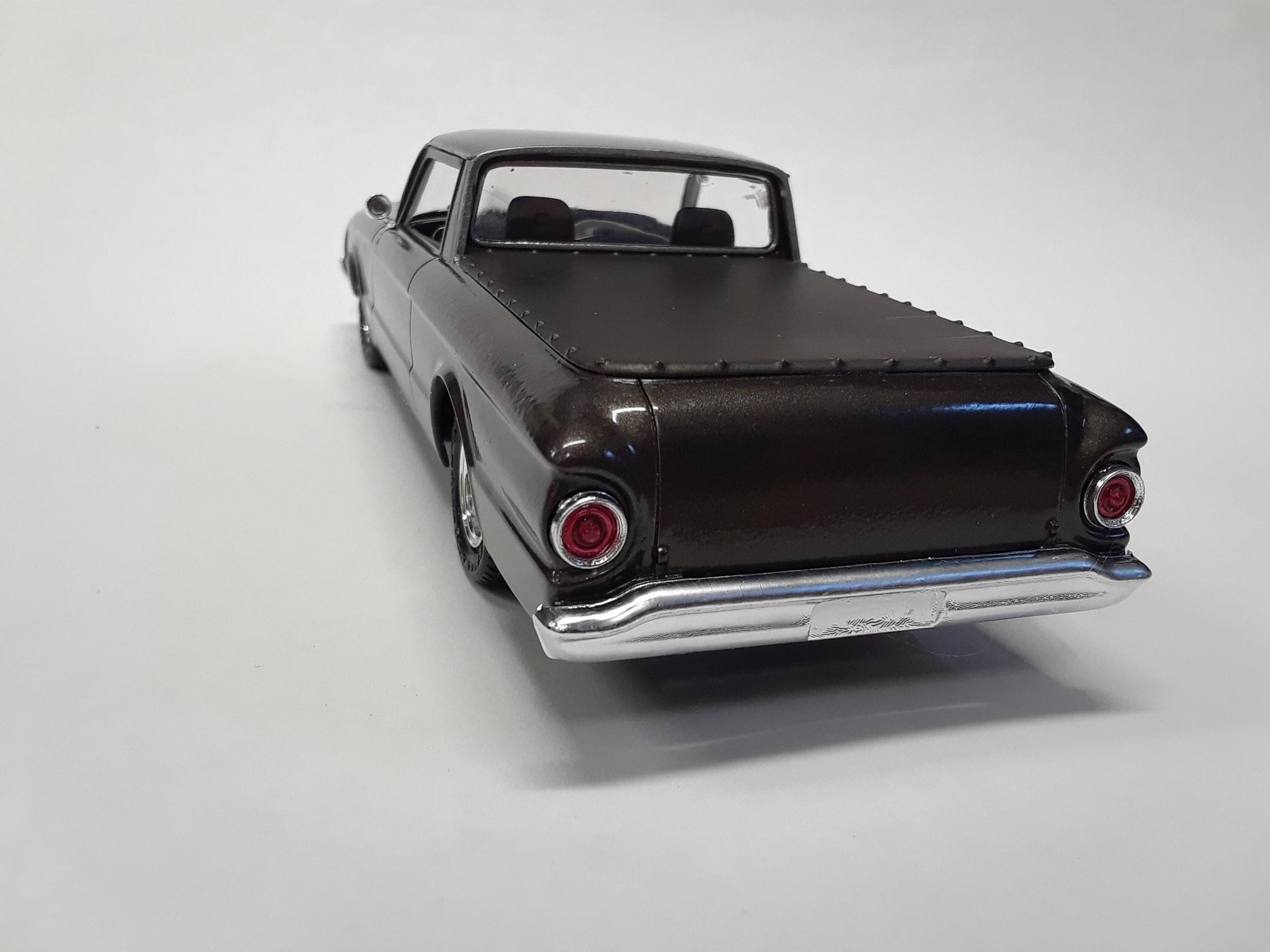

This is the AMT/ERTYL '61 Ford Ranchero that I modified the rear wheel arches to match the front fenders. I replaced the kit's Chev engine with the Ford 5.0L from the Revell/Monogram Dan Fink Speedwagon. The wheel/tire combo and bucket seats come from the AMT/ERTYL '36 Ford coupe issued in the '90's. New door panels are from the parts box. Paint is Model Master #2907 Sable Brown Metallic.
