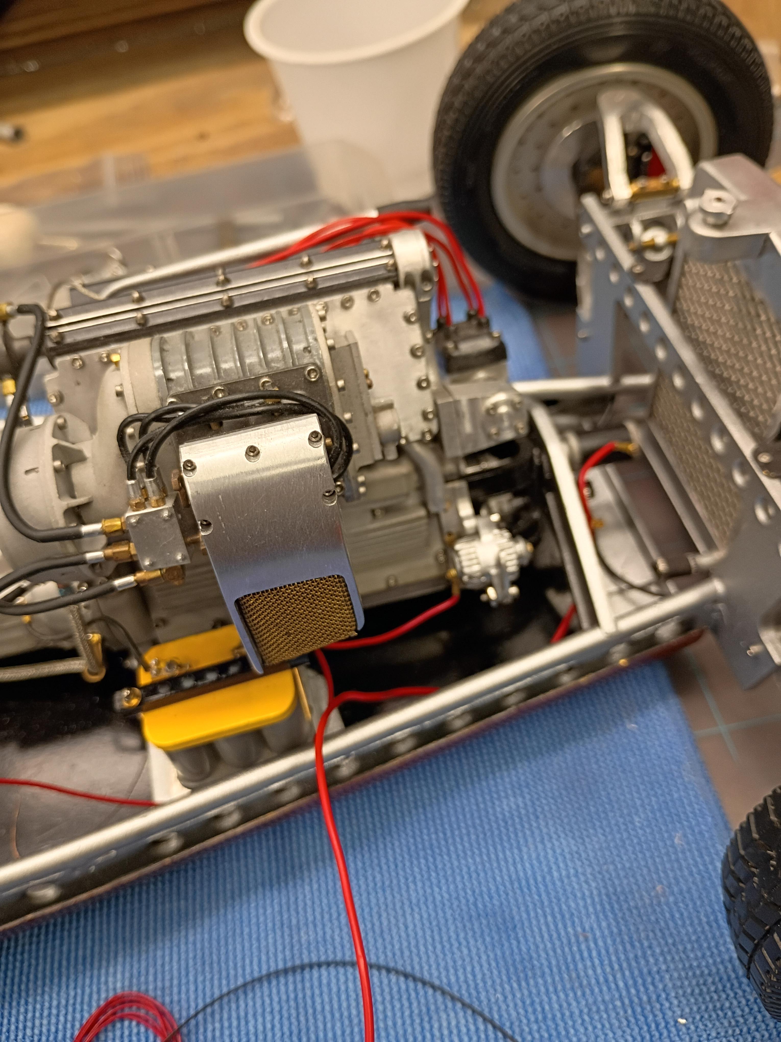

long time no see. a lot of company and other appointments in between. not much work happening for 3 or 4 weeks, but some. a little wiring and battery install. maybe 2 full days of work left and the chassis will be ready for the body. cant wait to see how it looks. thanks for the compiments all of you. ill try to do better . had to do alittle touch up work -

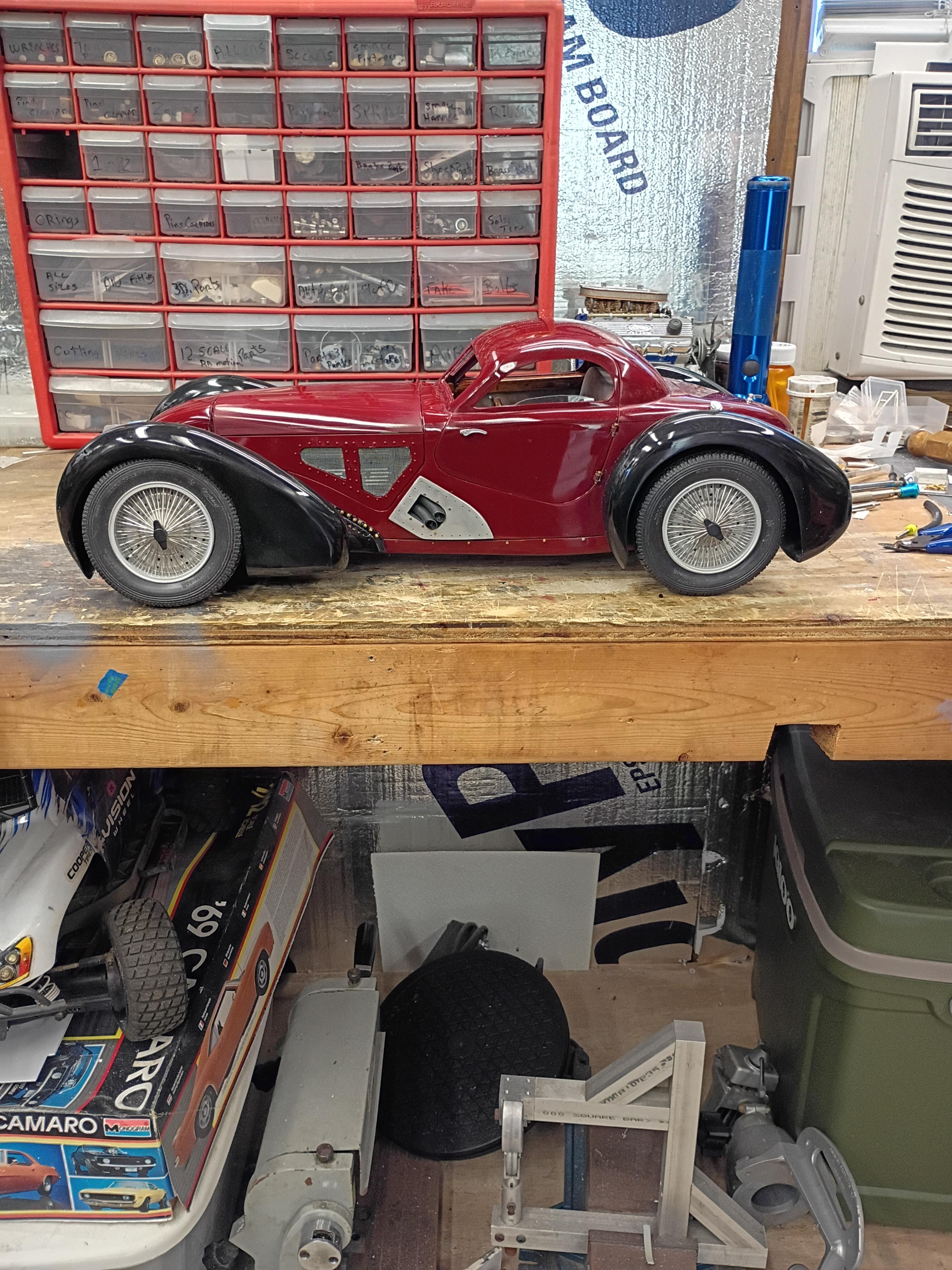

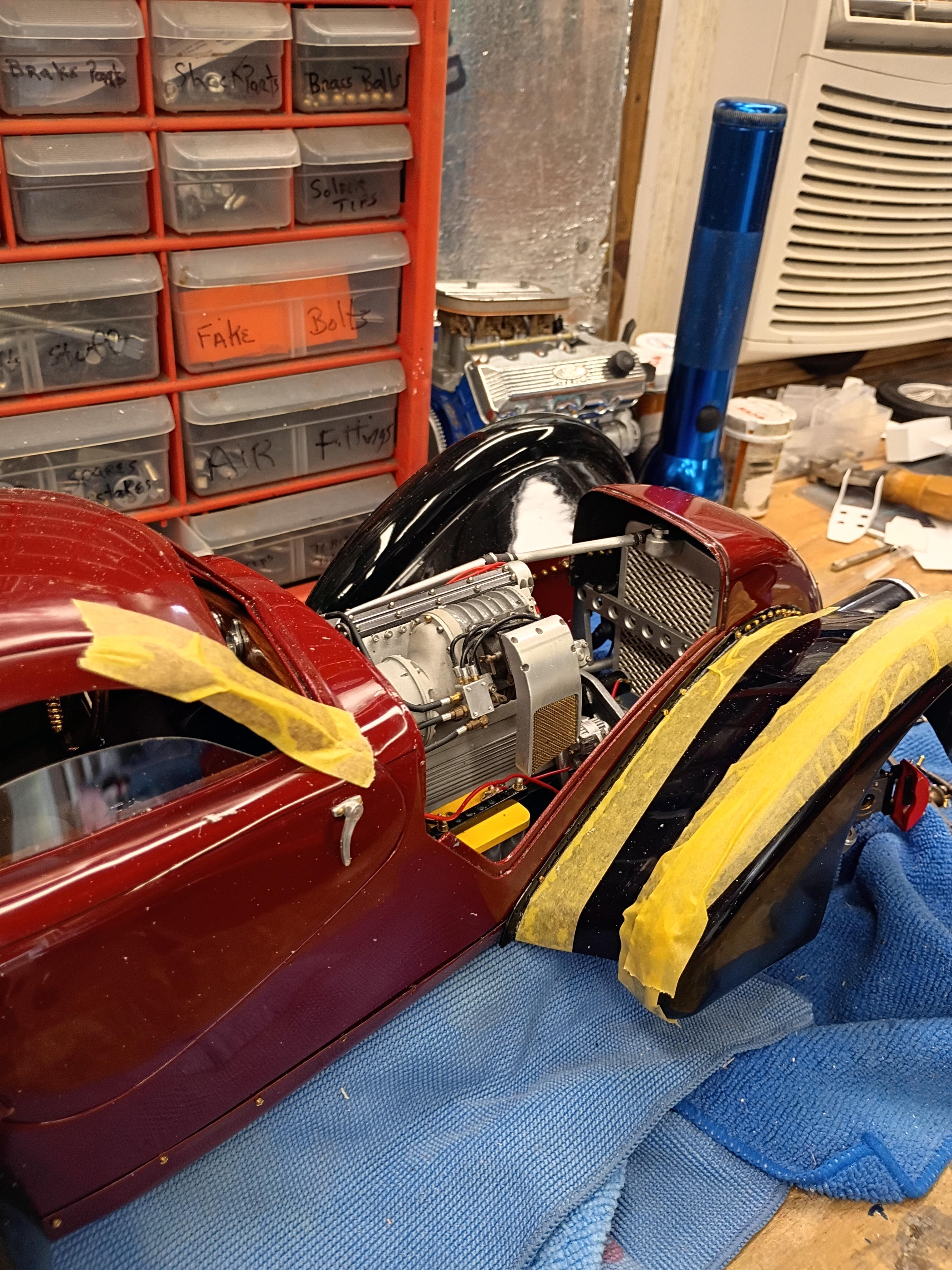

hi Tim how is your arm doing, getting better i hope. hi mike thanks for the complement and for looking. Francis is it warming up yet? your car is looking great. thanks for coming back noel. thank you ,Donato its slowly coming together. got alot of paint done ,all of it i think. finally got clear on the body and got most of it sand to 3000 grit ,only 4 more finer grits to go. can't wait to see it polished. had to strip and repaint the nose.one part of the clear got foggy and would not sand out before i sanded through to the red. also had a spot on the right rear fender same thing happened. it looks like thousand very tiny air bubbles. its starting to look nice. i have company visiting all this week. no progress for awhile. -

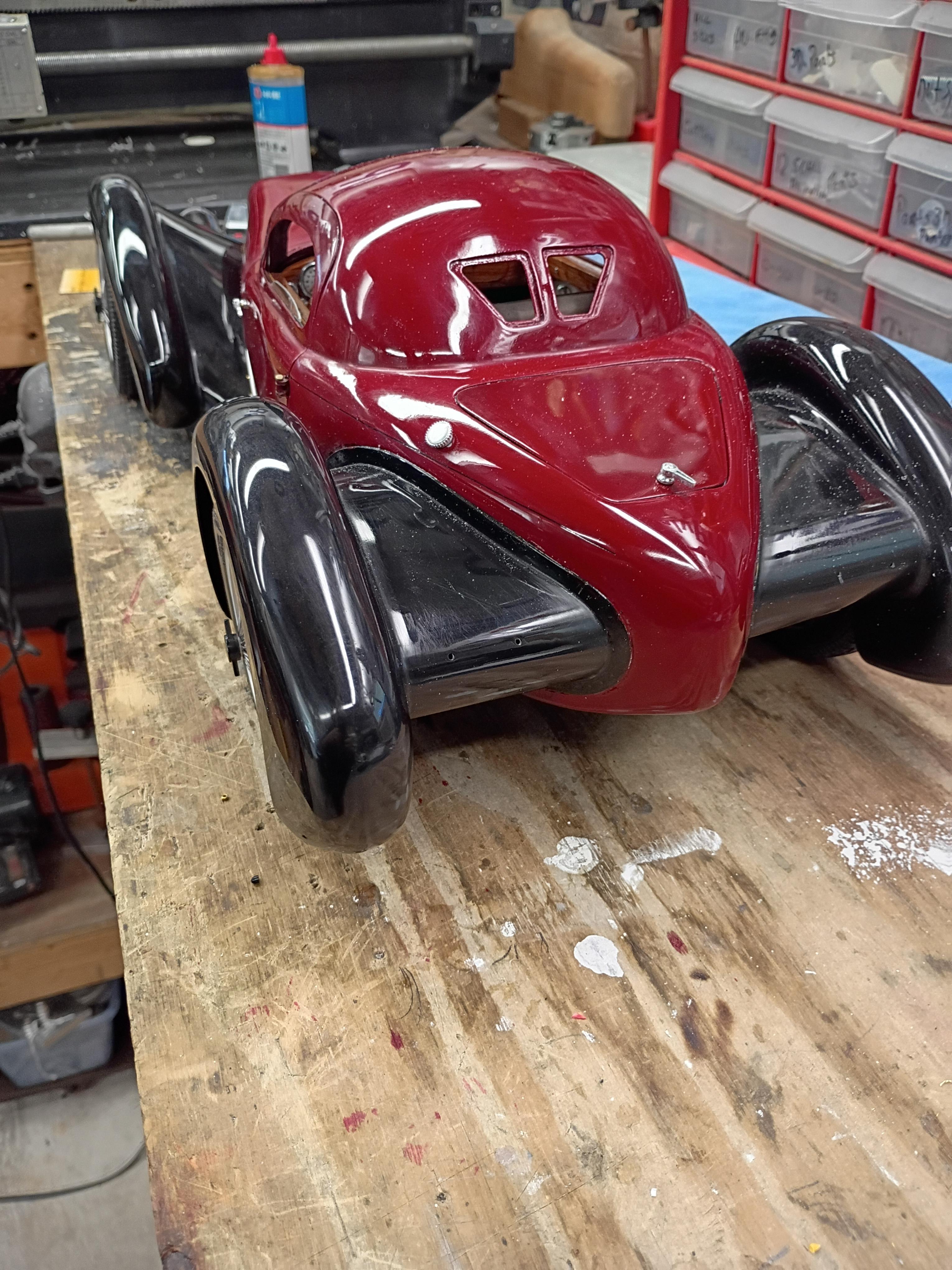

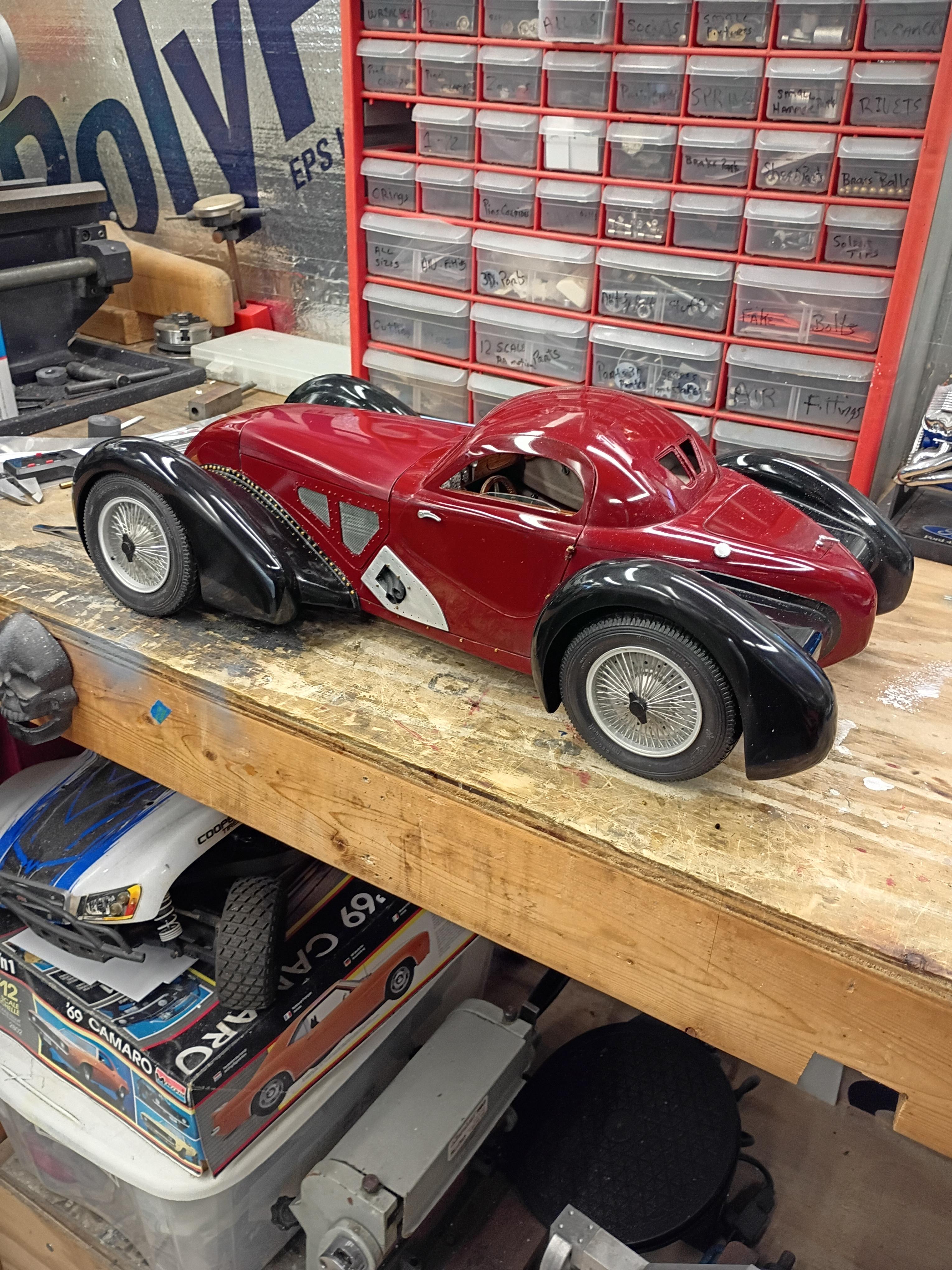

hi everybody, computer has been down .assembly and paint is going well . i had to unsolder some of the chassis and make an adjustment i don't know what happened . it had been assemble before but its ok now. sand blasted and repainted. I think its going together well other then that .all the separate pieces are sanded out to 12,000 grit ready for polish. the body will get the clear this week. i think the colors go together well. looking forward to it being shiny. talk to you again soon. -

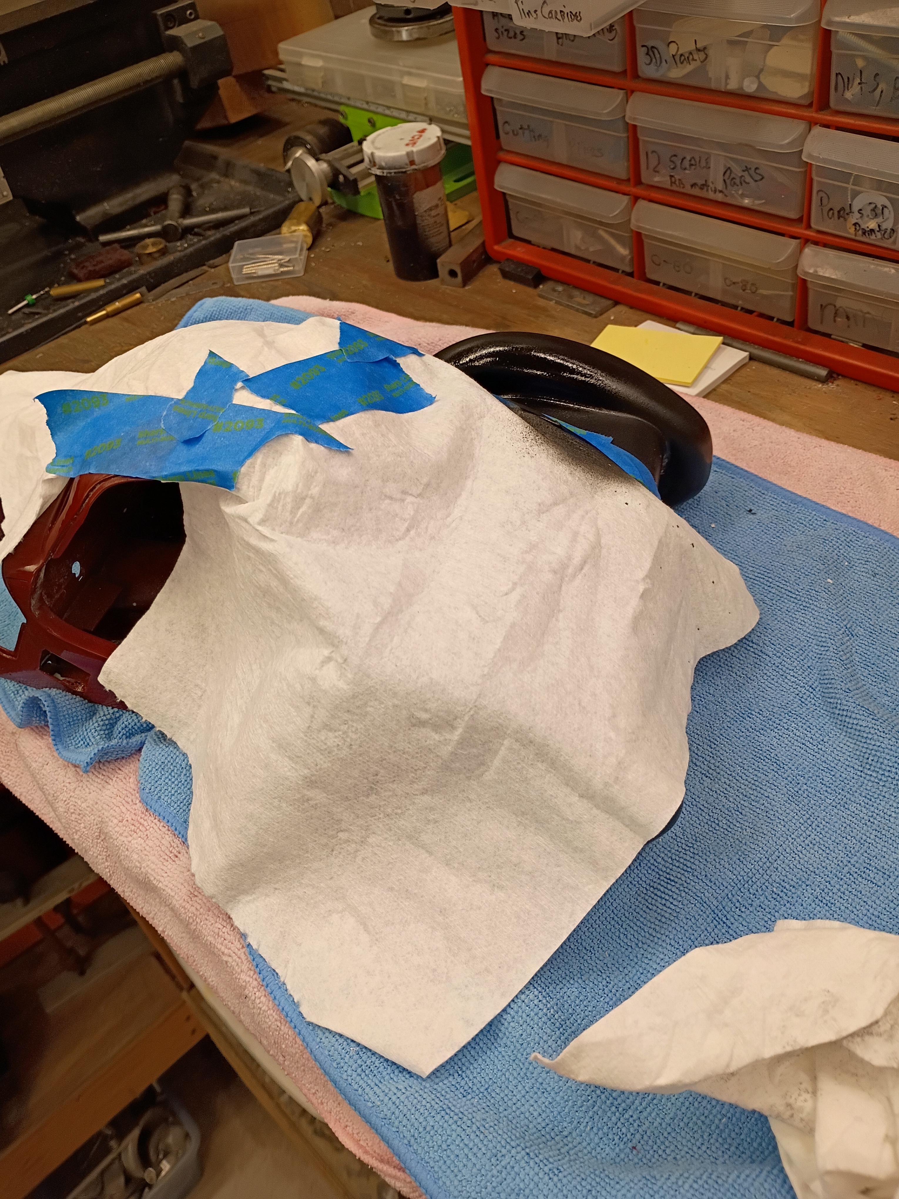

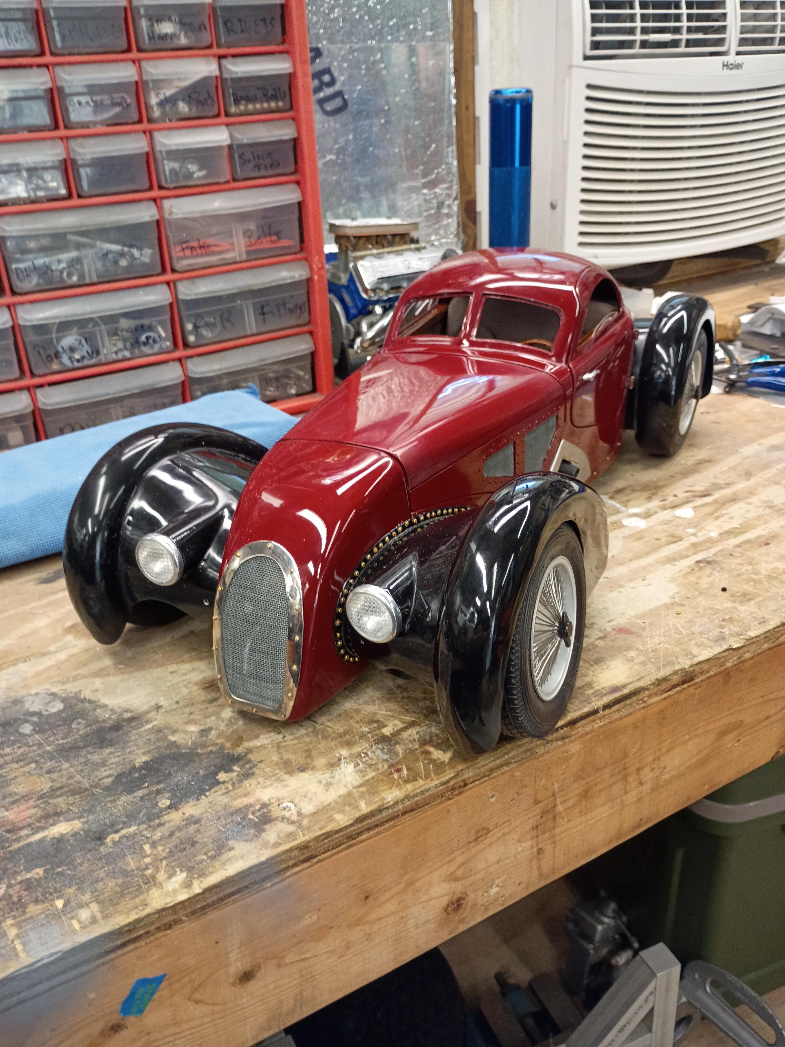

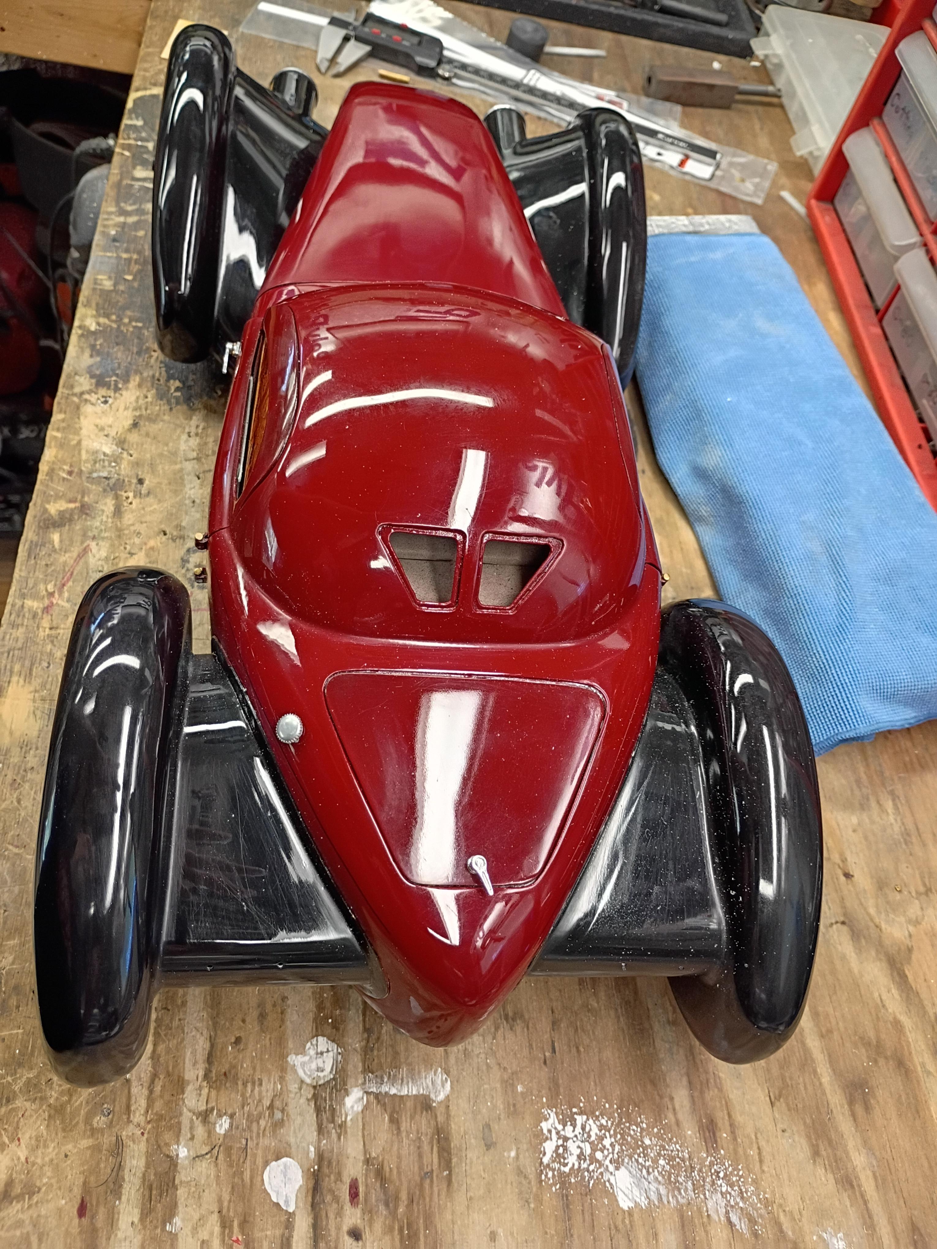

i have been painting ,sanding and polishing. red is coming long well. i thought the pin stripe was going to be .040 but it is more to scale at .015 but hard to see in the pictures. none of these have been sanded or polished . i will start that this saturday. i like to wait a week after painting. the front fenders are sanded but not finished polishing. thanks ken . -

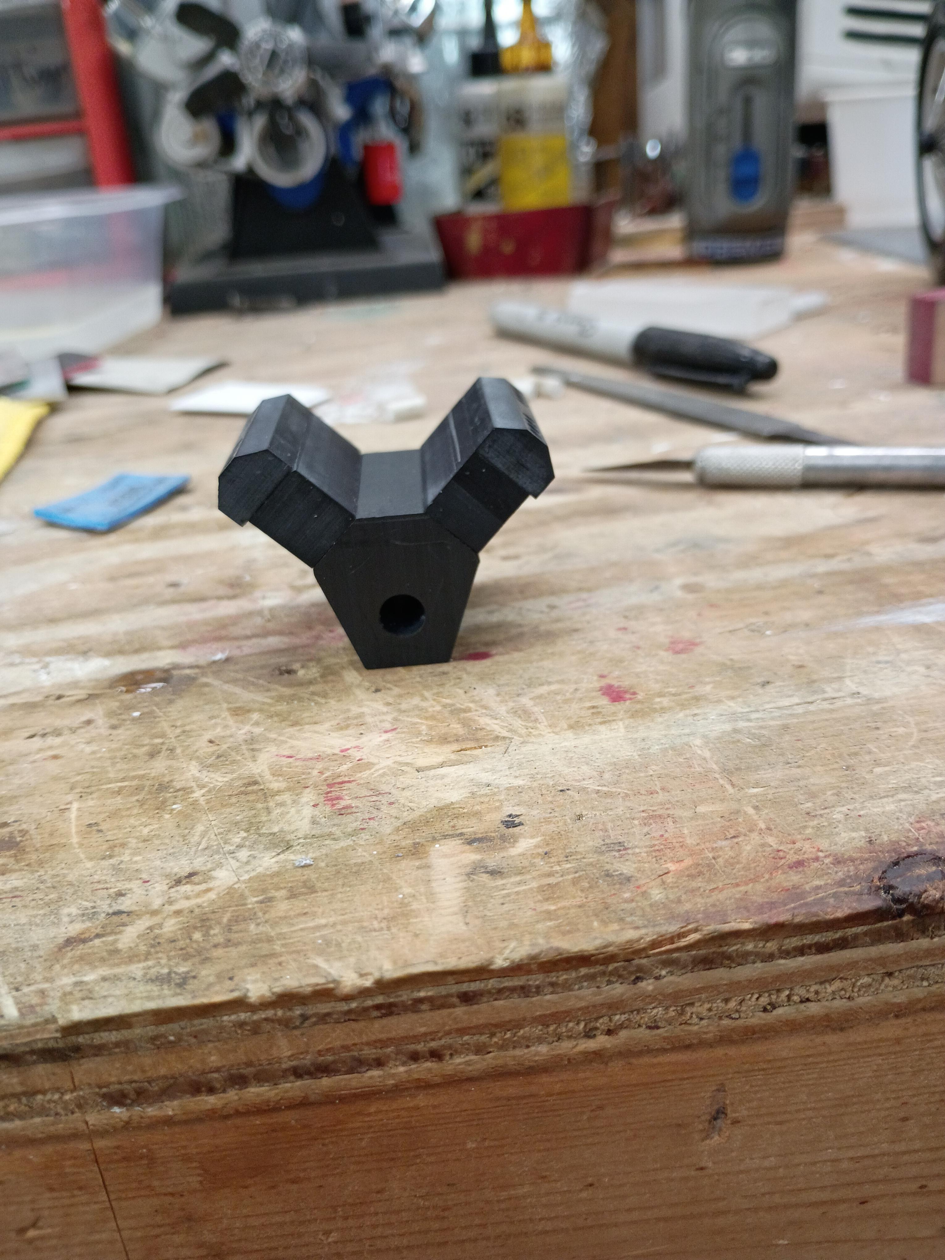

had this idea for awhile i had said i wanted to use a novi v8 for something different but i am not a researcher so i am having trouble finding pictures and info on the novi but i havent given up yet. if i dont find it i will go with an Ls . got my wheels made and am happy with them. made the brake rotors and front hubs. i opened the trunk, this is the first time i have tried that. the doors were already separate. alot of cutting and modifying of the wheel openings. I am not sure how many pictures i can put on here at one time so i will stop for now. thanks , more to come in between the Bugatti paint and assembly

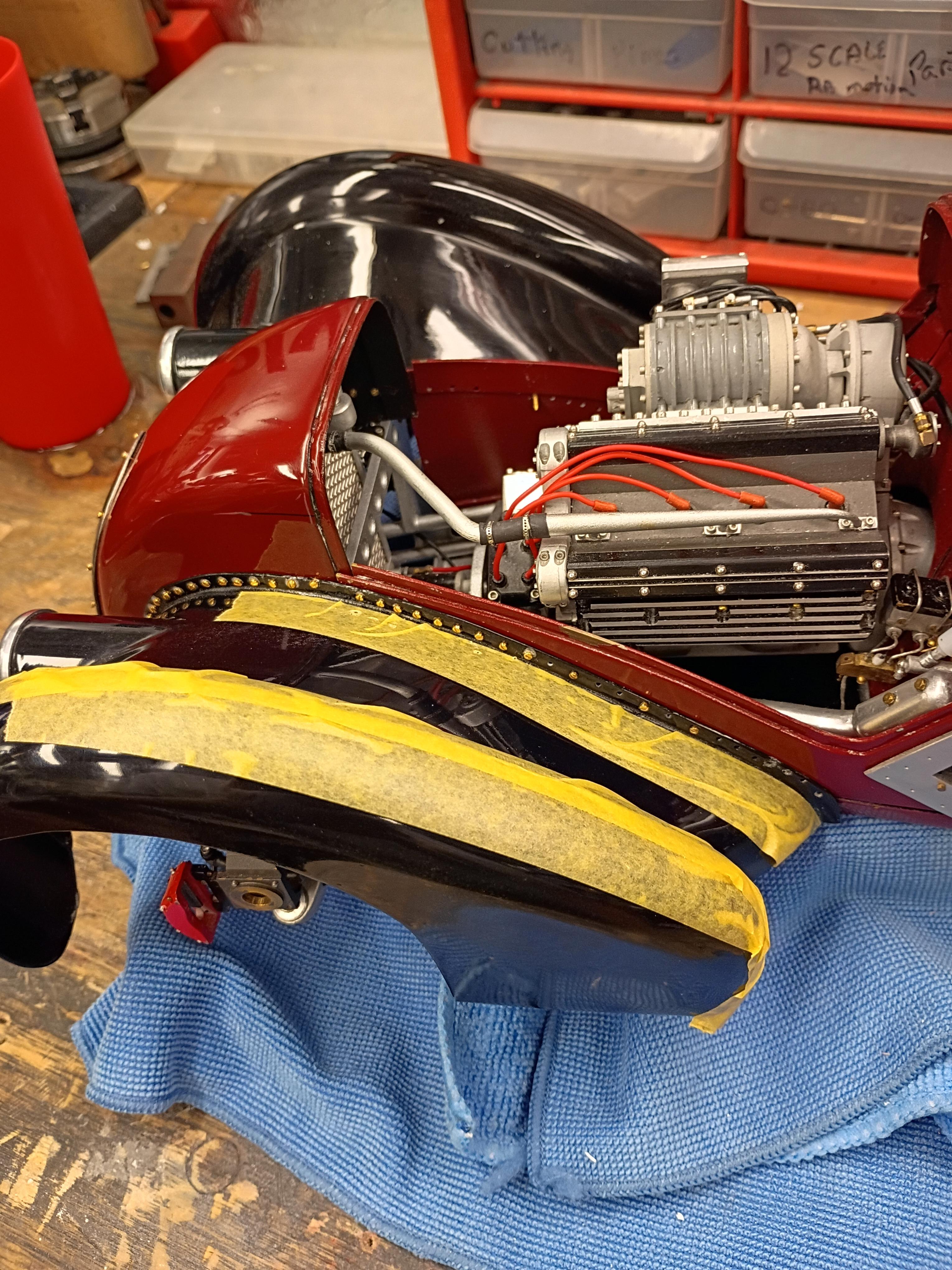

i finally polished one fender. 4000,8000, and polish. it looks good .i always afraid when it comes to sanding the clear, its so easy to sand through on the edges. i put the body back together to do a pin stripe and i could not get it to go back together. i had to make some adjustments in the frame rails and i dont know why. but it fits now. have to sand blast and repaint the frame .i will put the ..040 pin stripe tape on and take it apart and start painting the red. i have been working on the 55 chevy in between.more after some of the parts are painted red -
