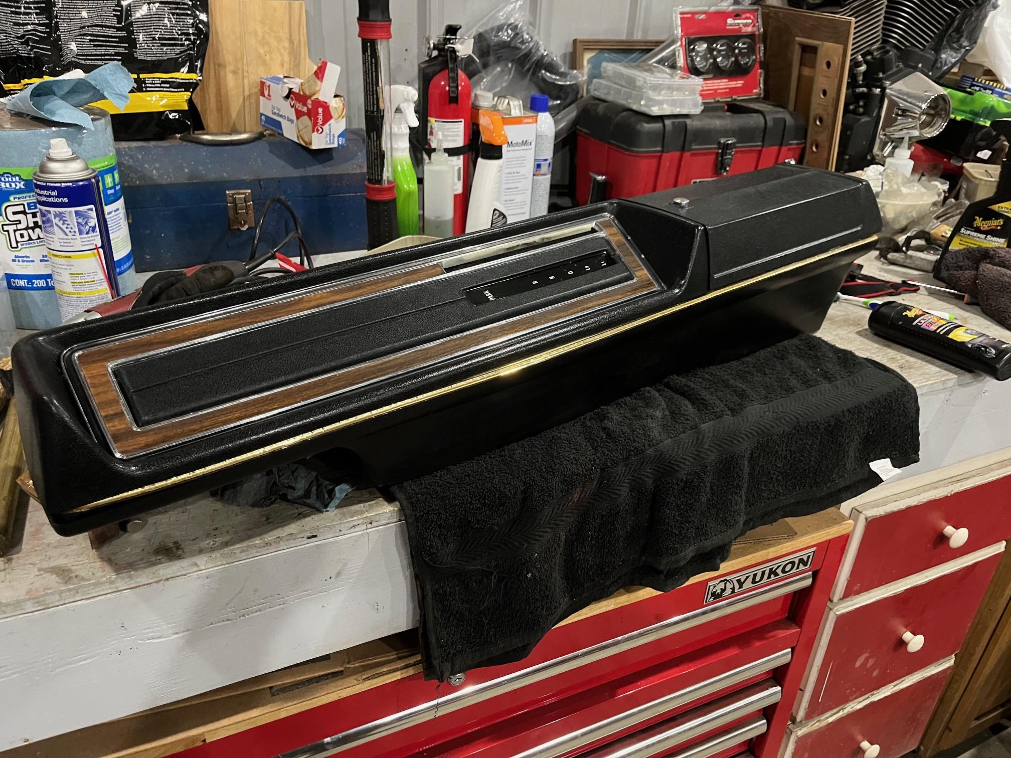

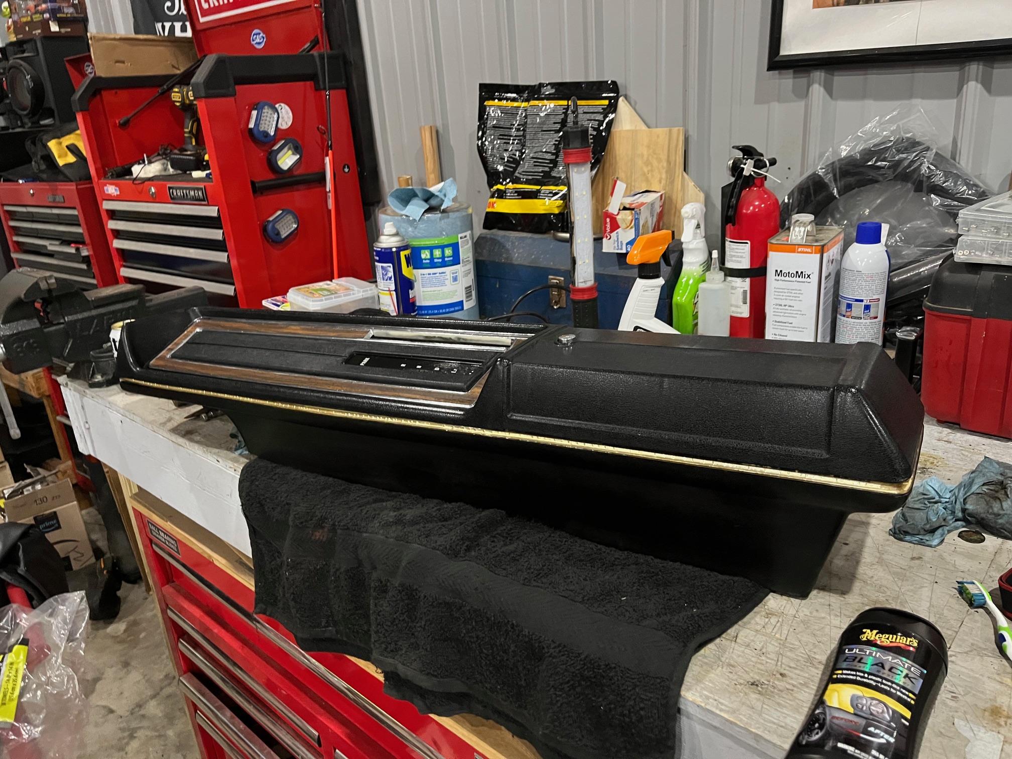

  8. I was able to get the console out last night. Didn't even break anything. I put it on the bench and started cleaning it so it's ready when I'm going to put it back in. Came out better than I had expected:

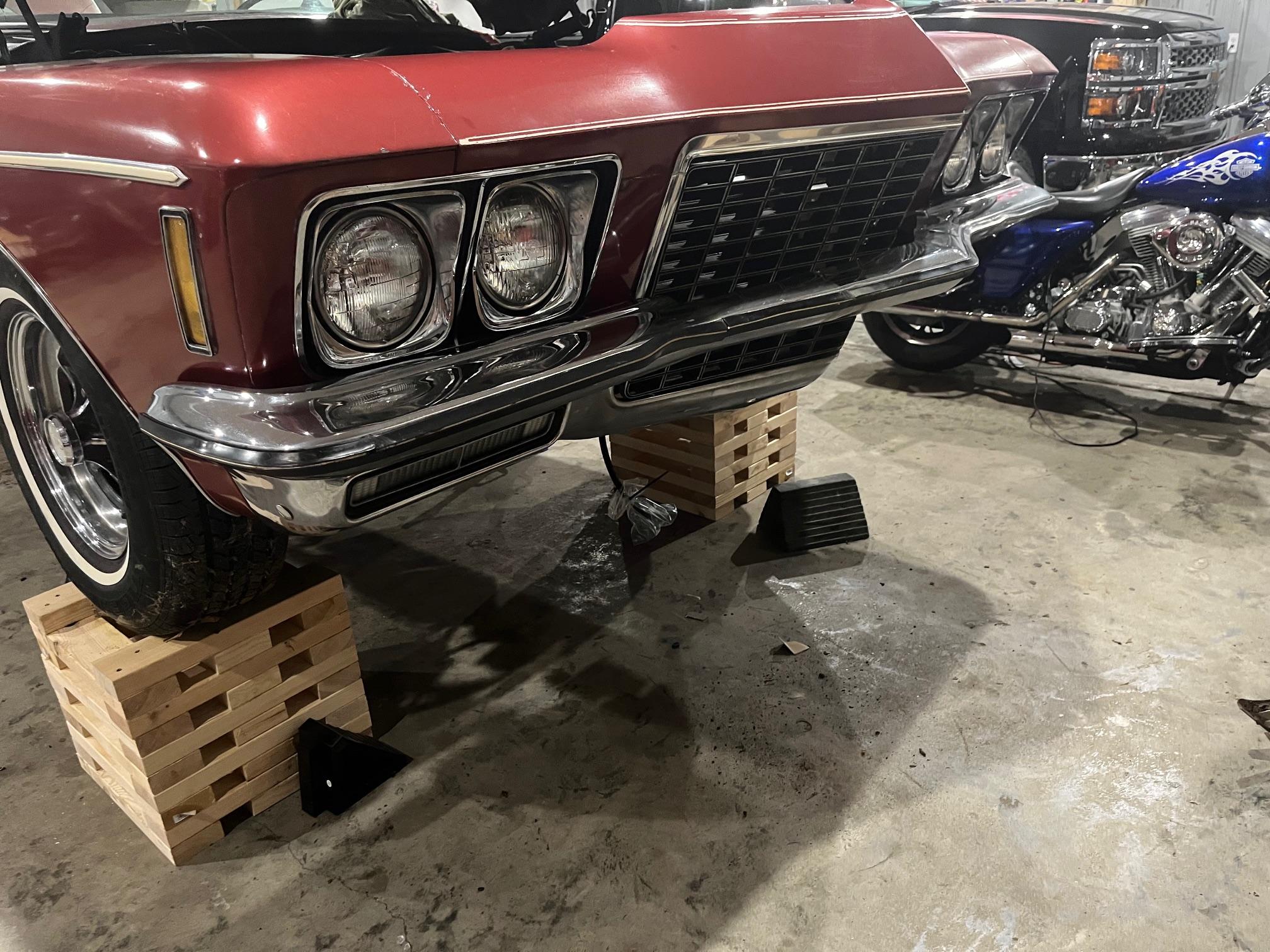

  11. Thankfully there is no front license plate requirement in Pennsylvania

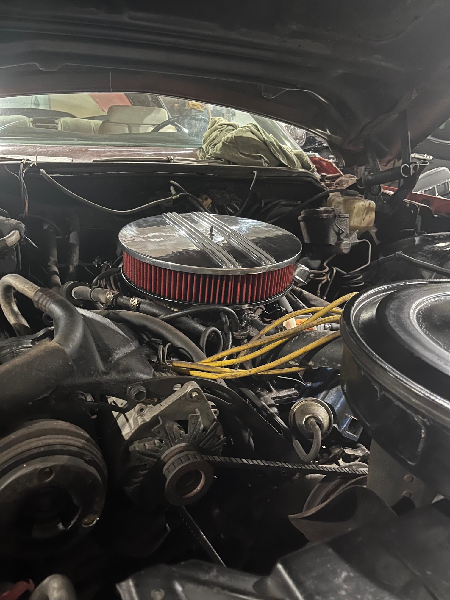

  12. Whilst coming up with a plan for more sheet metal work, I decided to remove the bumperettes and try the new swap-meet air cleaner on for a visual Big change in the looks of the front end with the bumperettes removed!
