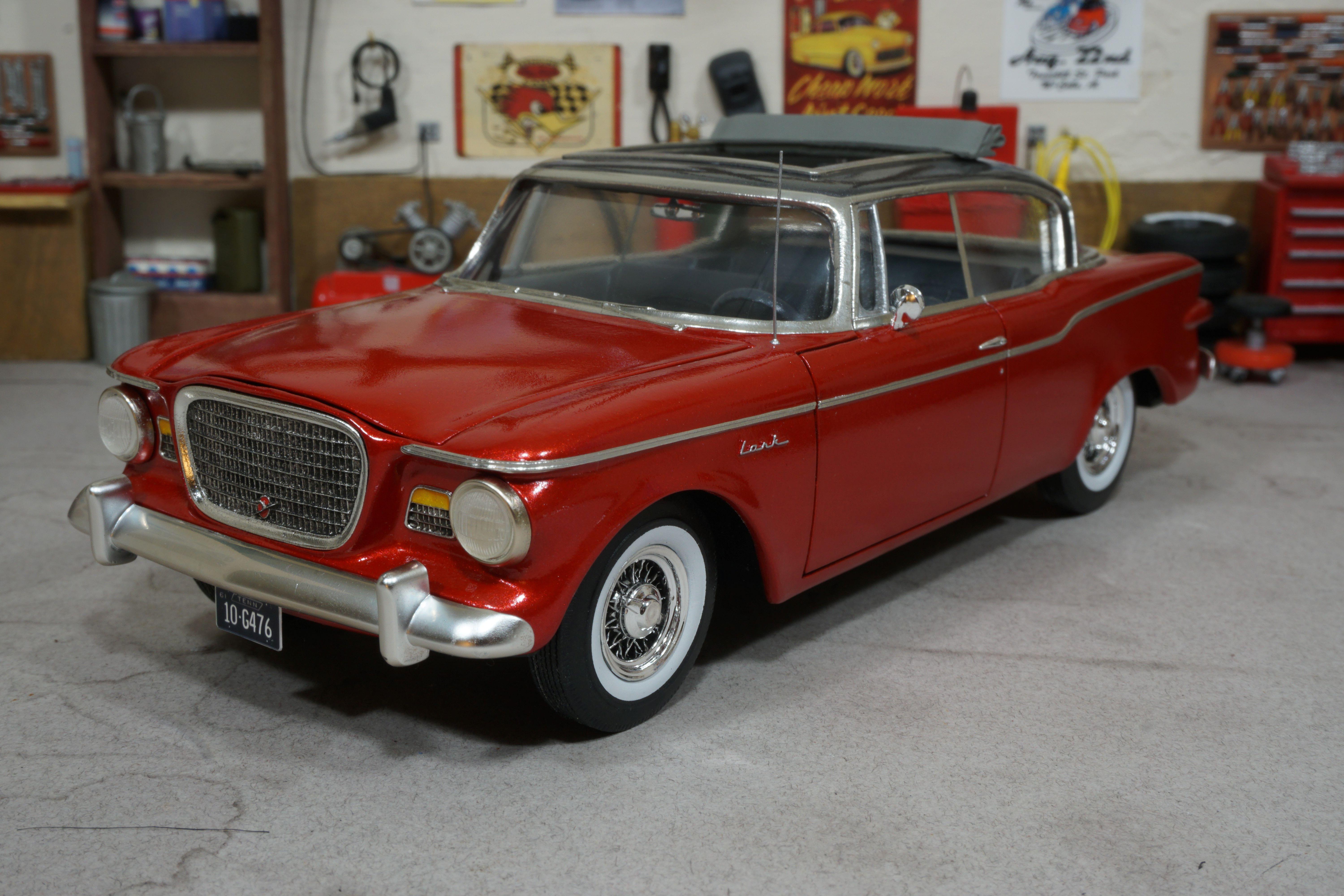

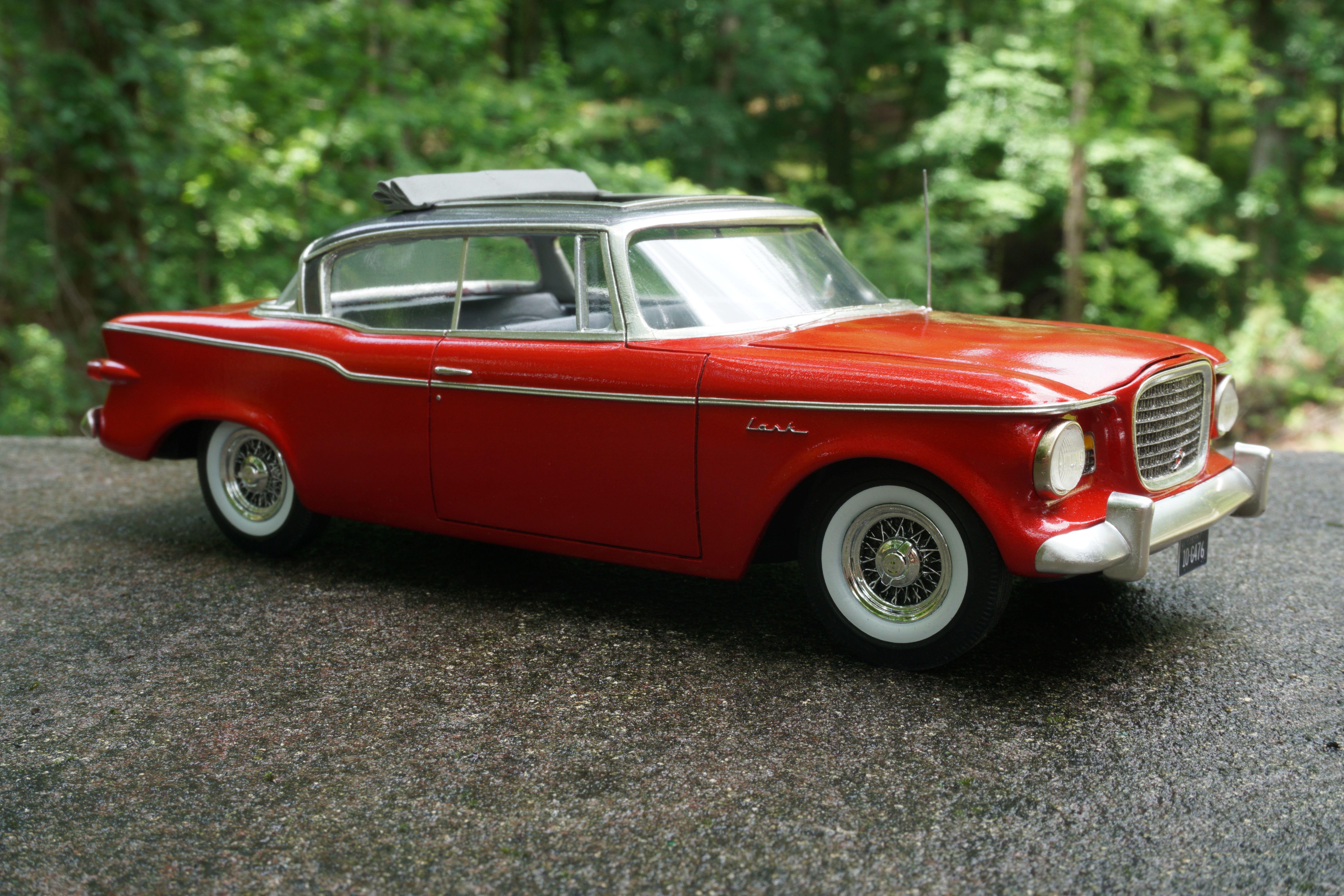

  11. After drilling the hole and test fitting the antenna, I mark the antenna with a very fine point sharpie where I want it to line up with the top of the fender hole. Then just below that spot I will put a SMALL drop of JB Weld or epoxy and when I lower the antenna into the hole the adhesive will 'build up' around the hole and, when dry, it will look like an antenna base. Rotating the wire just when the adhesive touched the hole will give the base a more even 'rounded' look. Then just, very carefully, paint it black.
  12. Thanks Jim. The antenna is 'steel music wire' from K&S Precision Metals. It is their .015" x 12". There are 4, 12 inch pieces in a pack. Check out the 'Hobbylinc' website. Part# 5498. Remember this stuff is music wire so it is HARD. I use a Dremel tool with a cutting disc and trim up the ends with the same disc. Don't use cutters or you will ruin them!

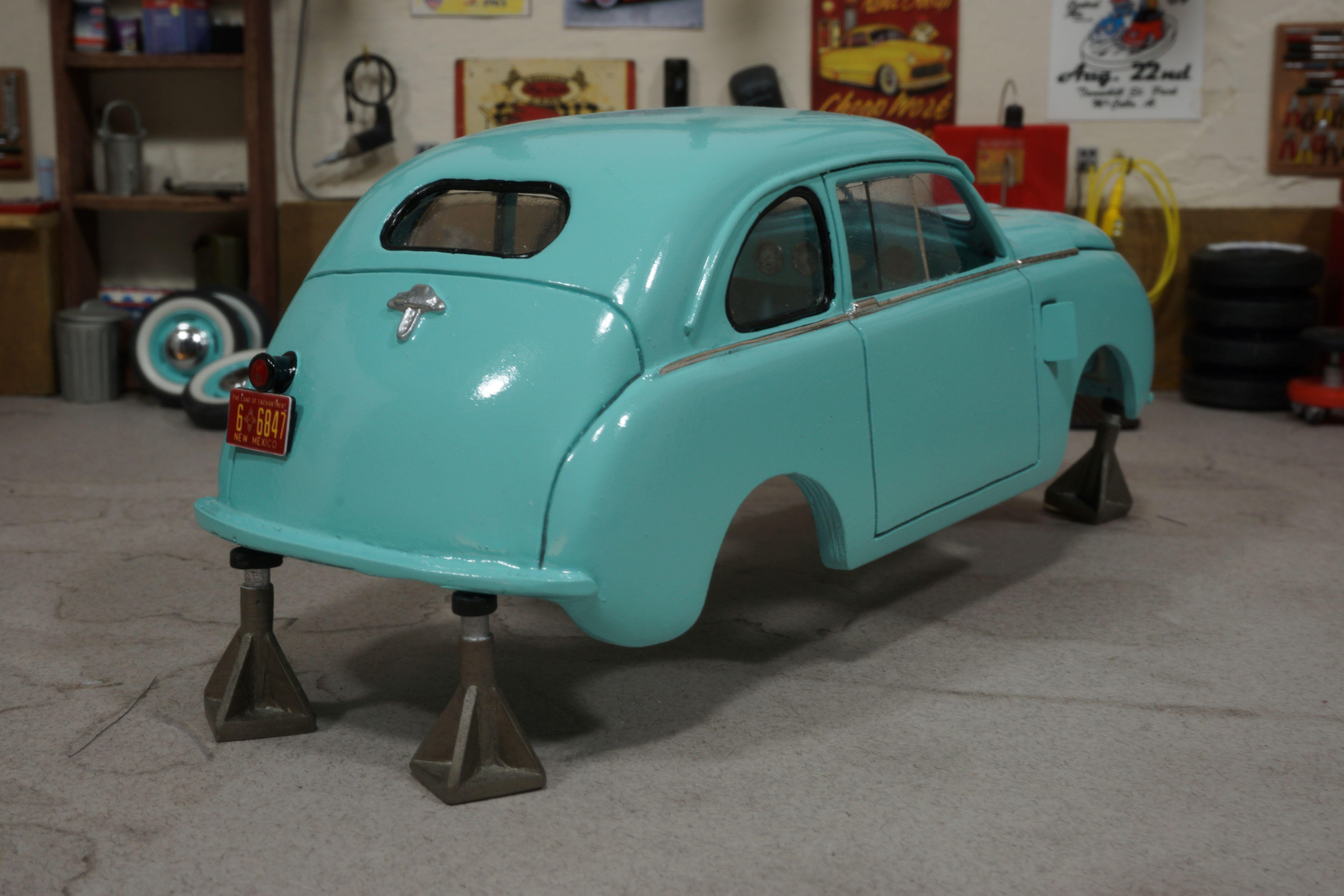

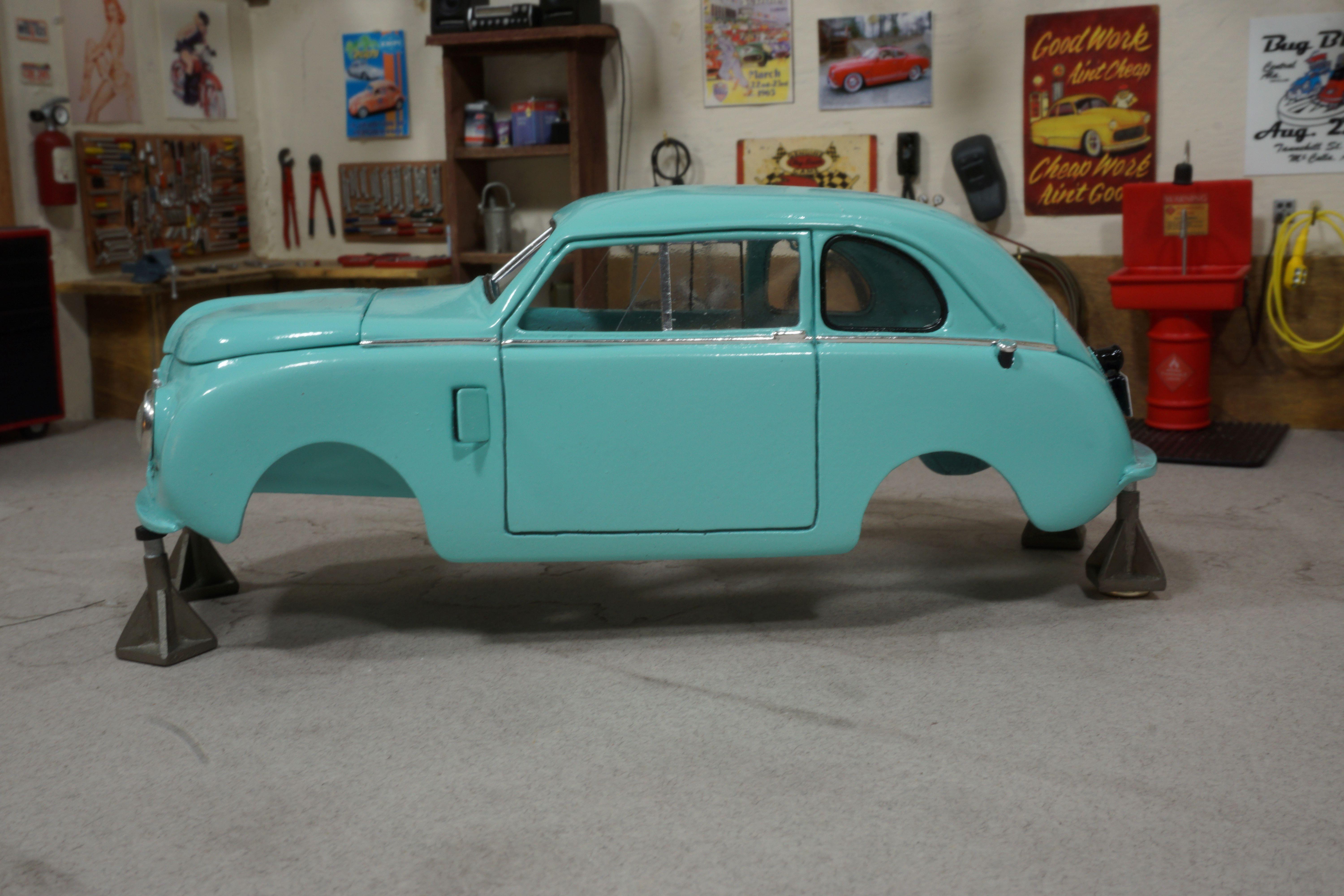

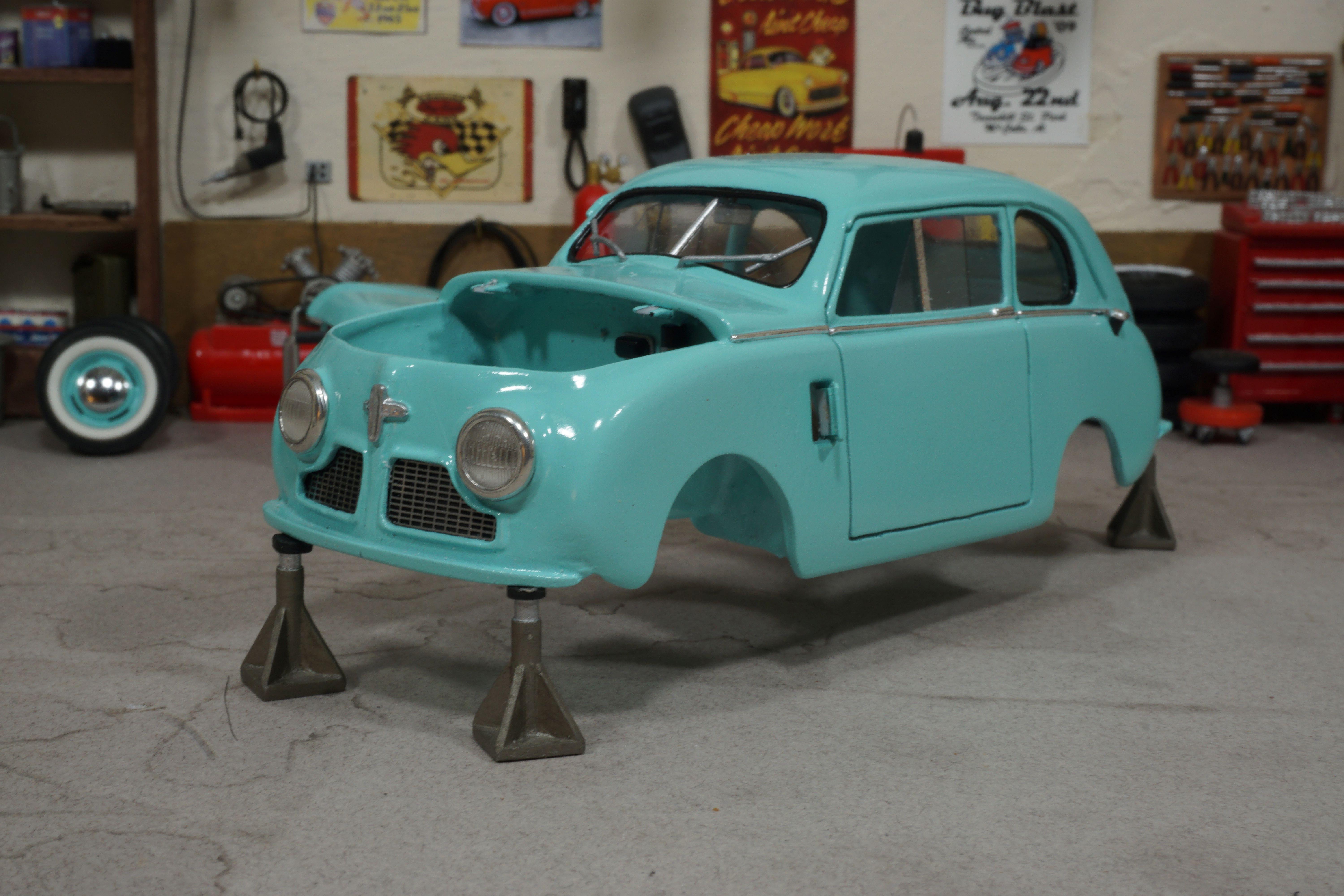

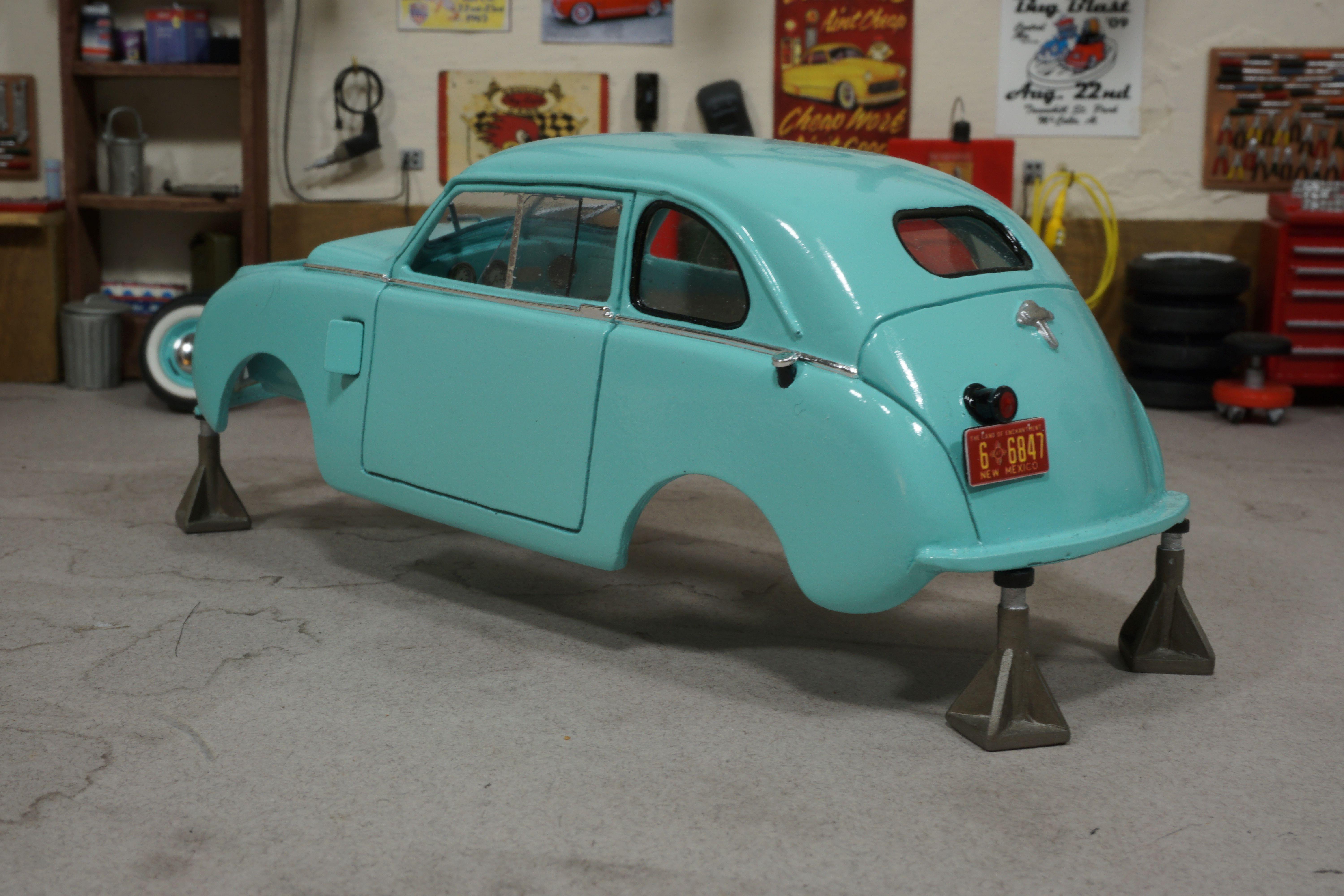

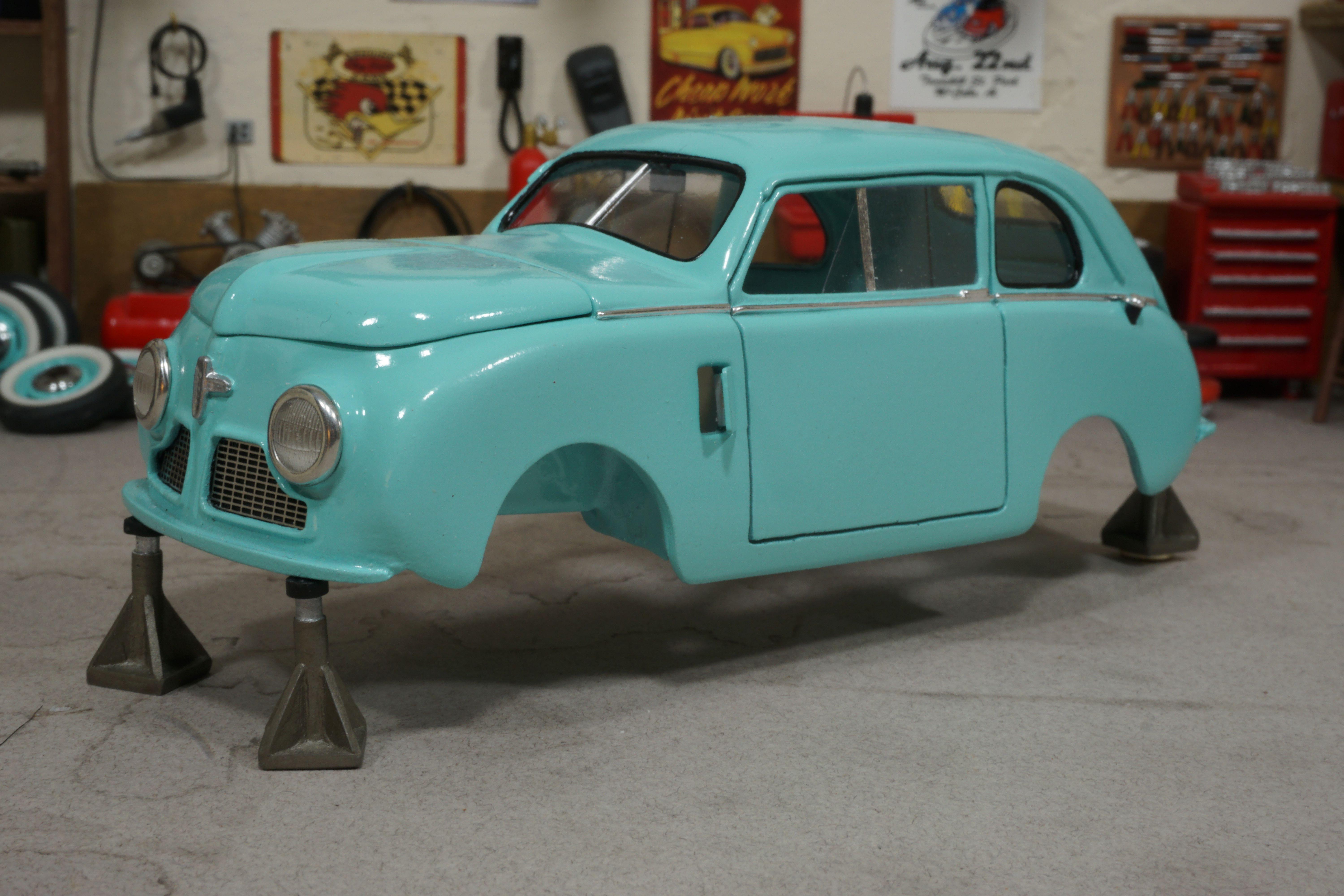

  20. There were 'dealers' for these cars. Crosley was a manufacturer of many consumer products. Powel Crosley was an inventor and entrepreneur who had his hand in many business ventures. You could purchase his automobiles from one of his appliance stores or a franchised shop. In fact, the cars width was base on the size of the 'double doors' on a typical store entrance, so if there was one in the store on display, it could be rolled out the front doors. My source, for the body, was R&R Resin. Parts came from a broken 1/24 Nash Metropolitan diecast, scratch building, and my parts collection. Info came from my automobile 'library' and internet.
