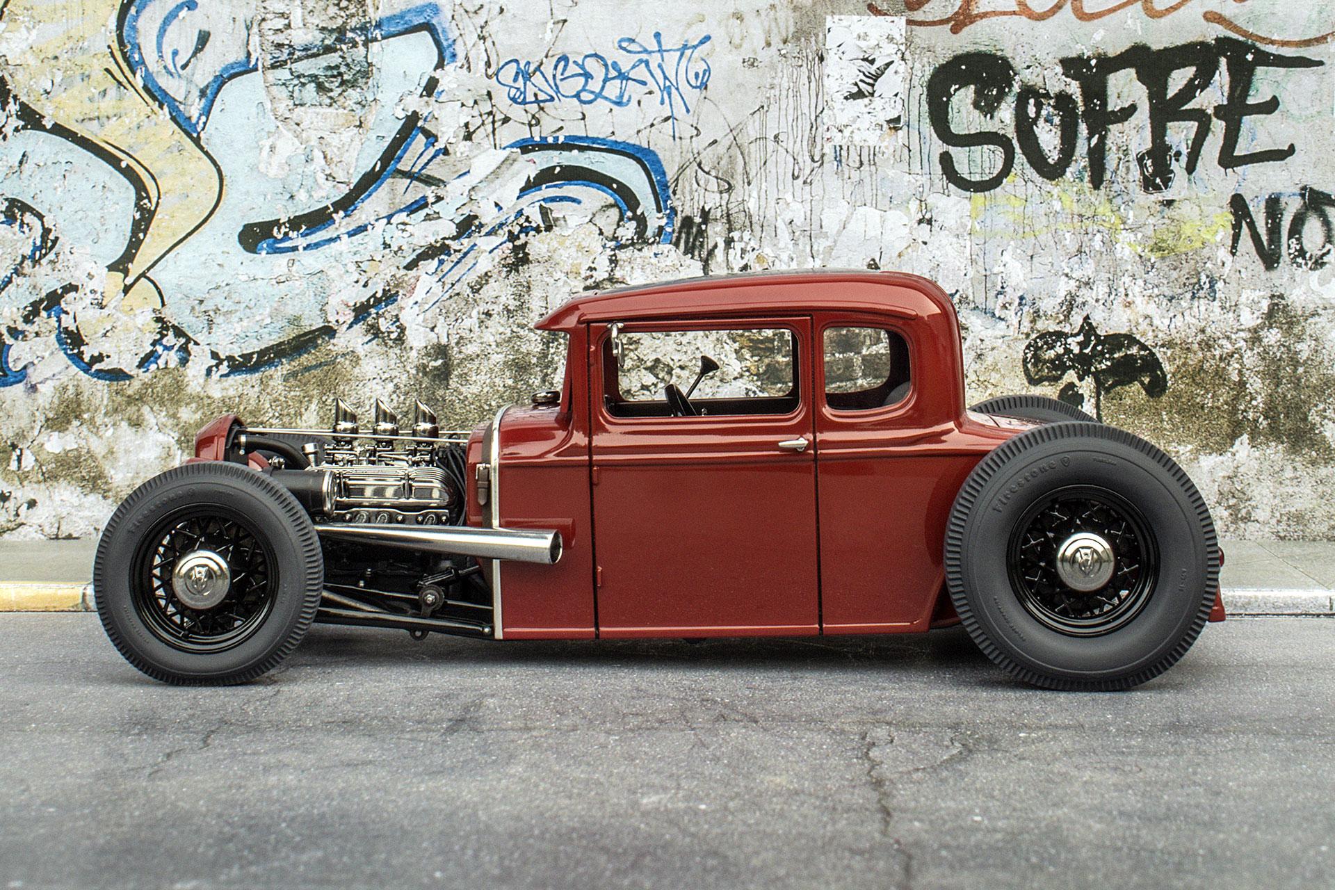

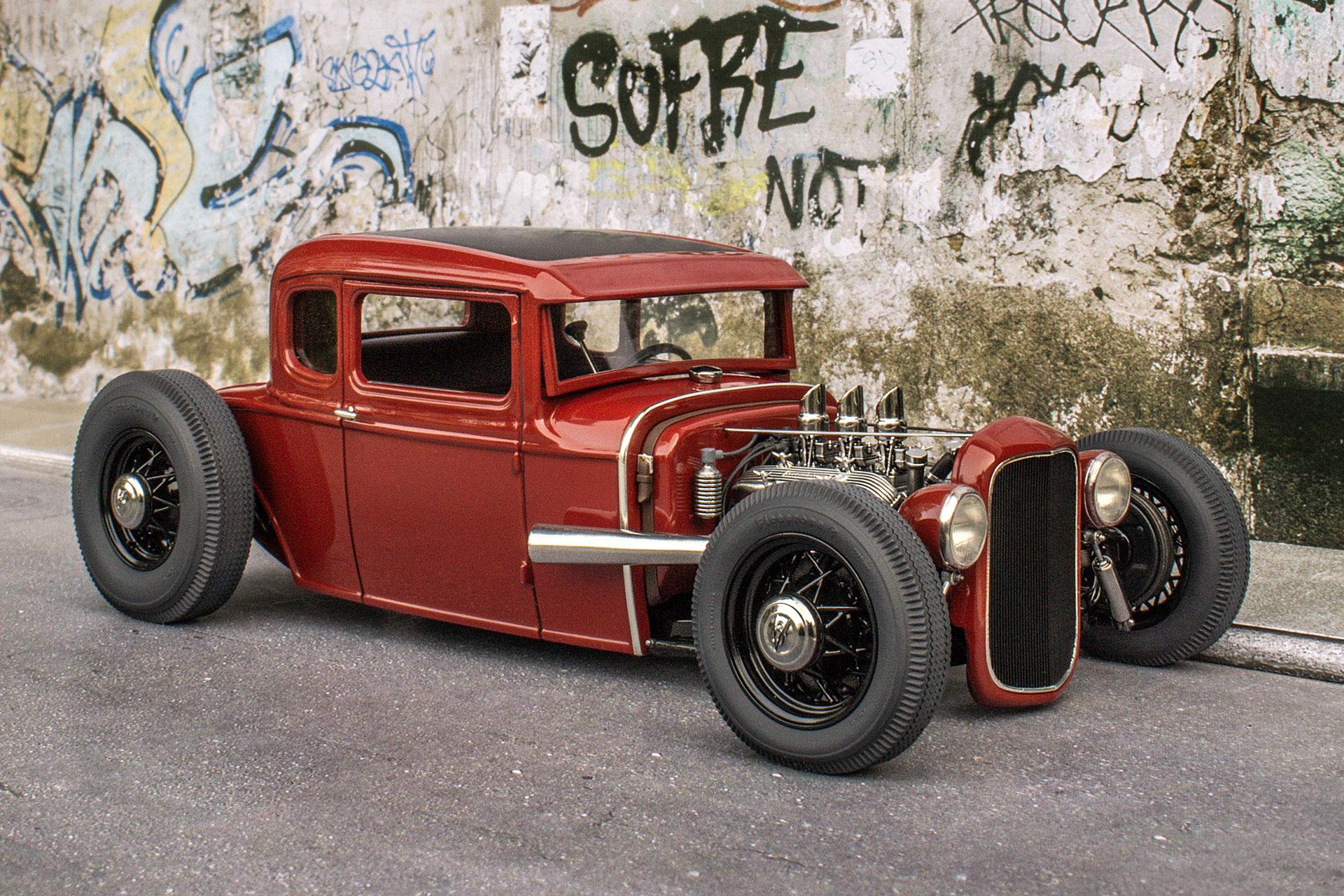

I've been wanting to build another hot rod and I kept coming back to images of Frankie Klepadlo's Model A- super low with some really nice details - you can see his real car here: https://www.instagram.com/panammotorcycles I started with the Revell 1930 Model A Ford kit and lowered and narrowed the chassis before adding a lot of custom designed and 3D printed pieces to replicate his ride. The first thing was to replicate the wheels and tires so I started with my earlier Firestones but added a bit more detail this time with extra sidewall lettering and a deformation to the bottom of the tire to give it a bit of weight. I designed and printed the wire wheels and V8 hubcaps as well as the chopped grill and grill shell to match the actual car. Paint is Tamiya Dull Red with Mr Color GX100 Clear over top. The taillight housings were 3D printed and I made the lenses by shaping some leftover clear red sprue. I think the engine is the star of the show of the real build so I built spent the time to make the intake, exhausts, Offenhauser valve covers and generator to match. The chrome was all done with Alclad Chrome over Mr Color Gloss Black. One of my favourite details from the real build is the leather strap on the cowl. I 3d printed the buckle and then painted a couple of layers of masking tape for the strap. Thanks for looking! Martin.
