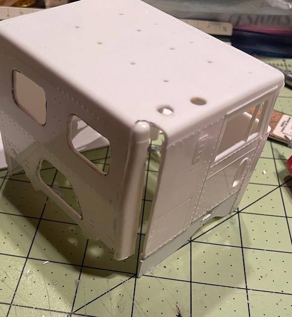

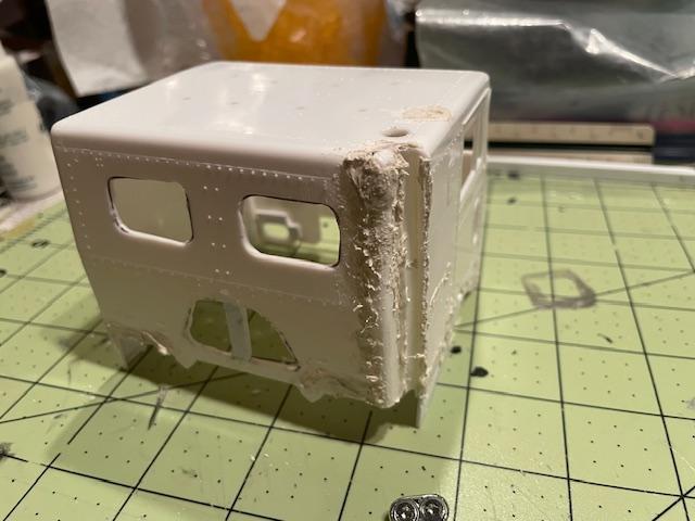

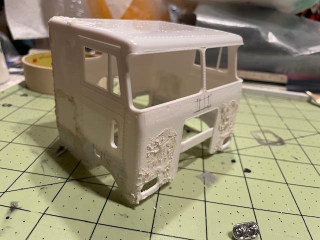

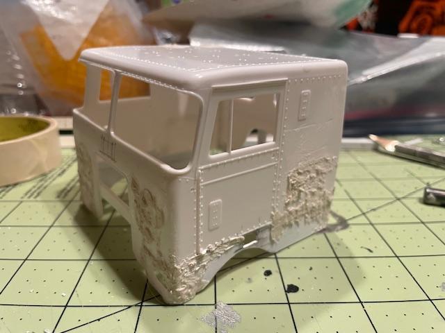

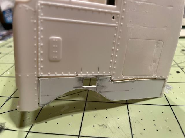

  6. I did something similar my first time I tried to tackle that correction. I couldn’t get them back into the right position, though, and it wound up looking a little cock-eyed, and with weird lumps when I tried to grind and putty it all smooth again. The second time, I just ground everything off, drilled in the right places, and then built it up again. I converted it from dual headlights to singles, though, so yours will be different. Also, I suspect that you will be better at the bodywork than I was. Good luck!

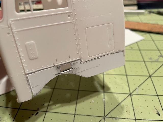

  9. Rivets! My first time working with Archer rivets, it’s a little painstaking but not too bad. I got the 0.11 ones but they might be a little small. We’ll see when I shoot another coat of primer!

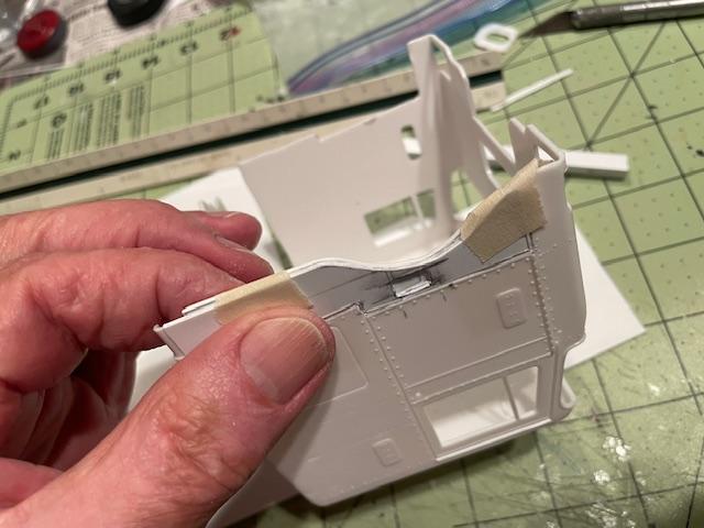

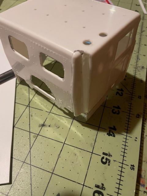

  10. Yeah, the AMT White Freightliner SD/DD kit is probably my favorite donor- you get two frames for the price of one; if you can dig up another front axle and suspension somewhere you get two almost complete chassis! I must have bought a dozen of these over the years and only built two straight out of the box. And one of those wasn't exactly straight out of the box, as I backdated it to the '60s. Looks like you're doing a great job with this one, I'll be interested in seeing what you come up with! Getting rid of the seam between the two cab halves can be tricky, I never liked that idea of AMT's.

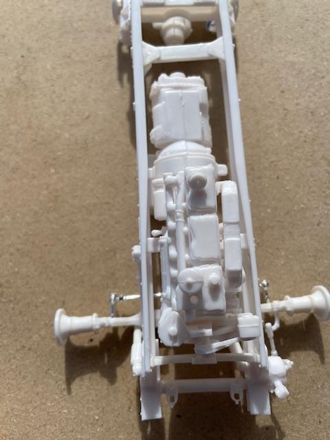

  14. Time to change the valve cover gaskets...
  15. That is one grimy engine! I can almost smell the dirty old oil just by looking at it!

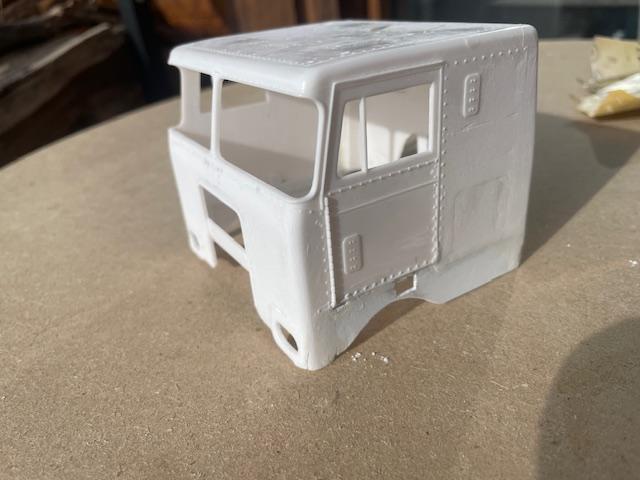

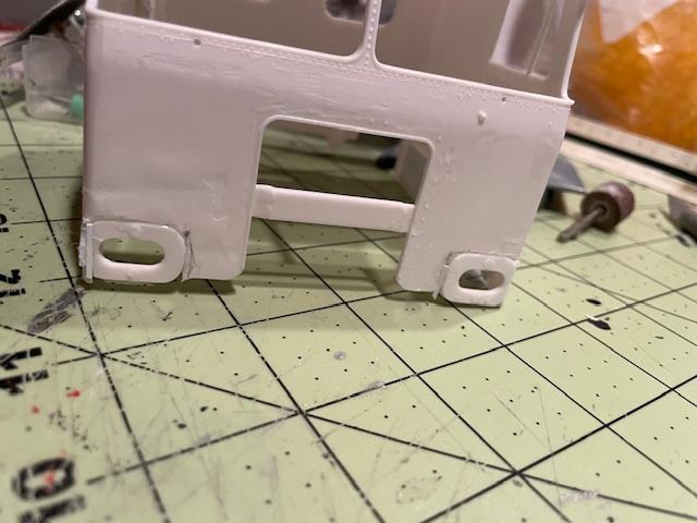

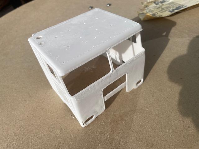

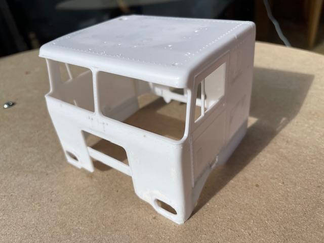

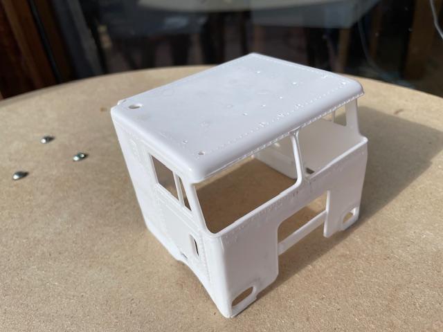

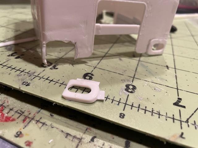

  16. The cab accessories are attached, and it's starting to look like an old Pete! Jürgen, not to worry! I ground the headlight surrounds down and they're about where I want them now. Same with the louver, it turned out perfect, thanks a million! My rivets are supposed to be here Friday, once the go on it will be ready for primer again. Time to focus on the interior now.

  18. Thanks, Victor! Actually, there is a T680, and it's on my list. Also an older-style (2010) Cascadia with the wide grille, and a new Volvo 860 and a Mack Anthem. I need to make some repairs to my printer, though, before I can tackle another big printing job, as some of those files are a little challenging.
  19. Thanks, Bren, for your help and inspiration on this one. I don't think I could have done it without your guidance... not to mention your help in slicing this enormous file!

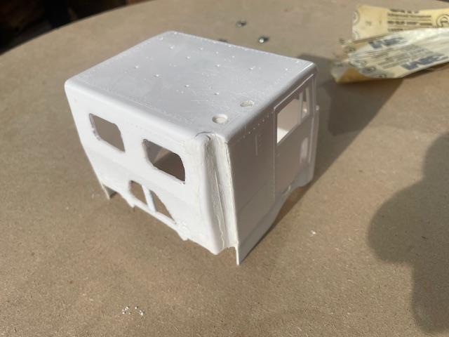

  20. First coat of primer... so, far so good. Jürgen was kind enough to design the headlight surrounds for me, and I had a chance to print them before my printer went kaput again. They extend out a little further than I like, but I can't realistically print them any thinner. The cab will take a little more filling and smoothing- I'll build up the surface around the headlights a little to blend them in better. Then, adding the luggage doors, flap at the front under the emblem, and a 3-D printed louver (also designed by Jürgen, thanks a million!)... once I can figure out how to print that tiny piece. Rivets are on order. It's getting closer!

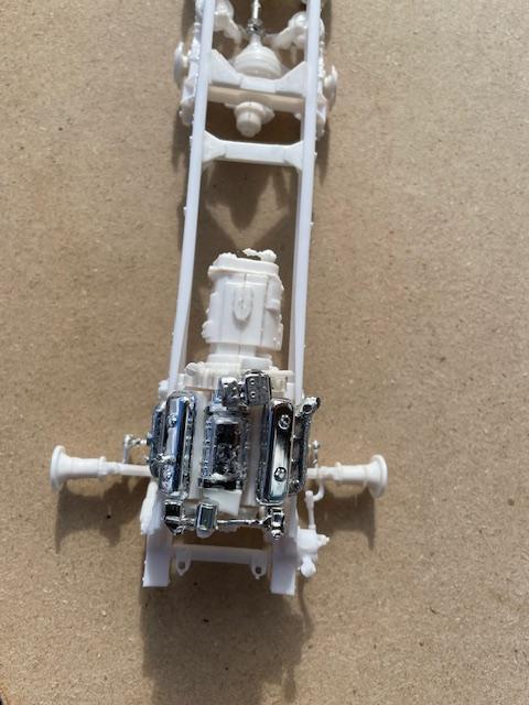

  22. Right, AMT liked to throw this engine, or variants thereof, into all kinds of different kits. I've probably put together 100 of them over the years, and I suspect you have too!
  23. That is one tuff truck! Love where you're going with it. Very impressive!
