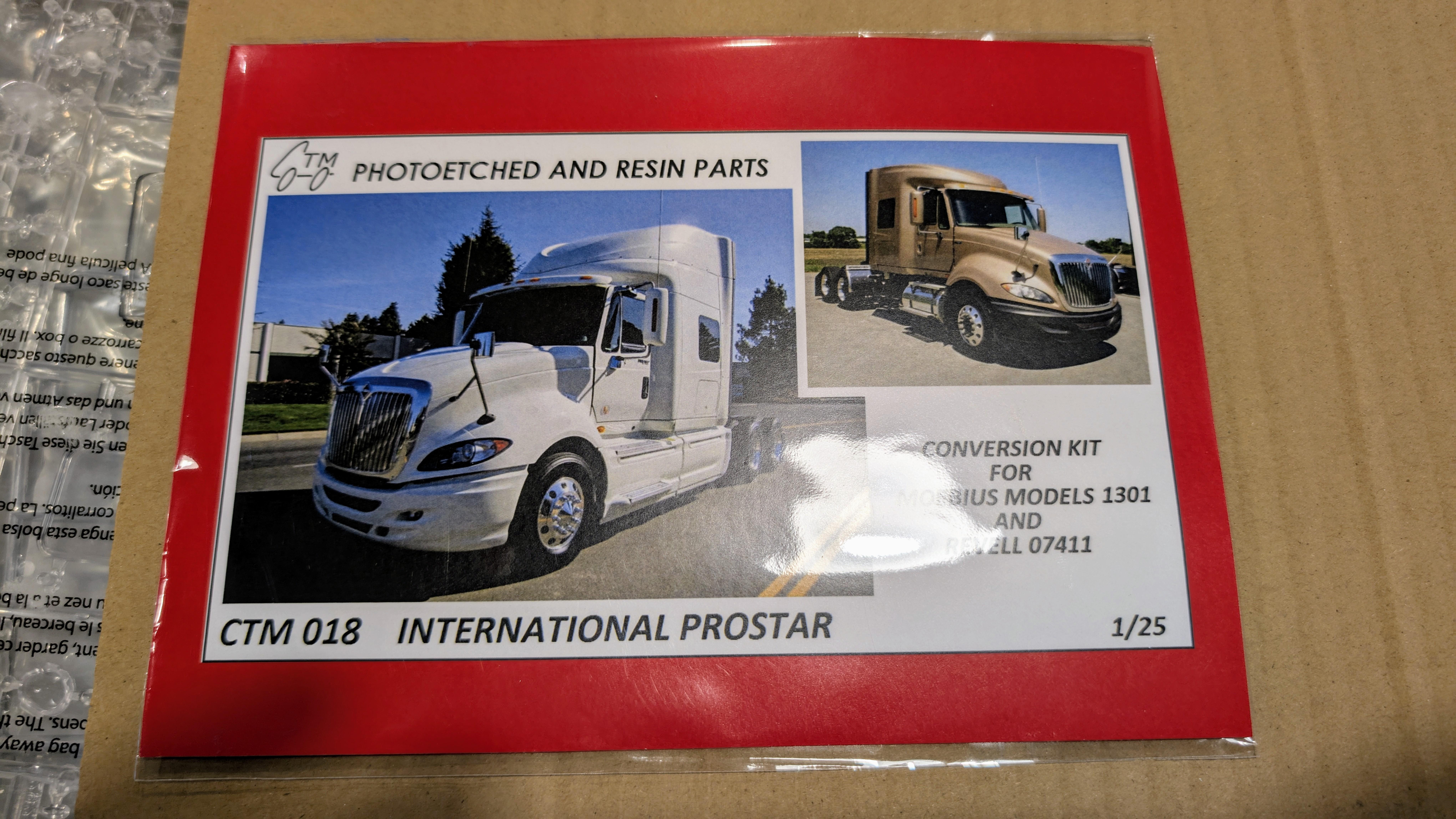

Lonestar - Hot Rod custom
LOBBS replied to LOBBS's topic in WIP: Model Trucks: Big Rigs and Heavy Equipment

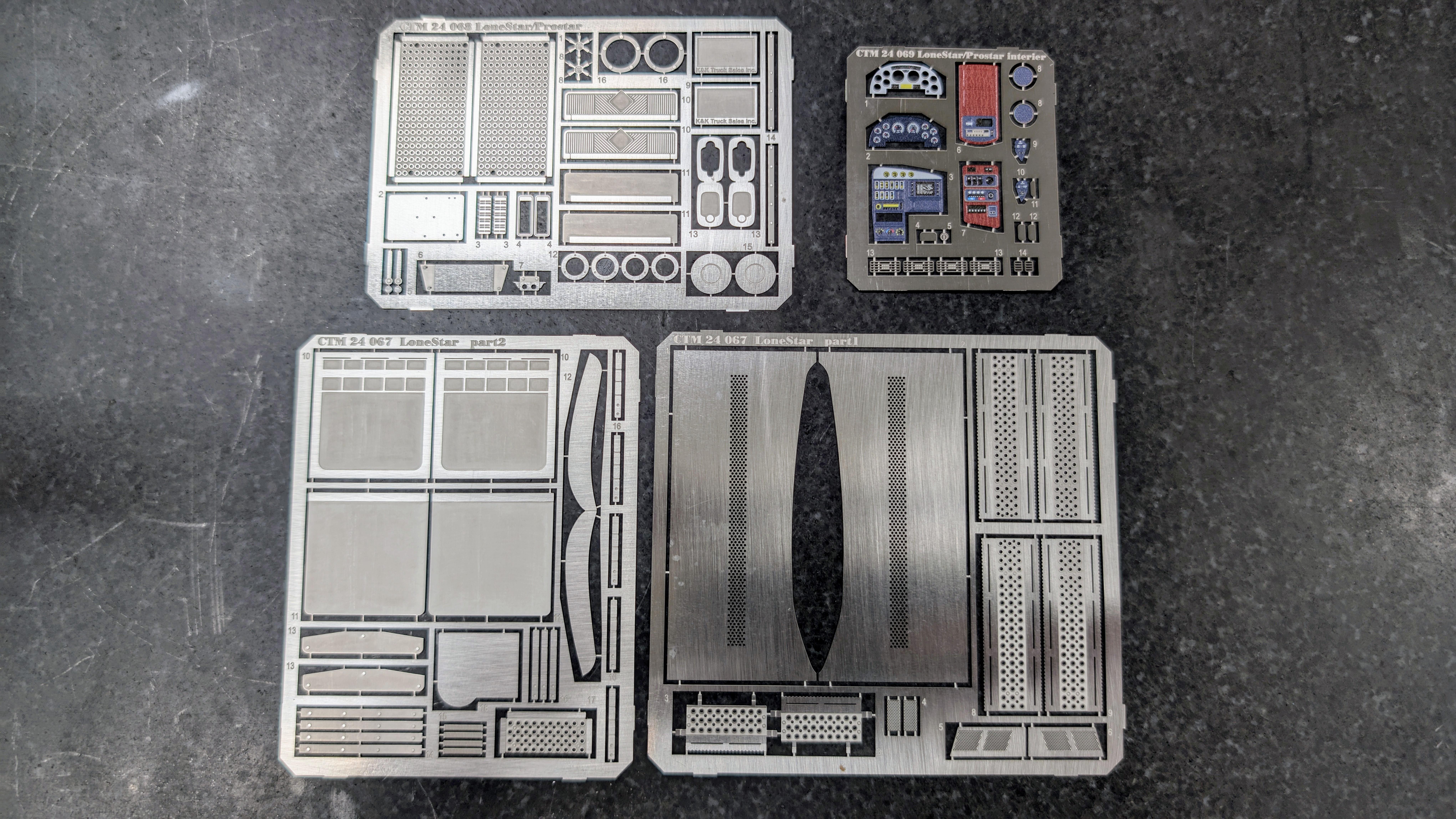

@vincen47 I happened to pick this one up when I was on ST Supply's site grabbing some CTM photoetch lights they had on sale. It's also an X15. Curious as to what variant it is, they said it's correct for a LoneStar or ProStar, but it's at least a Cummins instead of the MaxxForce. I don't believe it's the one that you had mentioned but I also know that it's not the Auslowe engine. Maybe it's a new contender? -

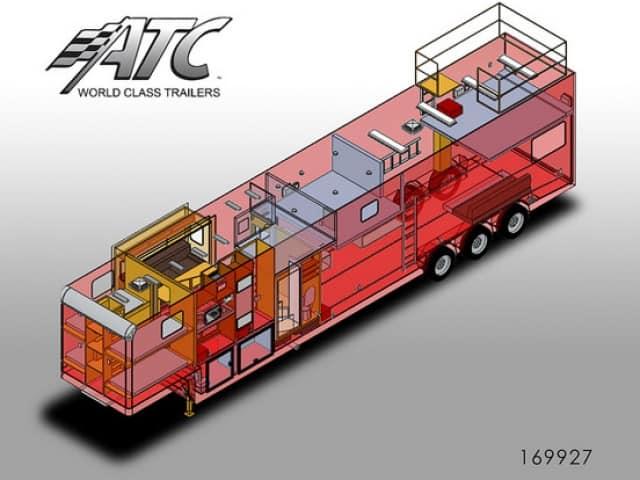

Took a bit of a break this evening before getting the walls and roof shelled in. Next up will be adding detailing, the stabilizer legs up front and the between axle storage framed in so to finish up the exterior bodywork. My personal version will be a "double stacker" in the garage with a "full floor lift" so that I can have more living area in the front of the trailer. Basically, an internal four post lift would be able to raise a platform to make room for a lower car to be parked on top of the wheelhouses (slightly lengthened of course). Then I'll rollback the model some and draw up the more traditional fixed upper deck, lower workspace area. That one I'll likely put out on Cults3D or offer to print up to spec for the public. -

Deck plate and flooring added. The math on the Featherlite print that I'm working from worked out to be .75" between whatever deck plate they're using and flooring materials. Almost looking like a real trailer now. Also went ahead and reworked the front corners for an 8" radius on the leading edge of the trailer. -

Reworked the frame to eliminate the C-section. I'll just draw up some major drop axles to get the clearance that I need to run the standard height super single trailer tires. I don't need to pass a DOT inspection 😅. At this point, I don't actually see myself using any parts from the Moebius Smooth Side but it's good to have for taking reference dimensions off of. I don't claim to be an expert at trailer design but I am working from a few images that I've been able to find of "unskinned haulers". The floor is aluminum 2x4s on 12" centers with 4x4s at critical junctions. Basically, I'm just framing it in like I would a house. The wheel house frames are 2x2s on 16" centers as will be most of remainder of the trailer's structure. For printing purposes though, I may model the walls and roof as solid pieces exterior to interior. Also, if there's interest, I'll go back in and rework the structure around the wheel wells to the proper proportions for the more correct low profile duals setup and save it as a separate configuration. I'd just have to lower the upper part of the framework and maybe make the opening length wise not quite as big since the tires will be of a smaller diameter. Now on to the fun stuff of fleshing out the actual "race hauler" part of the trailer. I've got 3 weeks before we move so I'm hoping to have this drawn up by the time we settle in and I can get my 3D printer set back up since I really can't do much in the way of physical building at the moment. -
