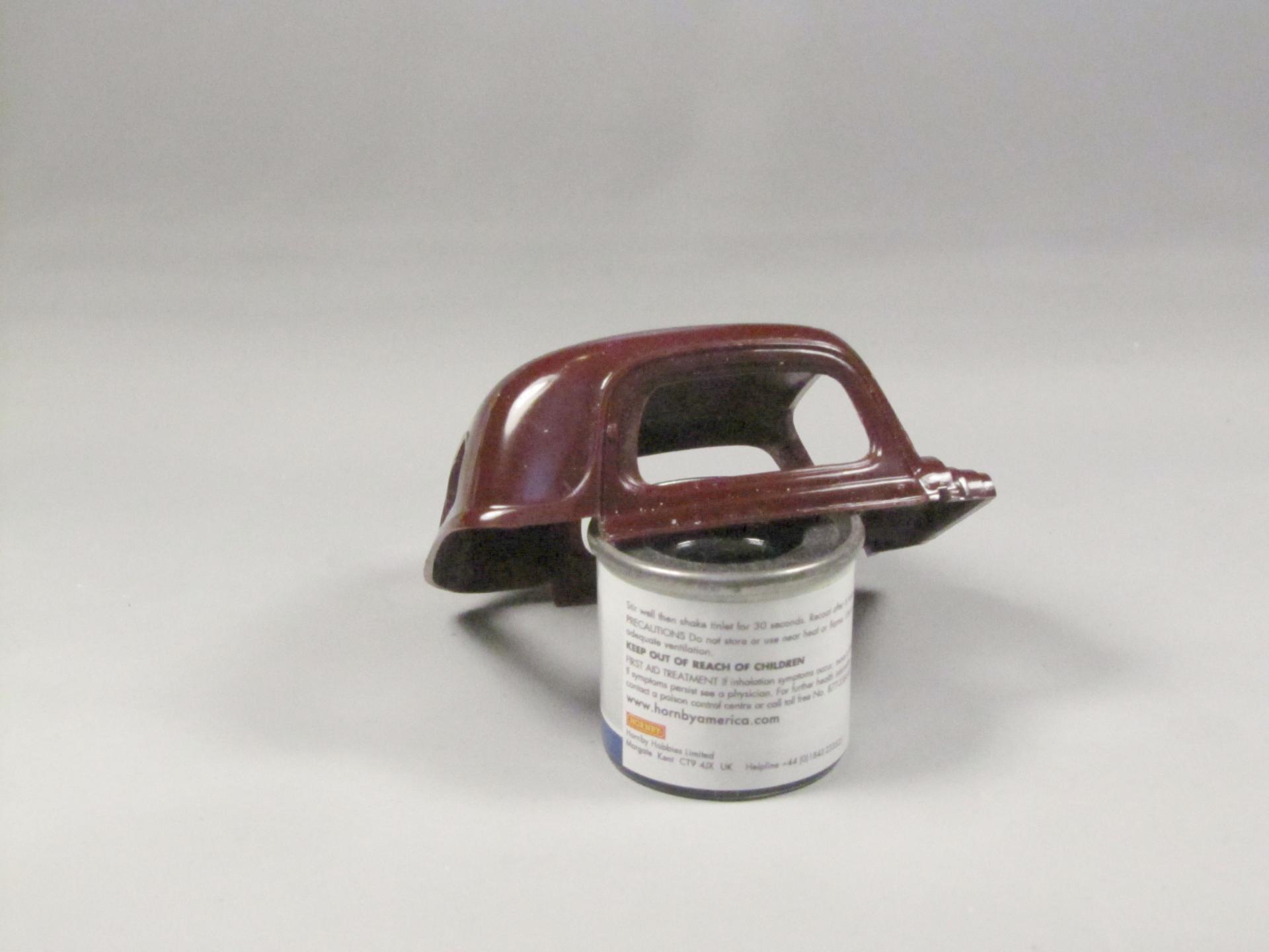

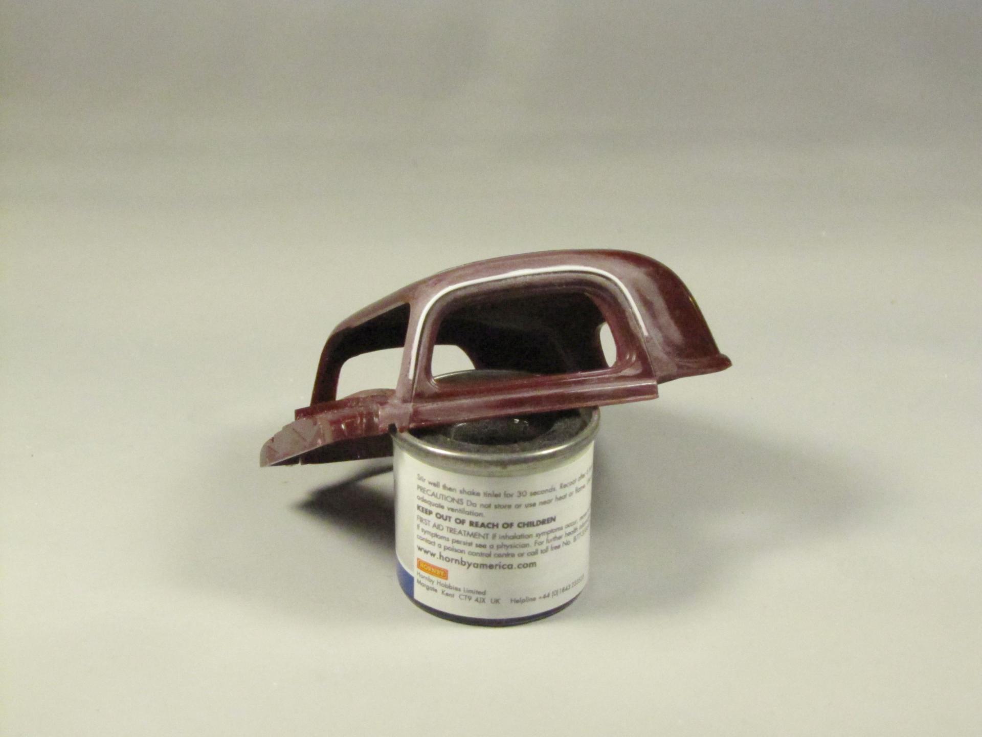

All the shaping was done with assorted needle files, the filler used is Zap-A-Gap CA glue, filed and and sanded to shape with bits of 400-grit sandpaper and a lot of patience.
OK, my turn! A couple of years ago, at the Detroit NNL, I scored a MIB 2nd issue of the Monogram '34 Ford (the shorter deeper box, stock parts only kit). Over this past holiday break from work, I decided "it's time". So into it I dig. The first thing I noted on the body, and coupe roof were some incorrect shapes (Monogram did the coupe roof with a considerable overhang at the sides, with a molding above and behind that speaks more of drain moldings (which those bodies did not have, and the belt line moldings looking more like a couple of "rounded" steps, rather than having a prominent indented crease between the large molding and the the window surround. So, a whole lotta filing, and the adding of some strip styrene. Here we go, stock kit roof, to adding some .025" styrene strip stock, to the final shaping of the slightly flared-then-rolled-under edges of the A-pillar, above the door, and down the B-pillar/upper quarter panel:
