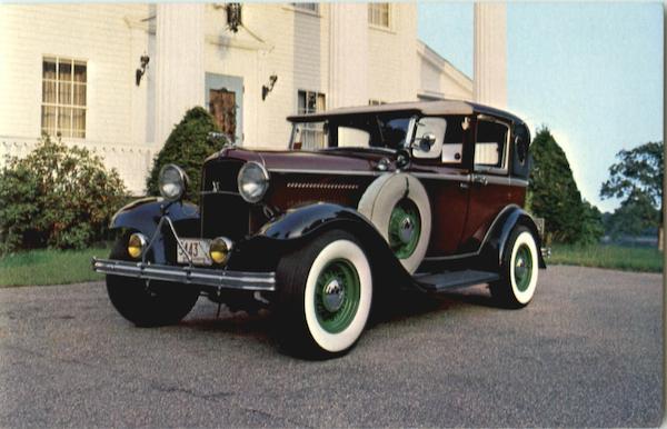

You are mostly correct! Although, after I started this project, I found this 1932 Ford Town Car... look closely and you'll see a small oval rear quarter window. Not sure, yet! -KK
