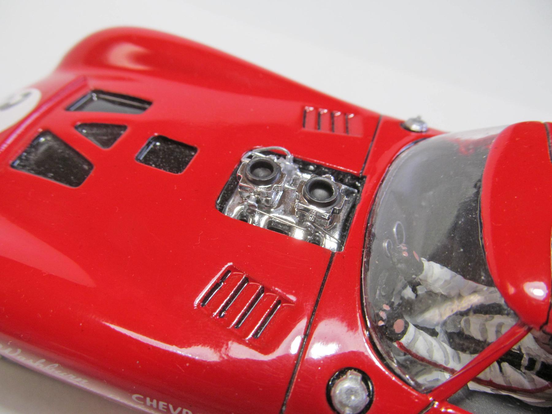

	As soon as I got the wheels and tires I adjusted the stance by shortening the front post. Rear was fine. A couple of other modifications were cutting out the molded in rear body screens and replacing them with an open mesh cut from an aluminum splatter screen. Another change was a necessity since one of the intake stacks on the engine detail panel was broken and missing. So I drilled them all out and replaced them with flared tubes. To be continued...
