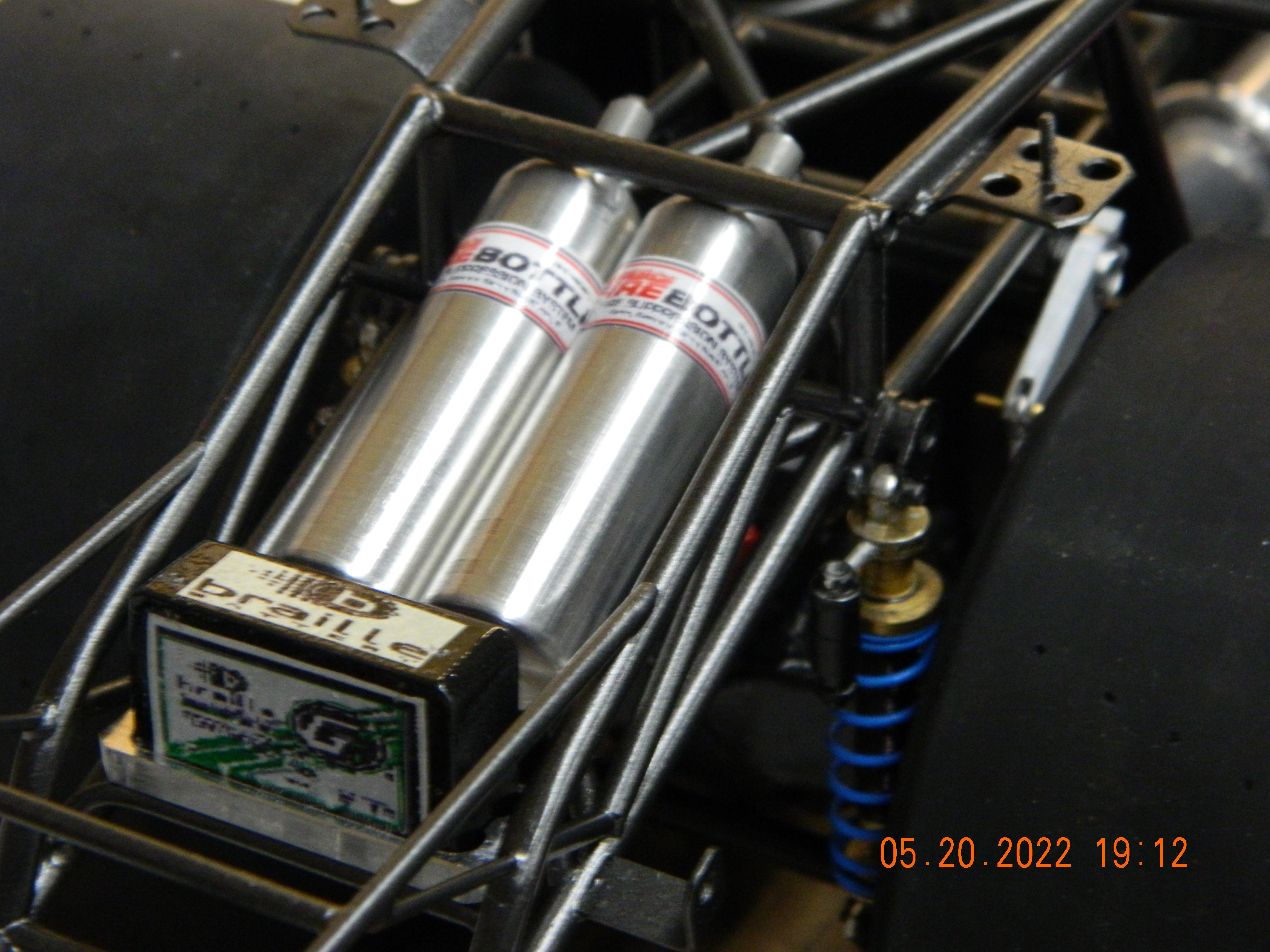

  6. so, i got some more stuff done. i'm working a lot faster than normal. some of the details may or may not get put into the car. i'm just really dis appointed in the thickness of the body and i don't want to put an extreme amount of effort into a build that, in the end, will not look right with body that is 1" thick in scale. any way.... fuel system plug wires more interior panels fire bottles hoosier mask bonded the scoop to the body

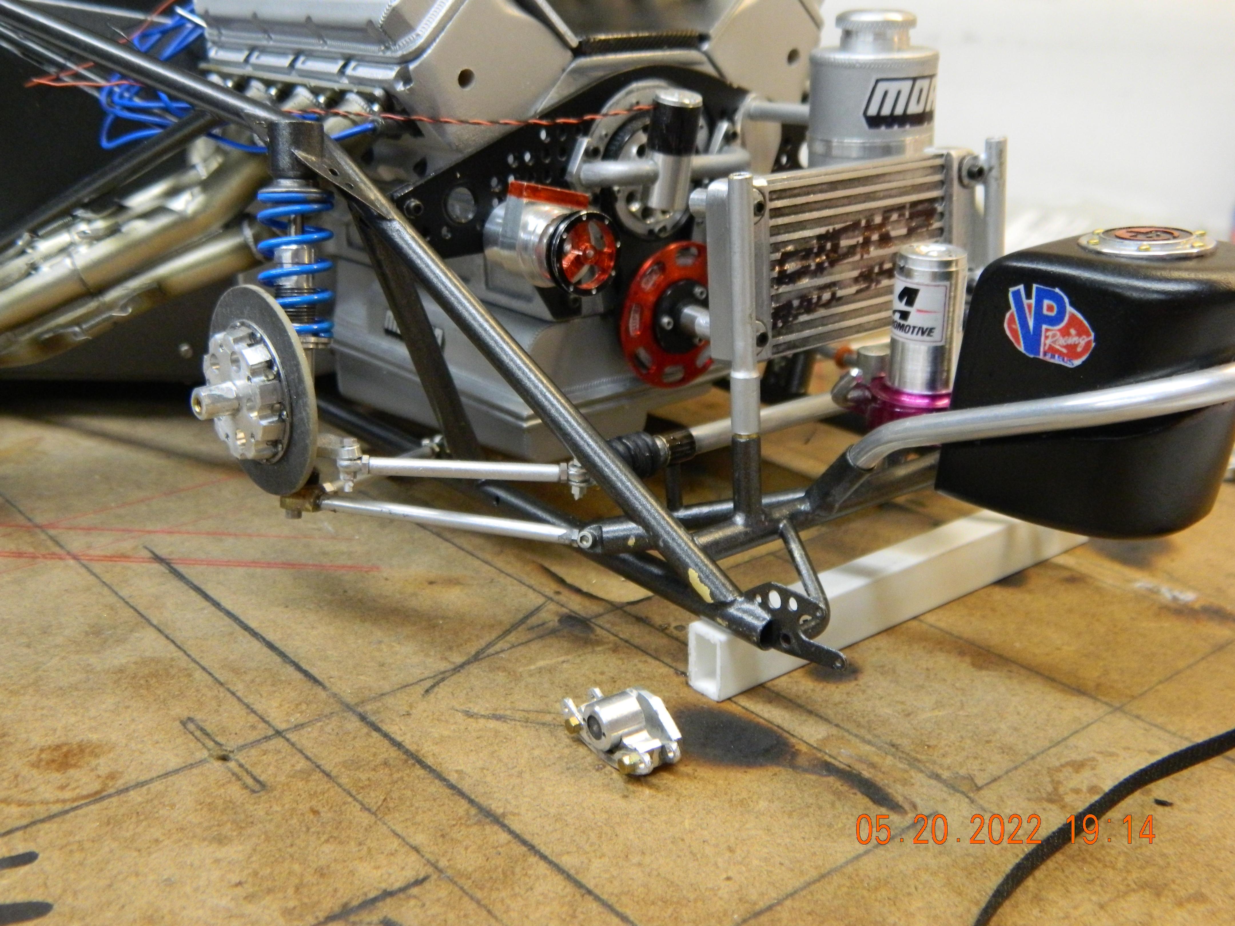

  13. here's some random parts. dry sump system / vacuum pump / frame clevis' and batt. shutoff/ upper rear shock mounts
  14. Edgar, thanks.
  15. front struts and susp.
  16. rear and susp. i seem to have lost my photos of the rear housing assy. the entire rear is put together like a real one. each plate is a separate piece and soldered together. rear axle spindles are turned brass and soldered in place on a small fixture i made.
  17. here are the headers.
  18. Henry, thanks. couple of more shots. the carbs.
  19. my absolute favorite part is the engine. this engine is based on a 5.2 inch bore space 822 cube Gene Fulton nitrous motor.it is all scratch built and fairly accurate.
