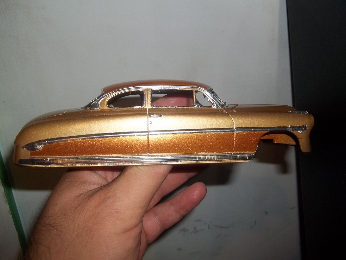

I gave this a try on a Mobius Hudson, used Micro Scale adhesive (I already had it on hand) and Meijer brand foil. Worked much better than BMF in my opinion.
Matthew, the door locks and the "Twin H Power" badge on the trunk lid were done using metal leafing, as I found it easier to do those that way. It basically amounted to painting them as one would with "chrome" paint, only using the adhesive size, then applying the leaf. I find that works sell on very small items that would be difficult to do with regular foil.
