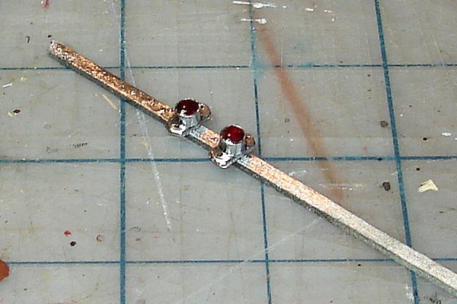

Harry P. Posted May 20, 2015 Author Posted May 20, 2015 Progress slowly but surely... I scratchbuilt the taillights. The bases are styrene, the bezels are brass tubing, the "chrome" is Spaz Stix, and the lenses are 5-minute epoxy painted with transparent red:

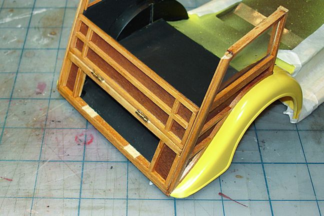

Harry P. Posted May 20, 2015 Author Posted May 20, 2015 I revised my design in back. Originally I was going to go with a one-piece lift-up tailgate, but changed that to a two-piece. The lower part seen here will swing down, while the upper part (the glass area) will swing up...
