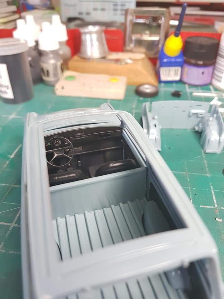

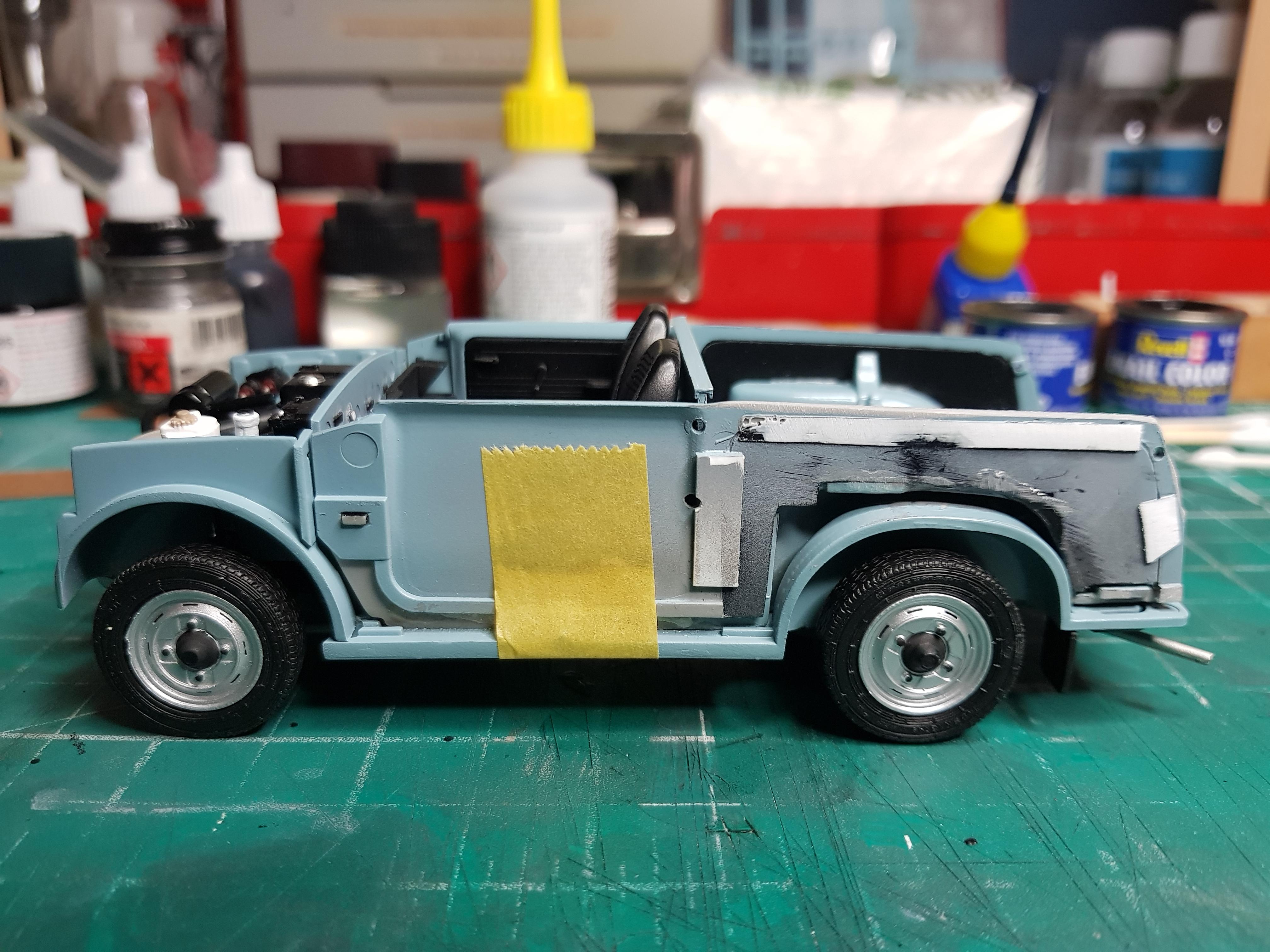

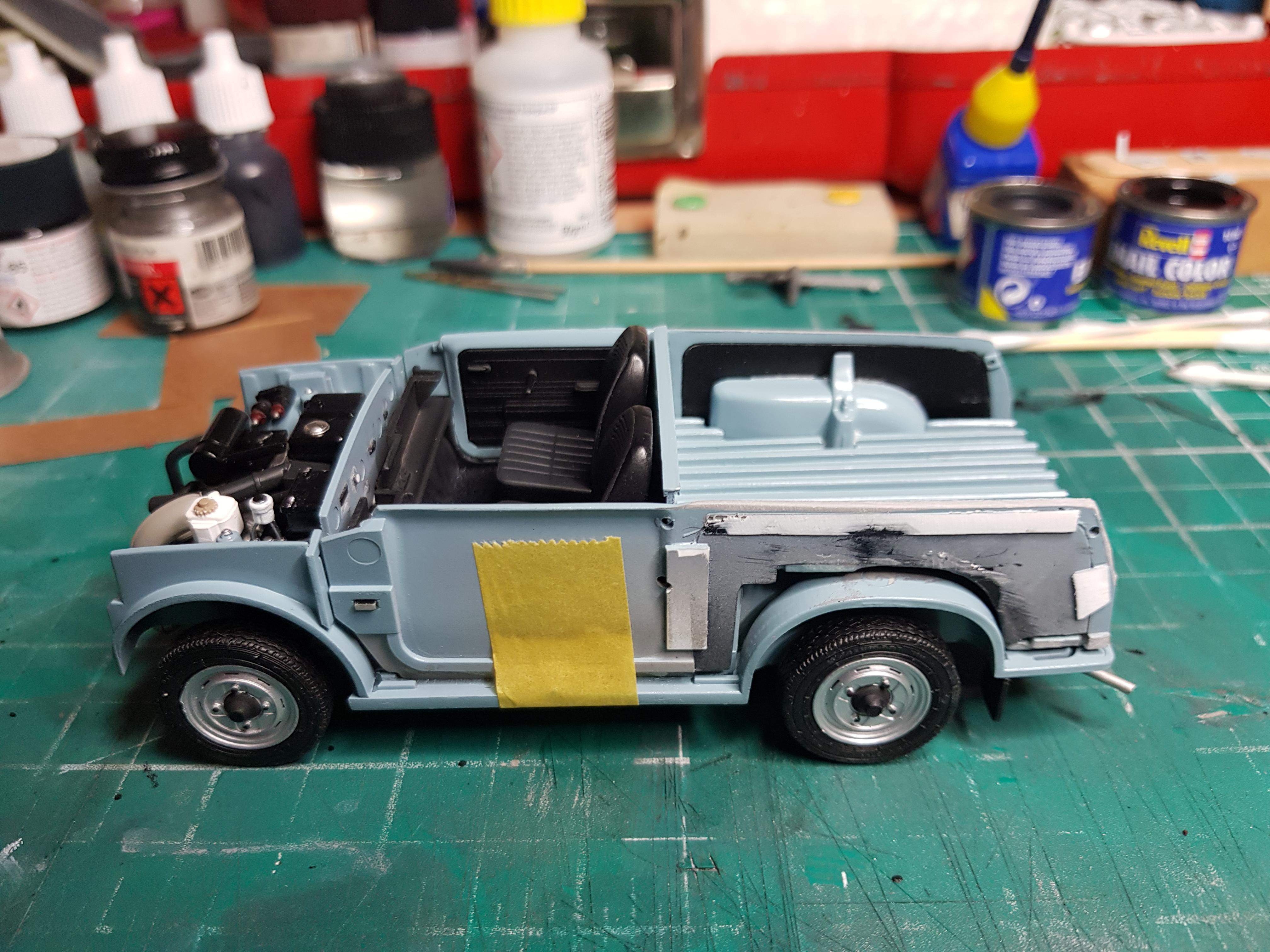

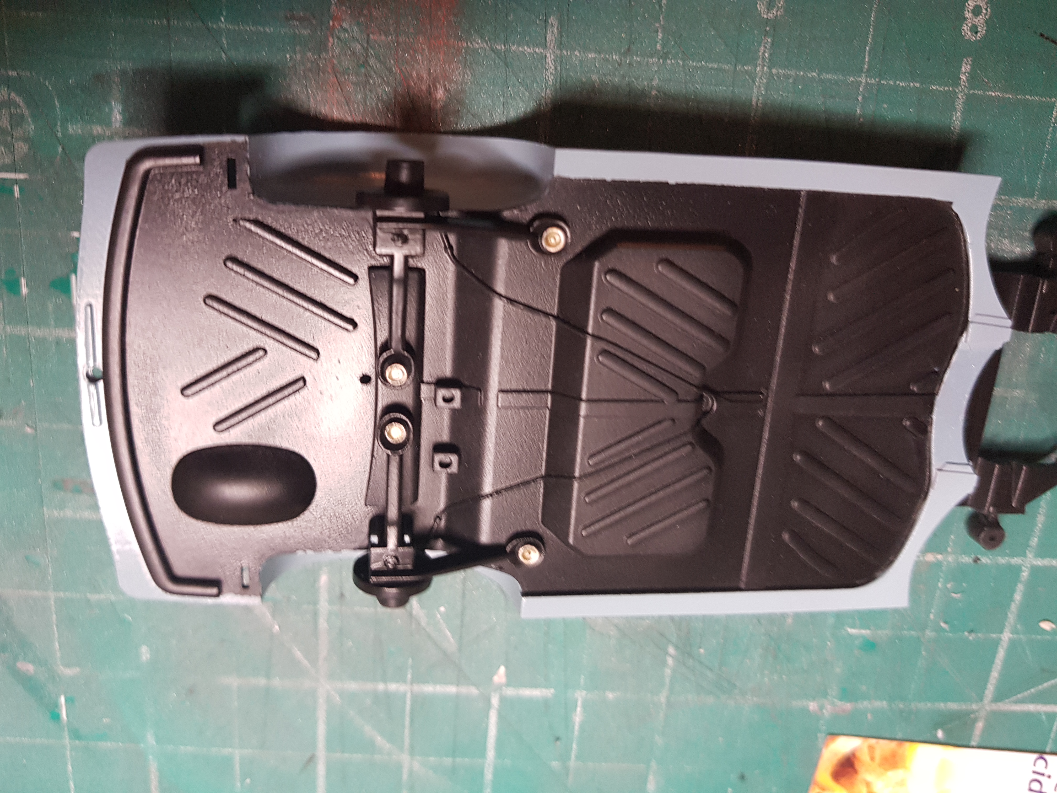

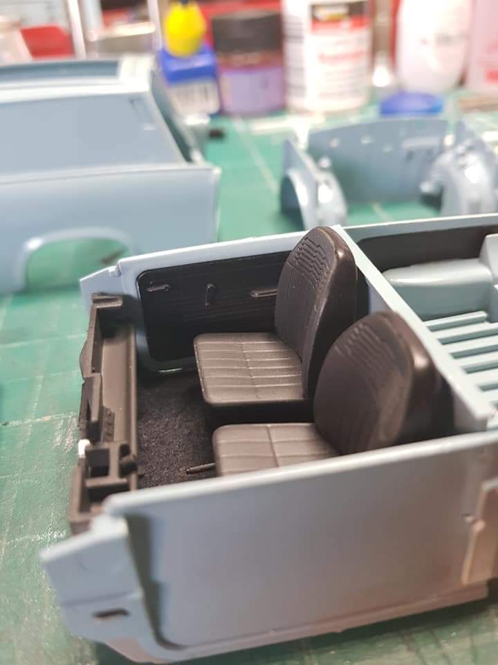

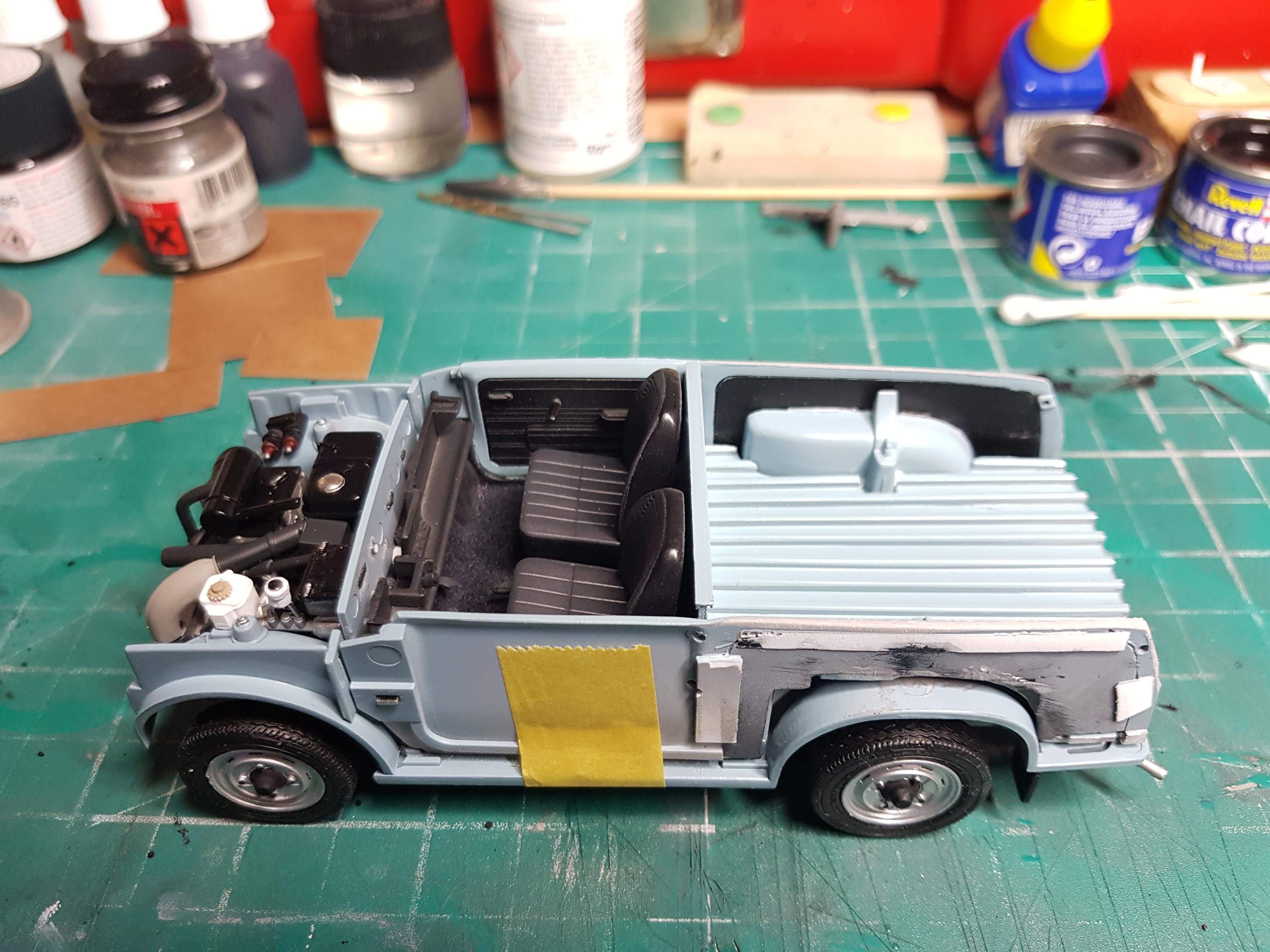

Can't believe it's been over there years this one has been sitting on the backburner, having a tidy and rearrange in the hobby room, found this one stored in various plastic tubs, tried a dry fit and things didn't want to go together,the ribbed floor I'd made was slightly too long, it needed about 3mm trimmed off it, then the side panels I'd scratch built needed sanding slightly so they could line up with the interior, but now everything fits just fine, just got to do a little airbrushing, engine,gearbox and front suspension and it was all go together permanently.

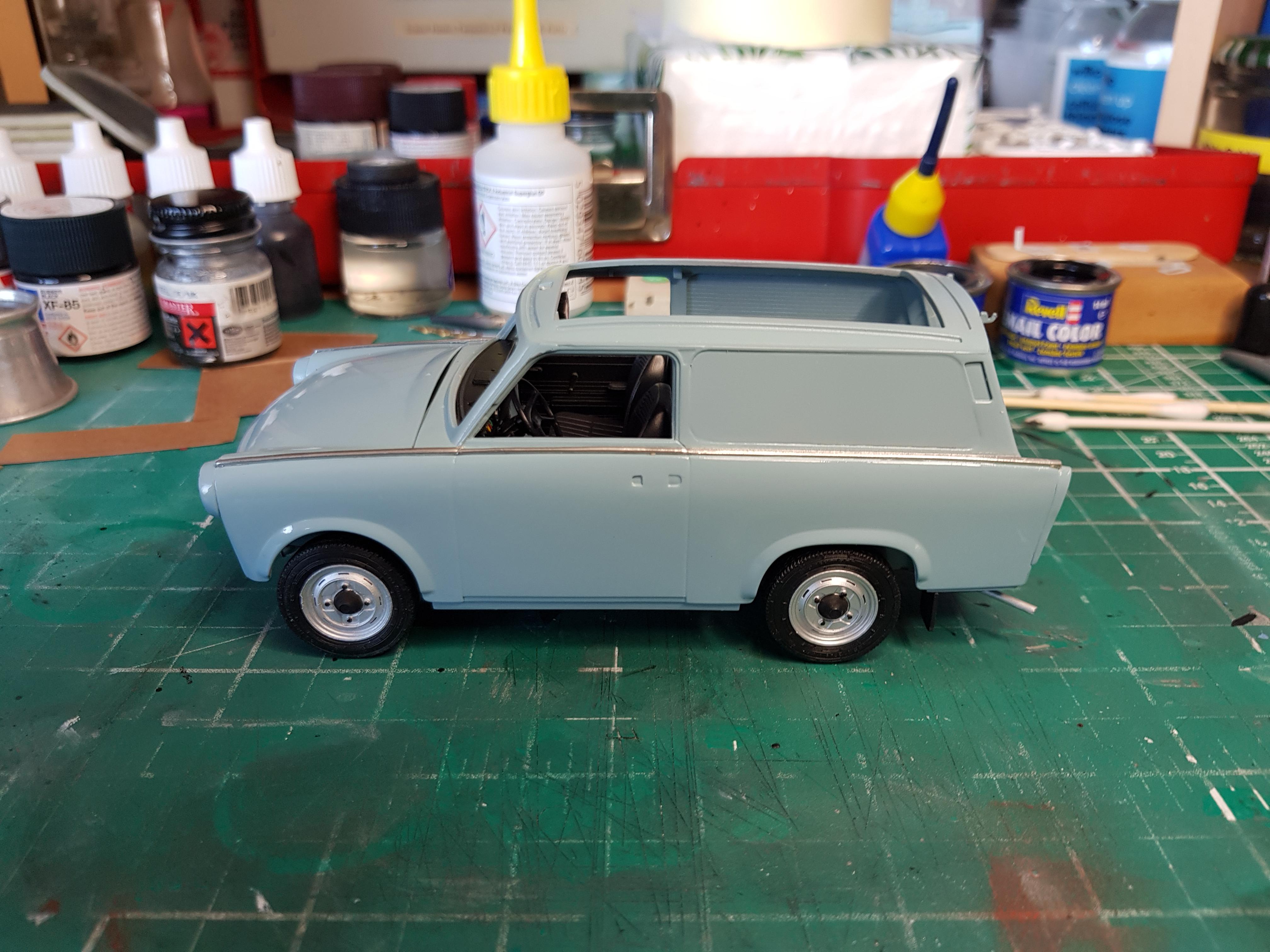

I found out just after i started this one that the side panels are stamped like the van, then cut out to fit the Windows to make the Universal (Estate) they are in real life made of steel as they are part of the skeletal bodyshell

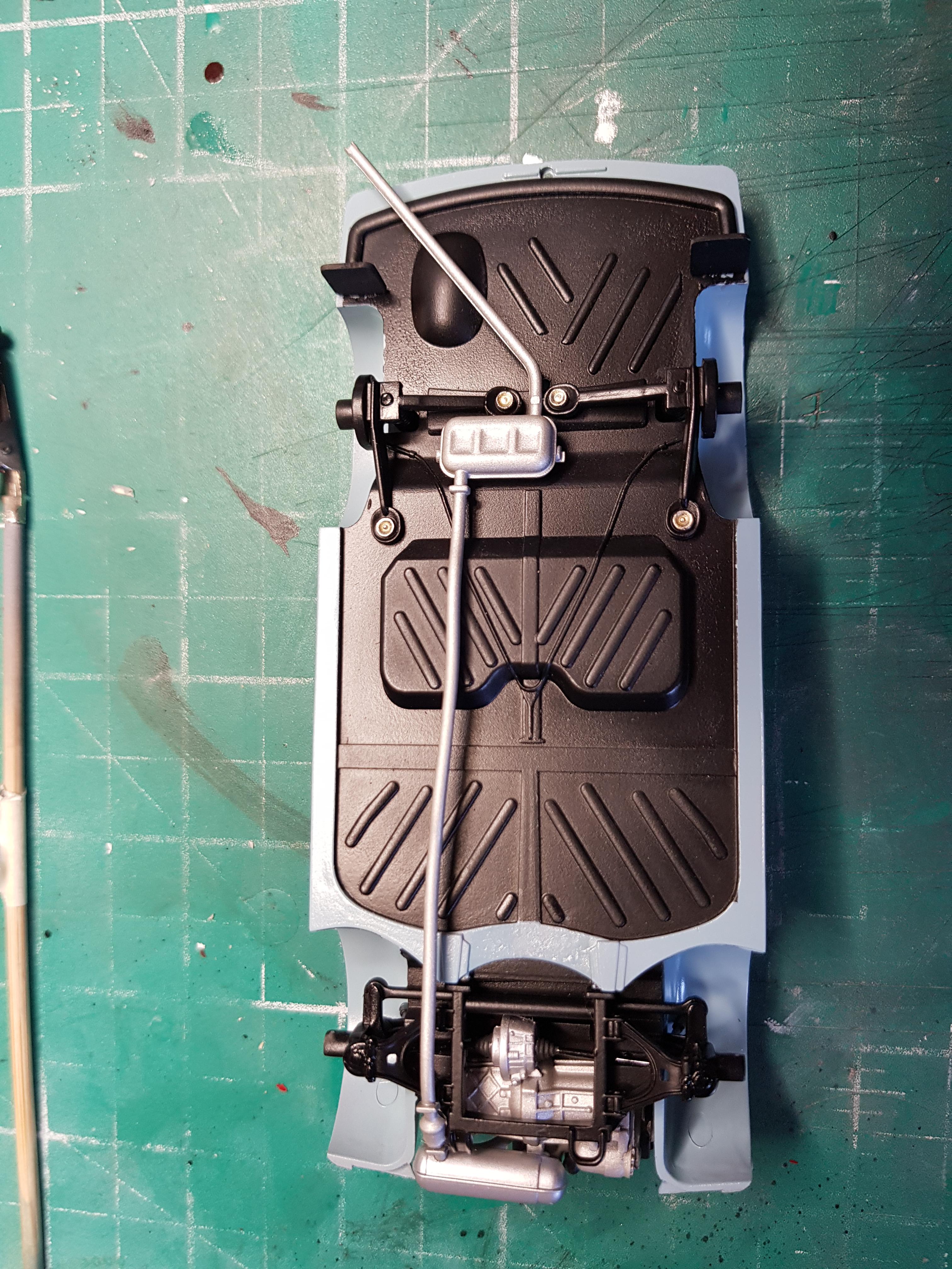

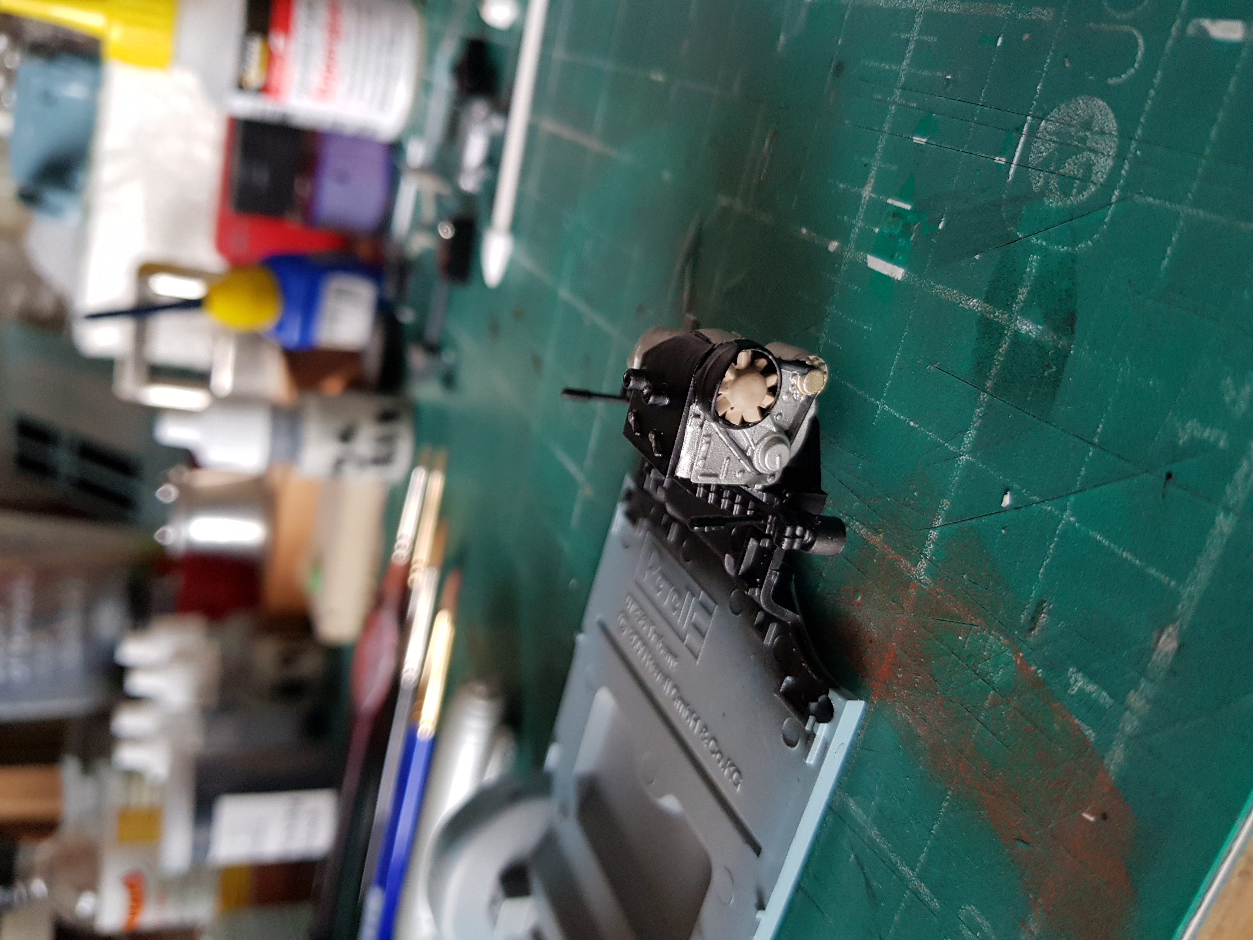

As I'm waiting for the paint on the Chevelle to harden so I can wet sand a few dust nibs out of it, I've made a little more progress on the Trabant, engine was airbrushed in Testors steel, other parts were airbrushed in various shades of grey,rear suspension was airbrushed in satin black with the fixing points picked out in Tamiya Titanium silver

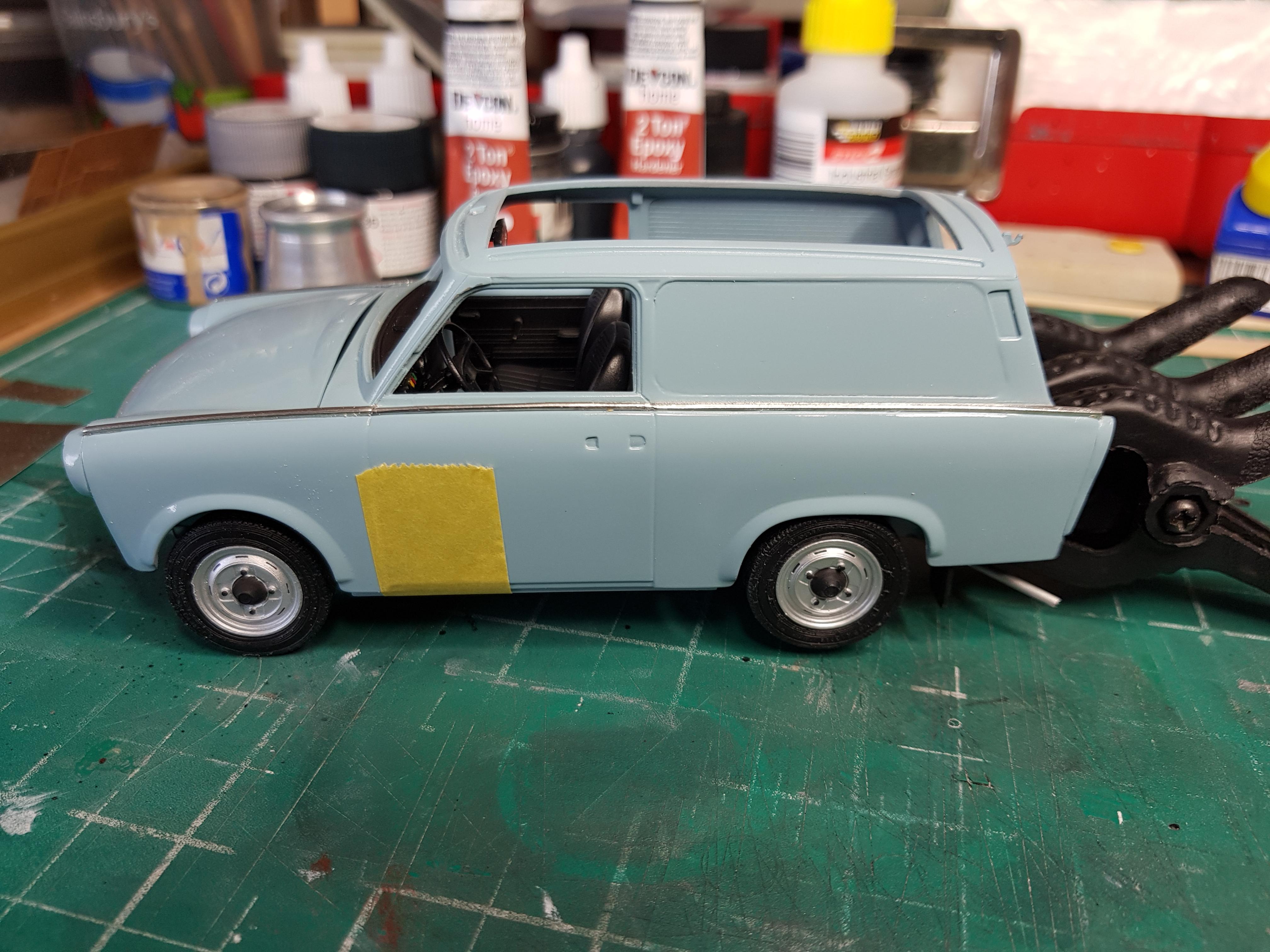

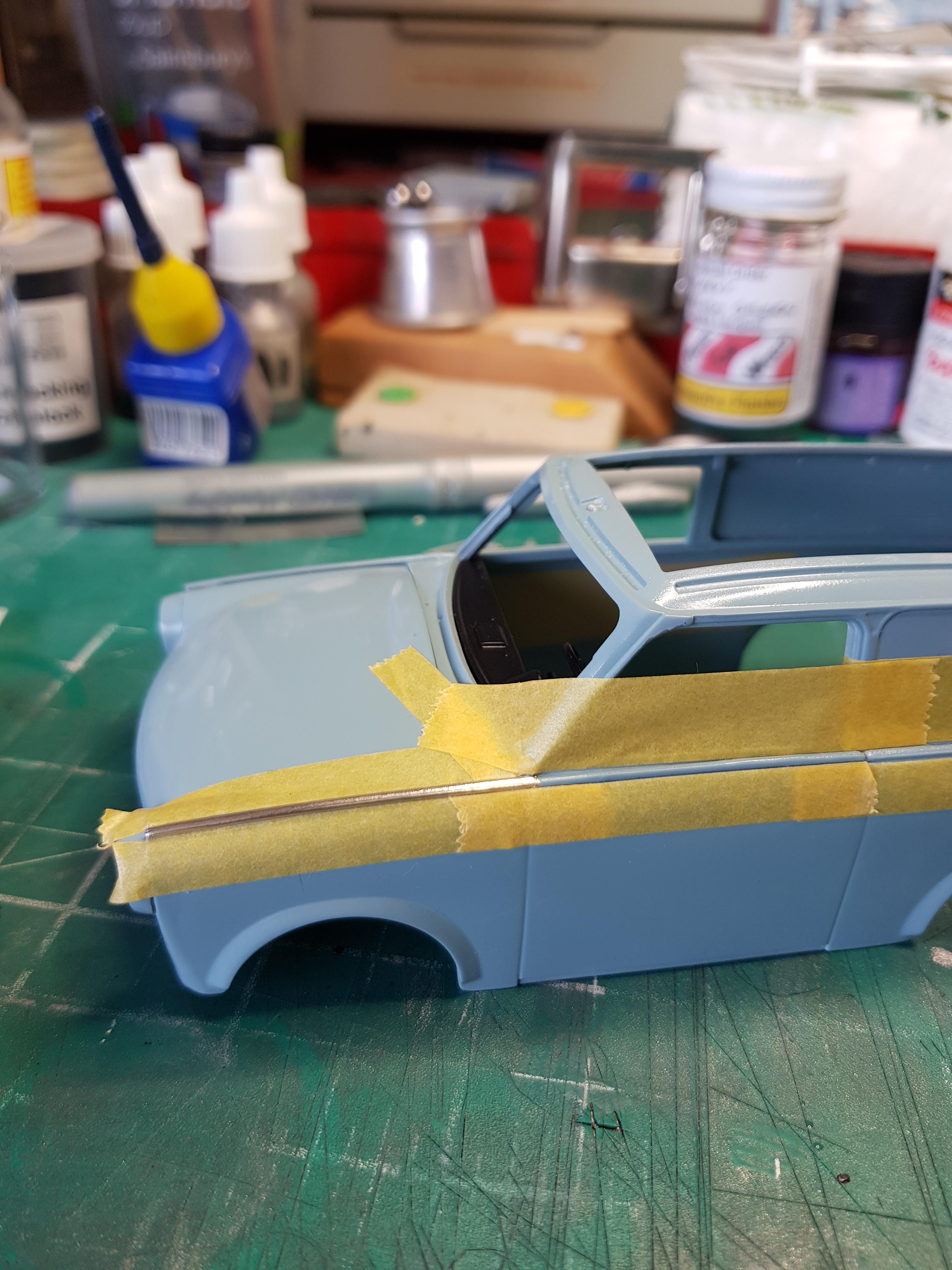

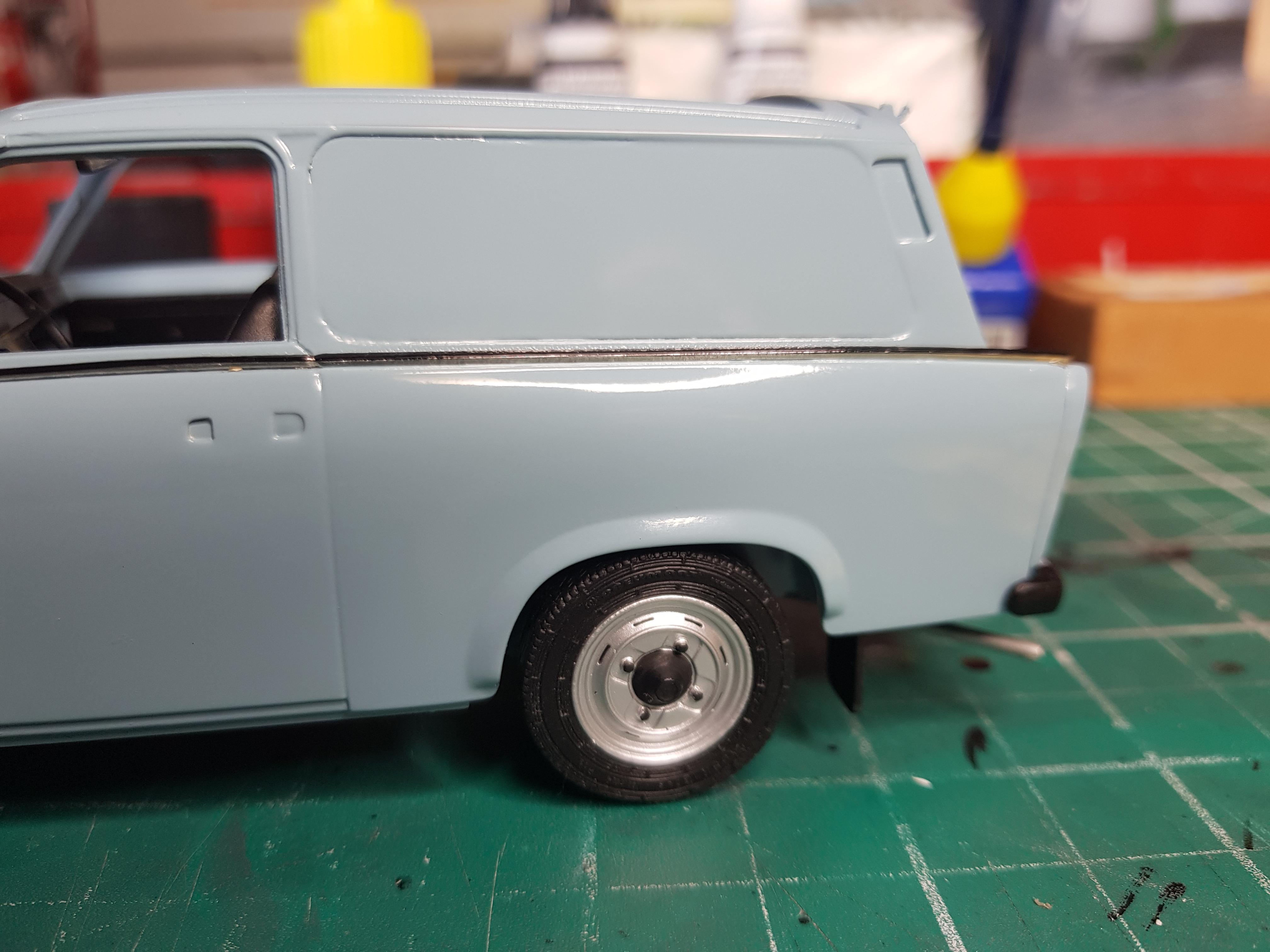

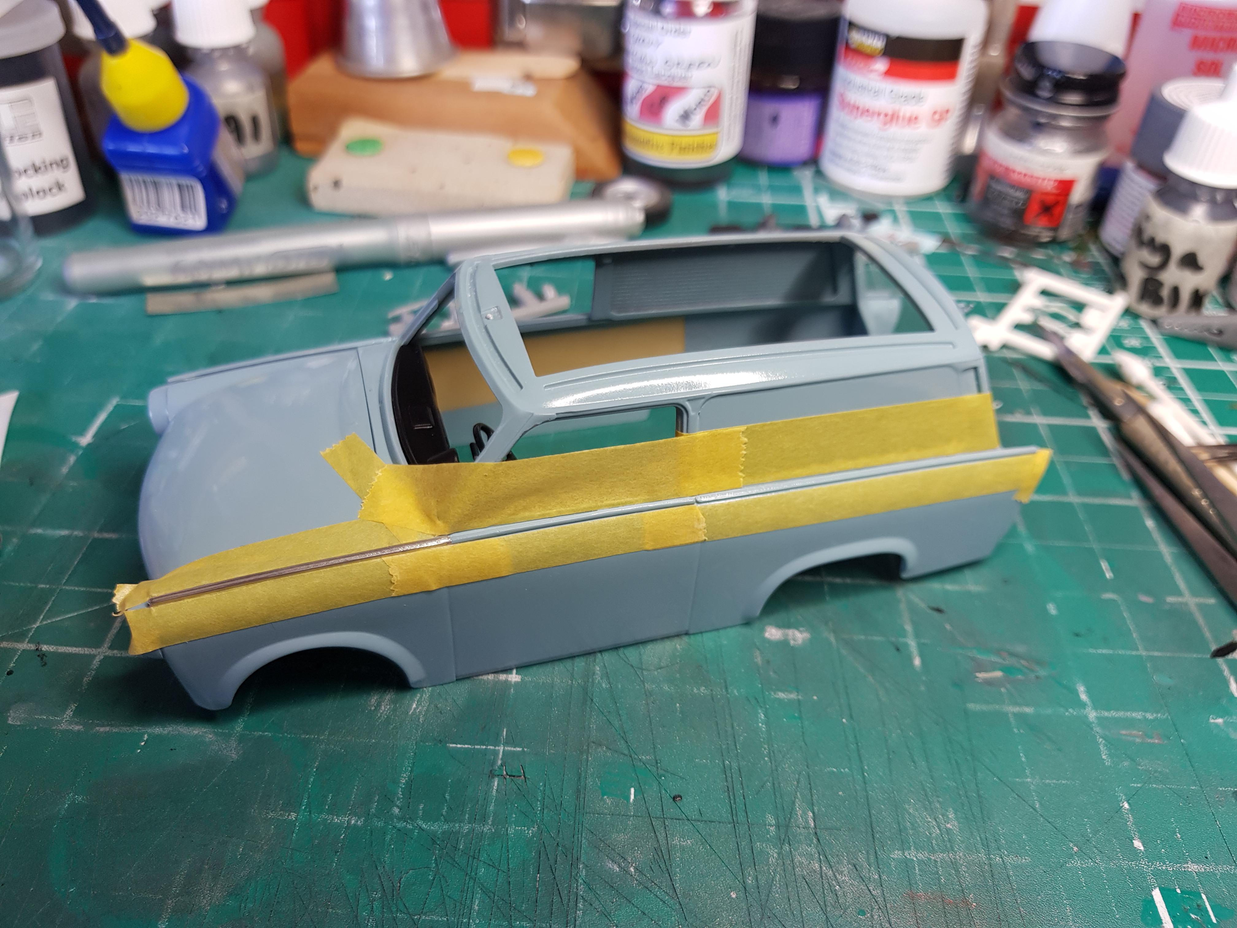

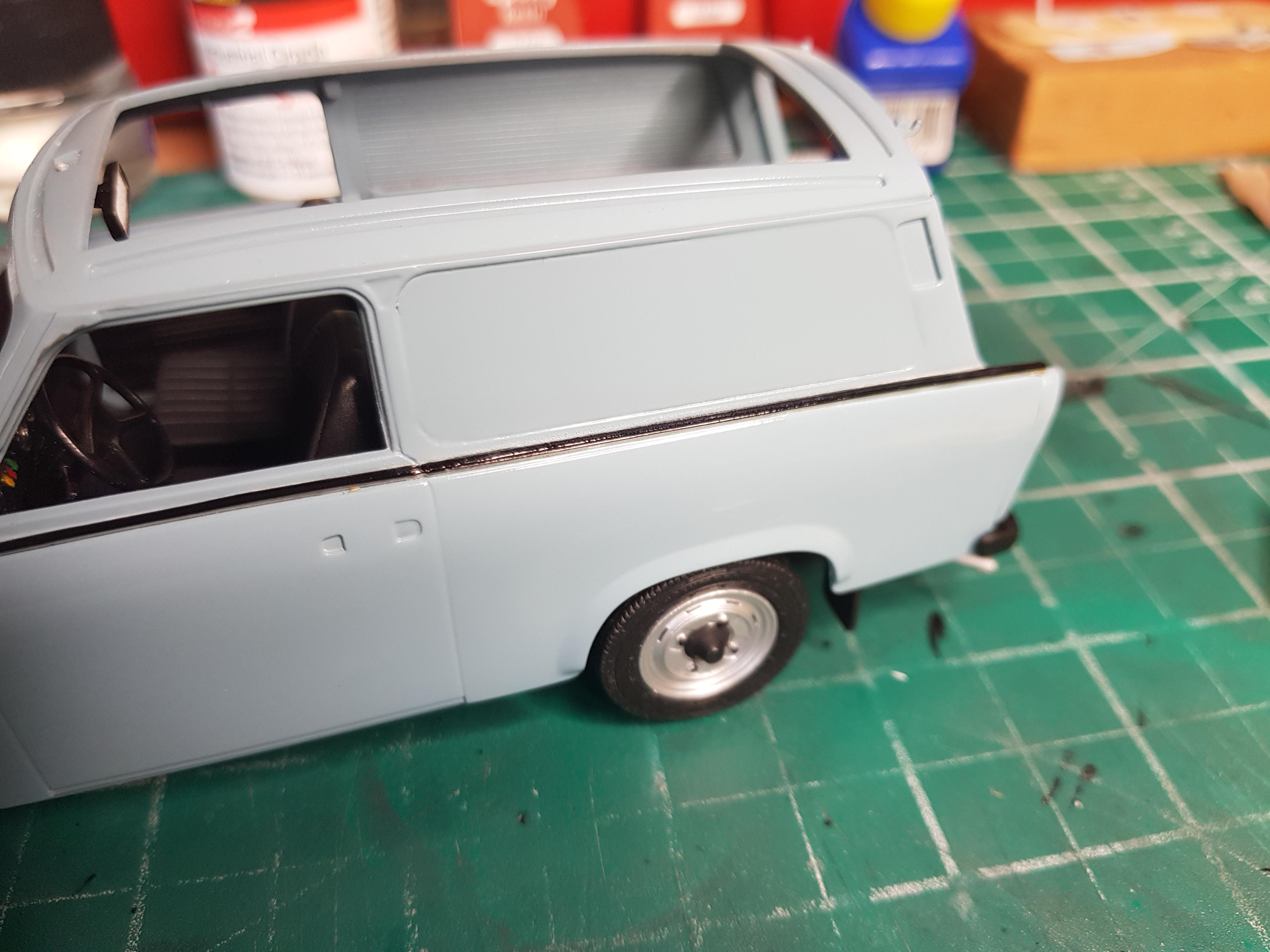

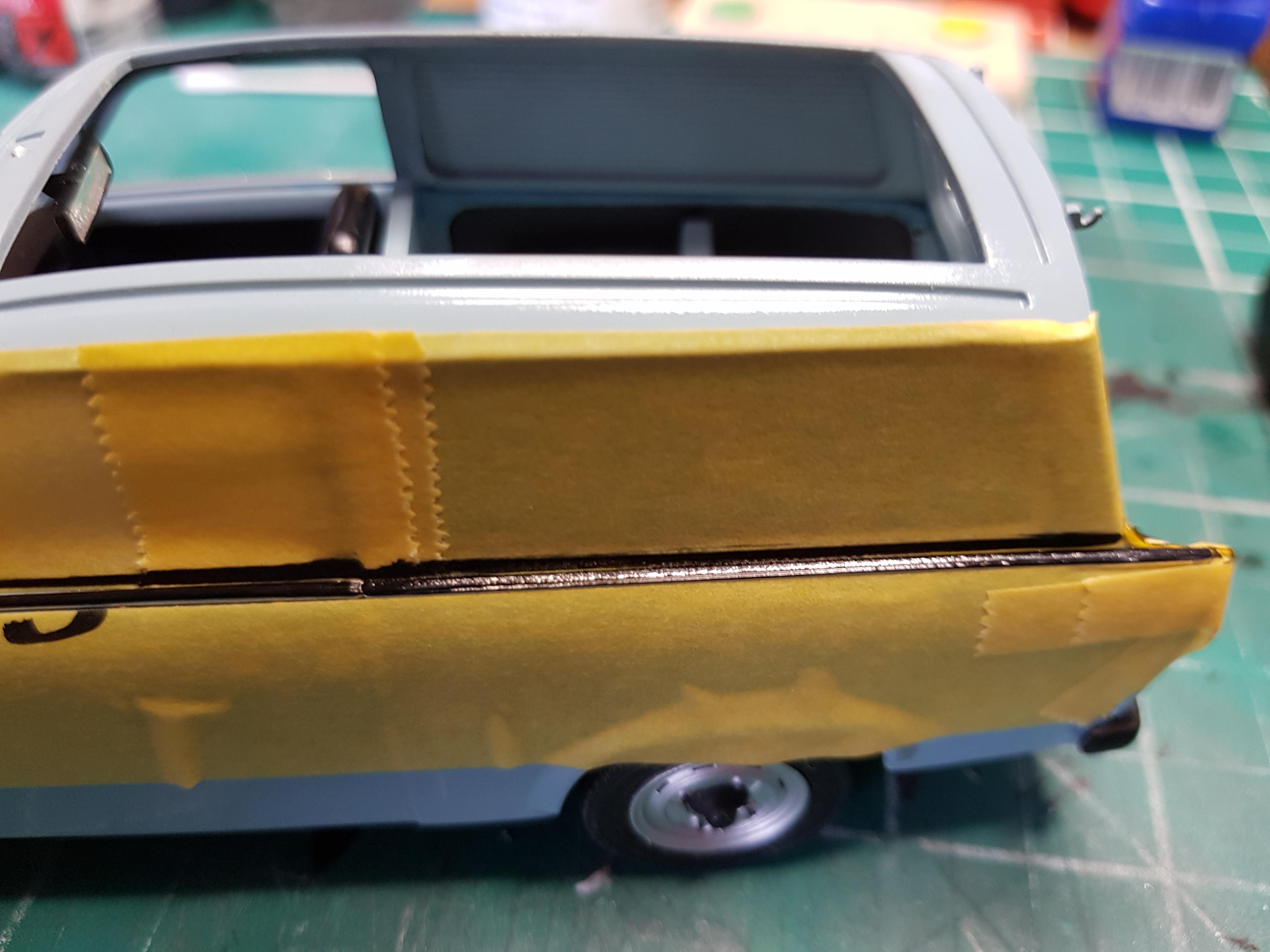

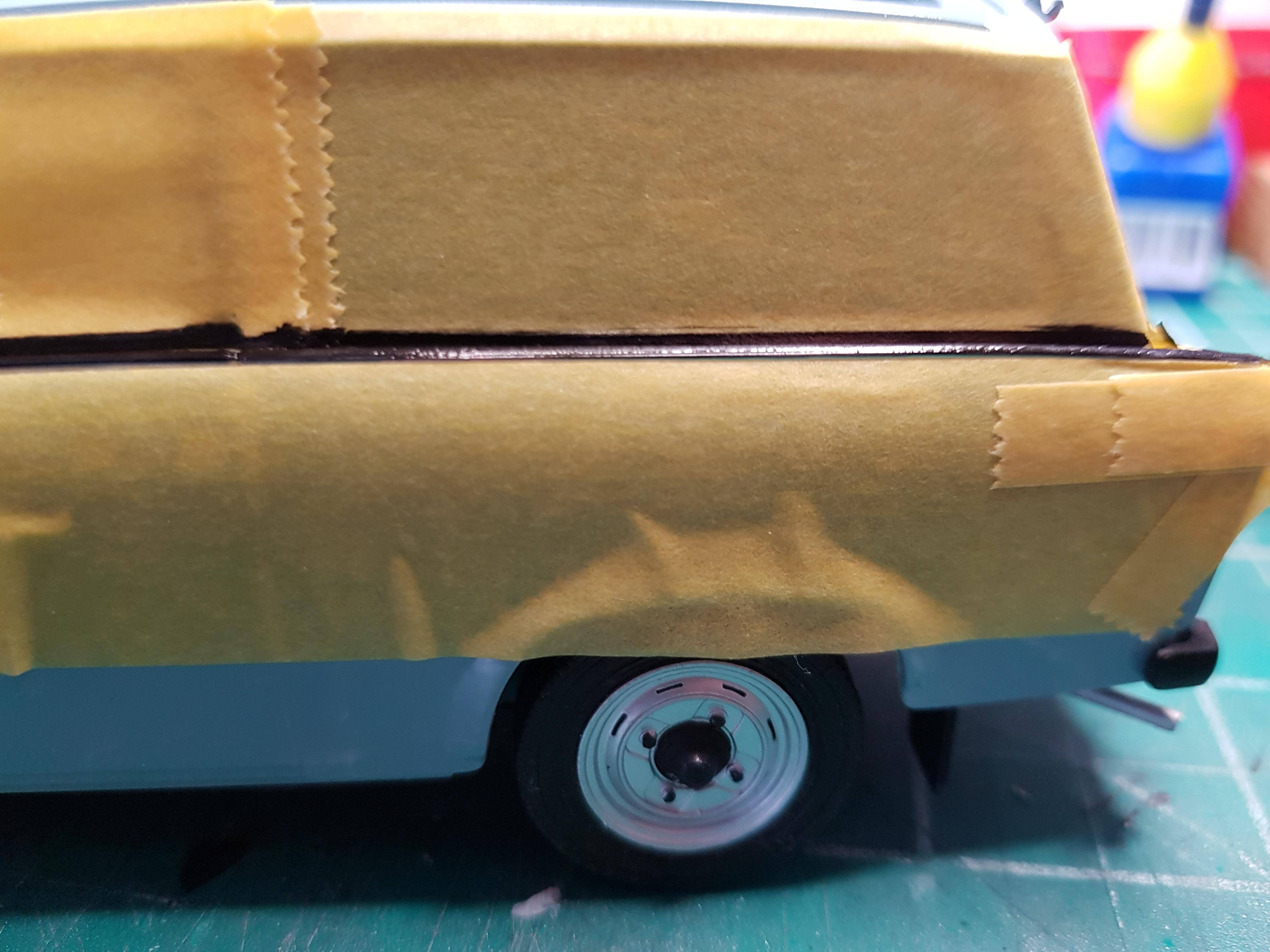

Started to apply the aluminium trim on top of the wings and door, in real life it's actually an aluminium U channel that hides the screws and rivets that hold the panels on, I used aluminium BMF,

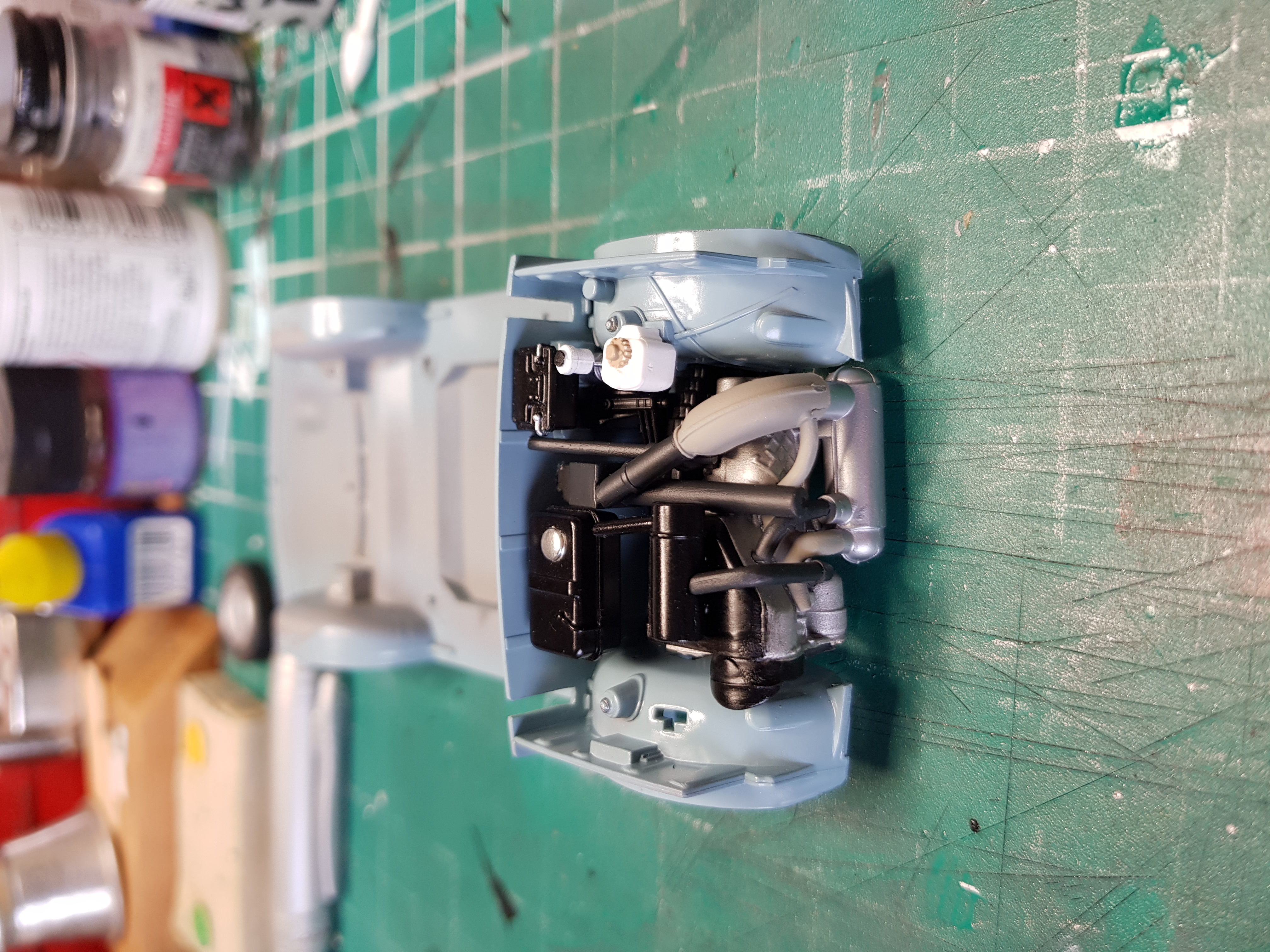

Engine compartment finished, just the towbar to fit onto the chassis,although the Instructions say to fit it before the exhaust goes on, it will actually fit afterwards.

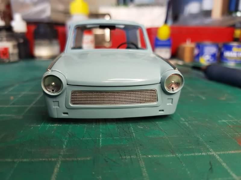

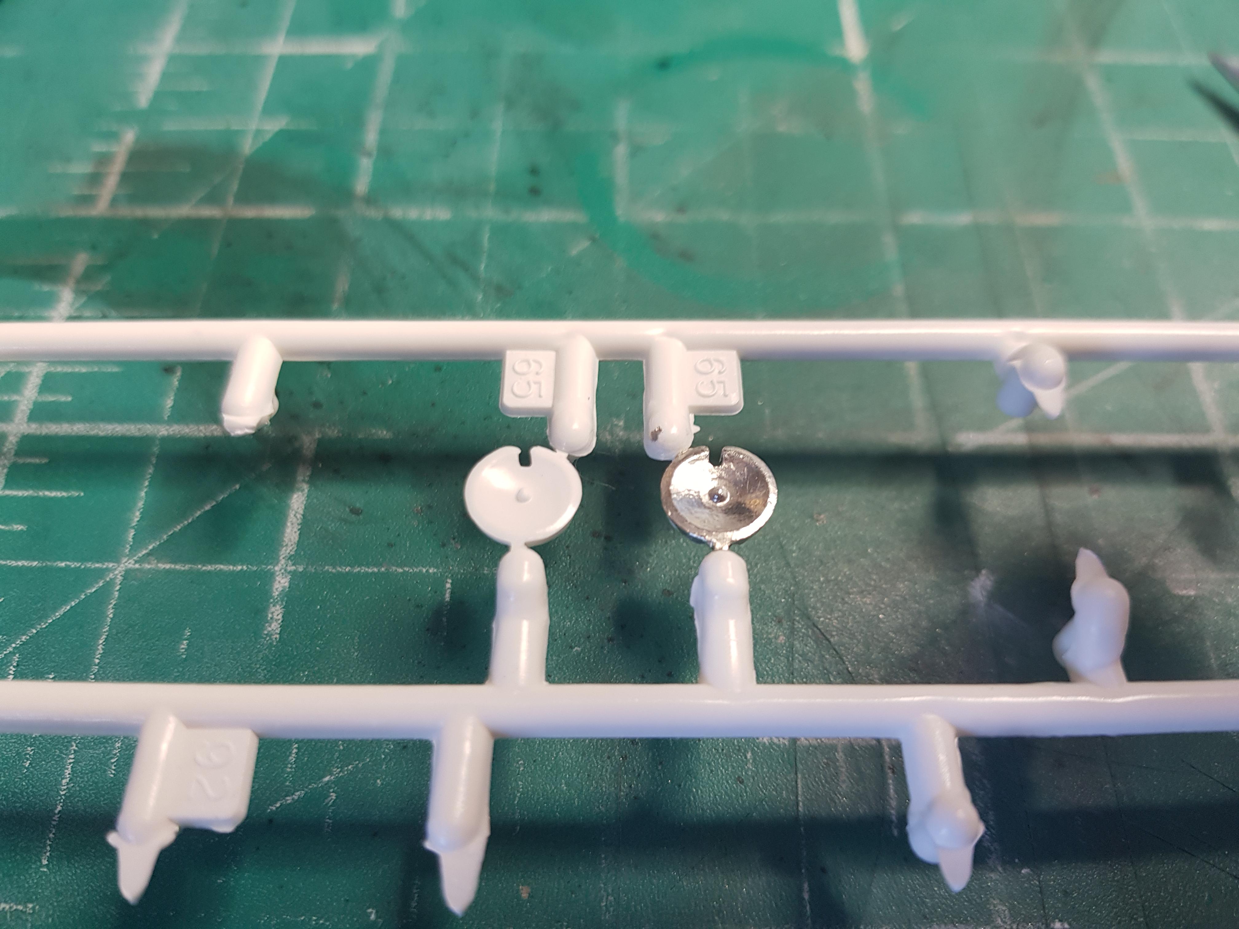

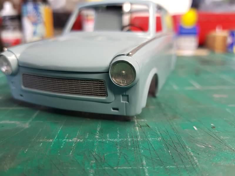

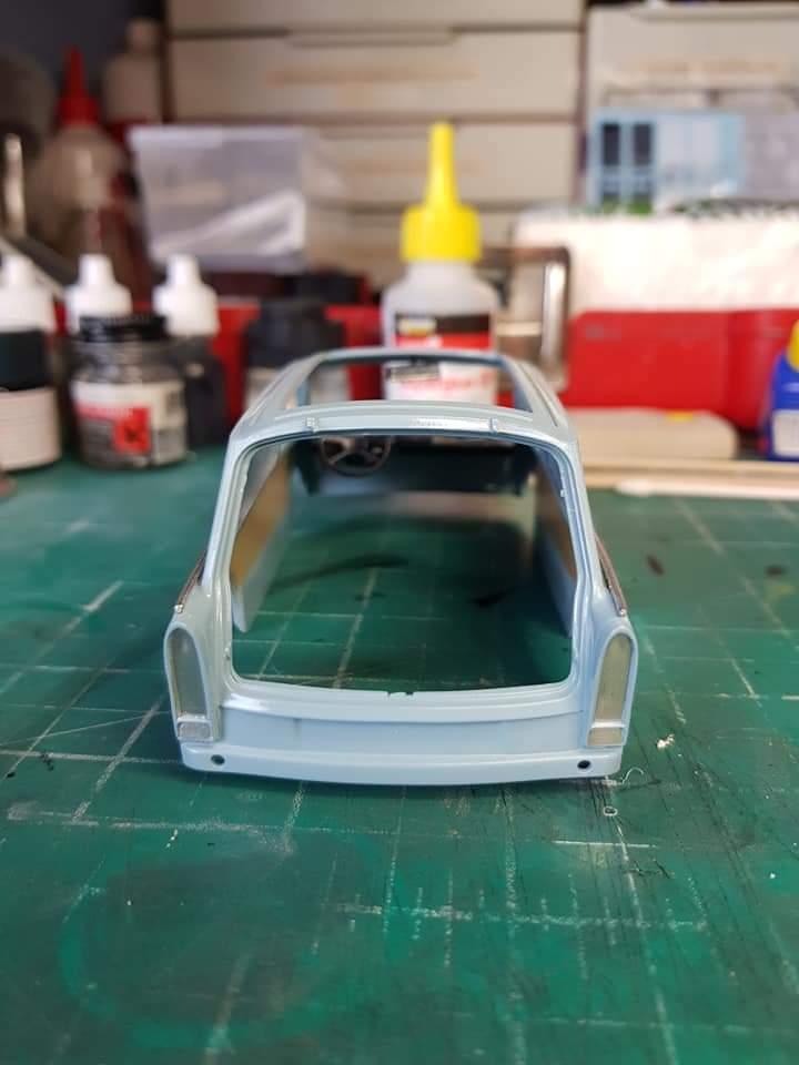

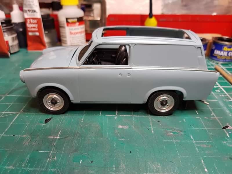

Body and chassis dry fitted together, just waiting for some slow setting epoxy to arrive so I can finally get them fitted together permanently, starting to do the headlamp reflectors in aluminium Bare metal foil

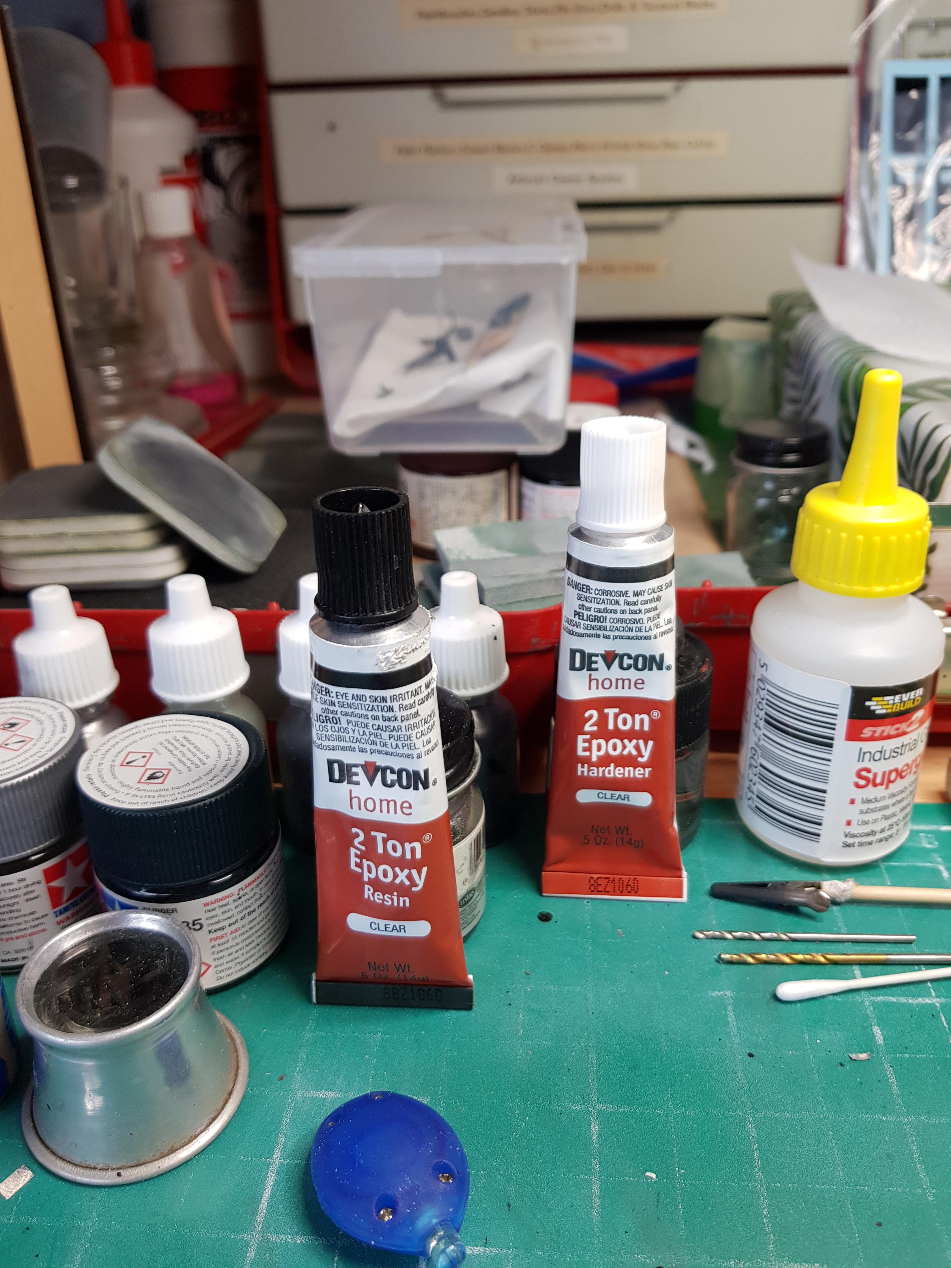

Thankfully the epoxy glue arrived this morning, so first thing I did once I got home was to glue the Trabbi together, I think the Devcon will be strong enough

Cheers Dann, can wait to get this one finished, the epoxy glue set up and thankfully all four wheels touch the ground at the same time, got the headlamp lenses fixed in using UV resin

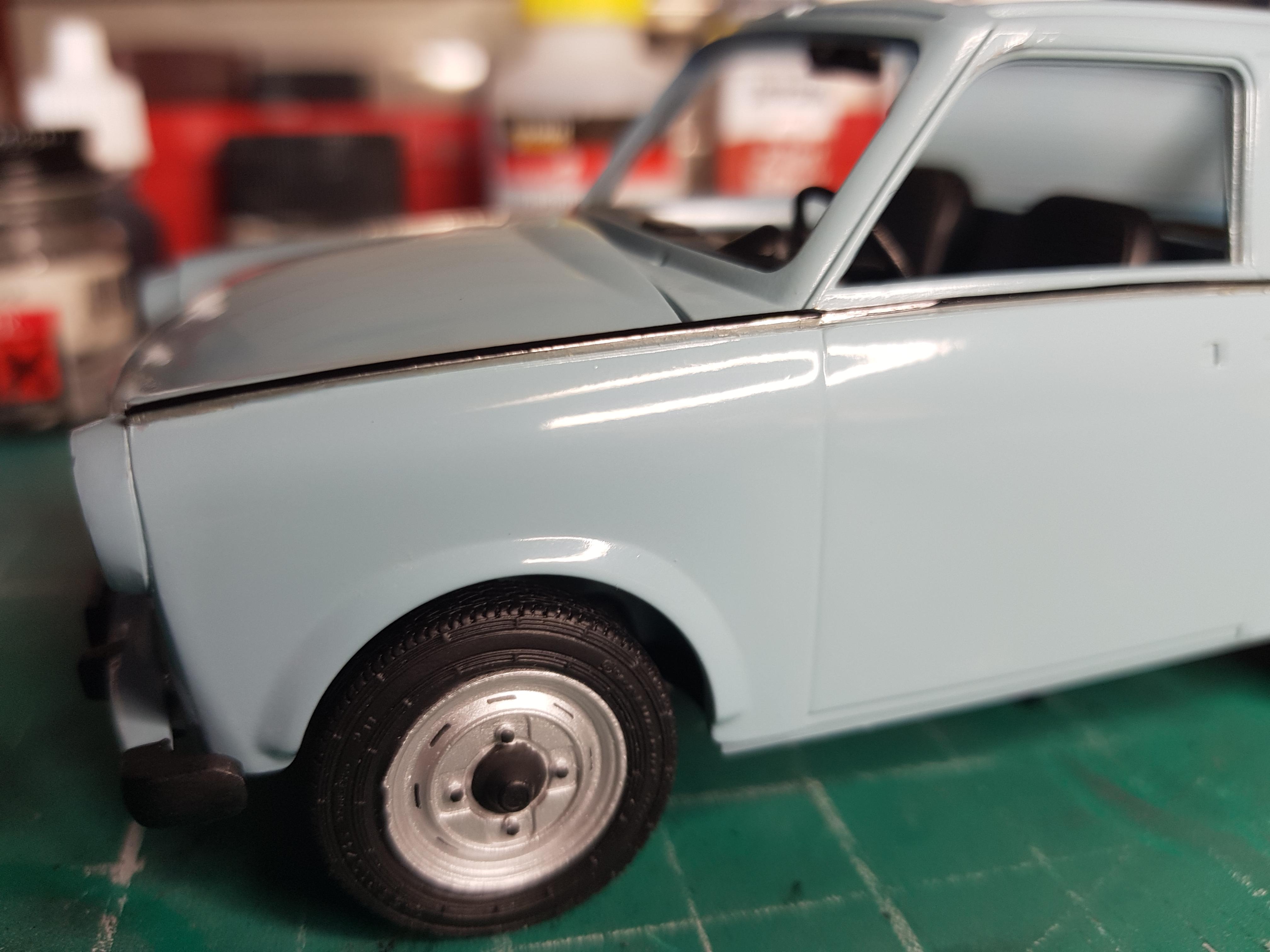

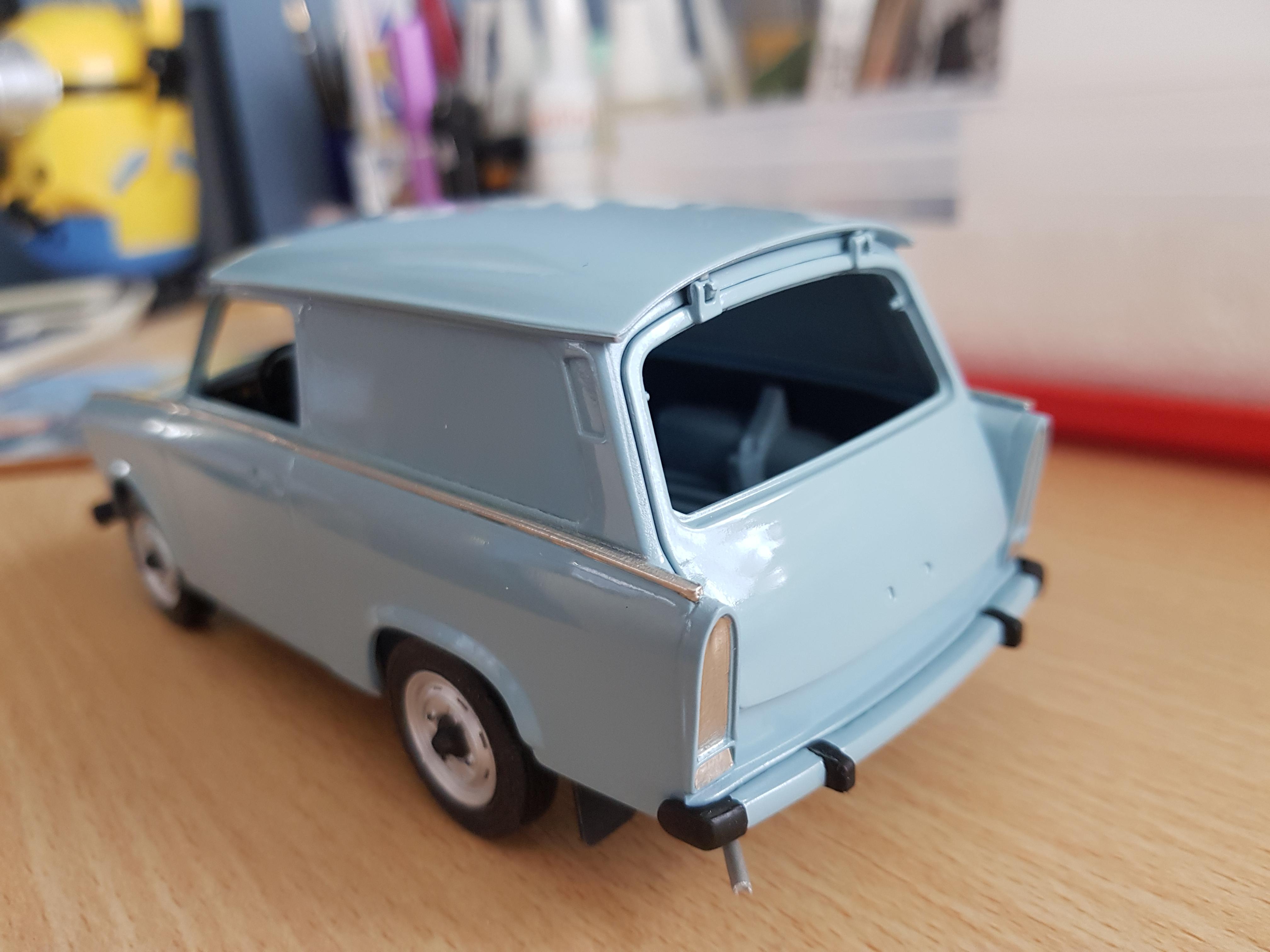

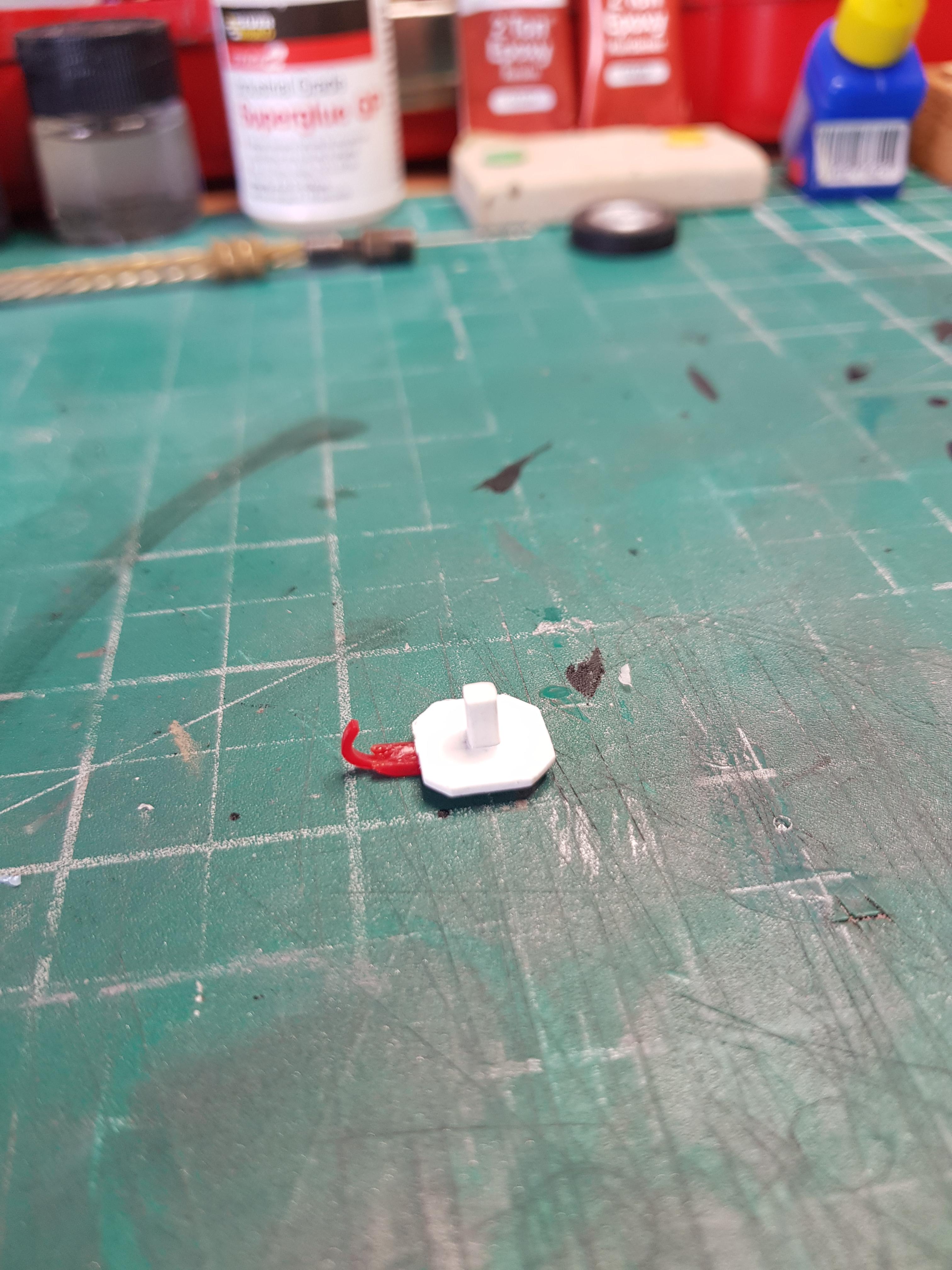

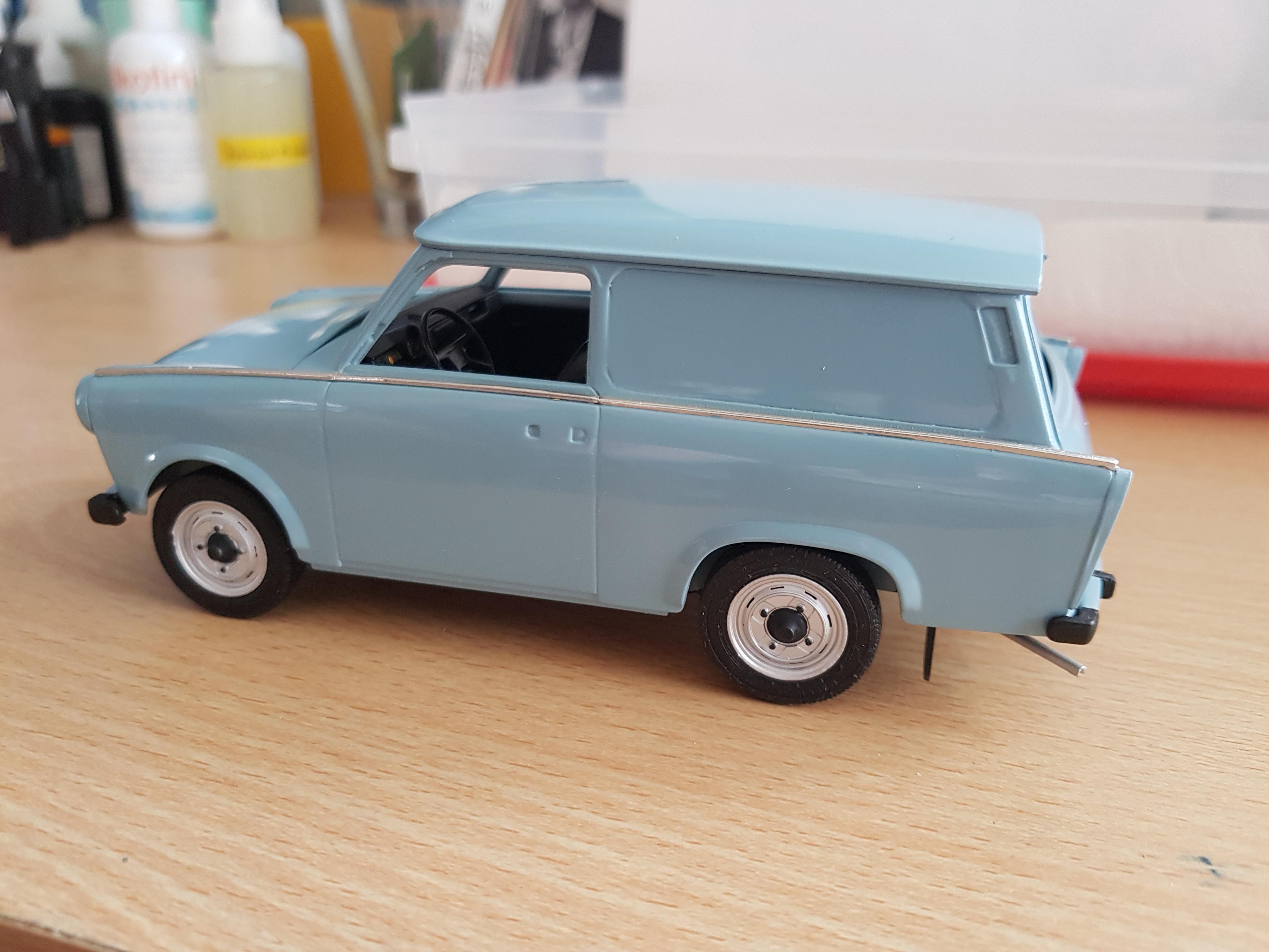

Nearing the finish line, because of the difference between the kit wheel arches and the few photos I've got of the 1:1, it wasn't possible to fit the spare wheel on top of wheel arch, so it will go as close to it as I can get, a spare wheel mount was scratch built from a square of styrene sheet and a few modified parts from the spares box.
Rubber trim on the one side done, using a chisel edge permanent art marker, pretty hard to see under the bright light, it's the first permanent marker I've found that hasn't got a purple tinge to it when dried.
