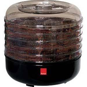

Pete J. Posted July 28, 2015 Posted July 28, 2015 (edited) A thought just occurred to me about rattle can vs. airbrushes. One of the biggest knocks on airbrushes(and some claim it as a reason for not using them) is the time it takes to clean them after you are done. I can strip and clean any of my brushes in less that two minutes. That is far less than the time it takes me to heat a rattle can and then reheat it if it is a long paint session. For the record I do use rattle cans for quick paint jobs, but I keep the cans I use frequently in a food dehydrator so they are warm when I am ready to use them. Been doing this for 15 years and never had a can fail or bulge or react adversely in any fashion. The food dehydrator runs at about 110 F. There is no open ignition source in the dehydrator so a burst can would be unlikely to light off. The food dehydrator would also likely to contain most of the paint in the case of a failure. Shaken, not stirred. One of the things that I learned a long time ago is it to store my rattle cans upside down. There are a couple of reasons for this, especially for long term storage. The primary reason is the shape of the can. The reverse dome on the bottom allows the pigments to settle into the small groove around the bottom edge and it is hard for the glass balls inside to get down in that area to agitate the paint into solution. The balls are also somewhat hindered by the dip tube(the straw leading to the nozzle) which could cause uneven mixing. With the pigments in the upper dome, they settle in the middle and there is no hindrance in the balls getting to that area to mix them up. Also, when you store the can right side up, the dip tube in very near the bottom and the pigments will settle around the dip tube and in long term cases in the tube. This easily causes a clog. By inverting the can the dip tube remains clear of the "sludge" in the bottom and is more likely to function properly. Edited July 28, 2015 by Pete J.

Pete J. Posted July 28, 2015 Posted July 28, 2015 anks for relating your experience with using a dehydrator to heat spray cans, Pete! If you've been doing it for15 years it's a pretty safe bet it works. For the record, this is the unit I am using. It hasn't changed at all except for an occasional color change and the "brand" It is sold under a lot of names but they all look the same. This one happens to be a Ronco. I have chopped up the internal racks over the years to give me more depth and glued some together for convenience. Works fine and I have never felt like I needed something fancier.
