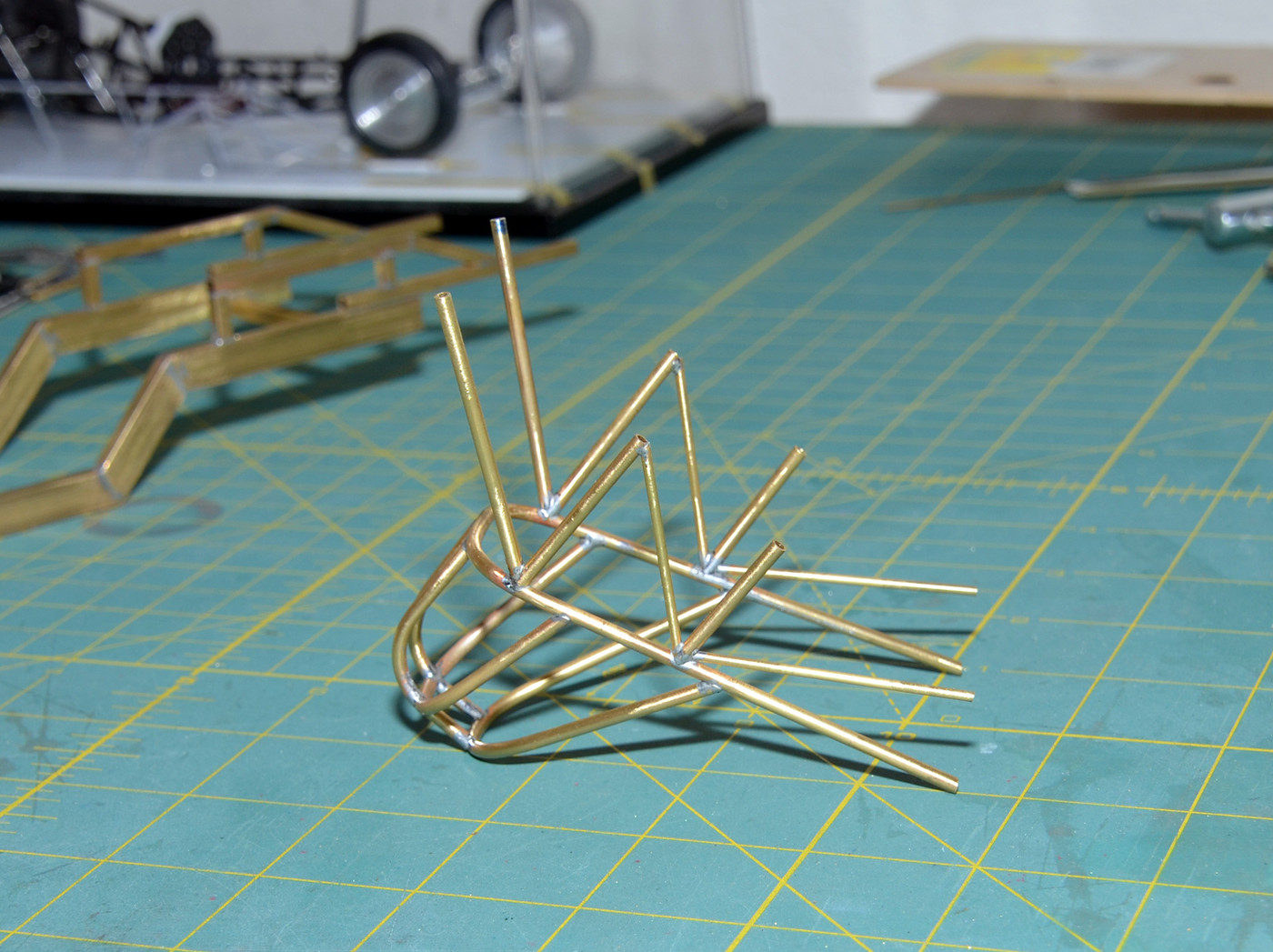

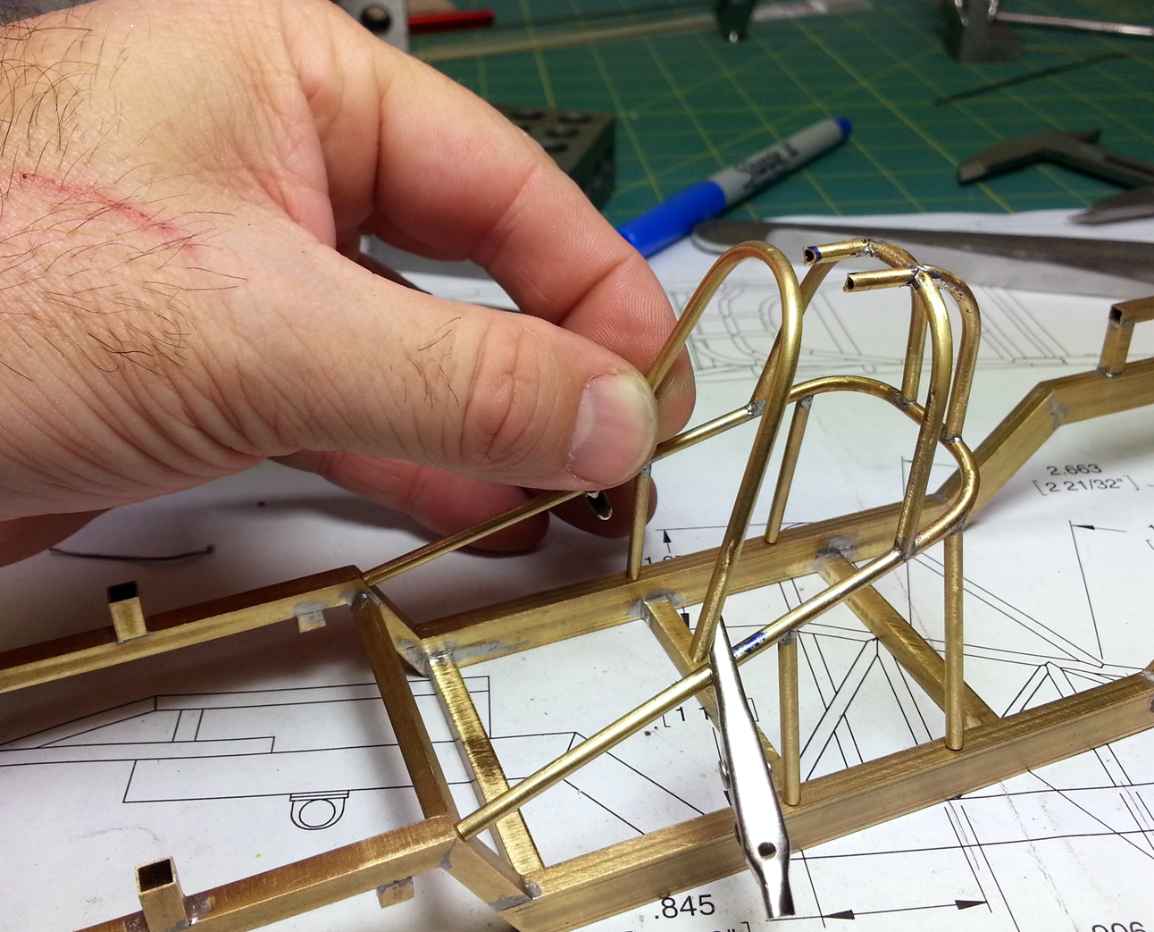

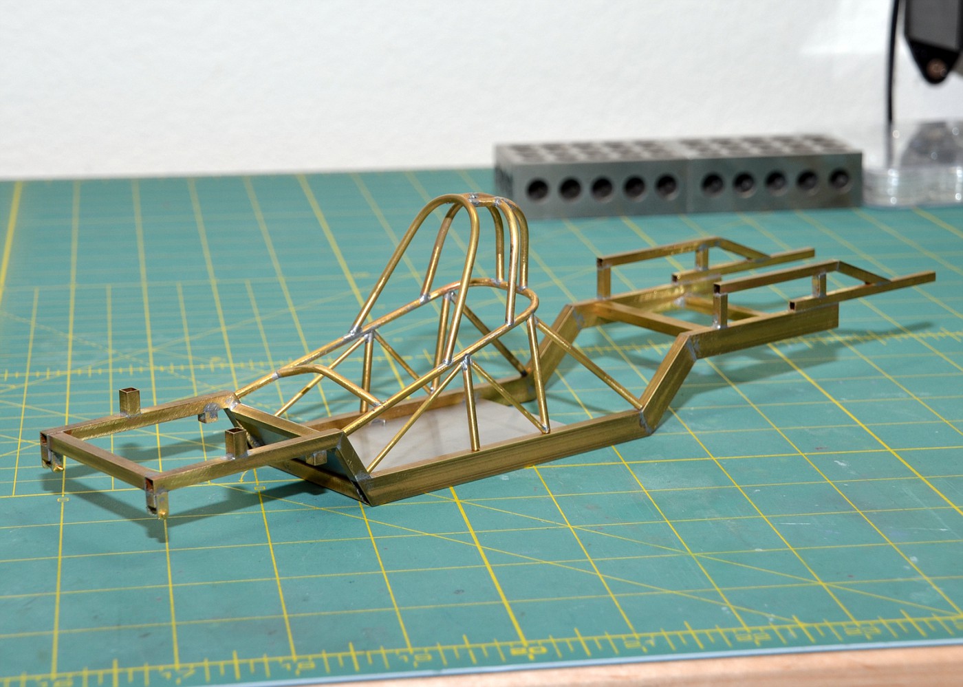

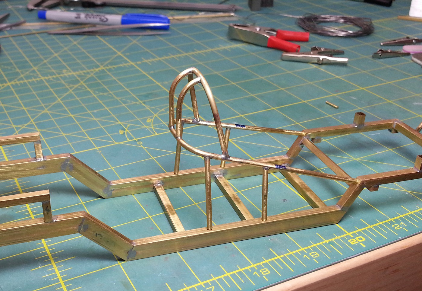

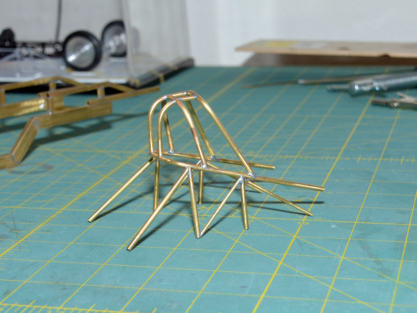

Mooneyzs Posted September 19, 2015 Author Posted September 19, 2015 (edited) Another shot of the back portion of the roll cage: Here was the start of the main hoop for the roll cage: Here is the roll cage completed: Back Side: Opposite side: Bottom: Edited July 12, 2017 by Mooneyzs

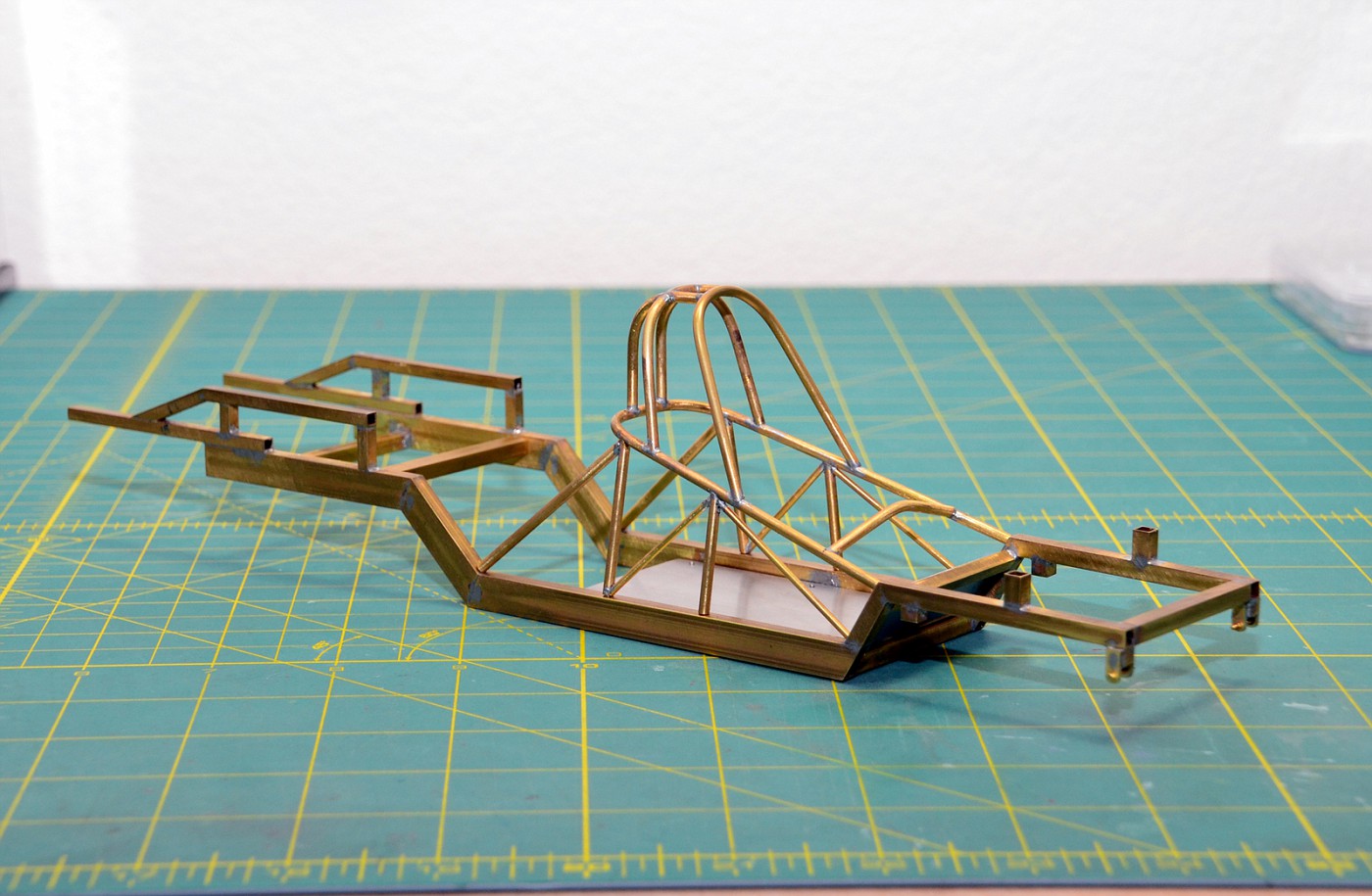

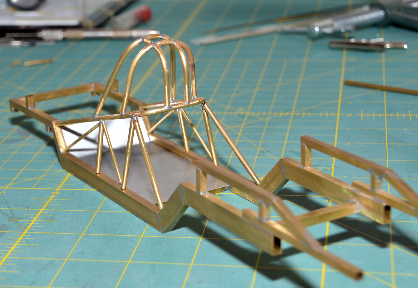

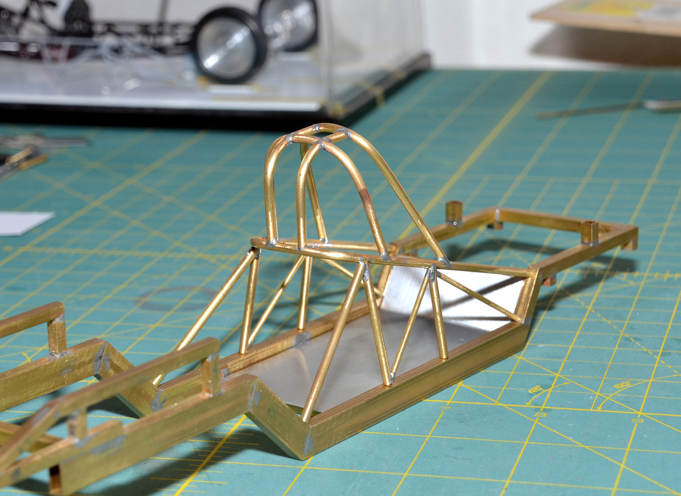

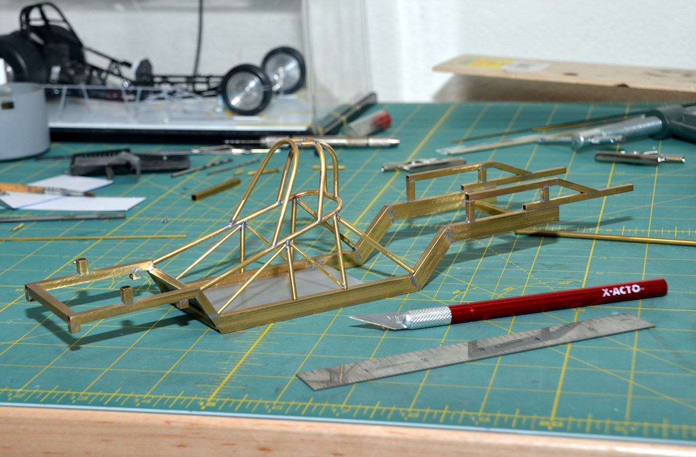

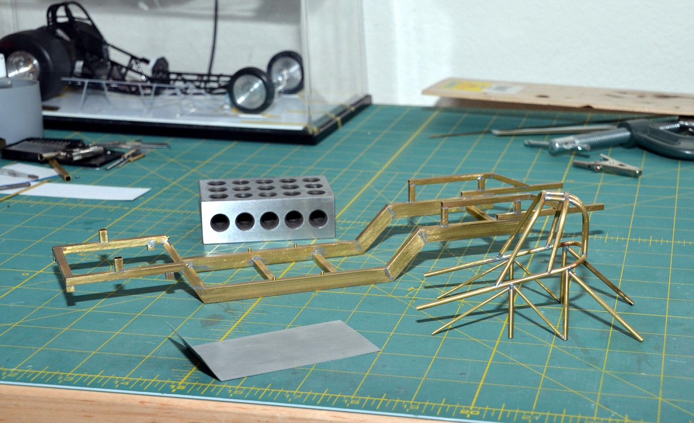

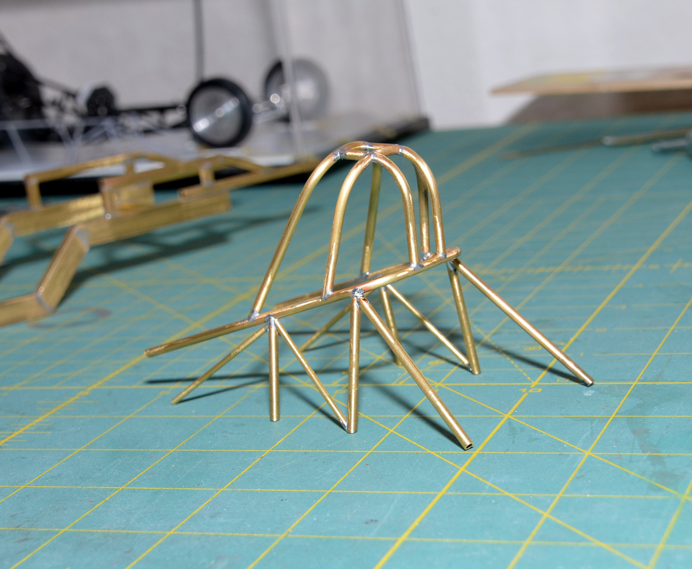

Mooneyzs Posted September 19, 2015 Author Posted September 19, 2015 (edited) Here is the Frame, Roll Cage and Floor Pan: Here is the Cage on the Frame.. Not soldered together yet: Straight on shot of the Roll Cage: Another shot: Back View: Edited July 12, 2017 by Mooneyzs

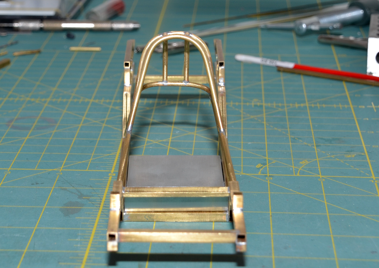

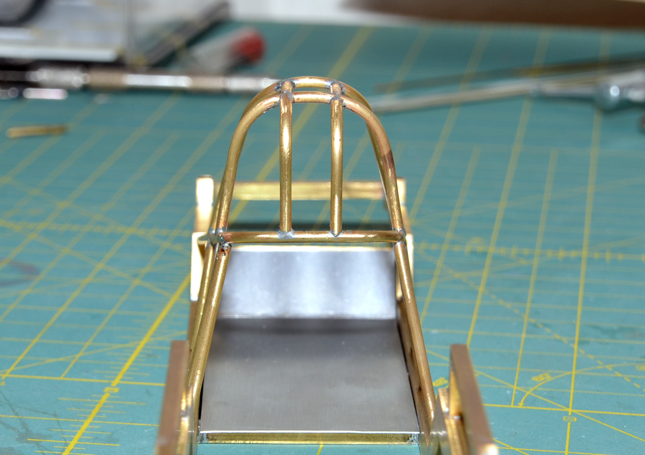

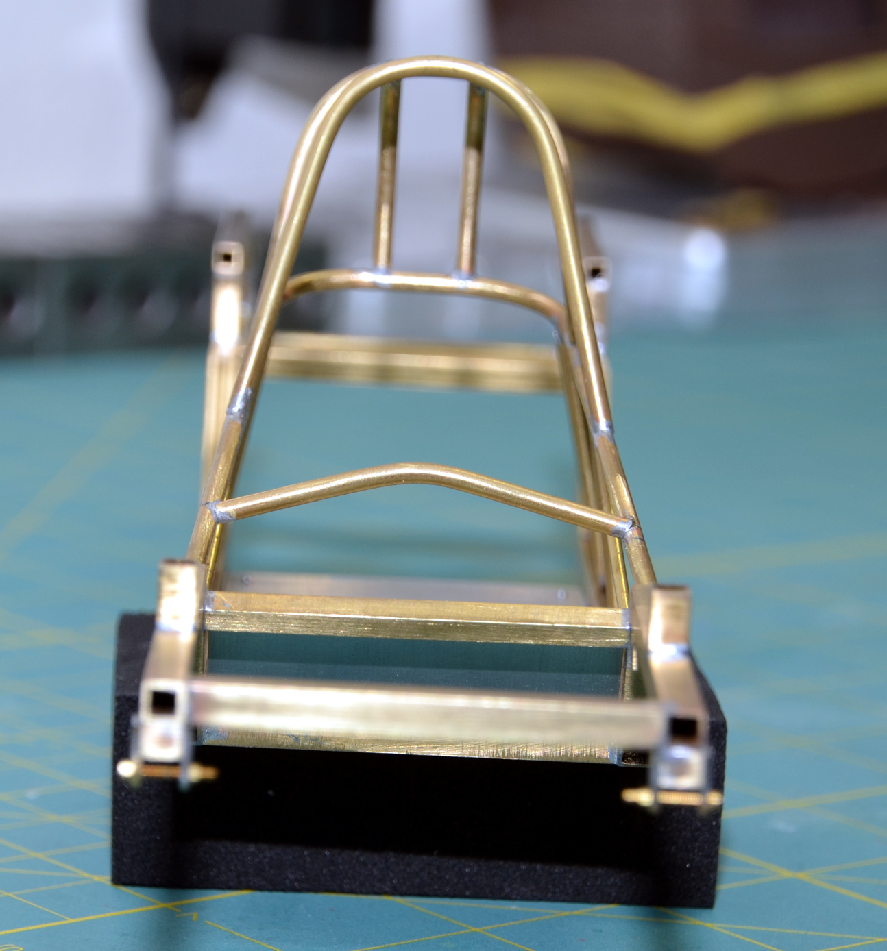

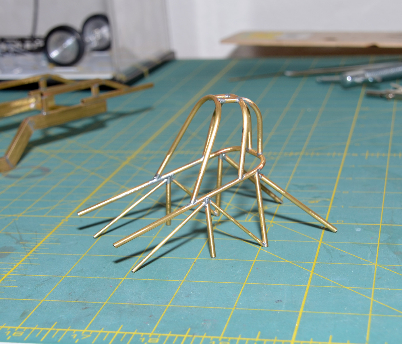

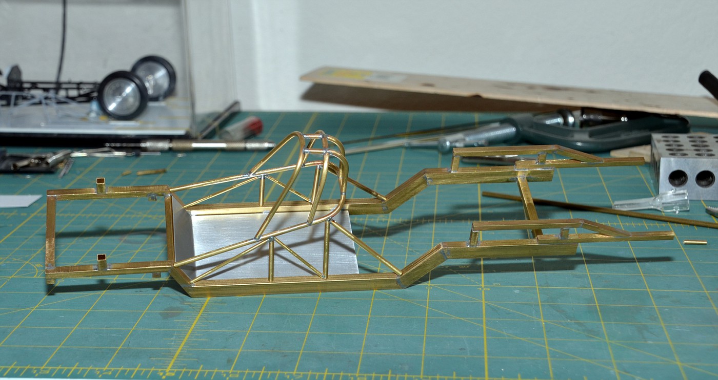

Mooneyzs Posted September 19, 2015 Author Posted September 19, 2015 (edited) Here is a shot of the roll cage straight on from behind: Another back view: Little Top Down View: Edited July 12, 2017 by Mooneyzs

Mooneyzs Posted September 20, 2015 Author Posted September 20, 2015 John... Thanks brother!!! LOL I think you should be having wet dreams from something other than this build... lol Clayton... Thank you very much. The cage was a bit of a pain in the butt and it gave me a few hurdles where some of it took me more time to do or thought but I will admit that I am happy with it now.Bob... Thank you. It was quite fun to do this chassis in brass and looking forward to the next build that I will do an all brass chassis for. Although I still have a few more things that I need to add for this chassis.Joe... Thank you. It was definitely a new challenge for me to use brass for the whole chassis. it was fun but I know I would like to hone my soldering skills some more.Brad... Thank you my friend. I gotta admit that chassis seems pretty strong. Although I haven't soldered the cage to the main frame yet. I need to drill some holds in the floor pan and into the cross brasses of the frame since I realized that I won't be able to have access to do so once the roll cage is in place.

Mooneyzs Posted September 20, 2015 Author Posted September 20, 2015 Art... Thank you. I am happy with the progress.Brent... Thank you very much. I am enjoying working with the Brass so far. I still enjoy working with styrene as well. I am trying to learn to not to use too much solder on joints so there is minimal clean up. Using some liquid flux has helped with that. Although holding the tubing and notching it with a file is a little bit of a pain in the butt at times and I would like to come up with a miniature tubing notcher to make that process a little easier...lol. The chassis seems pretty strong and it has been fun challenging myself by using the brass.

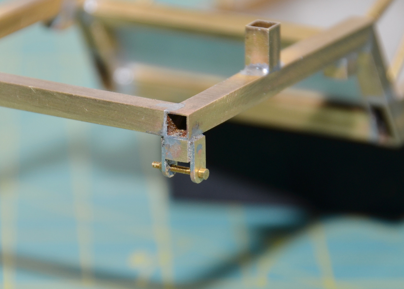

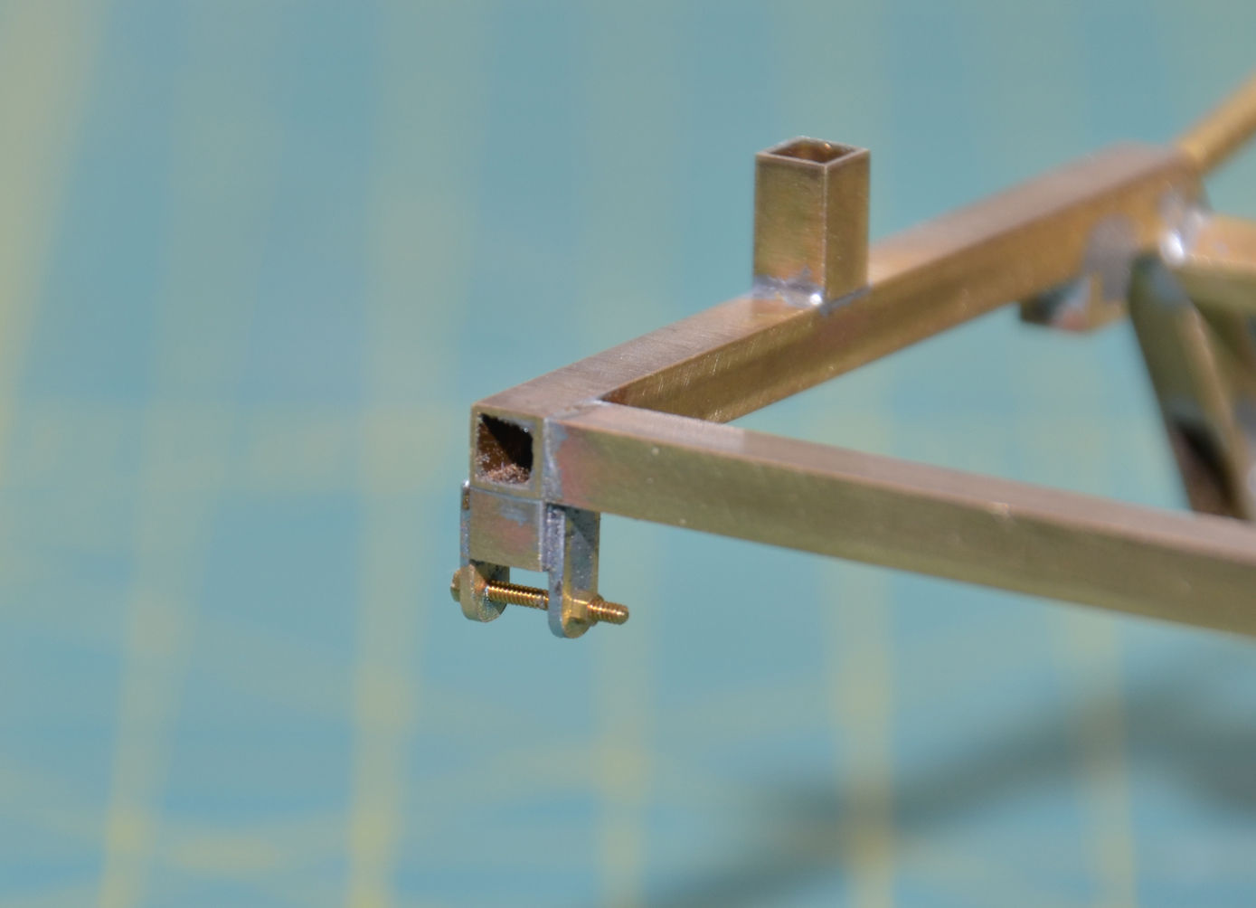

Mooneyzs Posted September 27, 2015 Author Posted September 27, 2015 (edited) Ok Fellas, so I have gotten some more work done on this chassis. I have started with getting some of the shackles for the front leaf springs fabricated as well as getting the steering shaft support and some more work to the floor pan. Here is the beginning of the shackles. I had a little bit of a pain in the butt getting them aligned properly prior to soldering them in place: Here is the other set: Another view: Here is the steering shaft support: Edited July 12, 2017 by Mooneyzs

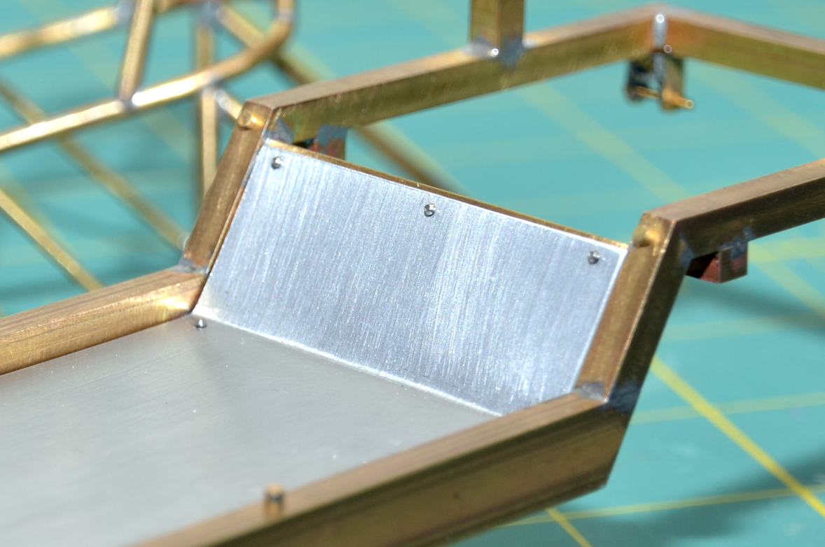

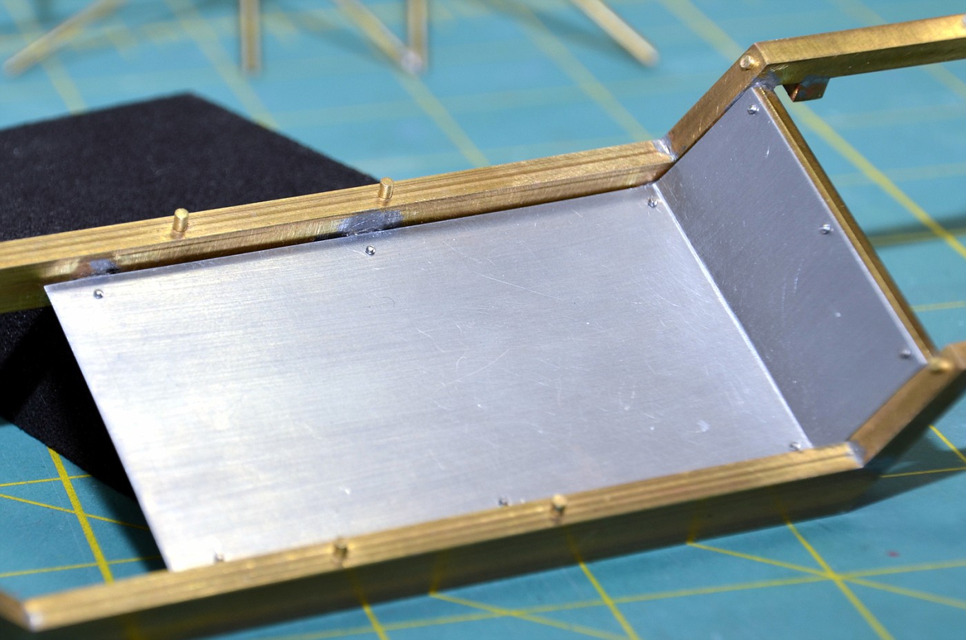

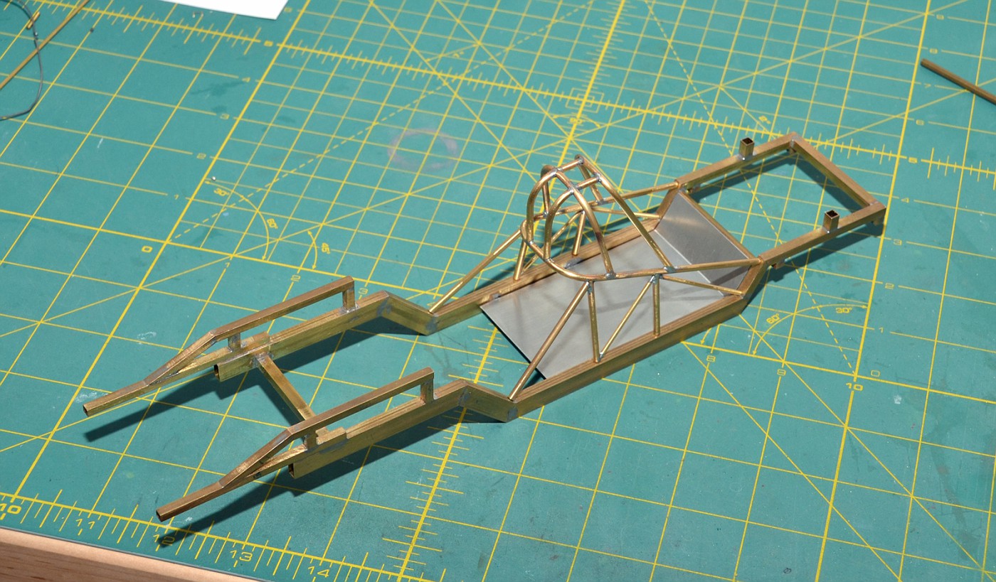

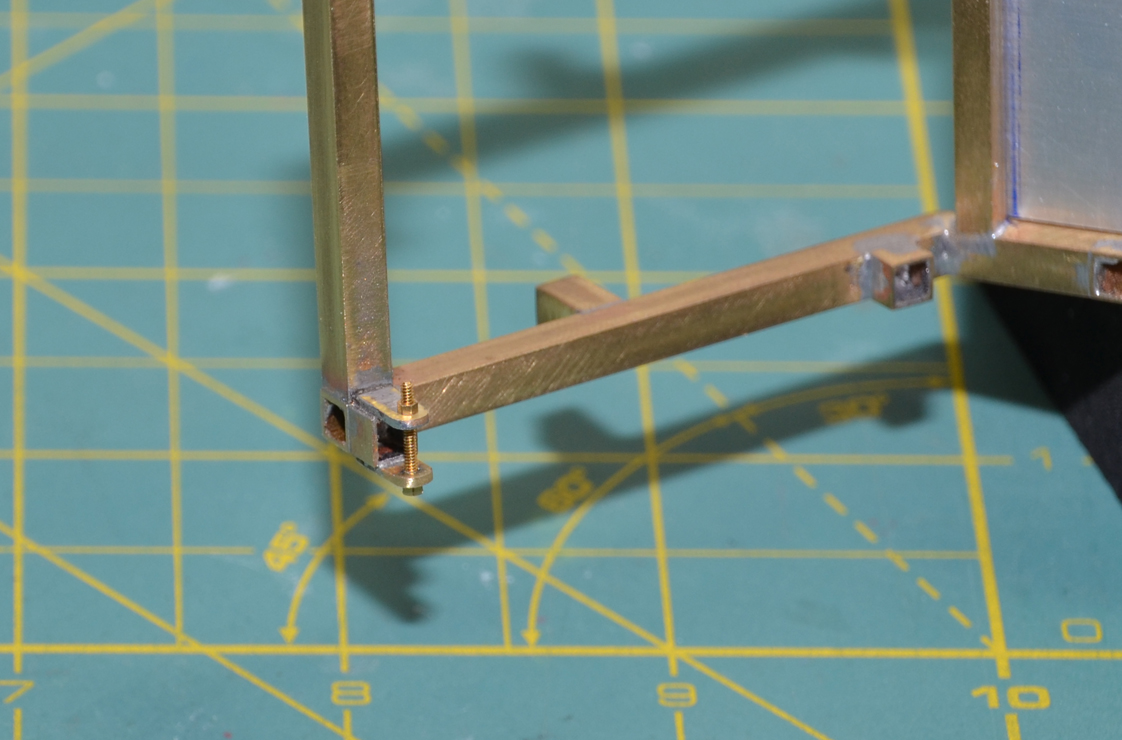

Mooneyzs Posted September 27, 2015 Author Posted September 27, 2015 (edited) Here is the floor pan again. I went and drilled all of the holes for the mounting bolts and then went back and transfer drilled the holes into the frame. I wanted to get them drilled and mounted before I solder the roll cage in place since I would not be able to get the pin vise in to do the drilling. Here is an up-close shot of the bolts. I decided to use button heads for these: Here is the whole chassis together with the roll cage in place, still not soldered at this point: Another view Edited July 12, 2017 by Mooneyzs
