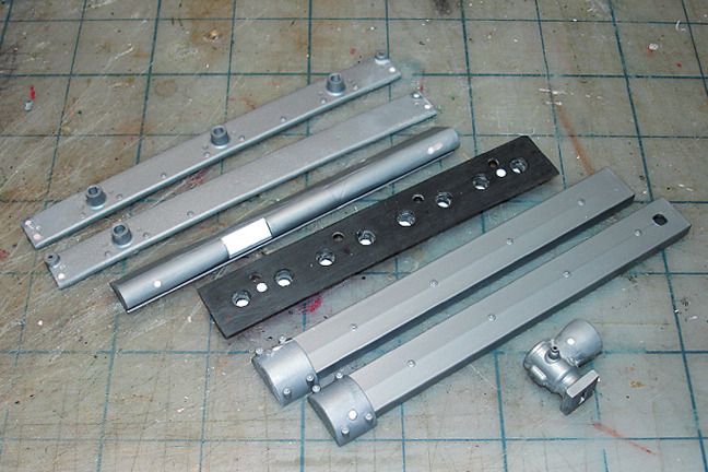

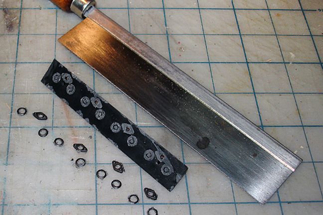

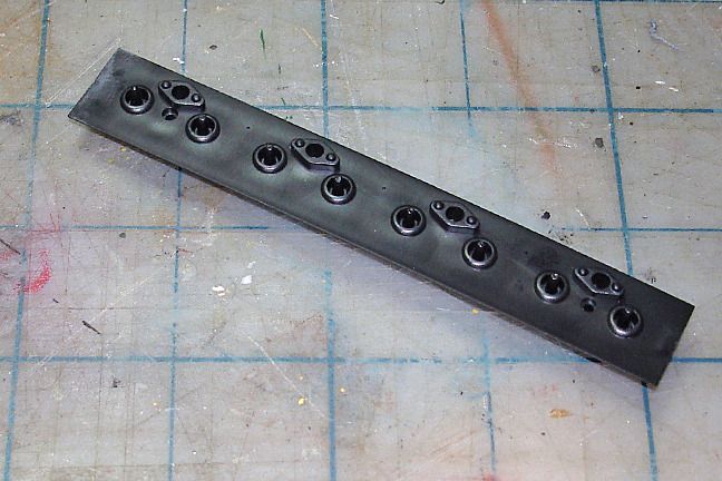

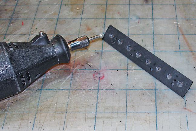

Harry P. Posted August 20, 2015 Author Posted August 20, 2015 There are multiple problems with the engine valley cover. Sink marks, plus the spark plugs and the flanges of the water pipe are molded in, making paint detailing them tough. What I want to do is saw off those flanges, save them, and glue them to the water pipe so I can paint the water pipe and flanges as one unit. I also want to remove the molded-in plugs and replace them with more detailed scratchbuilt ones. Step one is sawing off all the surface details. Save those flanges! Then I sanded the surface smooth to get rid of all the sink marks, and drilled out the rest of the molded-in spark plugs... And finally I used a round grinding bit in my Dremel to give those spark plug openings a chamfer...

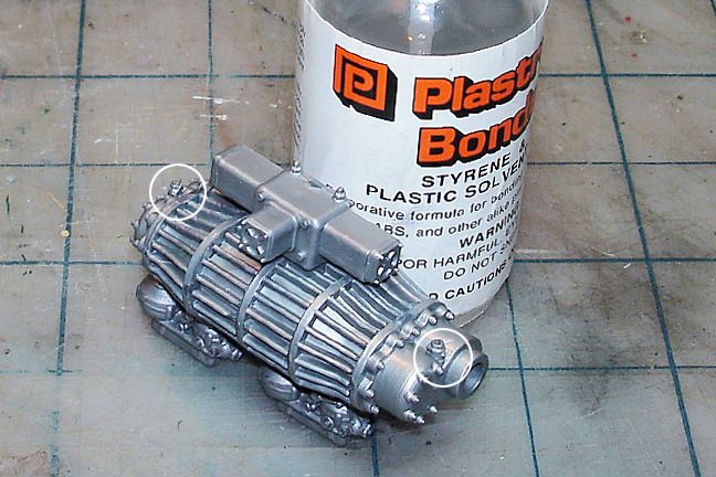

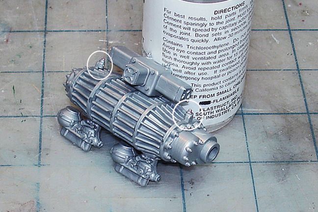

Harry P. Posted August 20, 2015 Author Posted August 20, 2015 Got the supercharger/dual carbs assembly built, and I will detail paint it s a unit, but first I have to take care of a small problem... the fittings for the linkage/oil lines are molded in the wrong place... So I whipped out my trusty razor saw, removed the fittings, and glued them in the correct positions...

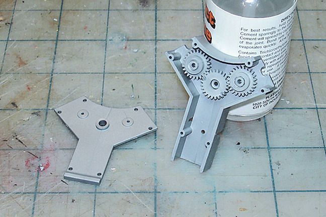

Harry P. Posted August 22, 2015 Author Posted August 22, 2015 Like I mentioned earlier, Pocher engineered their kits to be assembled using hardware, not glue. That makes for many instances where their screws are either out of scale, shouldn't be where they are, or both. Here are just a few of the engine parts where I filled in the screw holes because screw heads would not have been in those locations on the real engine. I'll glue all these parts instead of using Pocher hardware...

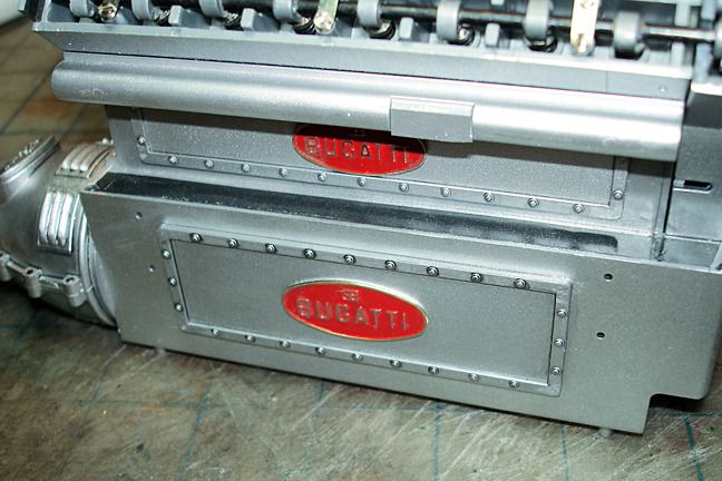

Harry P. Posted August 22, 2015 Author Posted August 22, 2015 These "BUGATTI" nameplates that go on the sides of the engine are really nice... metal with raised lettering. I painted them red and then sanded the paint off the raised area. Too bad that once all the engine components are added, these plates will become practically invisible...

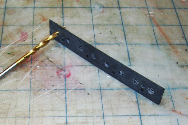

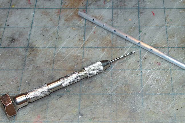

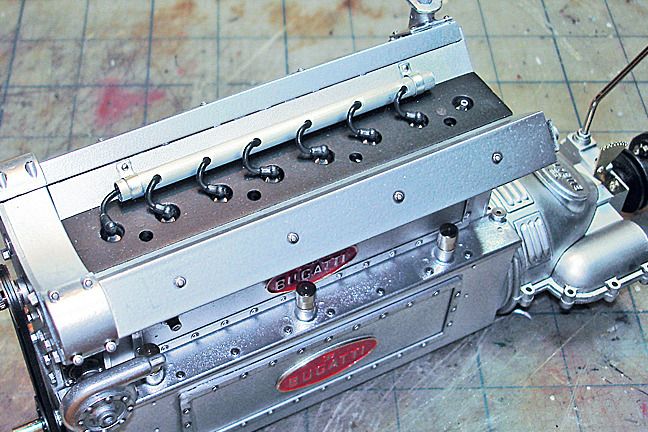

Harry P. Posted August 22, 2015 Author Posted August 22, 2015 No, this isn't the beginnings of a scale model flute... Many cars of this era had wiring looms to keep things neat and tidy under the hood. A loom is easy to make... just a length of aluminum tube with holes for the plug wires spaced evenly...

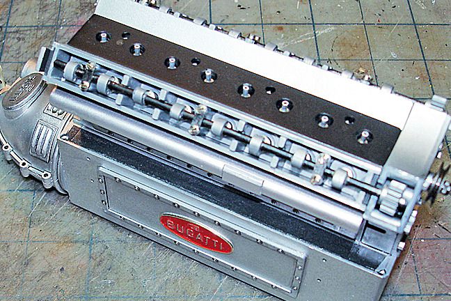

Harry P. Posted August 22, 2015 Author Posted August 22, 2015 Here is the loom in place. The mounting straps are thin aluminum cut from a pie pan. Pocher supplies nice molded spark plug boots, they look good as is, no changes necessary. All I did was cut off a short length of ignition wire at the boot end and attach them in place between the plugs and the loom. The last plug wire will run directly from the distributor to the spark plug, it won't need to go through the loom. I'll attach the cut-off parts of the ignition wires to the distributor and run them into the back end of the loom, so it'll look as if the wires are really running from the distributor through the loom and to the plugs... but it would have been impossible to feed seven ignition wires through the holes in the loom and out the back end. My way of doing it will look like that's what happening, only my way is much easier! BTW, those four holes in the valley cover are where the water pipe will attach.
