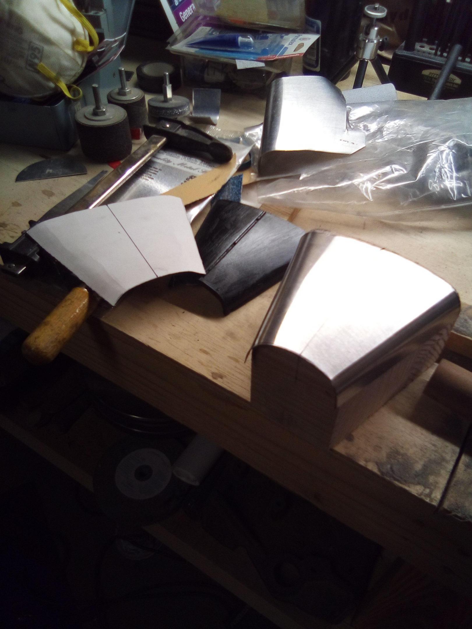

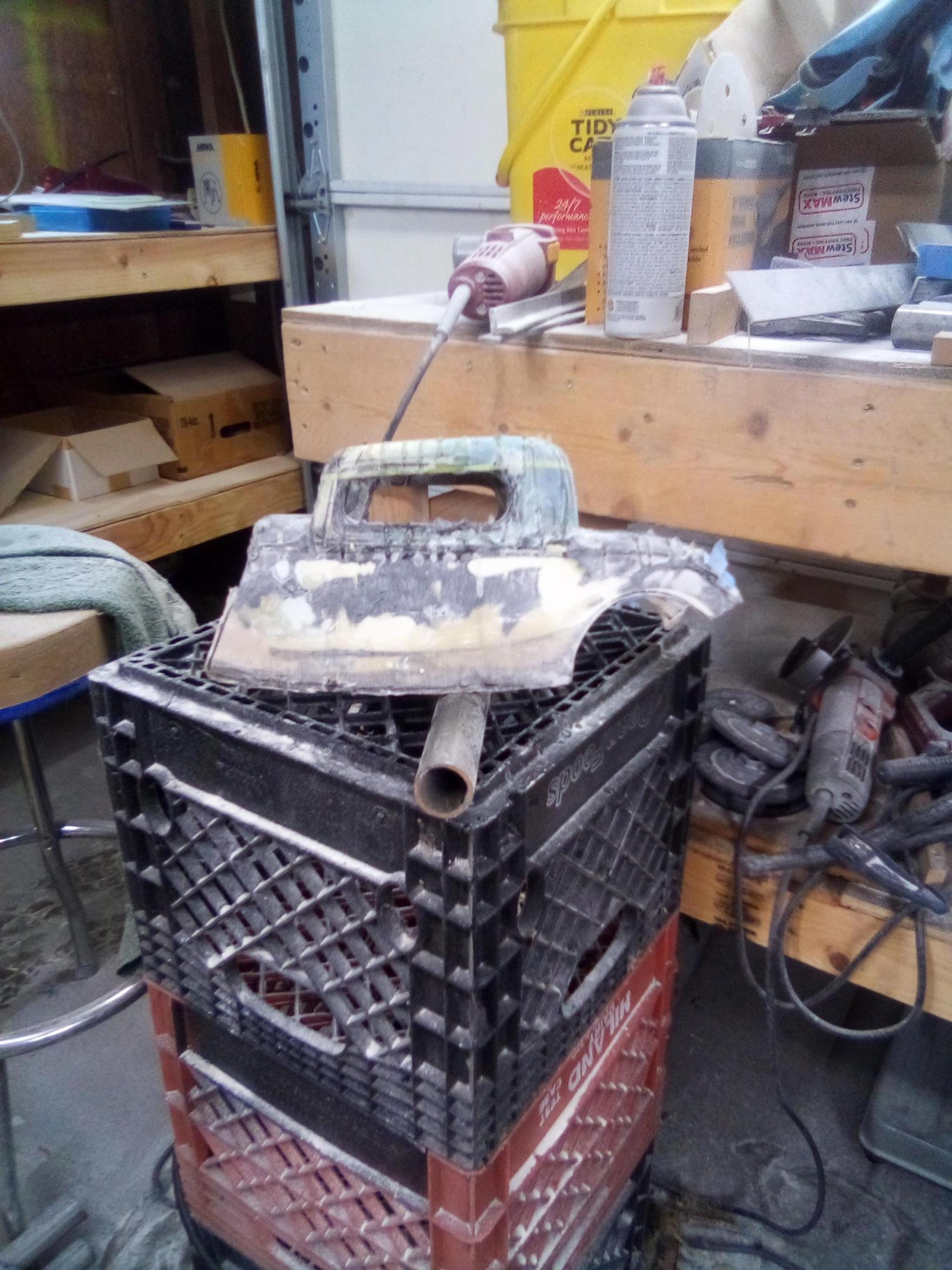

Ognib Posted June 26, 2020 Author Share Posted June 26, 2020 Working on a hood and deck lid in aluminum. Cut a buck to fit to. Also pictured is the aluminum grill shell I shaped in the roadster thread. Quote Link to comment Share on other sites More sharing options...

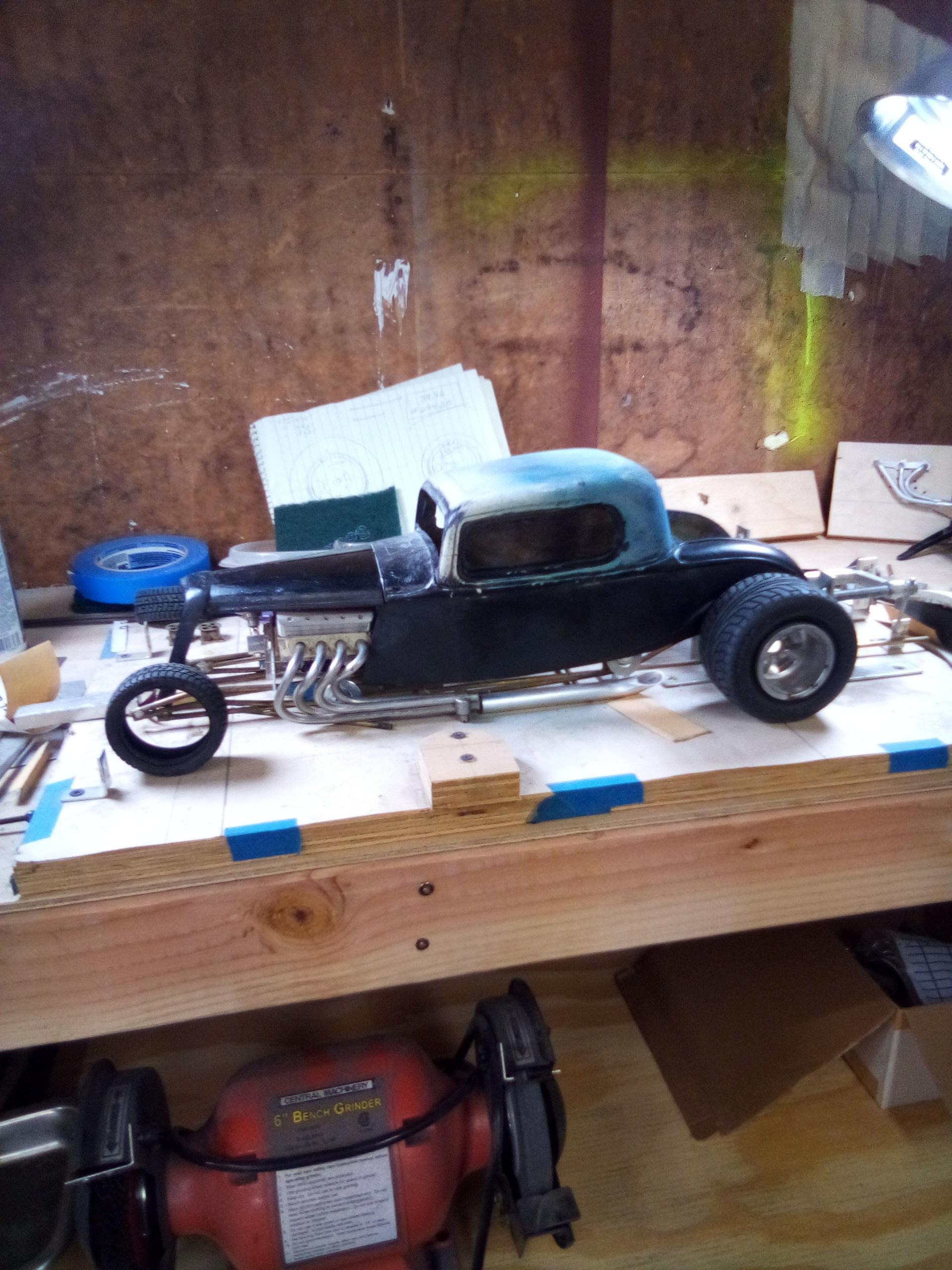

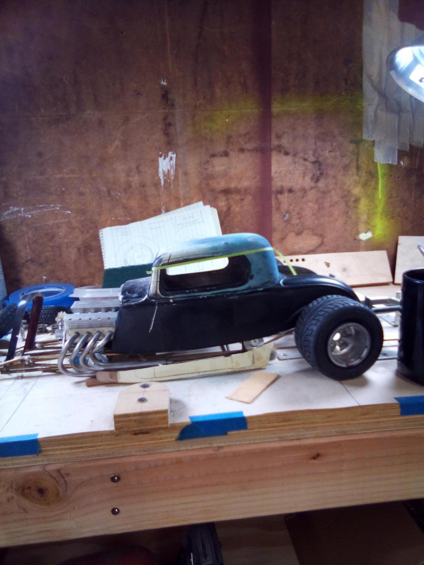

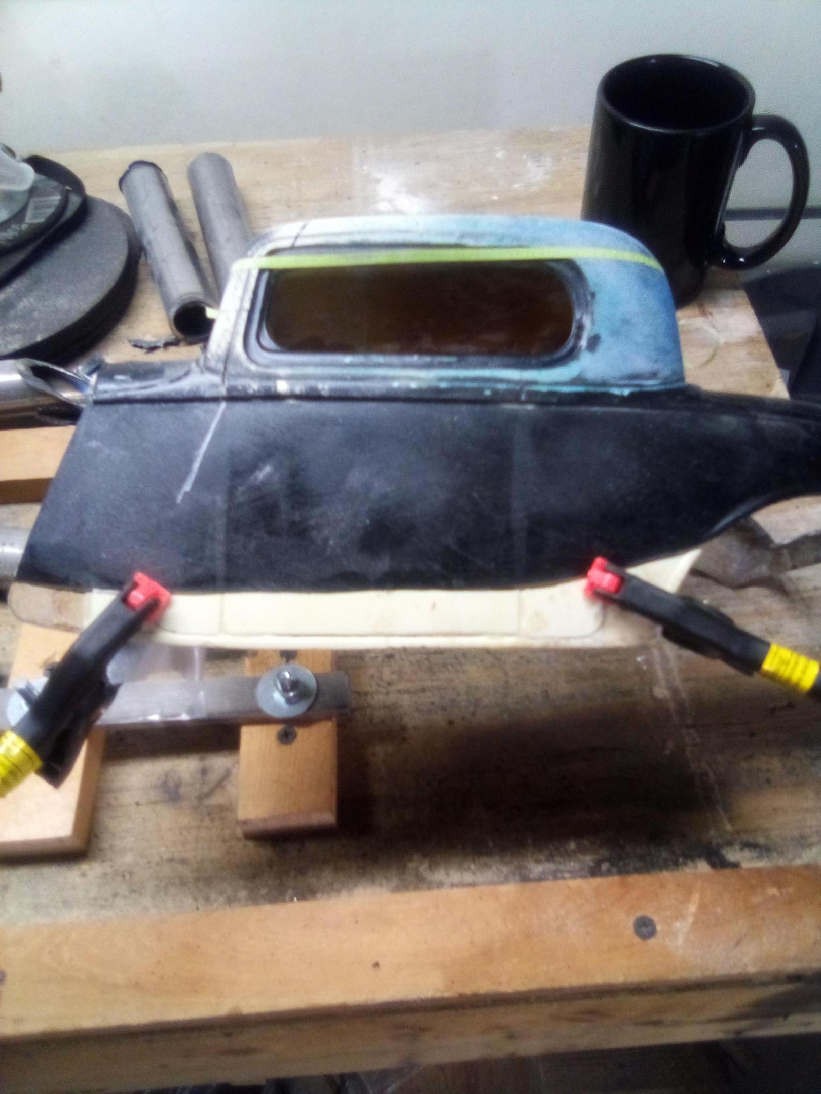

Ognib Posted June 26, 2020 Author Share Posted June 26, 2020 Well, that worked well. Wife and I moved couple of yrs back model projects now have a bench all their own. When looking at the side shot of the car, I have decided I don't like the proportion of the height of the side of body to height of top. I chopped the top 3 in scale at the time I converted it from 5 window to 3 window. I also took a slice off of the bottom of the body. Going to rebuild that move for more body height or take more out of the top. Proportion is everything here for proper visual balance. Quote Link to comment Share on other sites More sharing options...
blunc Posted June 27, 2020 Share Posted June 27, 2020 I feel you should add the height back into the body. Quote Link to comment Share on other sites More sharing options...
Ognib Posted June 27, 2020 Author Share Posted June 27, 2020 Blunc, thanks for the feedback. The other option a secondary chop on the top. I saw a deuce 3 window a while back that had a deeply cut top and the entire windshield frame was cut away from the cowl and top and refitted, laying it all back, raking the a pillar at about the same angle as the grill shell on this one. I've already built the cowl sides to match as well having the front door edge laid out with that shape as well. I illustrated all of this thourghly earlier in the thread. It's one of those things that, the more I look at the body with this concept in mind, the more I think it will tie the flow of the lines of the car together. Still will lower the sides, I think. Was not a good move...still have the pieces I cut off so some glass mat and back the way it was. Quote Link to comment Share on other sites More sharing options...

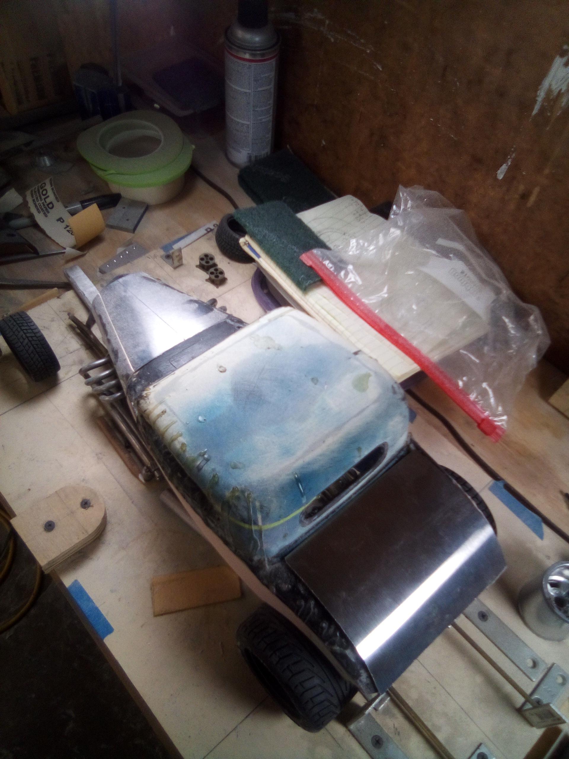

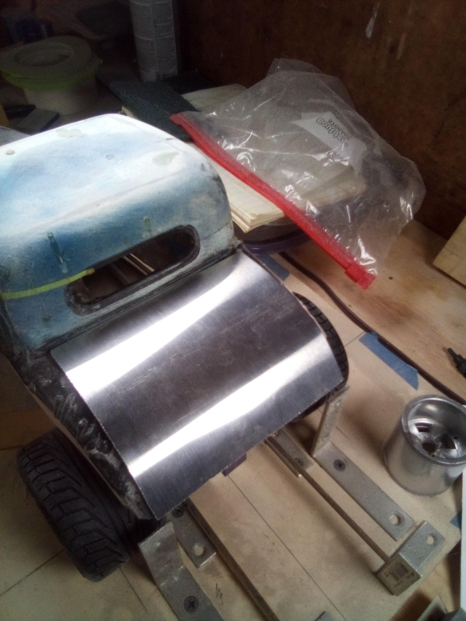

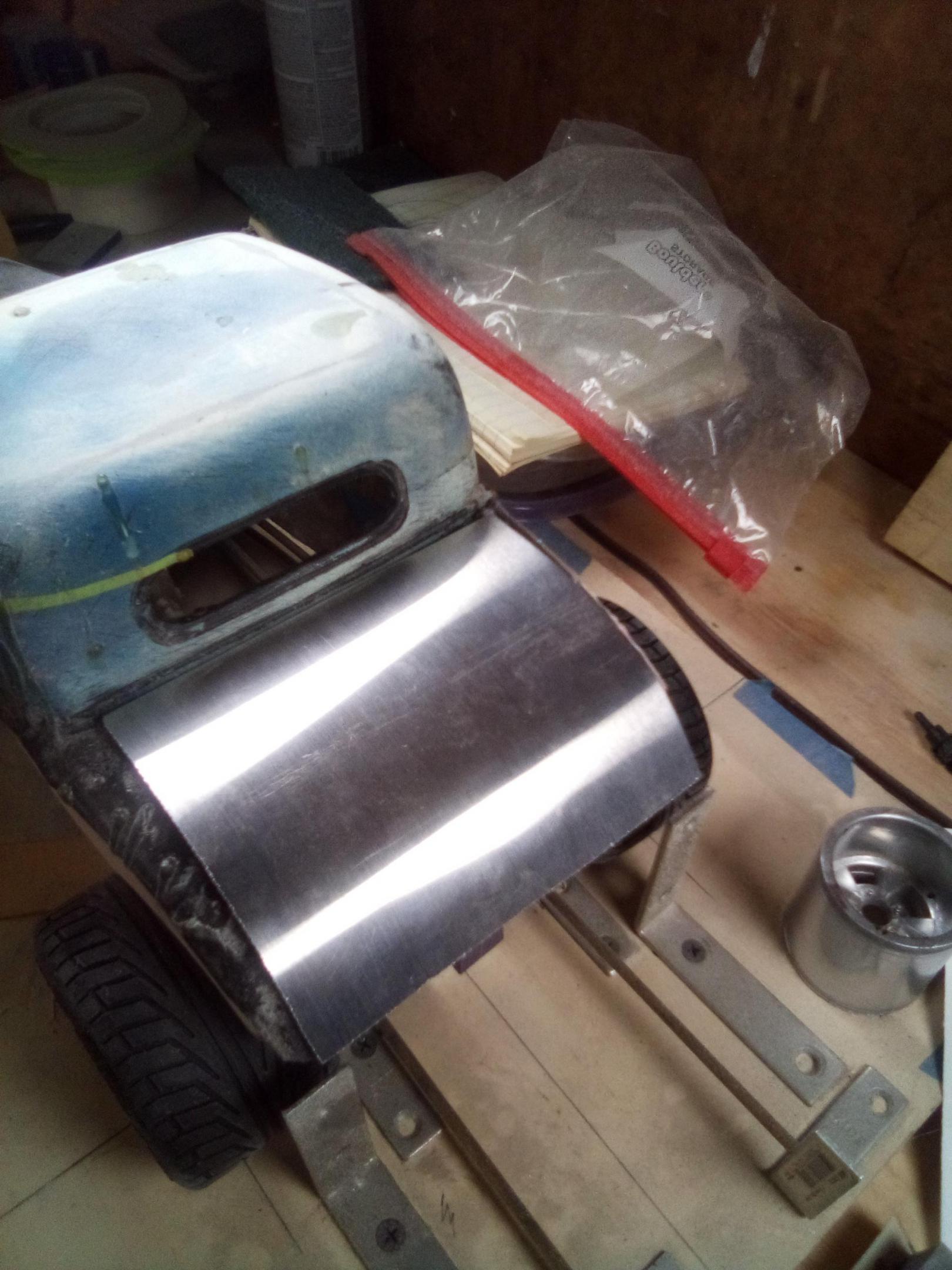

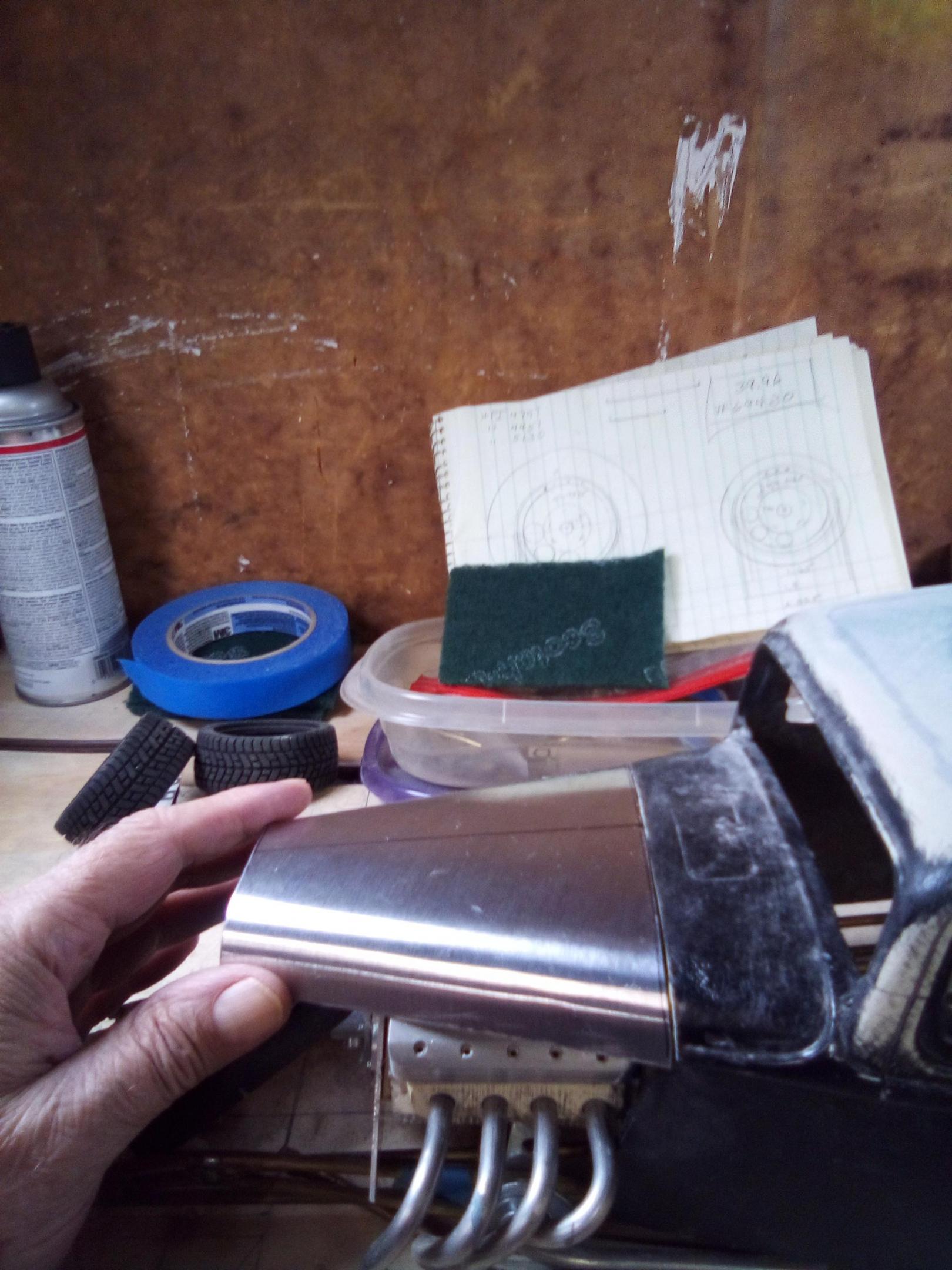

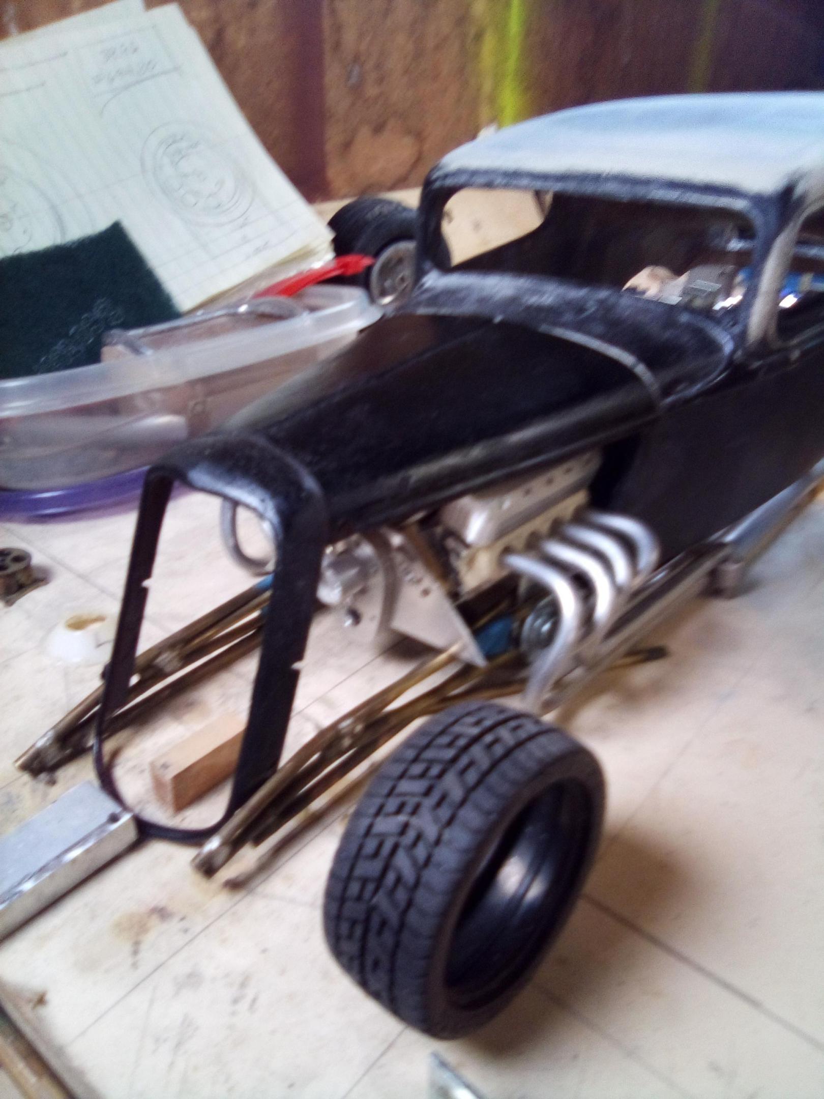

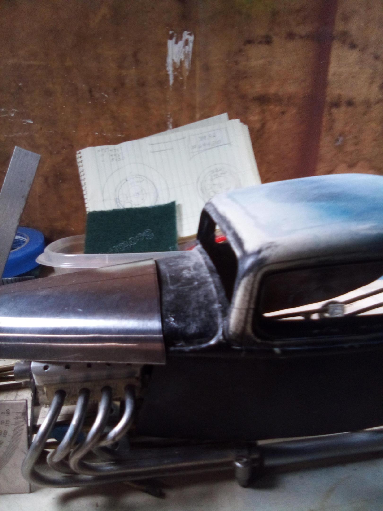

Ognib Posted June 27, 2020 Author Share Posted June 27, 2020 (edited) Hood is cut slightly oversize...allow final trimming for fit to the body and grill shell. The grill is set at desired angle. Hood at the cowl, across the top is slightly over bent. At the grill, it fits well on passenger side but is bent too tight on driver's side. All in all, perty good for first fit. Edited June 27, 2020 by Ognib Quote Link to comment Share on other sites More sharing options...

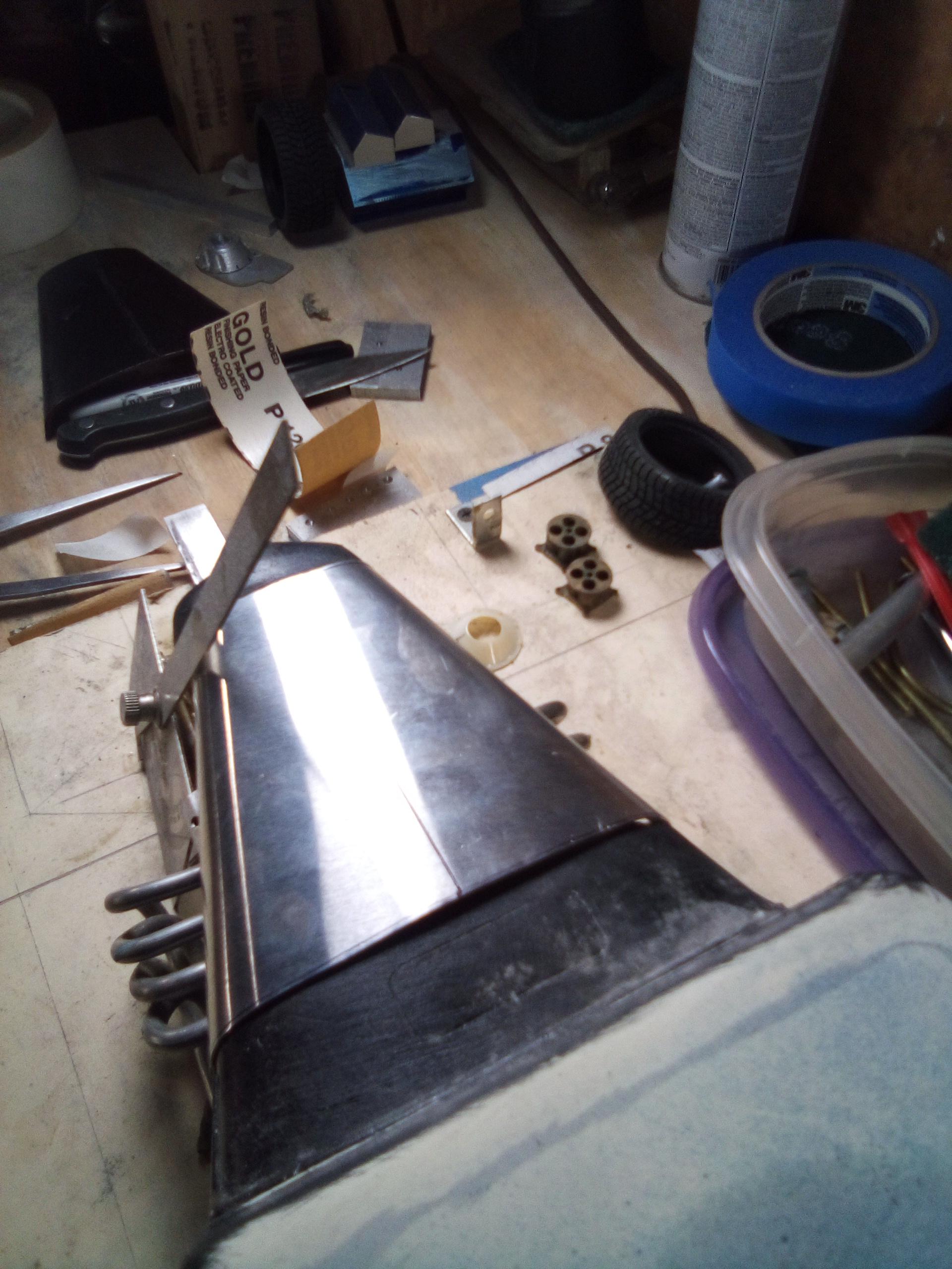

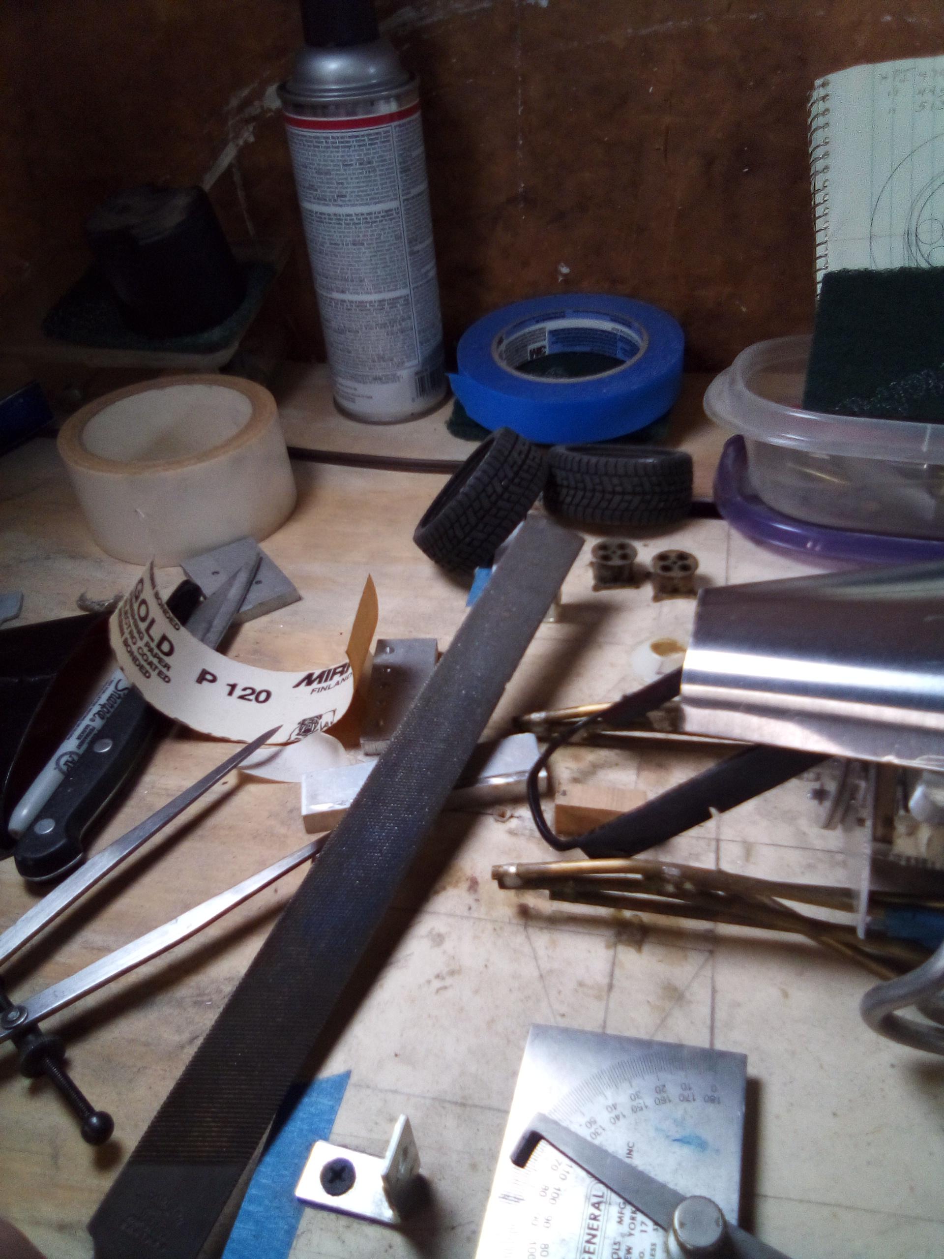

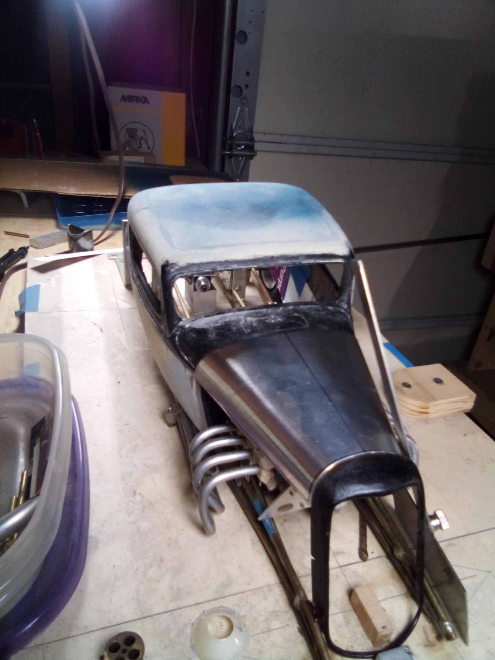

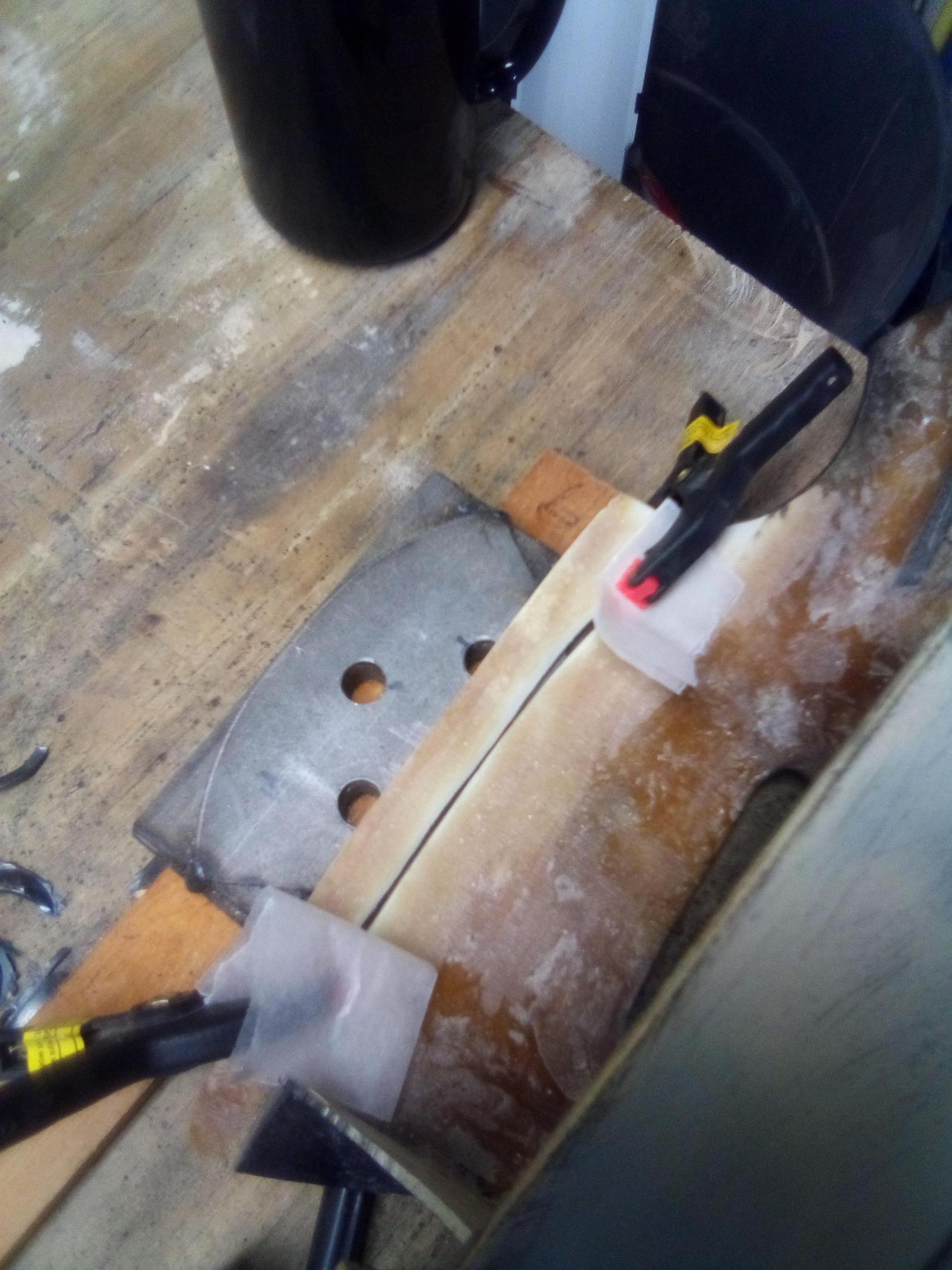

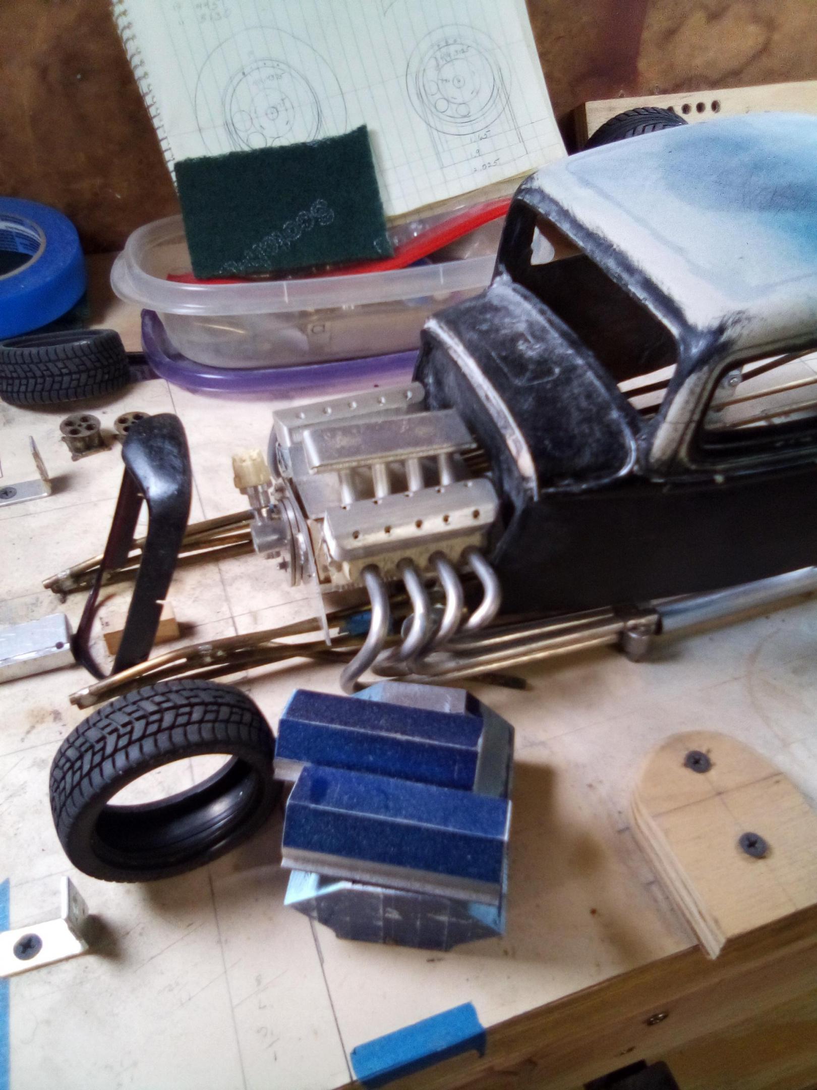

Ognib Posted June 28, 2020 Author Share Posted June 28, 2020 Fitting to the cowl. Dressing with a fairly coarse file until I get a good fit all the way across. Going to reattach the lower body sides at this time as well as to finalize body height, want a subtle down rake to the hood as it travels on forward to the grill. Quote Link to comment Share on other sites More sharing options...

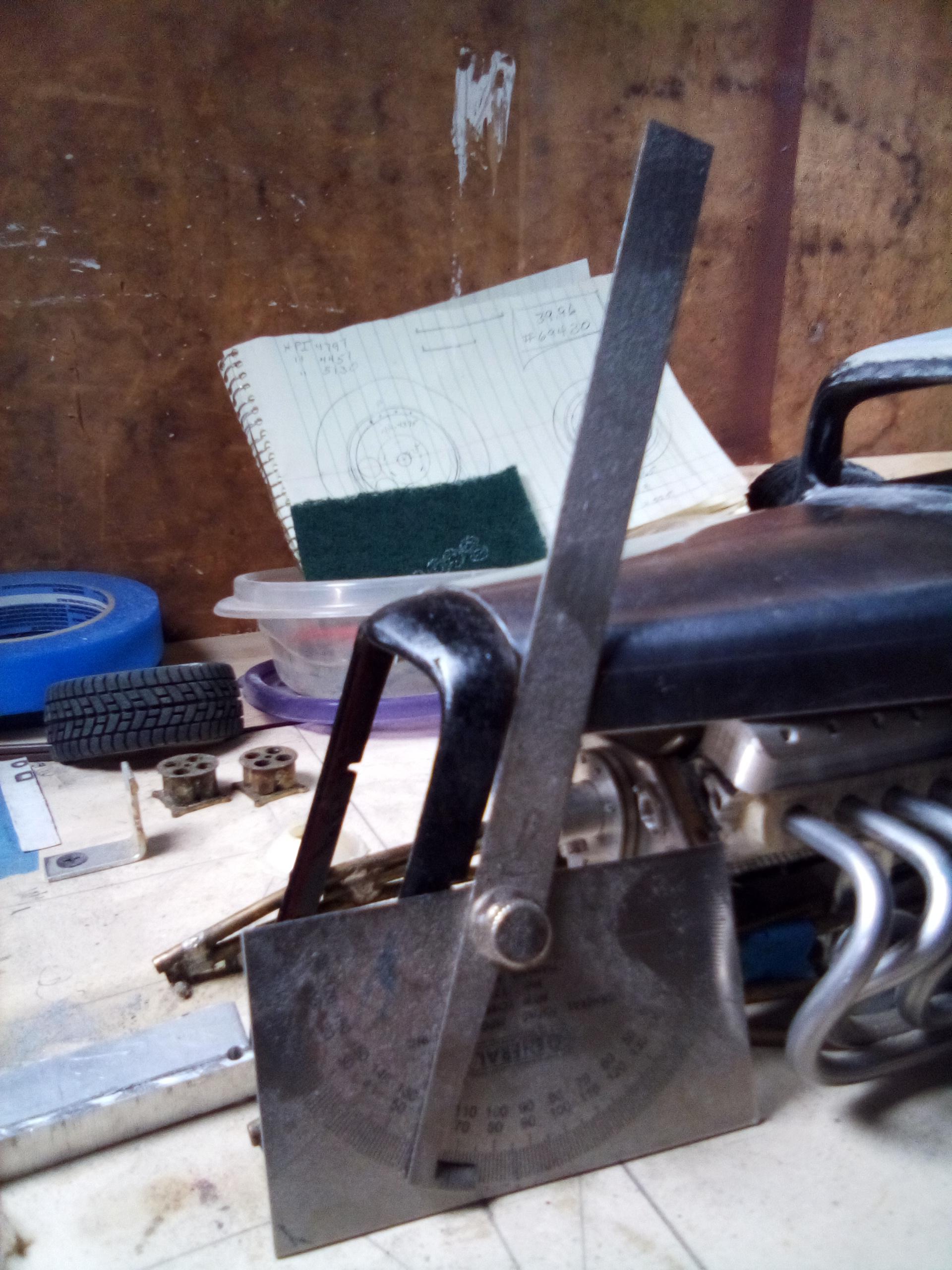

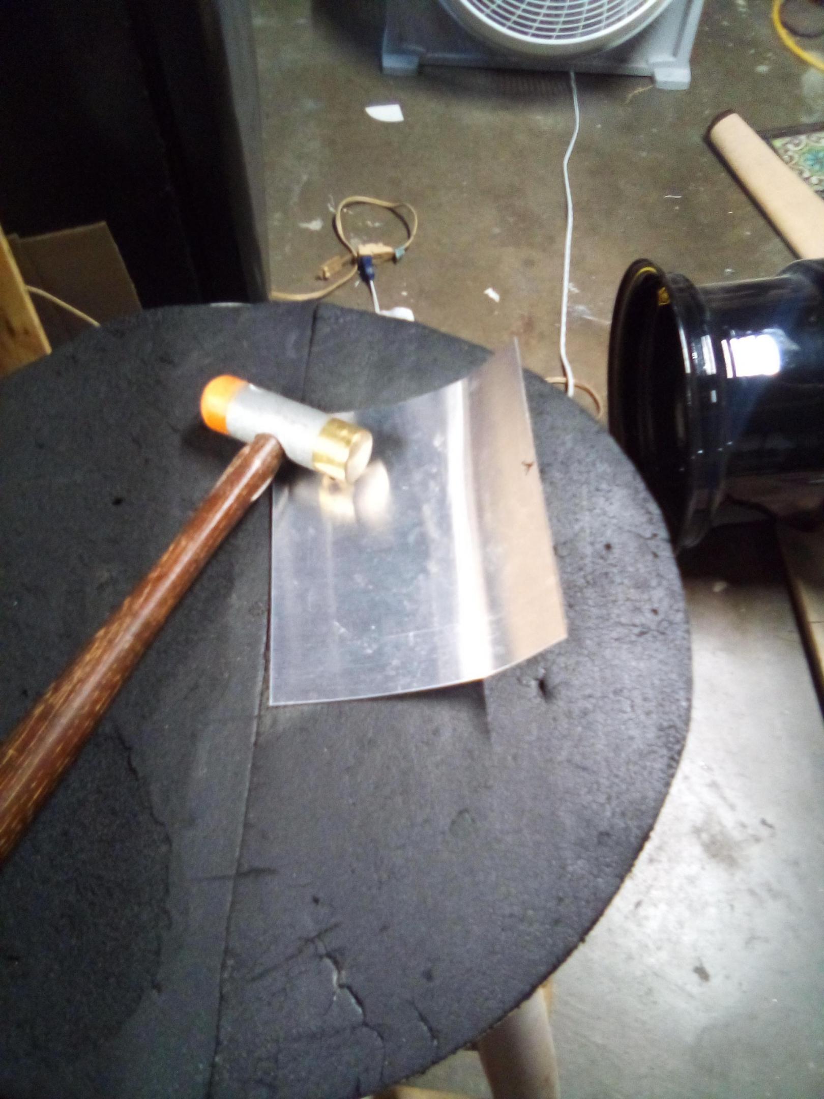

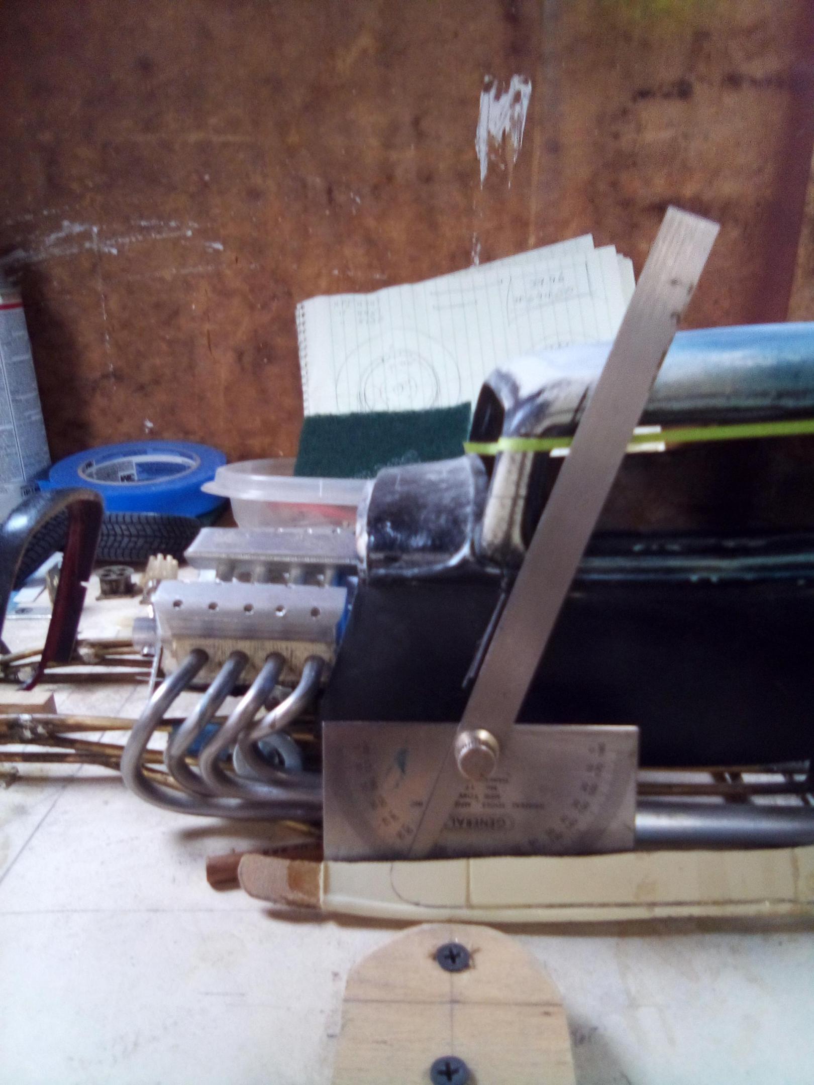

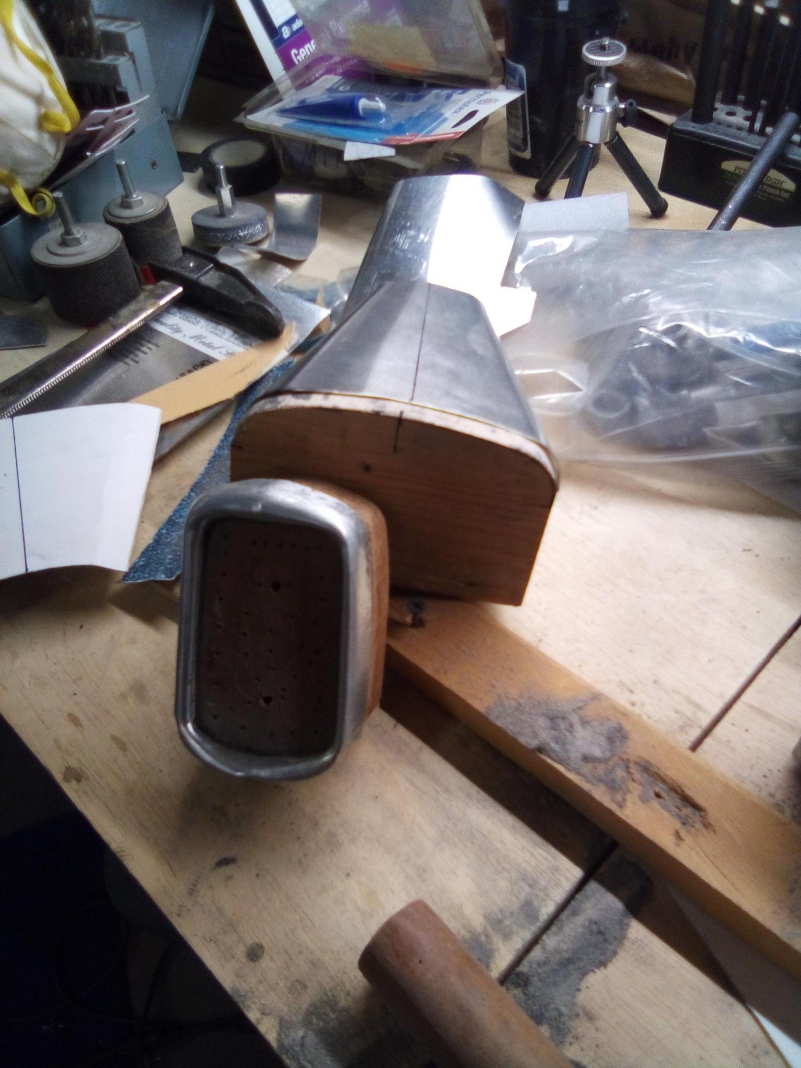

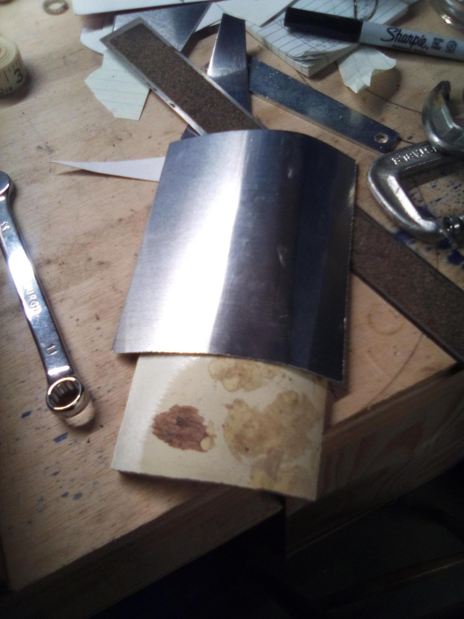

Ognib Posted June 28, 2020 Author Share Posted June 28, 2020 Couple of shots of the decklid process. I'm hammering the area that needs the dome. Hammer has a domed face and I'm working it into a dense foam pad that let's the metal move into it as it's worked by the hammer. Concept for top. Lay the a pillar back to match the angle used on everything else. Reattach the original body sides. Slight chop more at front giving a slight down rake to the roofline.ó Quote Link to comment Share on other sites More sharing options...

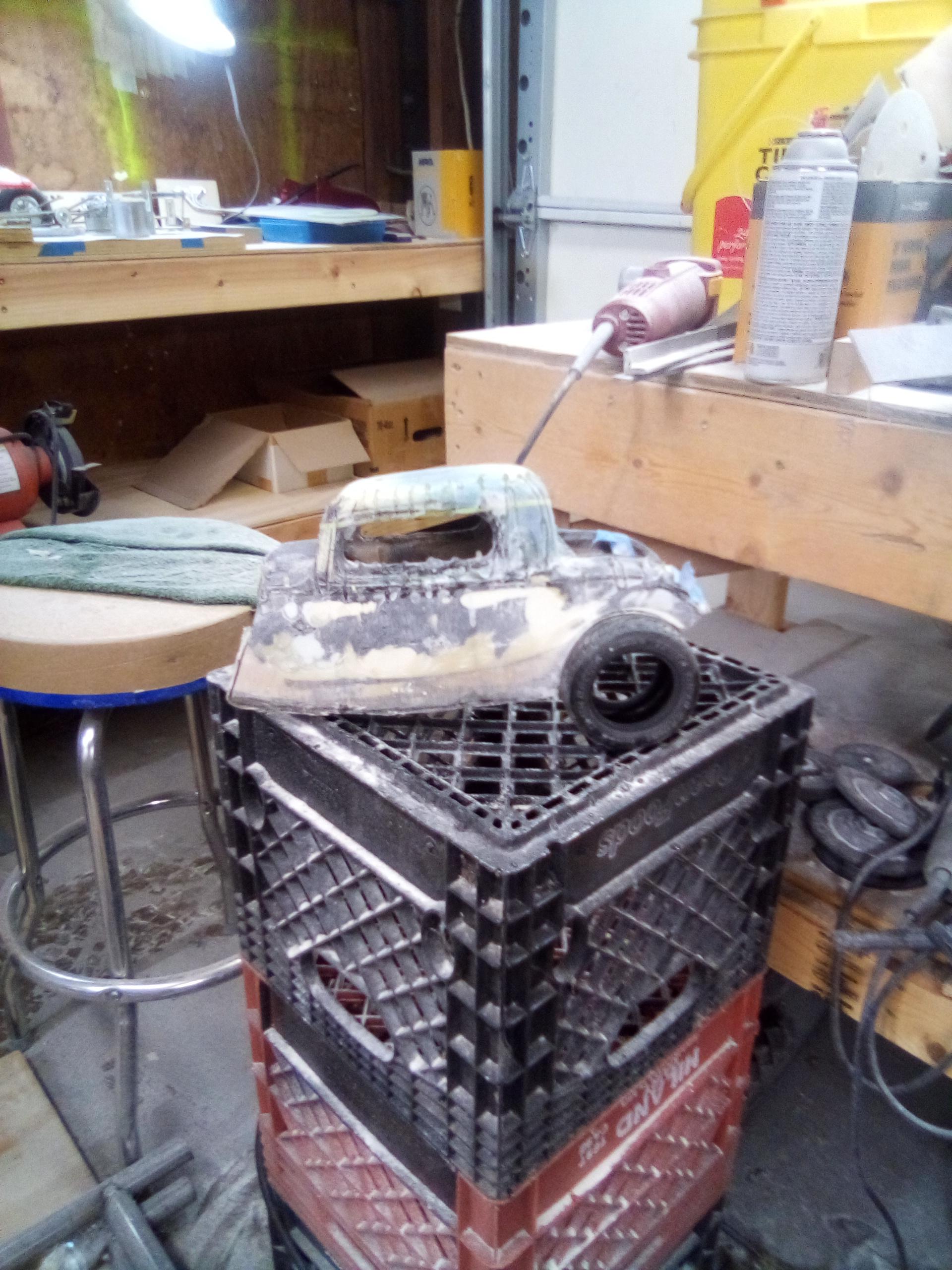

Ognib Posted June 30, 2020 Author Share Posted June 30, 2020 The body on this piece was very thin and weak so when I did the chop i also glassed the entire inside of the body with mat to stiffen it up a bit. Used a small hand held belt sander to dress everything for this procedure. Quote Link to comment Share on other sites More sharing options...
Ognib Posted July 9, 2020 Author Share Posted July 9, 2020 Proportion between top and sides much better now. Reconfigured the wheel opening to match the tires. Get the changes to the top roughed in next and then finalize everything together. Quote Link to comment Share on other sites More sharing options...
Ognib Posted July 9, 2020 Author Share Posted July 9, 2020 After I got the glass and mat level and straight, mixed up a bit of Bondo for a top coat. Started with sticky back 40 grit on a stick. Quote Link to comment Share on other sites More sharing options...

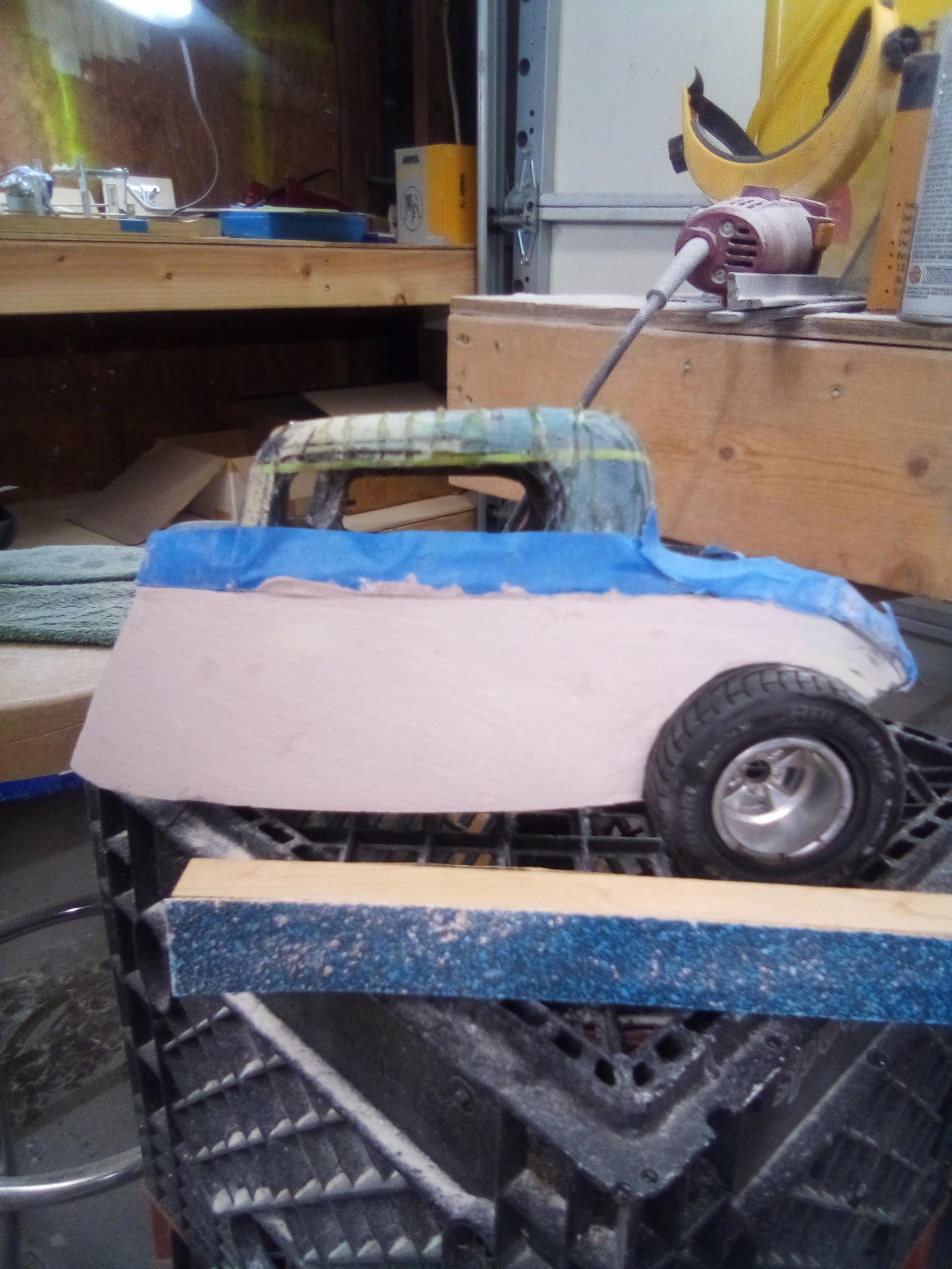

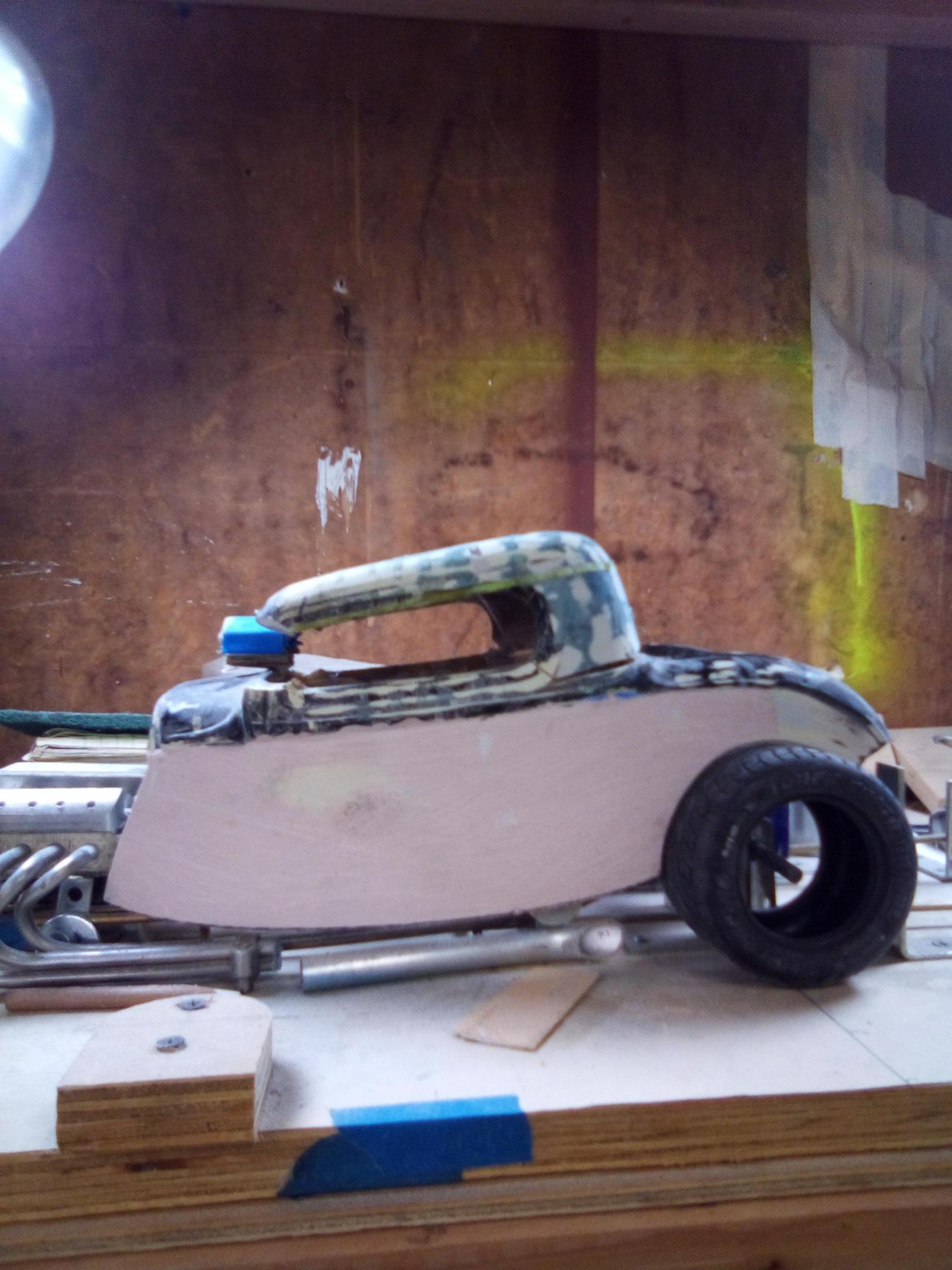

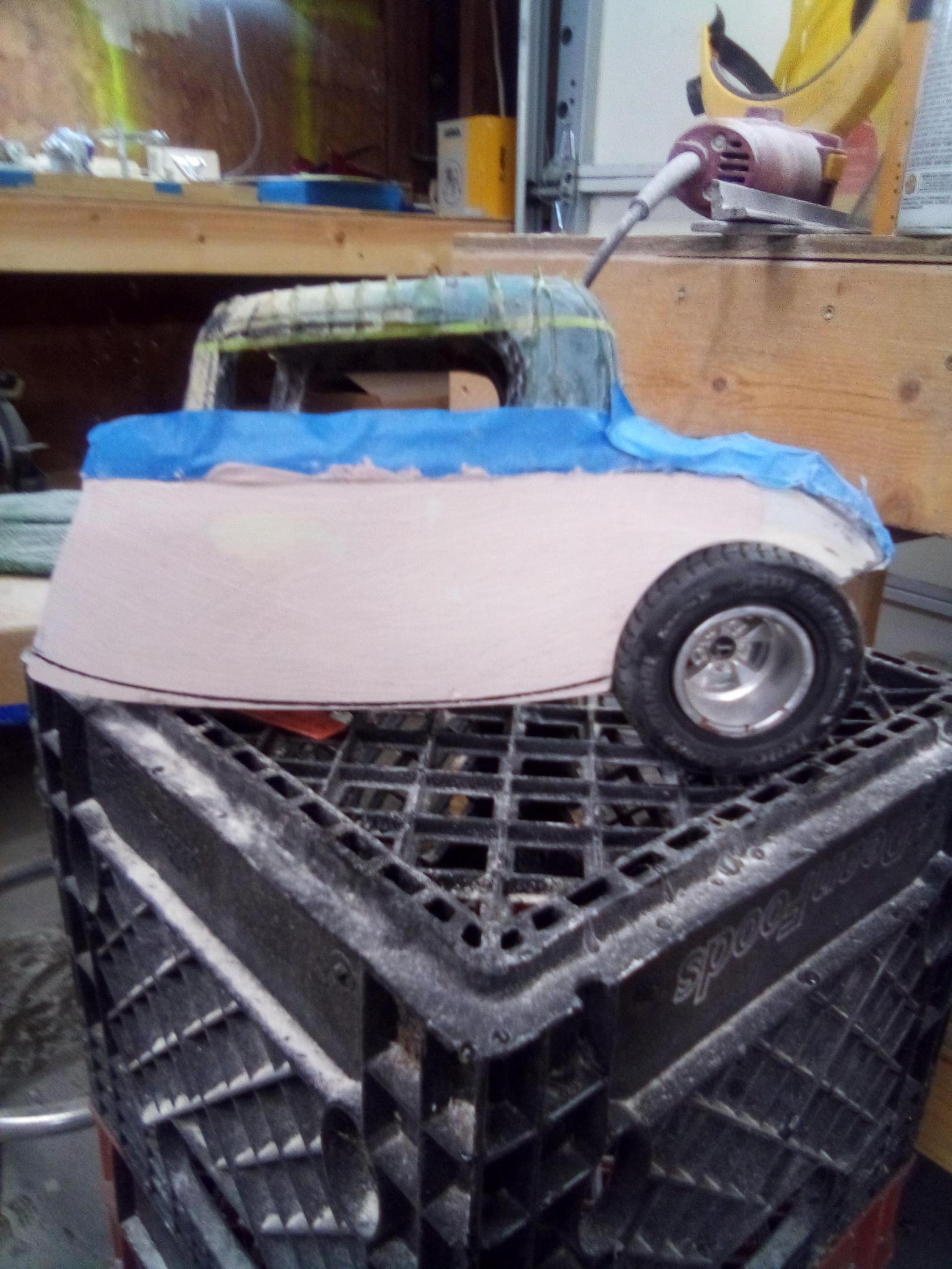

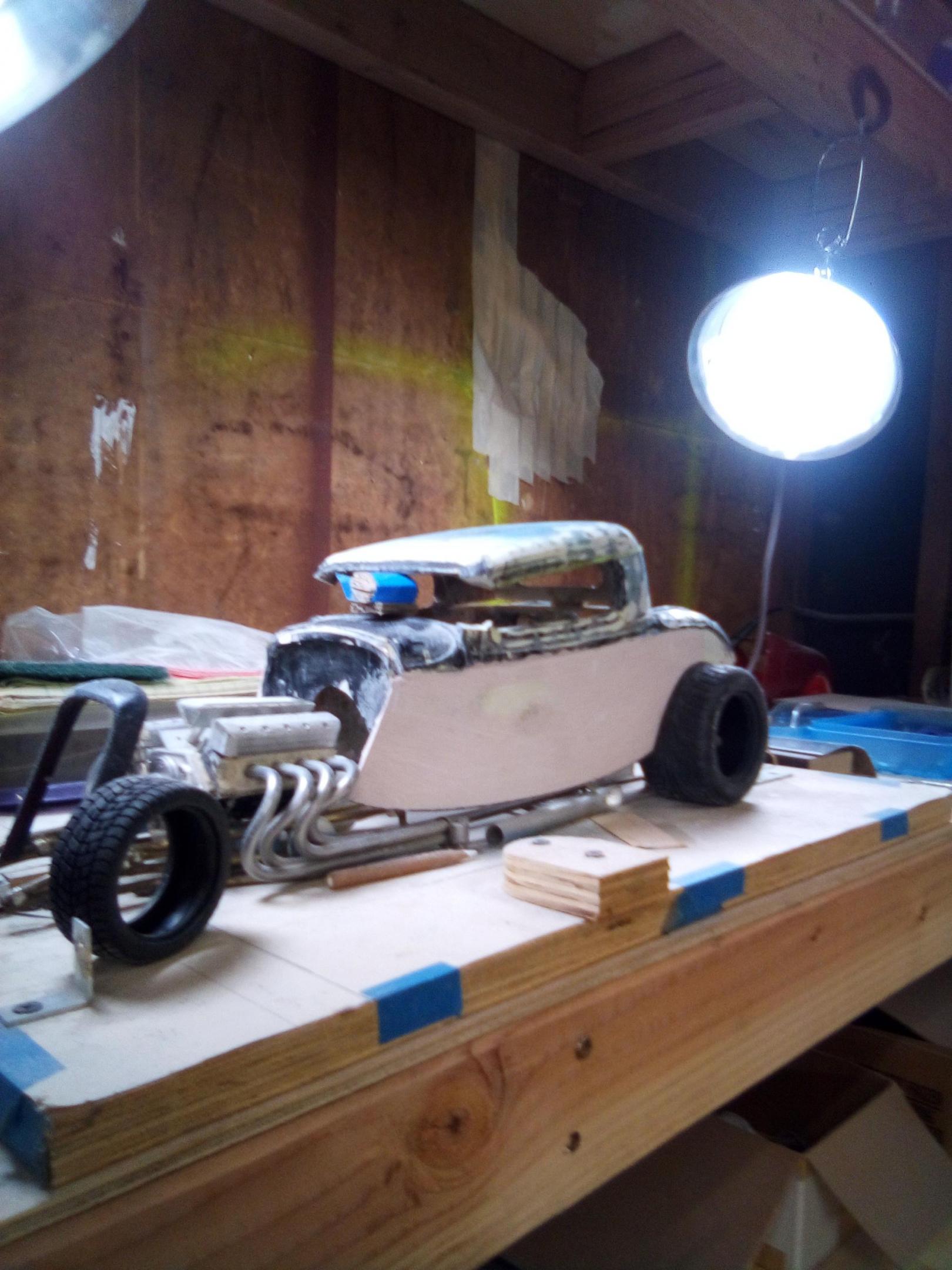

Ognib Posted July 9, 2020 Author Share Posted July 9, 2020 Proposed profile for lower body line. Quote Link to comment Share on other sites More sharing options...

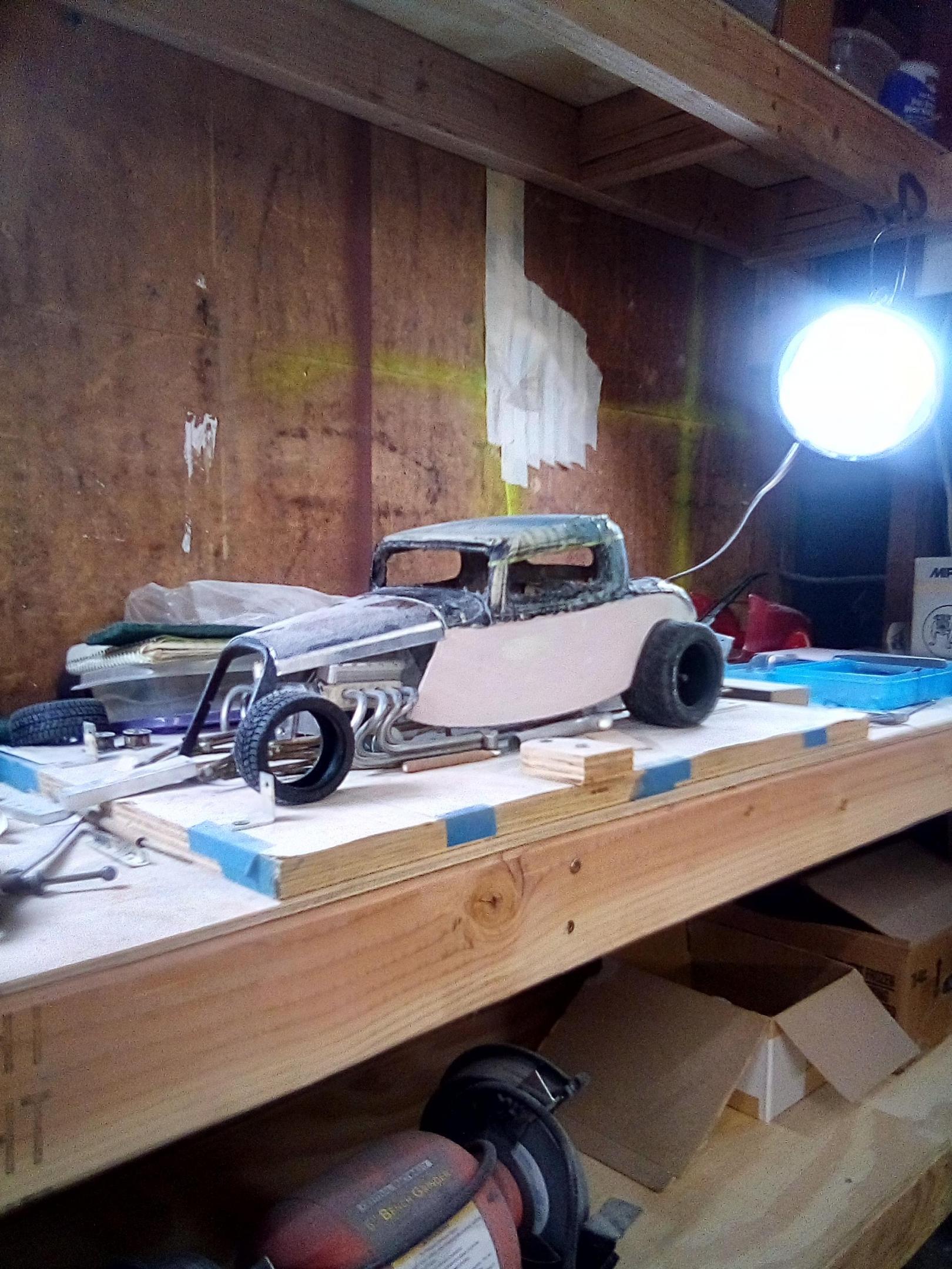

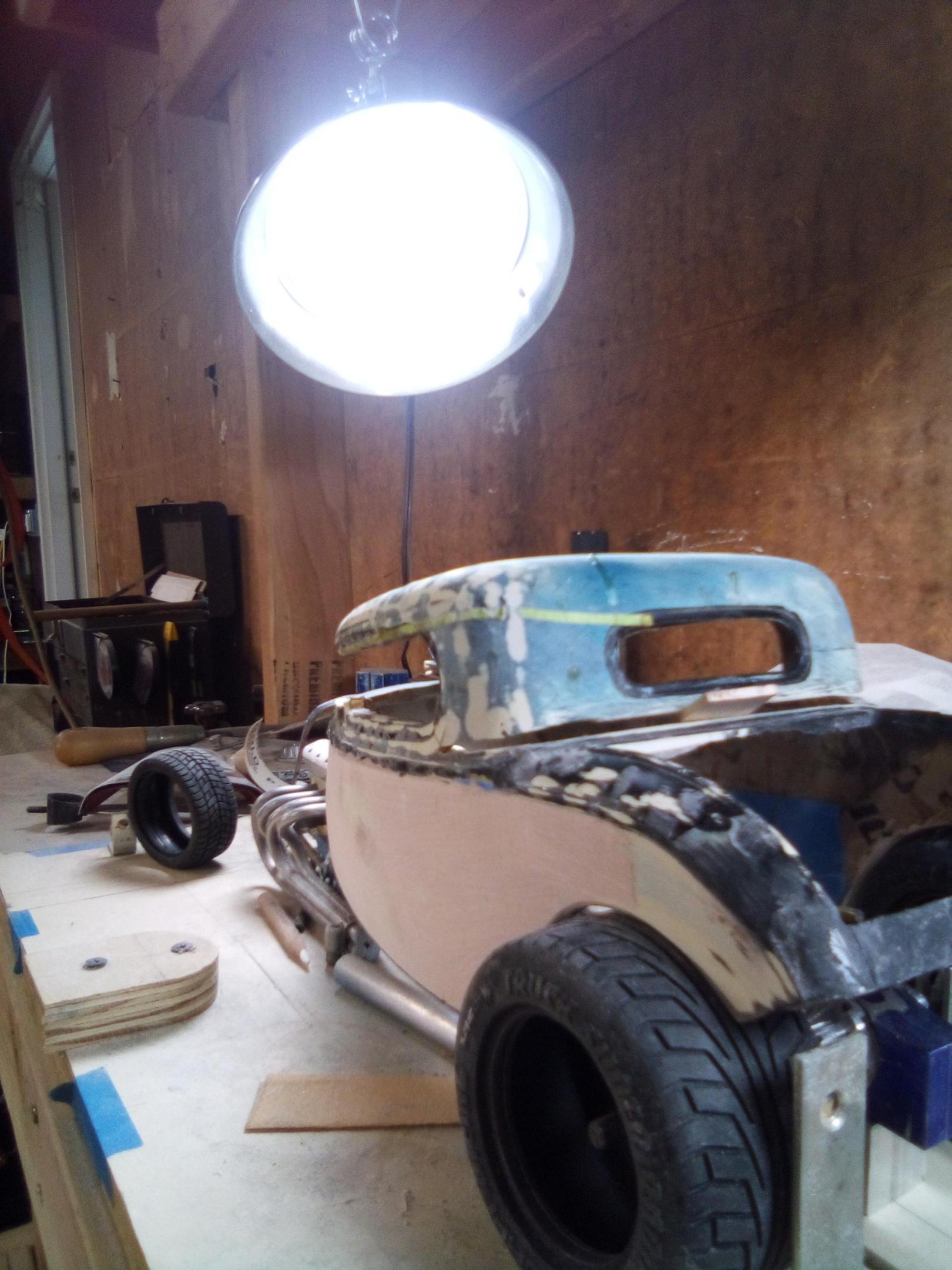

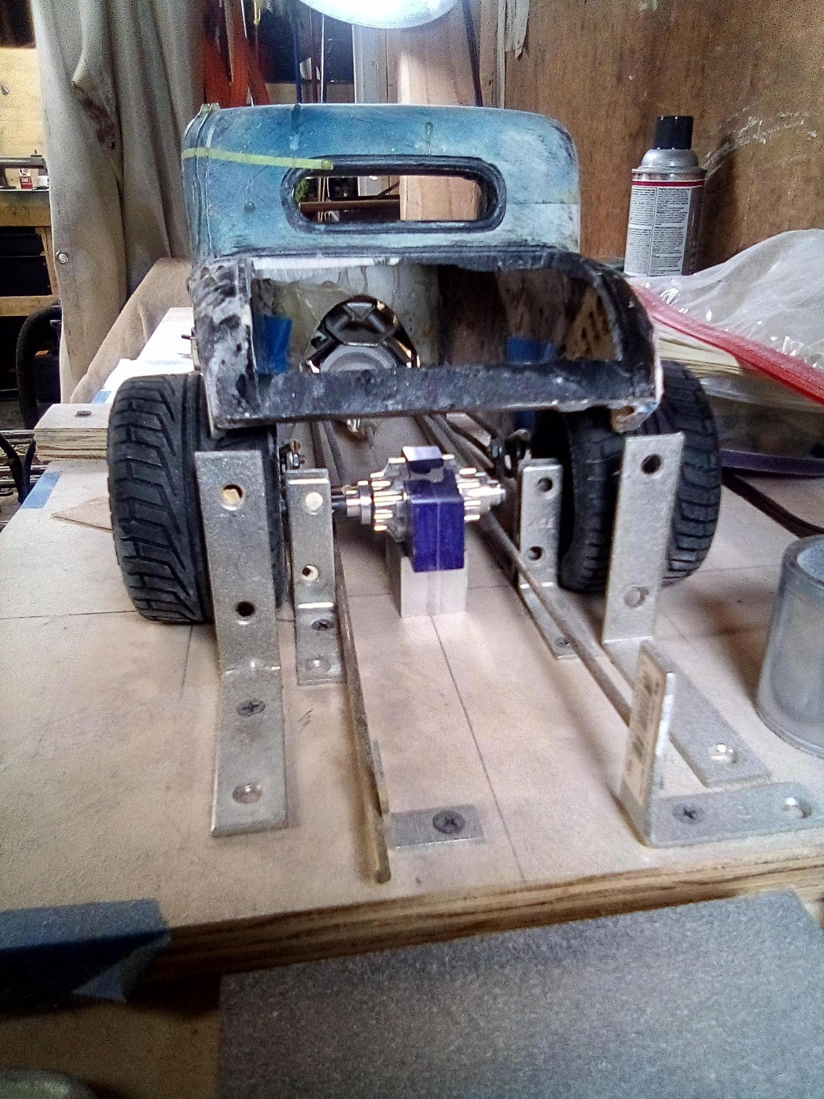

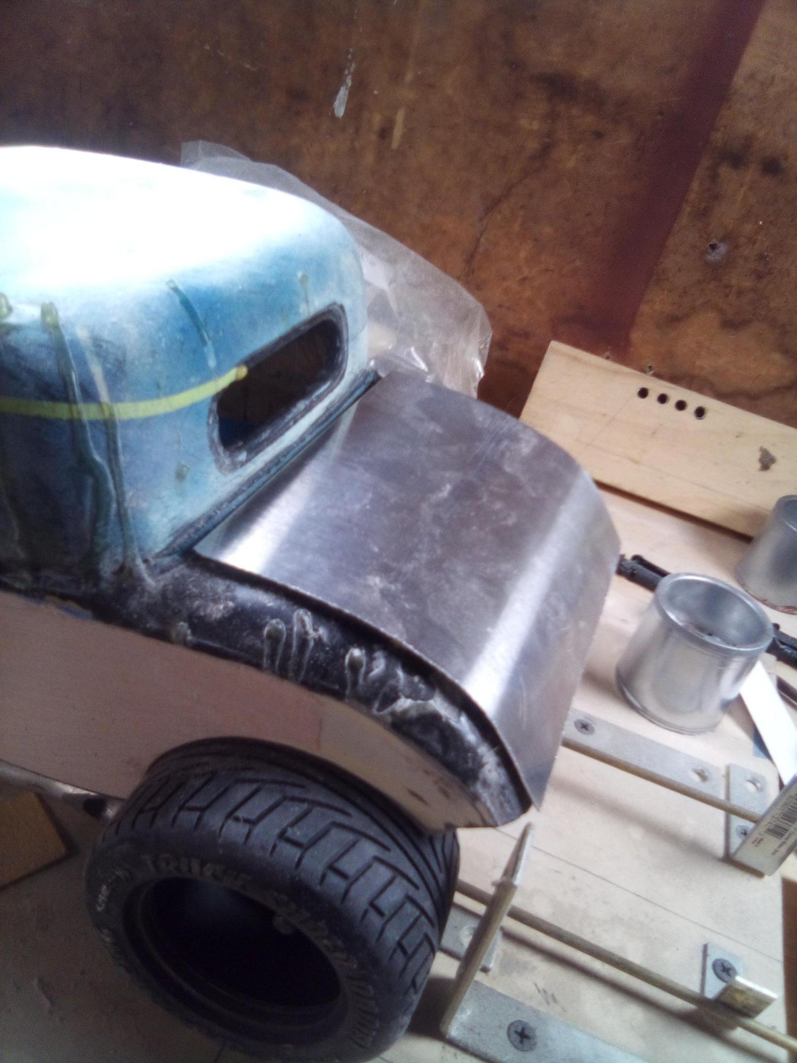

Ognib Posted July 10, 2020 Author Share Posted July 10, 2020 Hey L. Thanks for the very nice words and the sentemint. Much appreciated. Was the right thing to do. Proportion between top to body side...much better to my eye now. Back on the frame, it now has the nice forward rake to everything that is essential for the vibe I want for it. Going to tub it, I think,...get half of the tires tucked into the body. Get away from the dually truck look that occurs when the tires are outside the body. Hood is close to a good fit to cowl. Bottom edge will still need trimming. Still over long at grill. Quote Link to comment Share on other sites More sharing options...

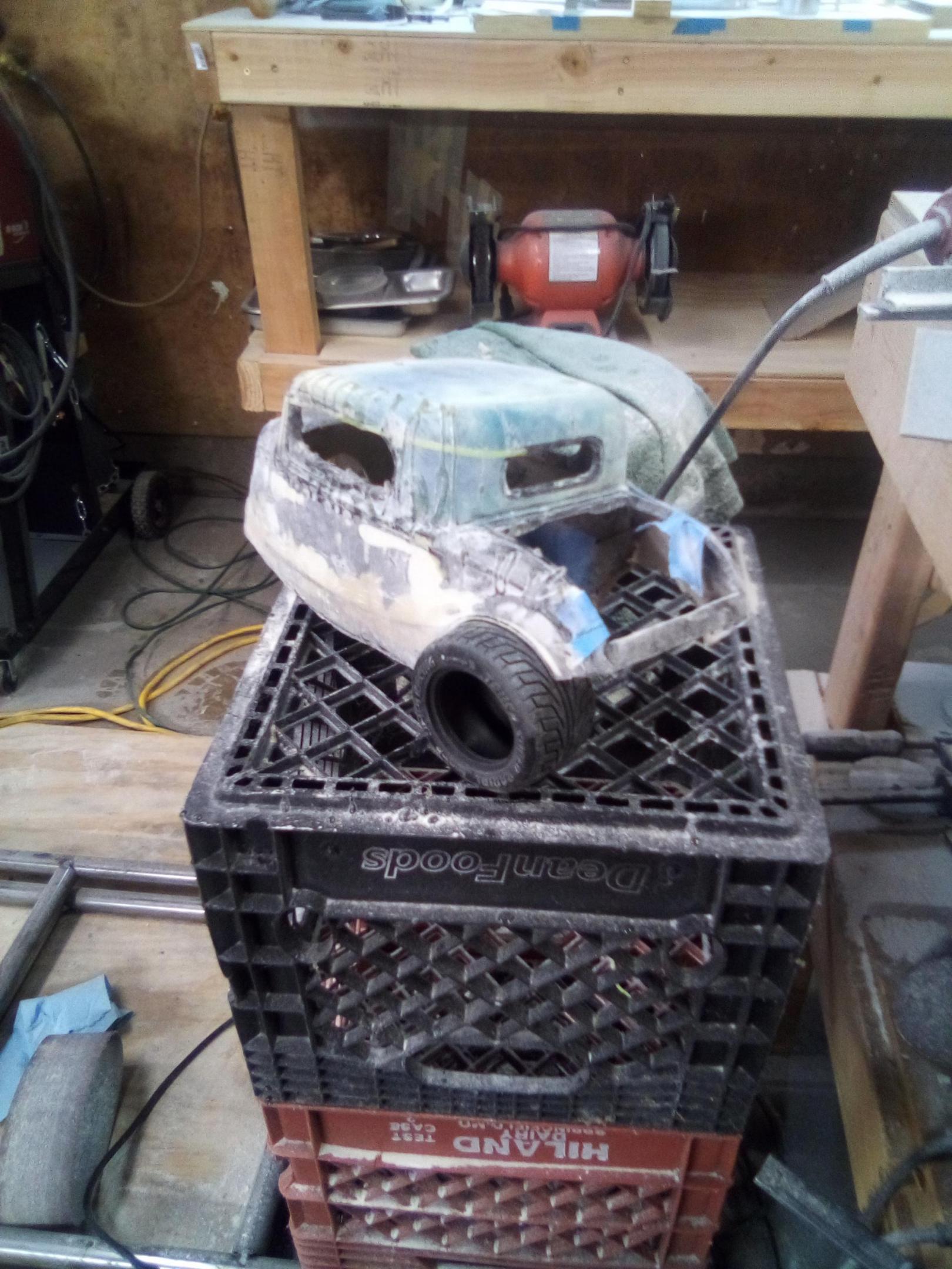

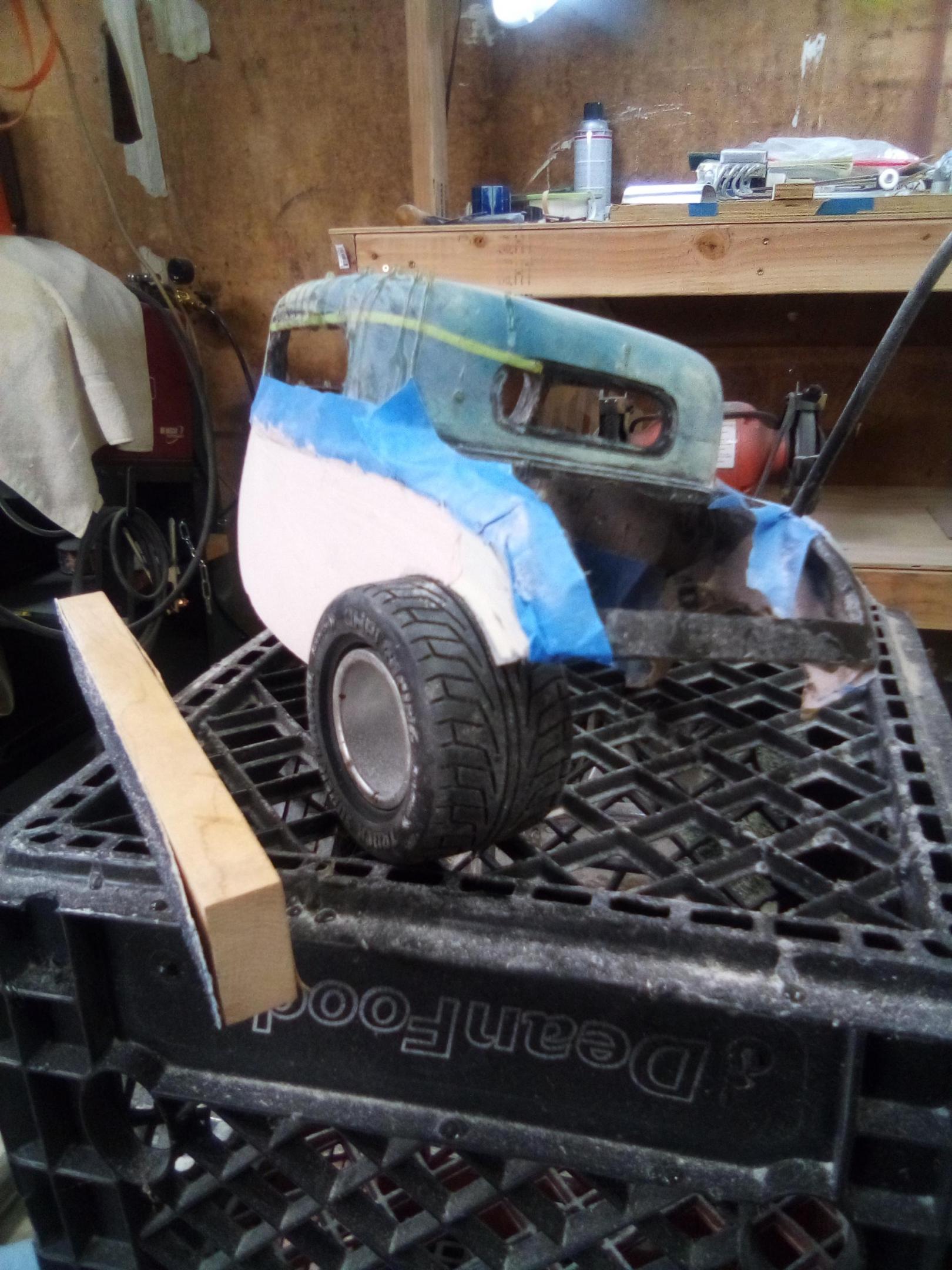

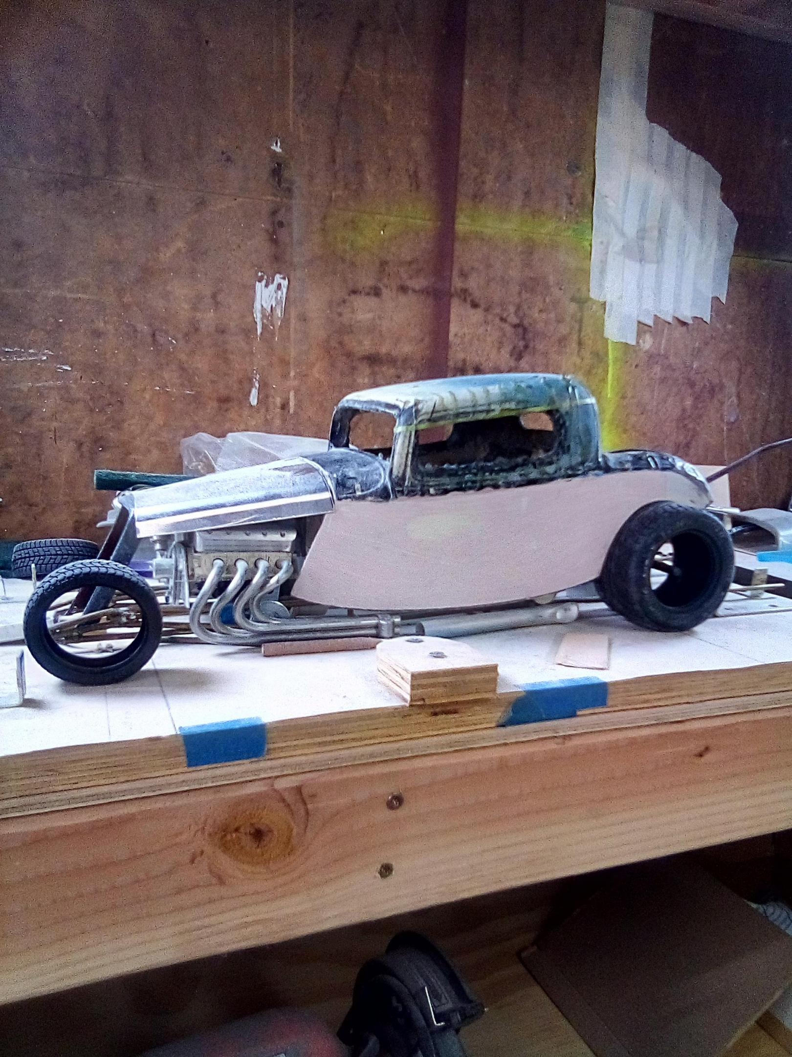

Ognib Posted July 11, 2020 Author Share Posted July 11, 2020 L.i., thanks for the feedback. Hard core Fab work going on here folks, even if it is in mineature. Sides need more shrink to pull the side to side radius into place. Front to back is very close to good. Quote Link to comment Share on other sites More sharing options...
Ognib Posted July 11, 2020 Author Share Posted July 11, 2020 Something like this. Let it set and look at it for a while. Don't want to go too radical. Quote Link to comment Share on other sites More sharing options...
