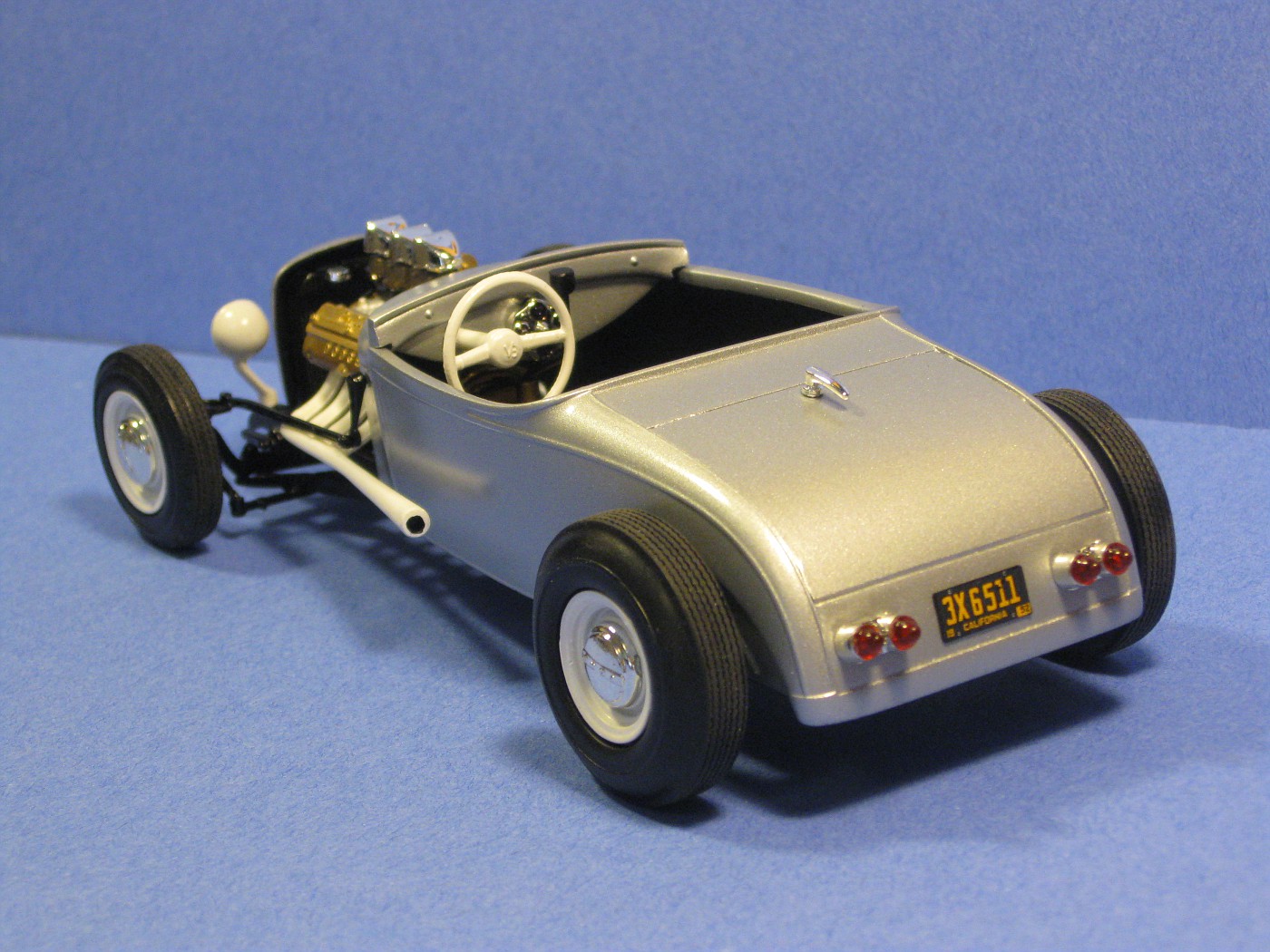

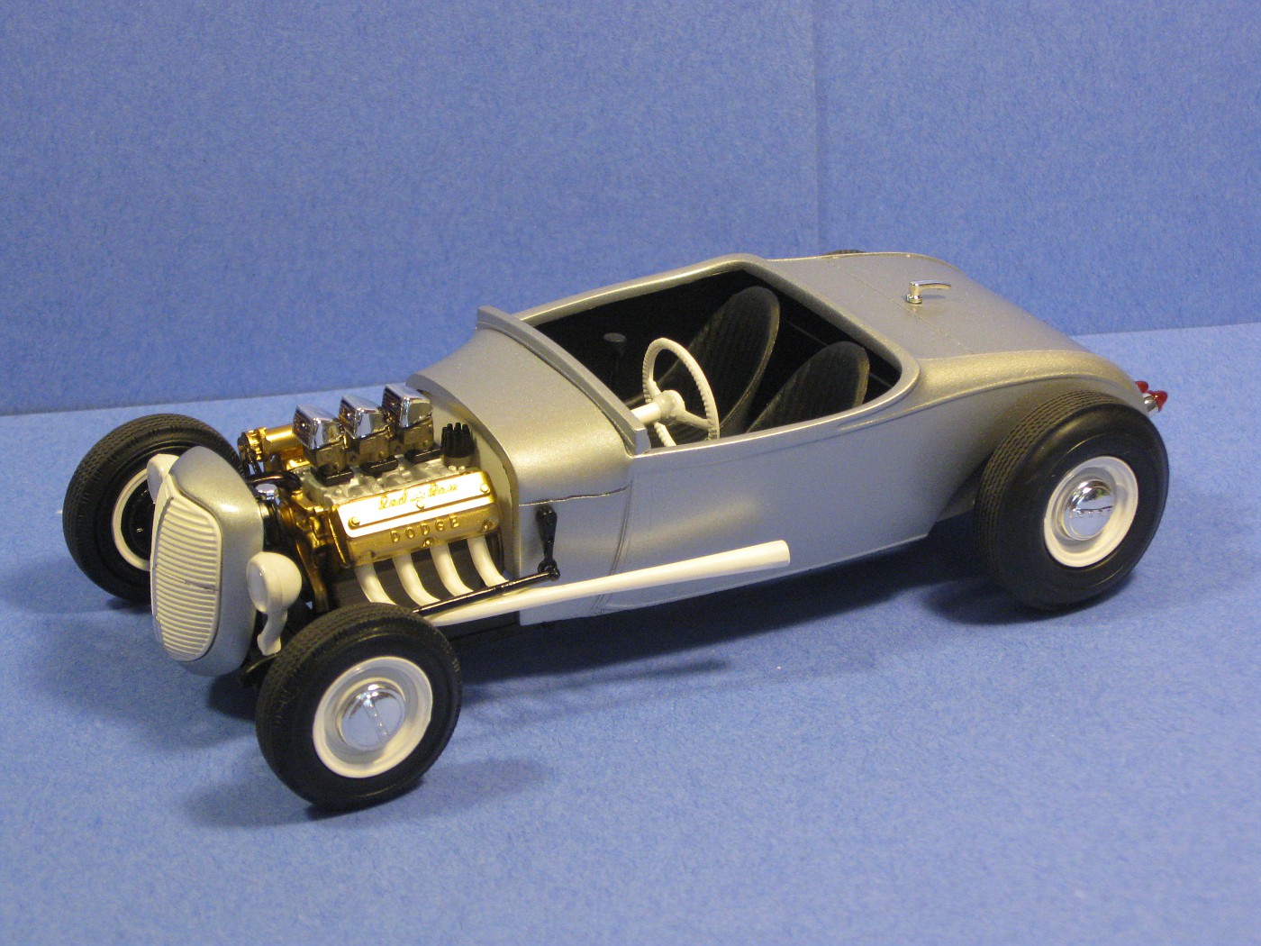

While the modern tooled Ala Kart has it's short comings (like the engine being, literally, too short) it does have good value as a parts donor for the hot rod kit basher. For instance, the excellent set of big & little whitewalls tires, chrome/reverse wheels and brakes. The beam axle has a healthy drop and if one doesn't like the air spring suspension a conventional spring can be glued on top of it (the stock axle spring from the original AMT '29 Roadster kit fits quite nice and is pretty flat for setting the front end LOW). And, while the engine (and therefor heads/valve covers/intakes) is too short the front cover/water pump, belt drive, generator and fan are scaled well and can be glued to the front of the Dodge Red Ram in the original AMT '29 Roadster kit which (except for the Ala Kart double kits) comes with a competition only blower setup. This lets you build a streetable version of the Dodge Red Ram!
The picture below shows the modern Ala Kart engine front drive parts attached to the original '29 Roadster Dodge Red Ram engine. Also shown is the modern Ala Kart front axle fitted with the spring from the stock axle in the AMT original '29 and the modern Ala Kart front wheels, tires and brakes.
Hosted on Fotki
The finished model also uses the modern Ala Kart rear wheels & tires and the custom taillights. On this model the wheel chrome was stripped off and they were painted with hubcaps from the AMT '53 Ford Truck.
Hosted on Fotki
Hosted on Fotki

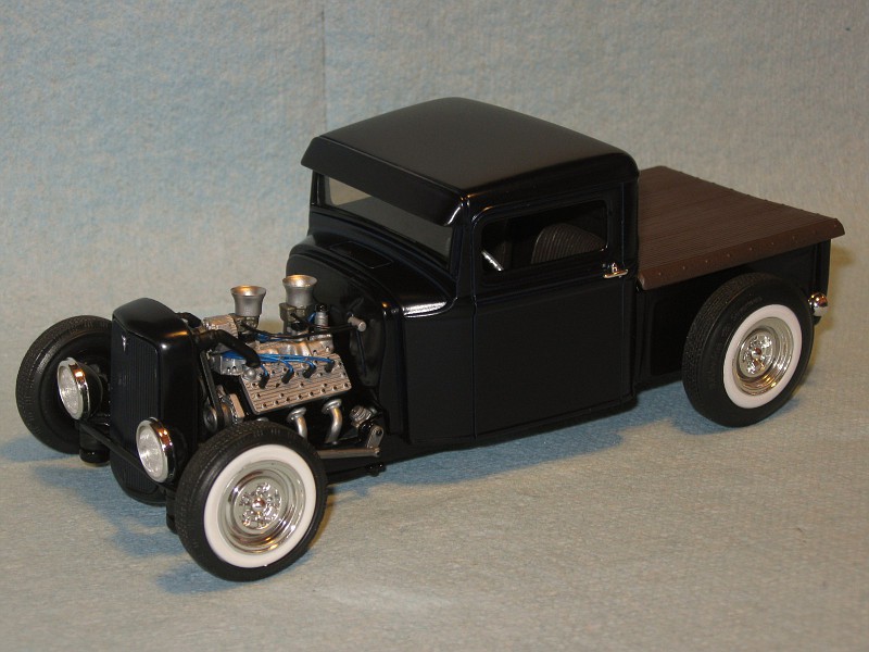

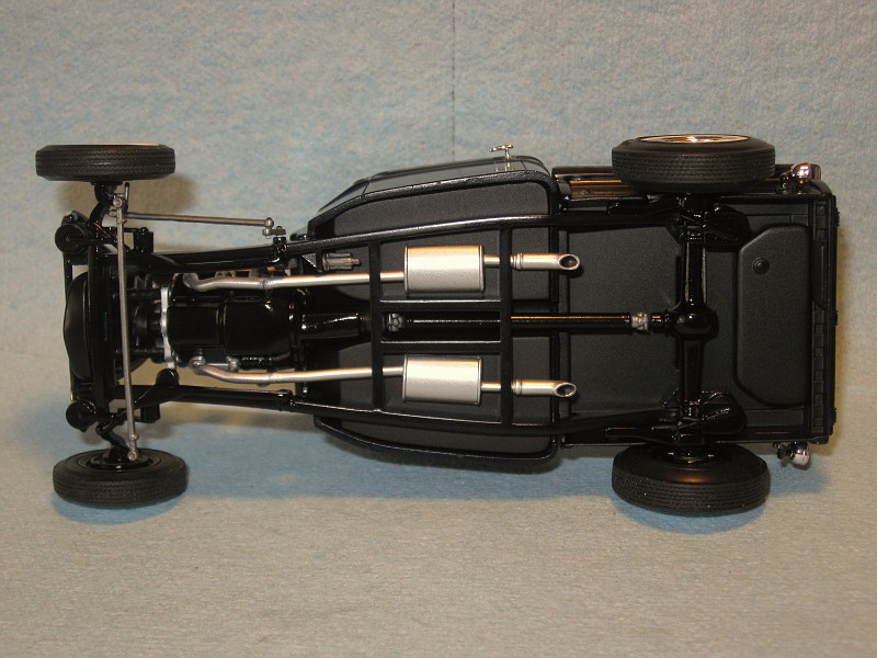

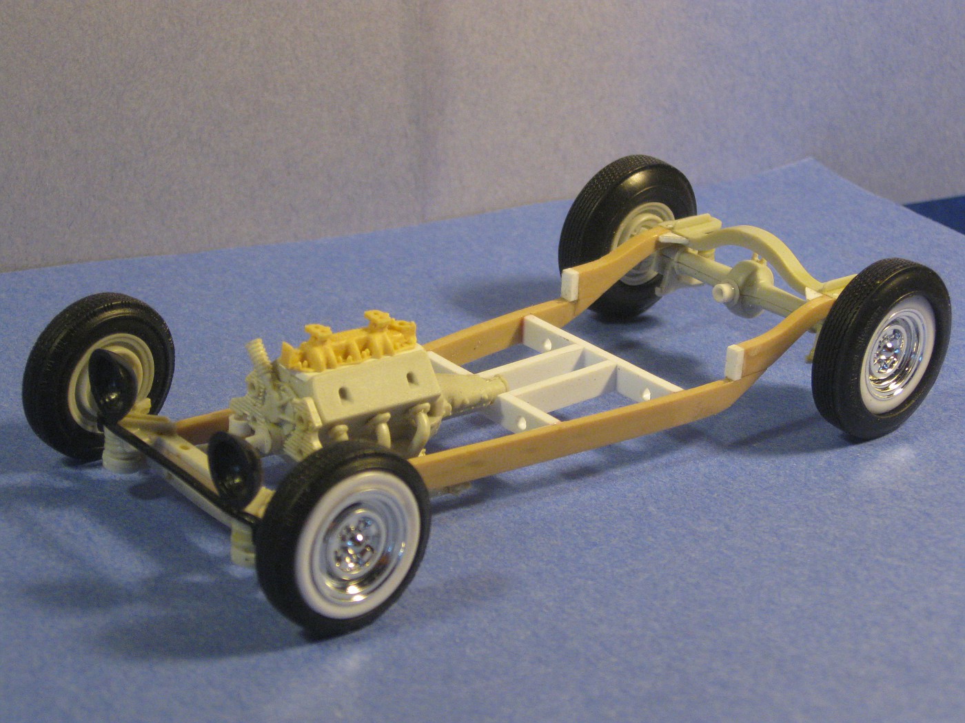

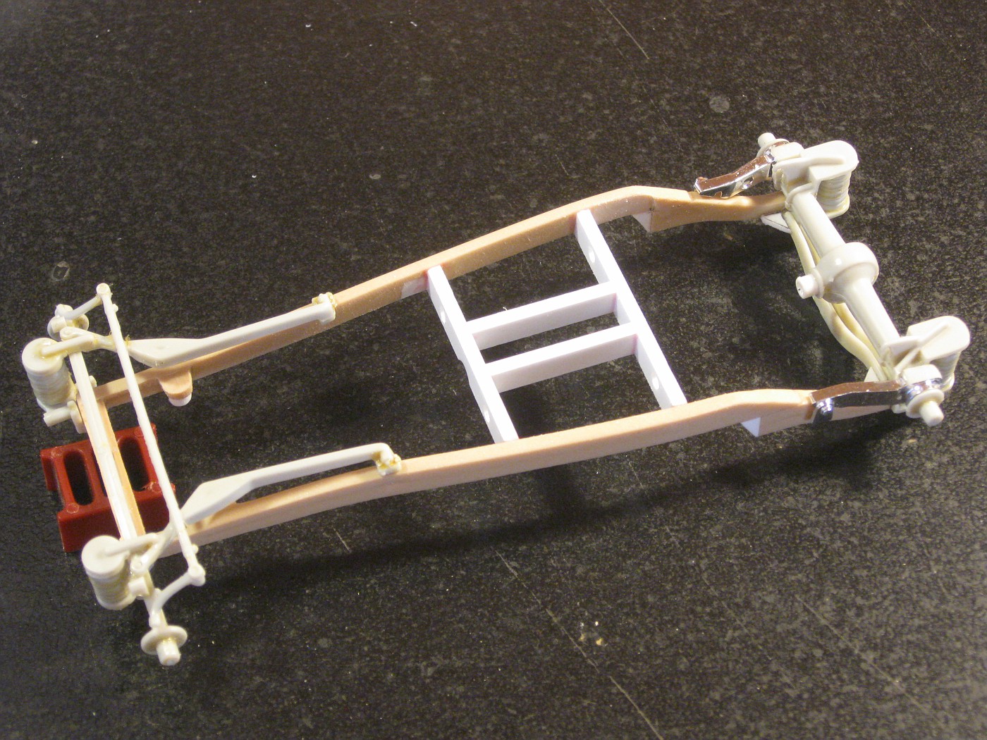

The picture below shows a Lindberg '34 Ford Pickup frame modified with the full modern Ala Kart suspension. The only thing I changed was deleting the rear torque tube and radius rods for short trailing arms and a live drive shaft.
Hosted on Fotki

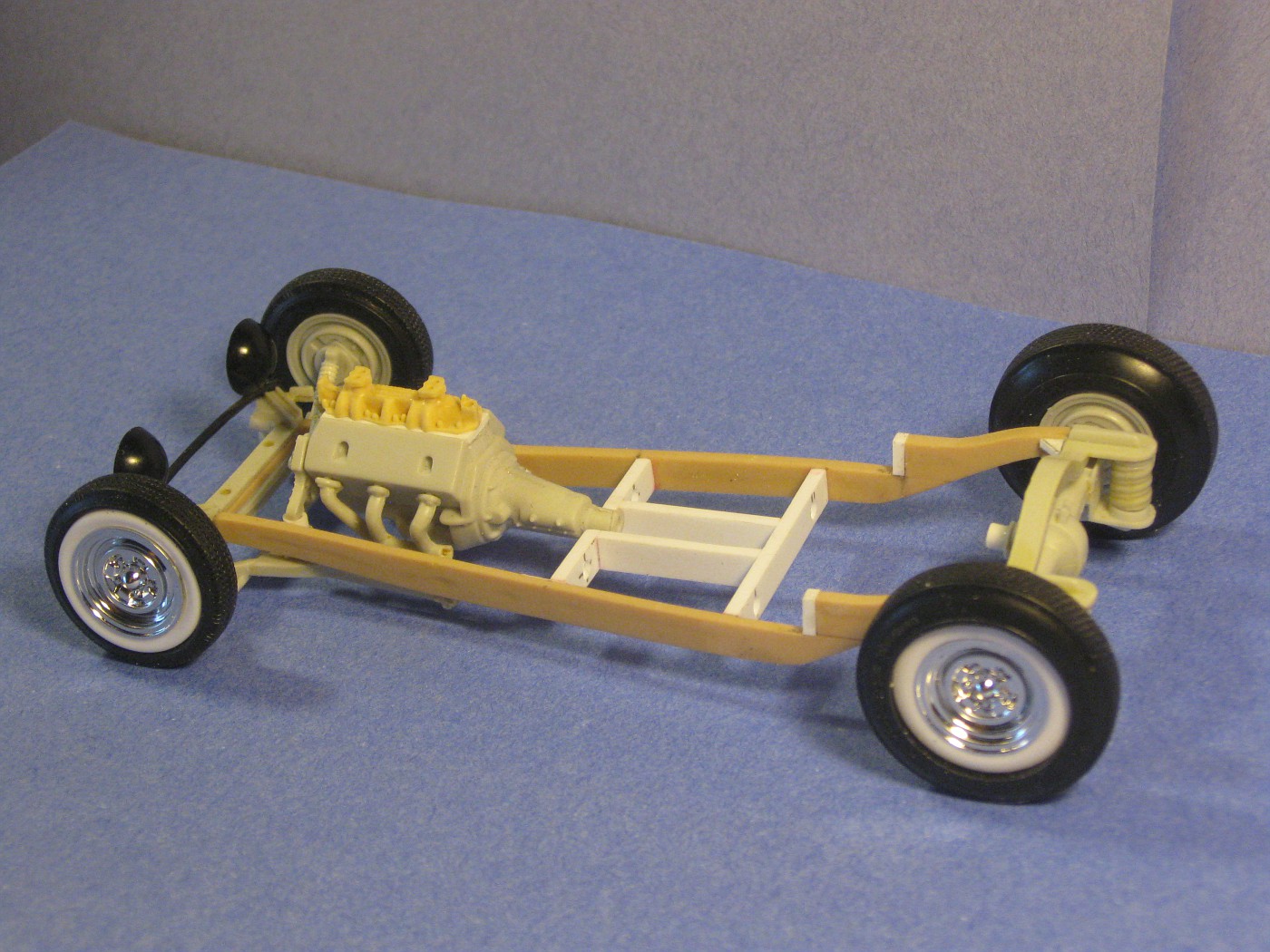

Same chassis as a roller also using the modern Ala Kart wheels, tires and brakes.
Hosted on Fotki
Hosted on Fotki
Same model finished.
Hosted on Fotki
Hosted on Fotki
So you see, the modern Ala Kart definitely has redeeming value!

Dennis...that is some mighty fine kitbashing going on there. for both of these models.

Thanks, Tim! I would love to attend one of the Legendary NNL's back there but I'm stuck out here on the lower left coast.
