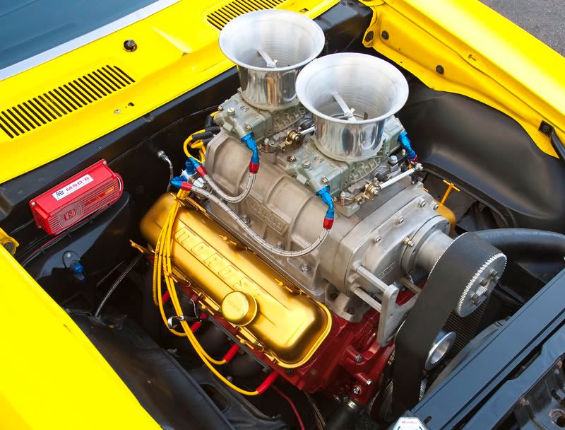

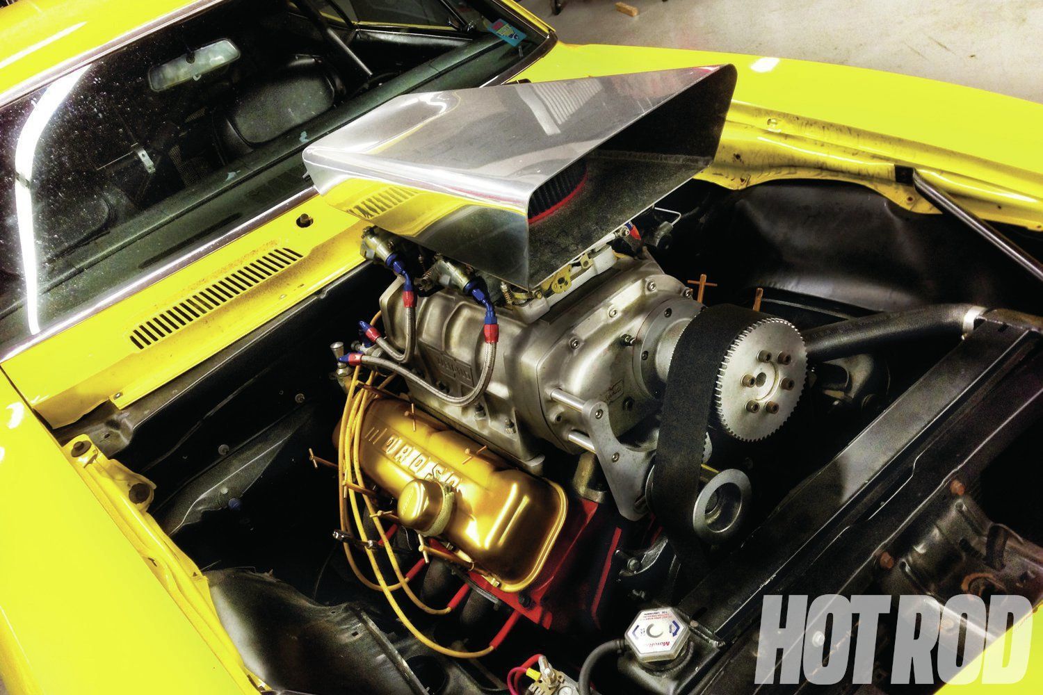

Thank you for the tips folks. I really appreciate it. For example this is the sort of color I'm after for a blower, something that looks like its been handled before and isnt quite new.
In the top pic, the blower housing looks like one of the "burnt metal" metalizer colors that guys use for jet aircraft afterburner stainless.
In the bottom pic, the housing looks like it's been left as-cast, with a slightly rough surface, but the blower drive looks to have possibly been polished at one time, but not kept all sparkly.
Subtle differences between exposed-metal colors of the blower housing and drive can make a model appear more realistic.
If you shoot Testors metalizers 'wet', they lay down and give a nice soft sheen with a very fine grain that can be polished up to a quite realistic full-polish look, or only polished halfway, etc. If you shoot them 'dry', you can achieve a rougher as-cast effect.
