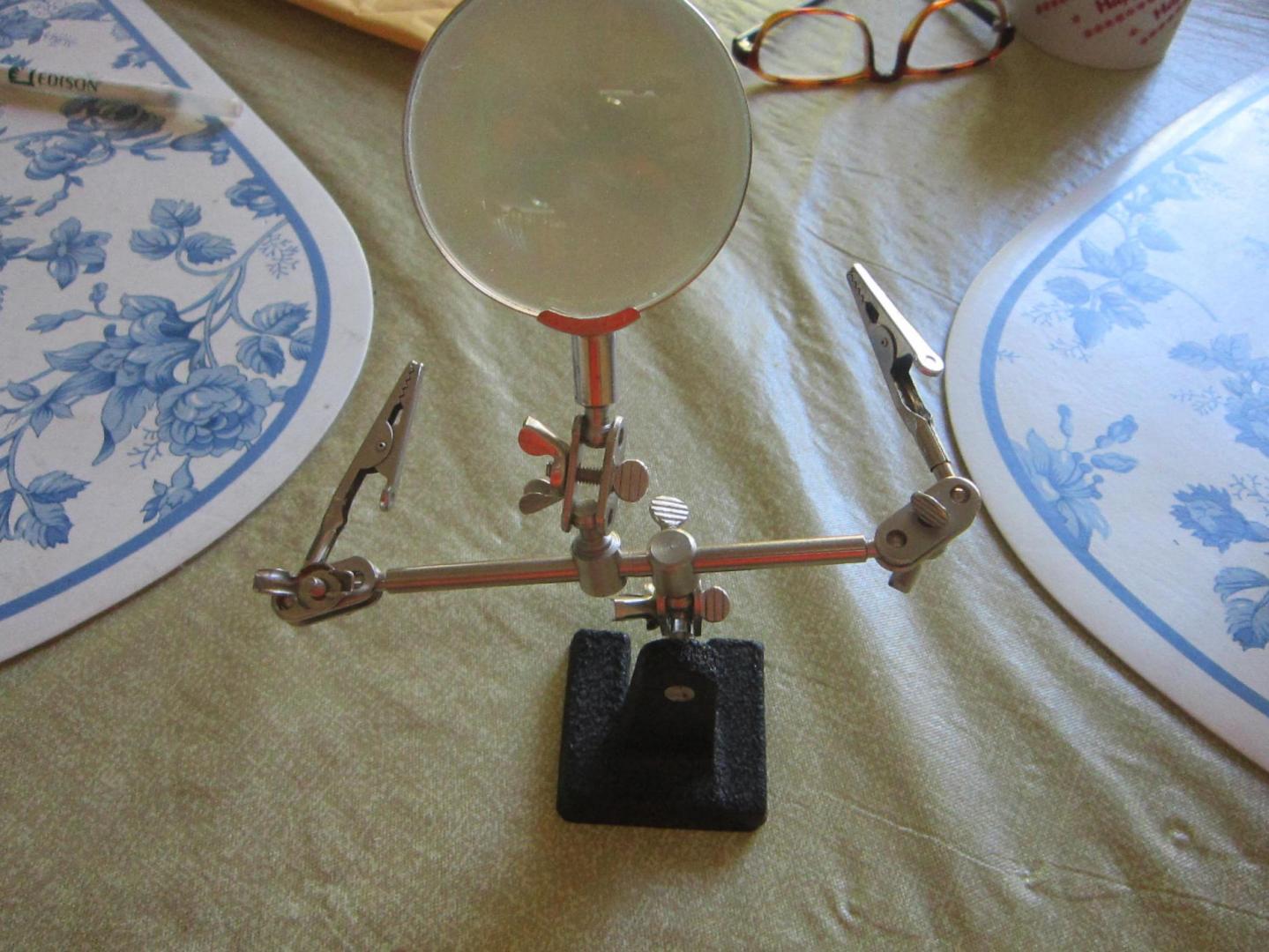

Greg,
How sturdy/stable is that when you are using it? It looks like it might be kind of wobbly with the small base. I really need one if it is pretty stable. Both for models and doing wiring/soldering when I am working on wiring harnesses.
Thanks,
Russ
actually, the base is very heavy. although  a bit top heavy with the glass. i have accidentally bumped it (lightly) when the glass was horizontal and it fell right over.
Edited by Greg K
