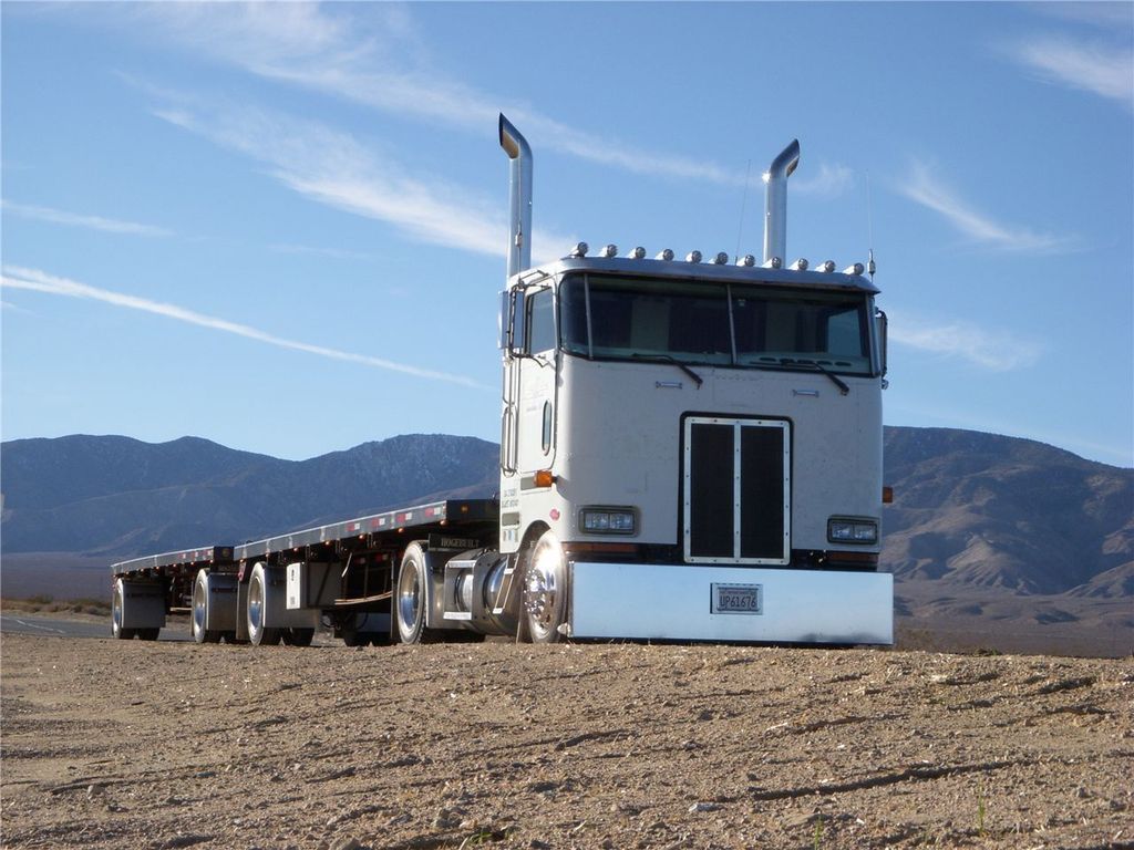

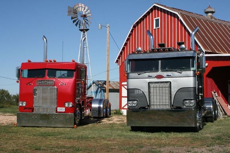

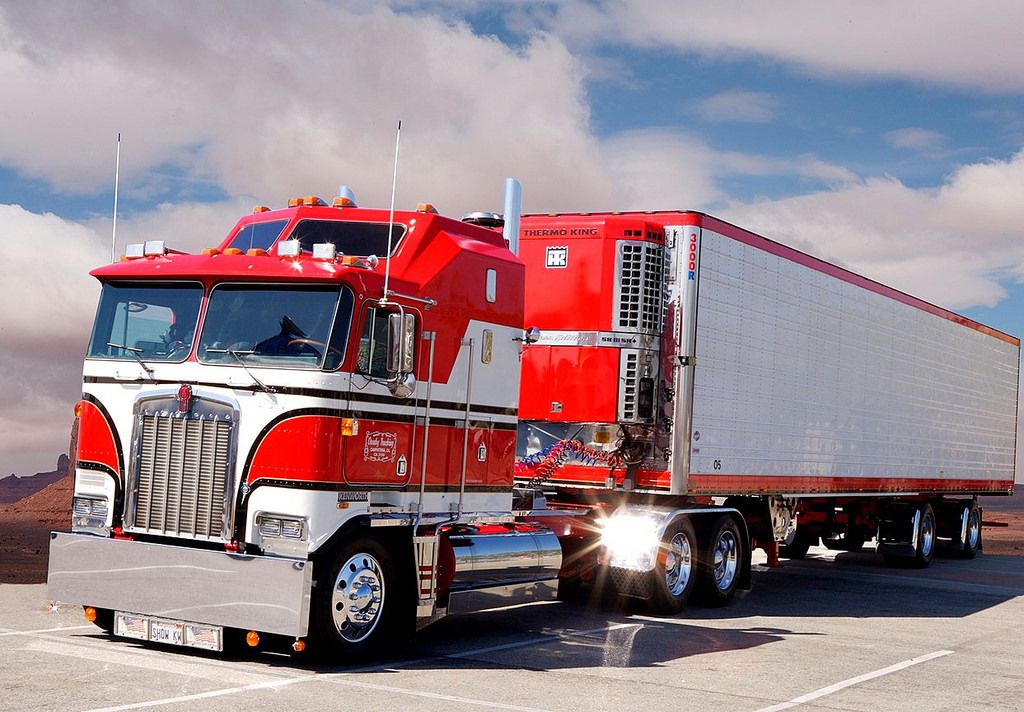

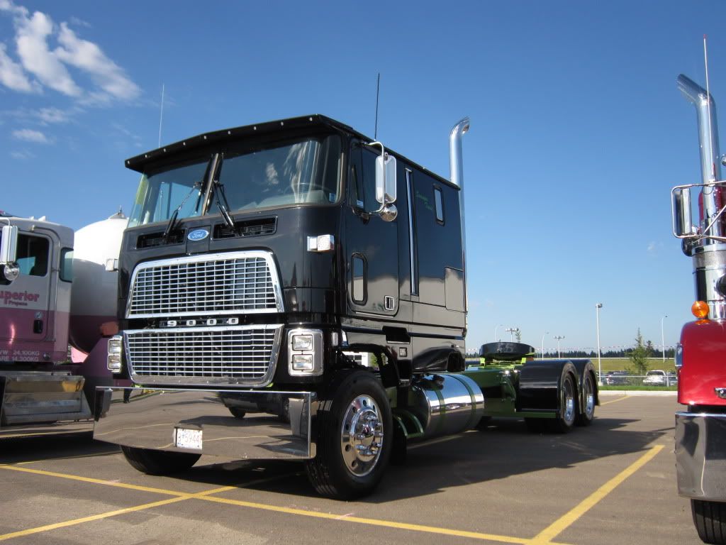

Here are my favorite COEs.
A Pete 362
A Freightliner and Pete 352
A Kenworth K100
And a Kenworth K123
I'm a little more partial to the K123. When Dad started driving, he bought an old P.I.E. K123 day cab 2 axle, 6V92. Painted silver with red stripes. I have some very fond memories of that truck. I remember sittin in the passenger seat, I still remember the red glow from the turn signal by the windshield and door. Someday I'll be building that truck in scale. But only from memory. There are only a couple Polaroids of that truck, front facing only.

The red and white K100;  What extras has the owner added?  I'm sure lots can be assembled from the factory, but what is on there that is beyond the base factory delivered model?
What is added...
Bumper.
Trim pieces on the bottom of cab and the top and bottom of the fuel tanks.
Lights.
Deck plate.
Air line box.
Rear fenders.
I imagine there is a rear bumper loaded with lights too.
The suspension has been lowered.
And the level of polishing done. Factory polish jobs do not look that good.
There is probably more. If you image search Ownby Trucking, more pics will come up, along pics of the truck this replaced. It was a 362 Pete. I've seen that in person many years ago at a show.
