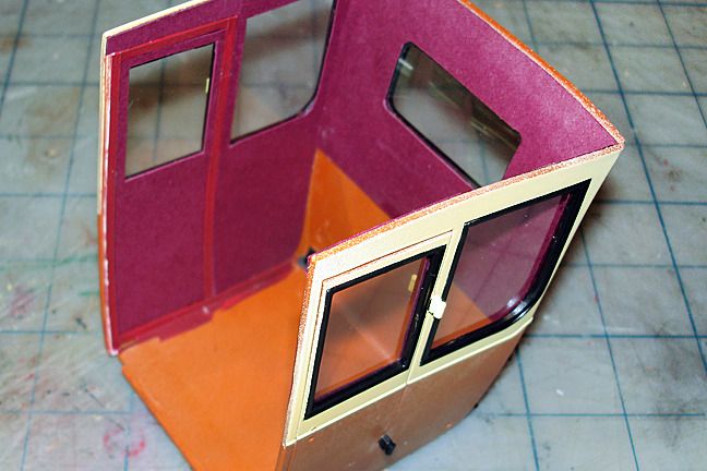

I made paper templates for the interior panels, then cut the final panels out of heavy colored paper...
Here are some of the panels glued in place...

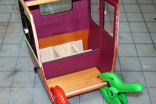

New seat base made of balsa scraps, and balsa floor installed...
Here's the finished interior. Not much in there but the seat. I added the roof beams because the body was warped and the sides were bowed in... the wooden strips keep the body sides parallel and straight...
The red of the interior is really getting blown out by the flash. In reality it's a very dark maroon. The actual color is more like the area in the above photo just above the seat's left side armrest
The interior looks great -- nice upholstery choice. Looks like you added straps on the doors and on the window pillars.
Edited by sjordan2
Yes I did. Sharp eye!
