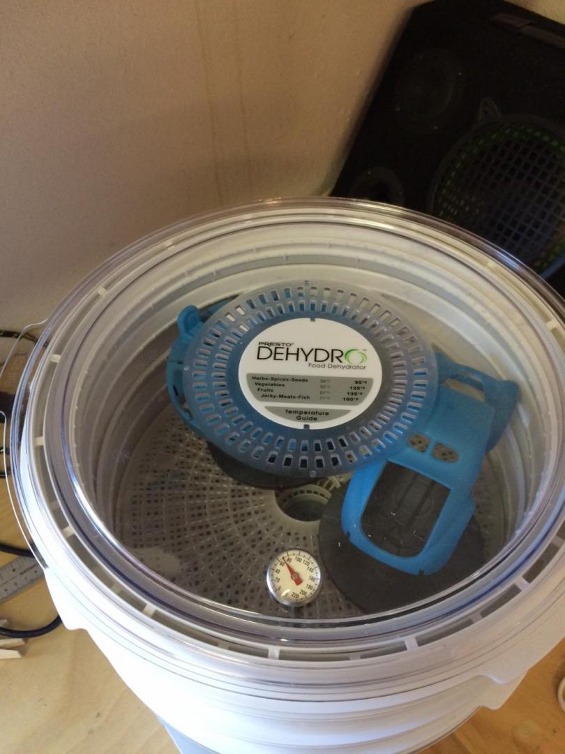

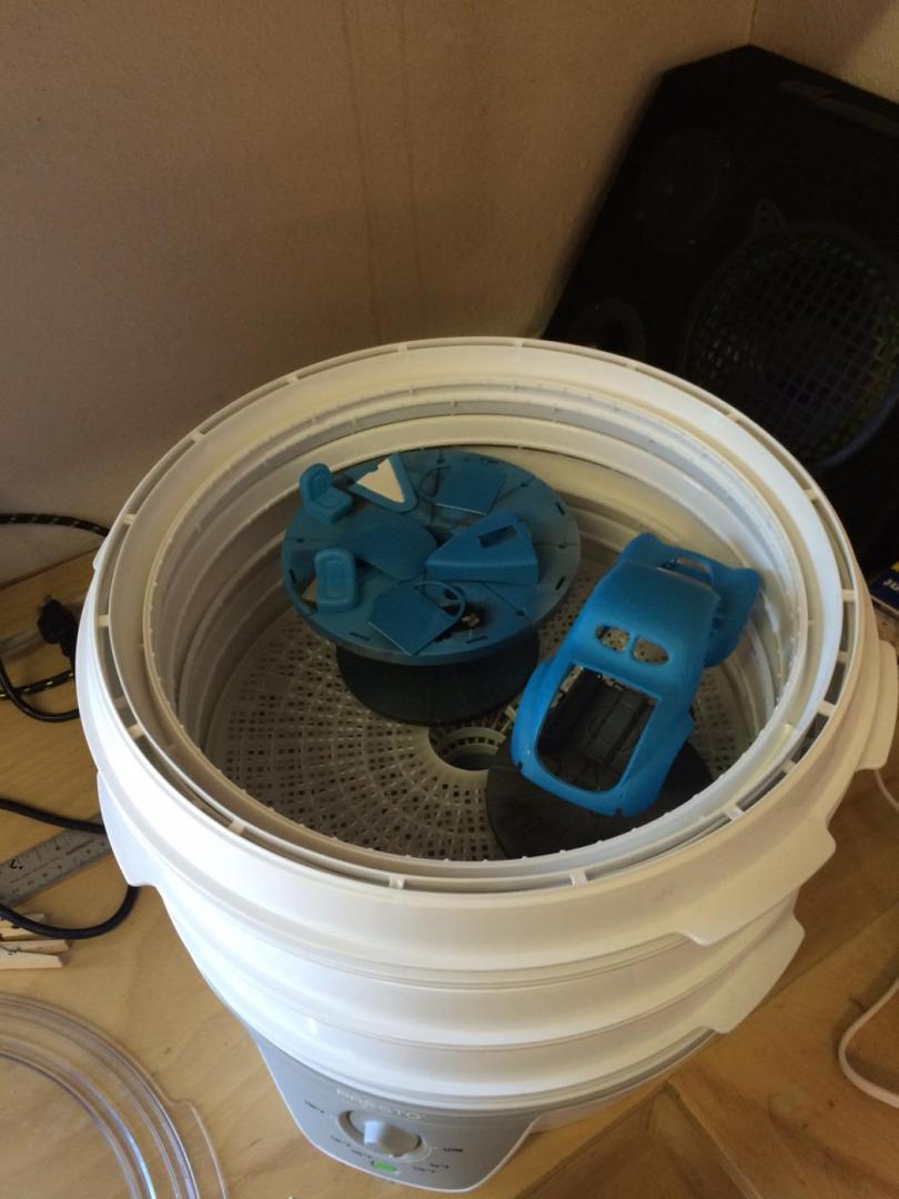

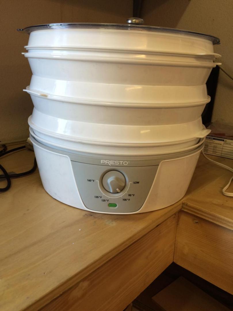

TedD Posted December 7, 2015 Posted December 7, 2015 I only recently started building plastic model cars as a hobby. One of my first purchases was the dehydrator for paint drying purposes.. I order this one from Amazon - http://www.amazon.com/gp/product/B008H2OENC?psc=1&redirect=true&ref_=oh_aui_detailpage_o07_s00 in addition to the extra trays- http://www.amazon.com/Presto-06306-Electric-Dehydrator-Dehydrating/dp/B008HPVOAU/ref=pd_bxgy_79_img_3?ie=UTF8&refRID=10KHY1A2F4611E5QQMBF Once you trim out the bottoms of the trays, you have plenty of clearance. I also added the thermometer to the top and it maintains a temp of 105 perfectly.
