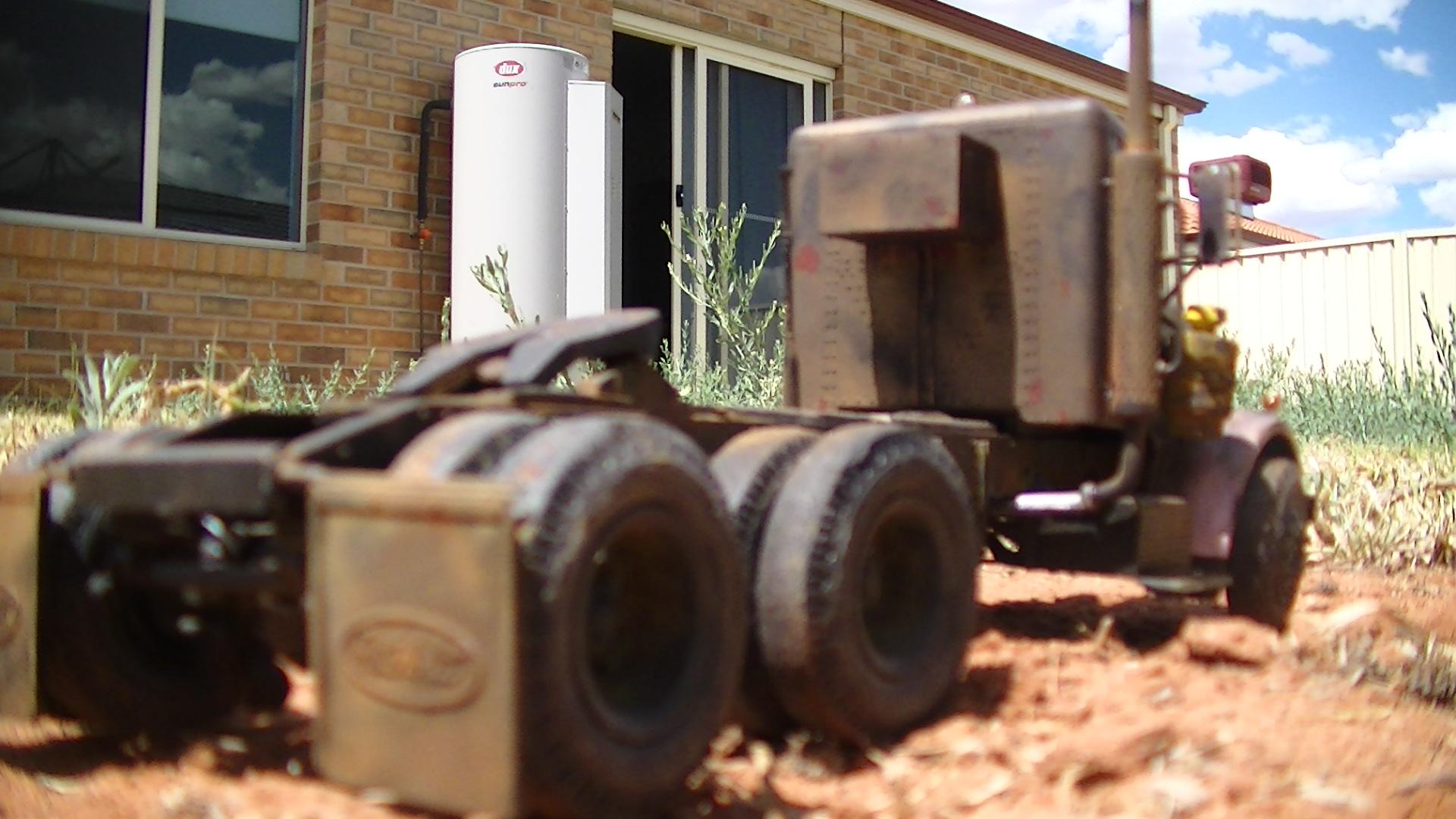

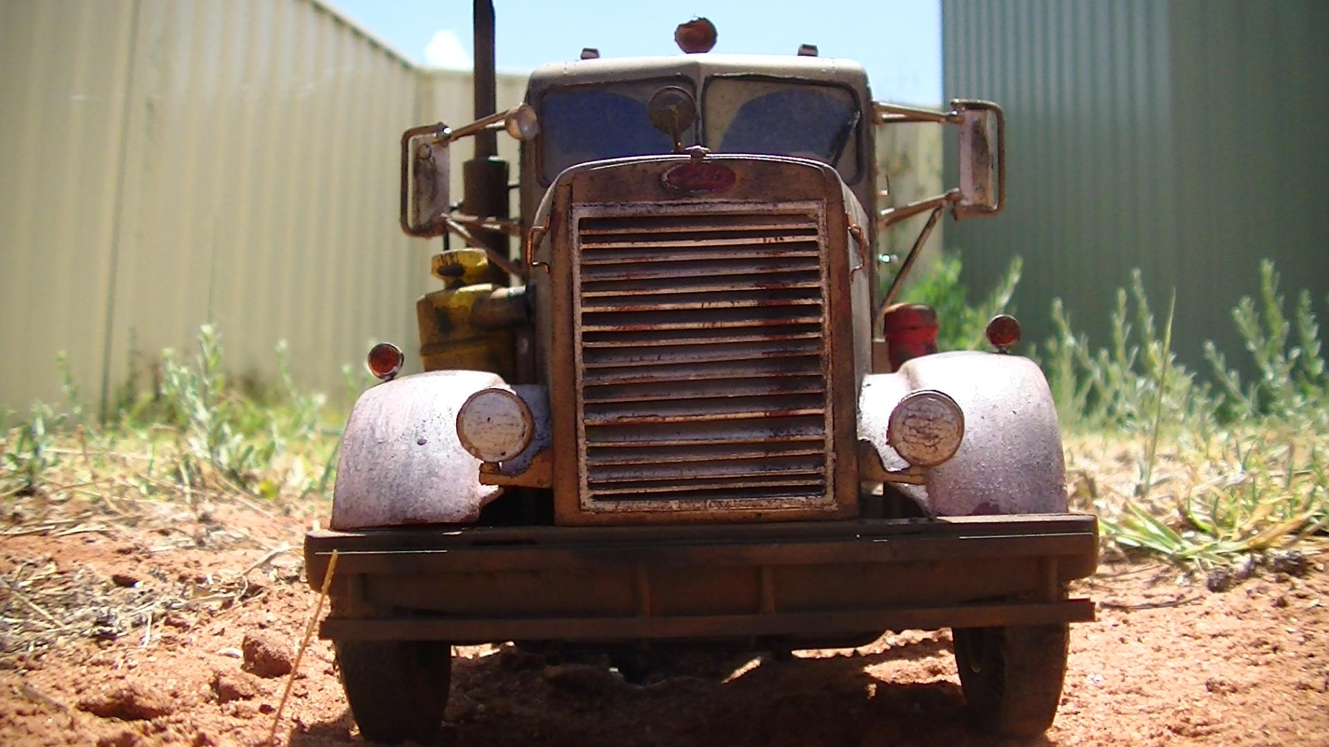

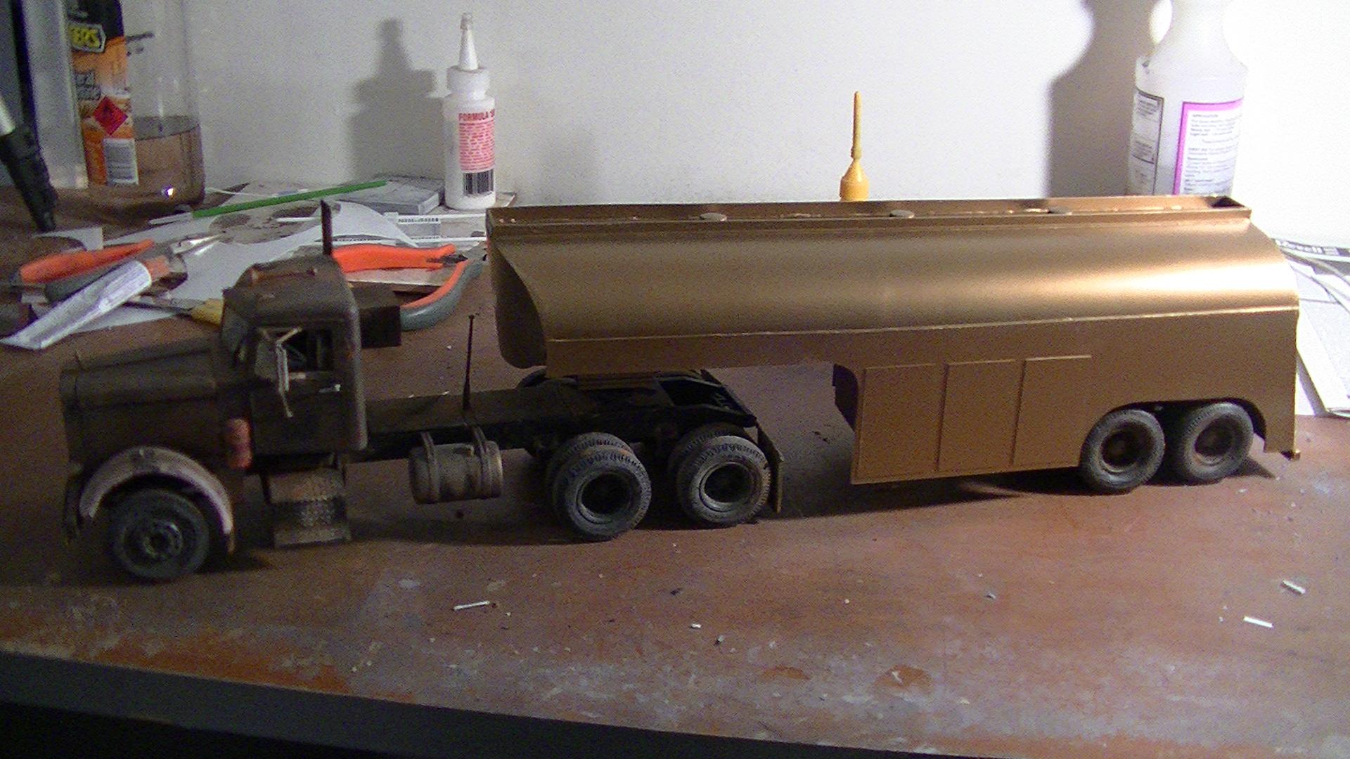

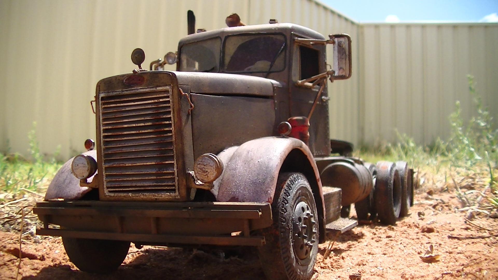

AussieTrekkie Posted December 20, 2015 Posted December 20, 2015 I am in the process of building the Duel truck too. Here's a couple pics of mine so far. Scott.

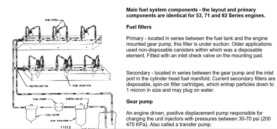

Stuntman Mike Posted December 23, 2015 Author Posted December 23, 2015 Great job on your truck and trailer, Scott. I wish I was that far with my build I´ve stripped the chrome off of some parts and assembled the engine. This is where I run into the unknown. Is there any wiring and plumbing that should be done before painting the engine? Is diesel injected into the blower on these engines? I know it´s a two stroke, so there are probably no fuel lines to each cylinder. Is that correct? Pretty hard to find the reference I am looking for. Mainly because I don´t know what to look for. And what about that air compressor thing behind the blower? Is that for the brake system and looking forward to get connected to the air tanks? In case someone likes to share a link to a WIP that includes a superdetailed 8V71, I´d be a happy bloke Cheers
AussieTrekkie Posted December 23, 2015 Posted December 23, 2015 The air compressor behind the blower will have airlines coming out of it to the air tanks.I did a google search for "8v71 Detroit" click on images and there are hundreds of photos of the engine showing where all the wiring, and other vacuum lines and all the othe lines go.https://www.google.com.au/search?q=8v71+detroit&biw=1366&bih=614&source=lnms&tbm=isch&sa=X&ved=0ahUKEwil-ej1l_HJAhWlF6YKHZ7fAUkQ_AUIBigBHere's a link.Glad you like what I have done with mine so far.Scott.
guitarsam326 Posted December 23, 2015 Posted December 23, 2015 Please someone correct me if i am wrong, but there are no fuel lines to each injector, fuel is fed to the injectors via passages in the head, there would be two fuel lines coming out of the fuel filter, one to each head. Everything looks great so far, this is one of my favorite movies and definitely my favorite peterbilt, i have plans to build a few myself!

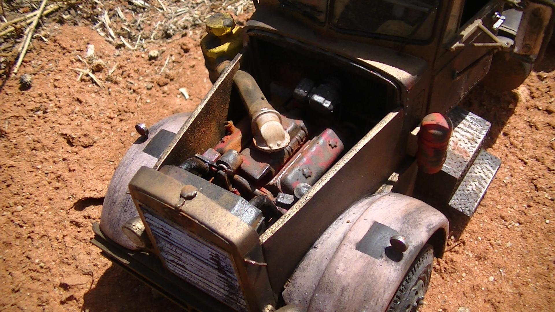

AussieTrekkie Posted December 23, 2015 Posted December 23, 2015 Please someone correct me if i am wrong, but there are no fuel lines to each injector, fuel is fed to the injectors via passages in the head, there would be two fuel lines coming out of the fuel filter, one to each head. Everything looks great so far, this is one of my favorite movies and definitely my favorite peterbilt, i have plans to build a few myself! There is a fuel manifold as part of the cylinder heads. Fuel lines go to the fuel manifold and then to the injectors. Refer to picture. Hope this helps. Scott.
guitarsam326 Posted December 23, 2015 Posted December 23, 2015 There is a fuel manifold as part of the cylinder heads. Fuel lines go to the fuel manifold and then to the injectors. Refer to picture. Hope this helps. Scott. awesome, i couldnt find a good pic of how the fuel lines ran, so i figured they were internal like the c series cats. I havent had the pleasure of working on an old detroit yet.
