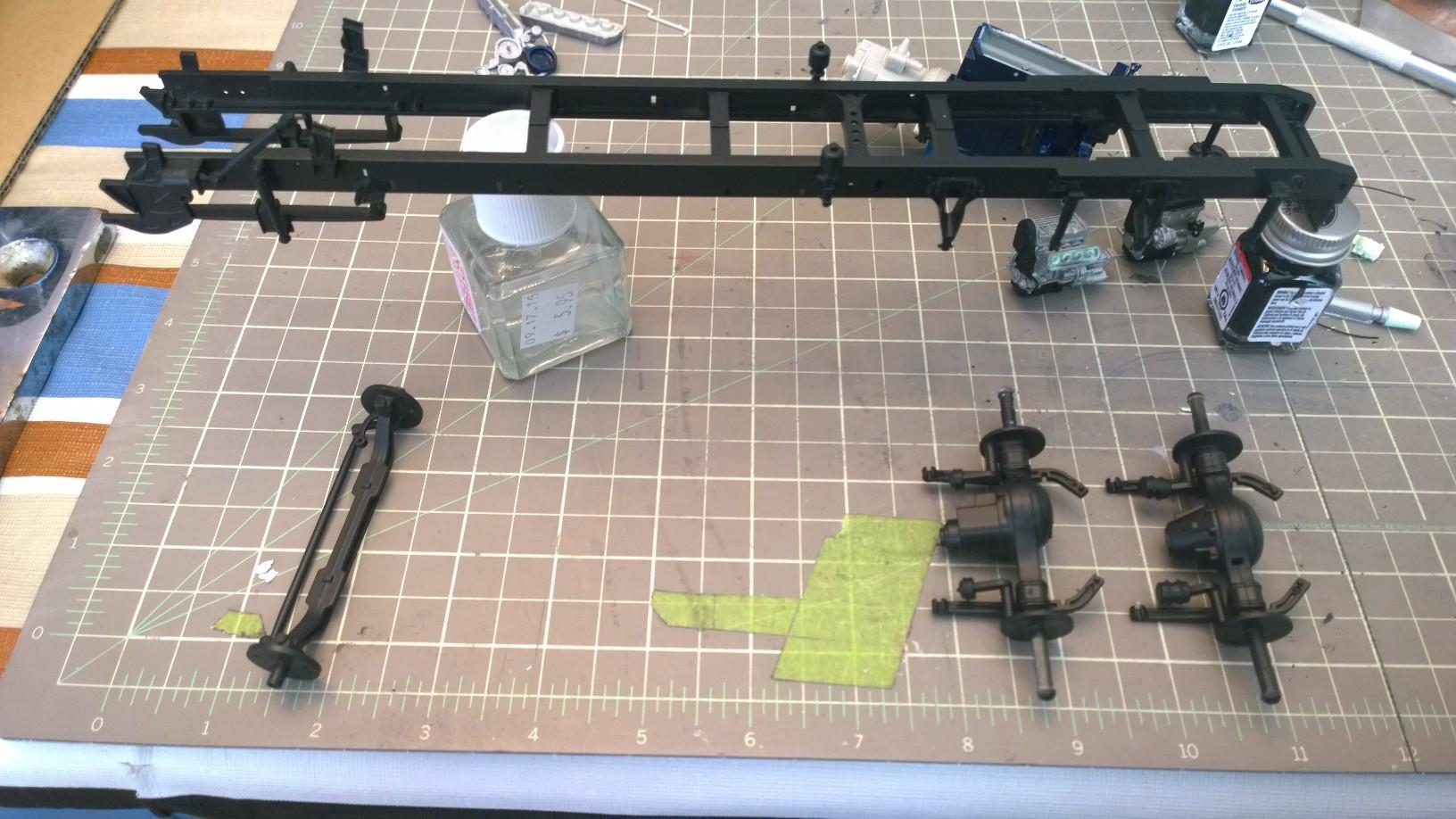

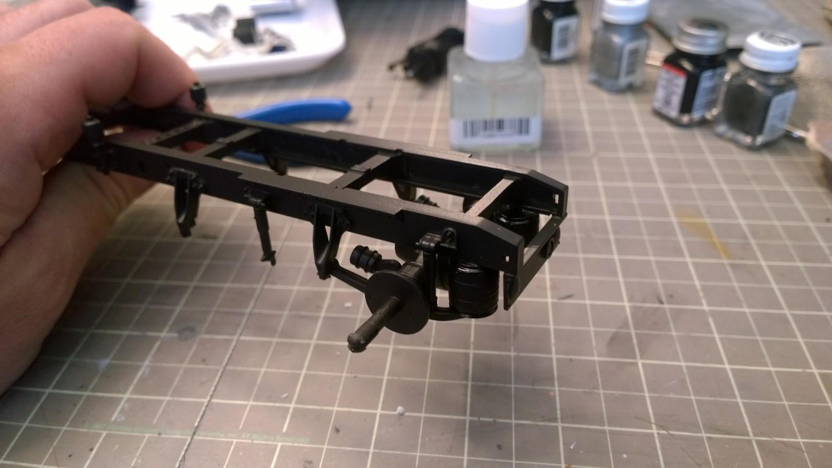

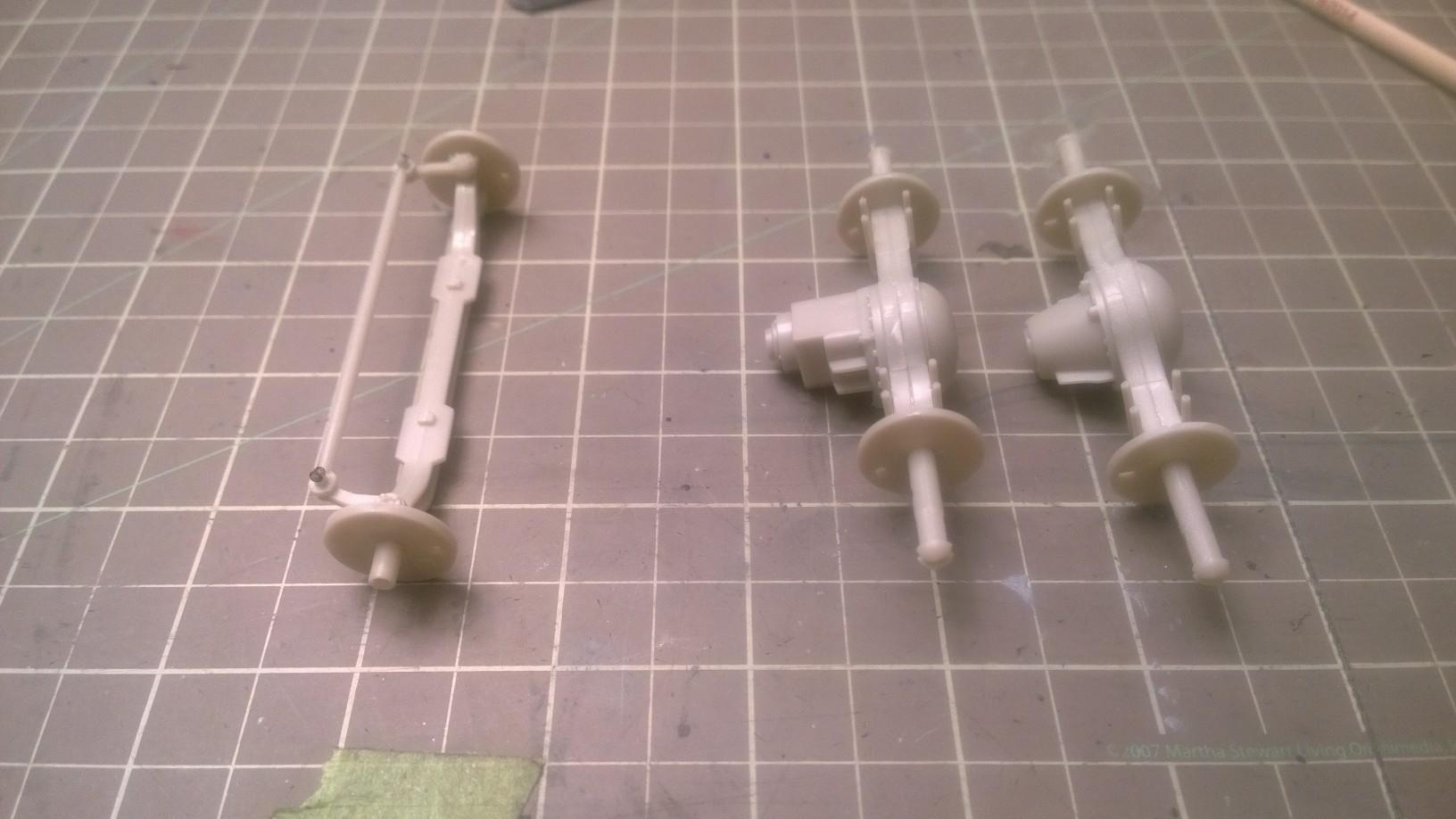

Slow progress, but stuff's getting done. Frame and some of the hangers are looking good, got the axles mostly assembled, but still need sanding and smoothing before paint.

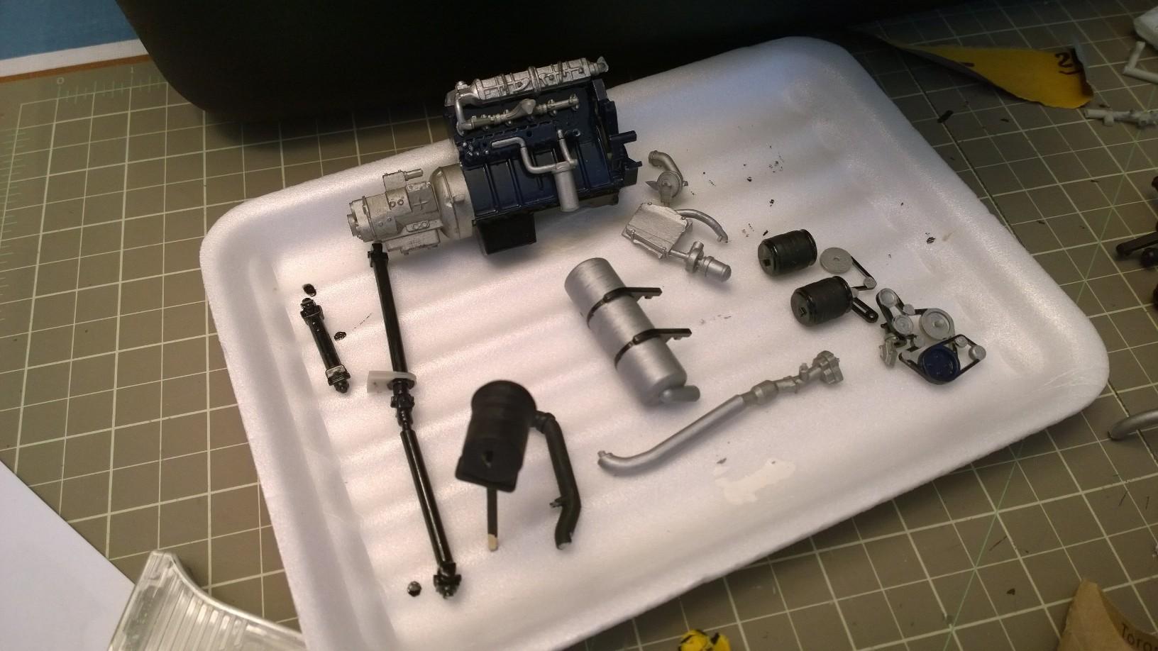

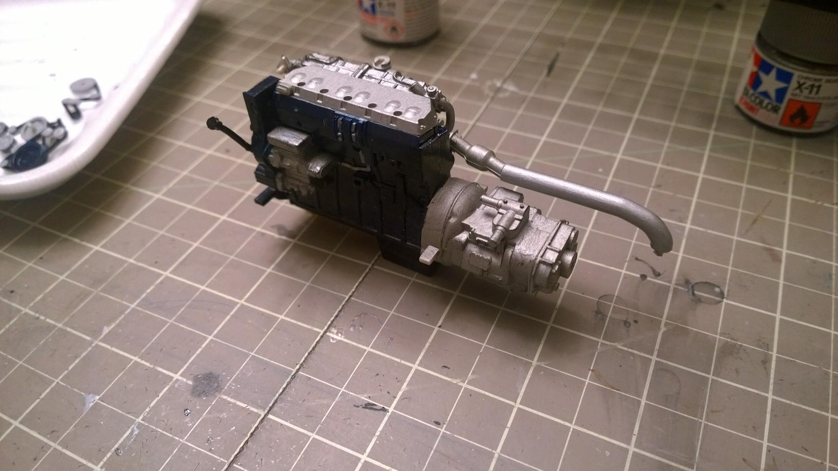

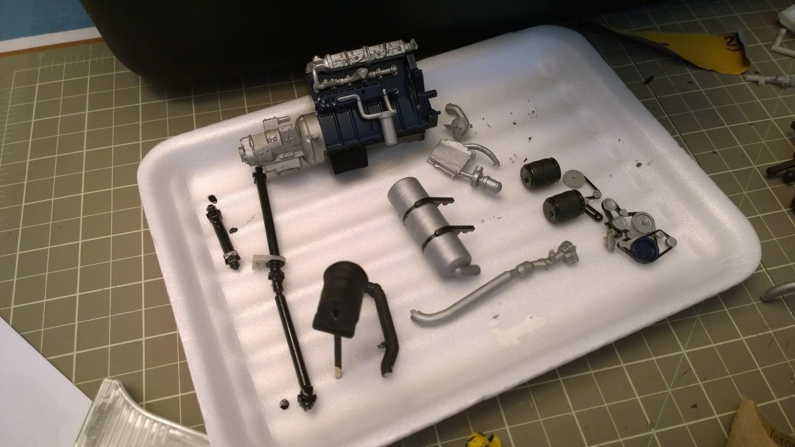

Engine has first coat of paint done. I found Tamiya's X3 blue is pretty close to the Maxxforce blue. Maybe a little darker, but looks close enough for me. I have plenty of reference pics now, so it should turn out pretty good.

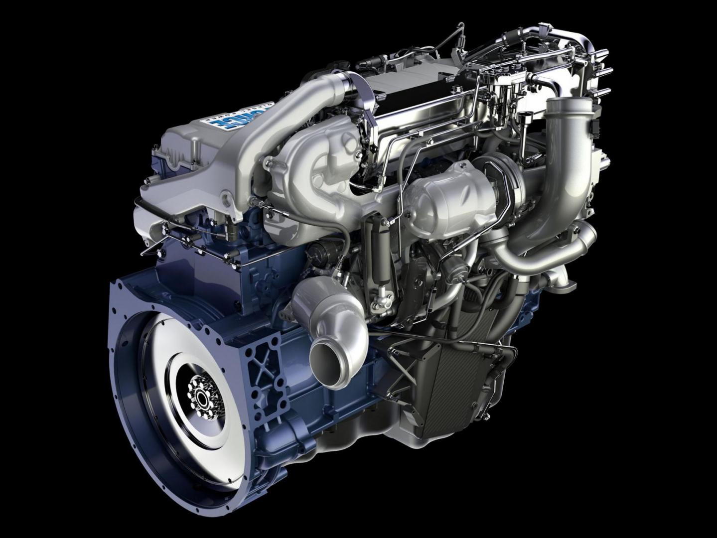

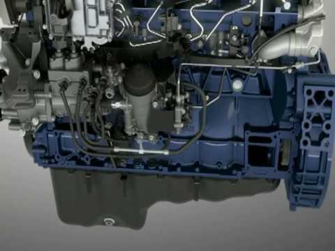

One thing I noticed is that the instructions say to install the oil pan as I have. But every reference pic (see below for examples) of the real thing I've found has the pan on the other way around. For those who have built this one, are the instructions wrong? Will the engine still fit if I flip the pan around?
Hmmm.....That is interesting....I never knew the oil pan may be backwards.....I don't think it will fit if you swap it, though......I'll have to do some checking on that, myself.....

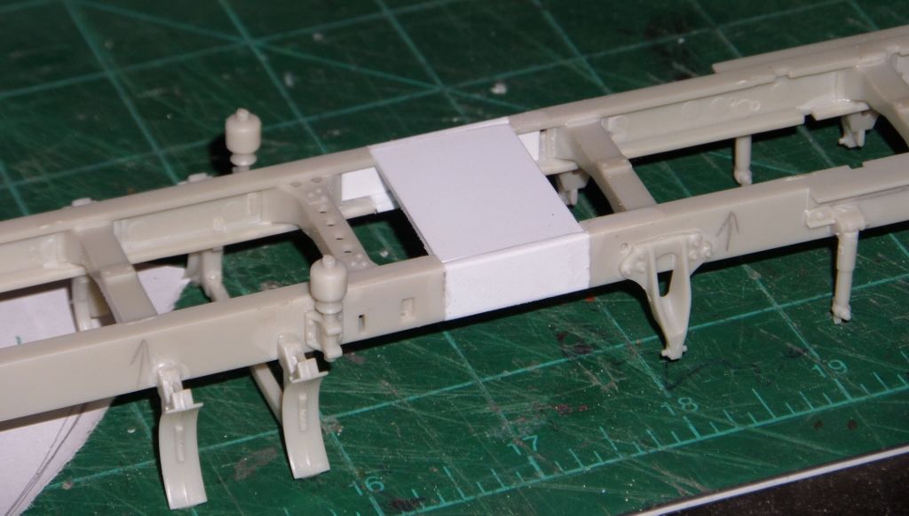

Not sure if you're going to extend this one, but I've found that if you do it at this point, you won't have to worry about messing up any of the mounting points....

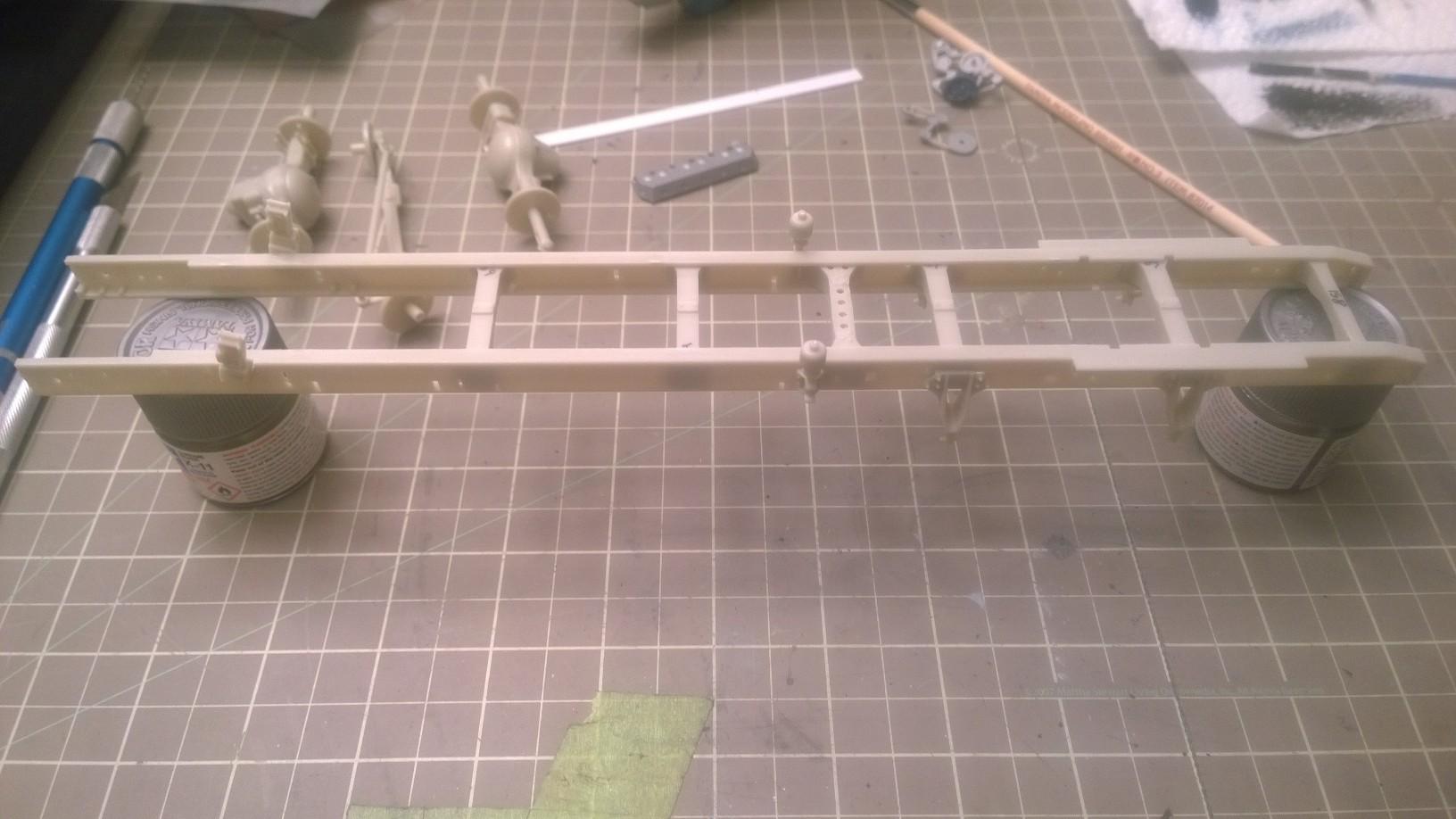

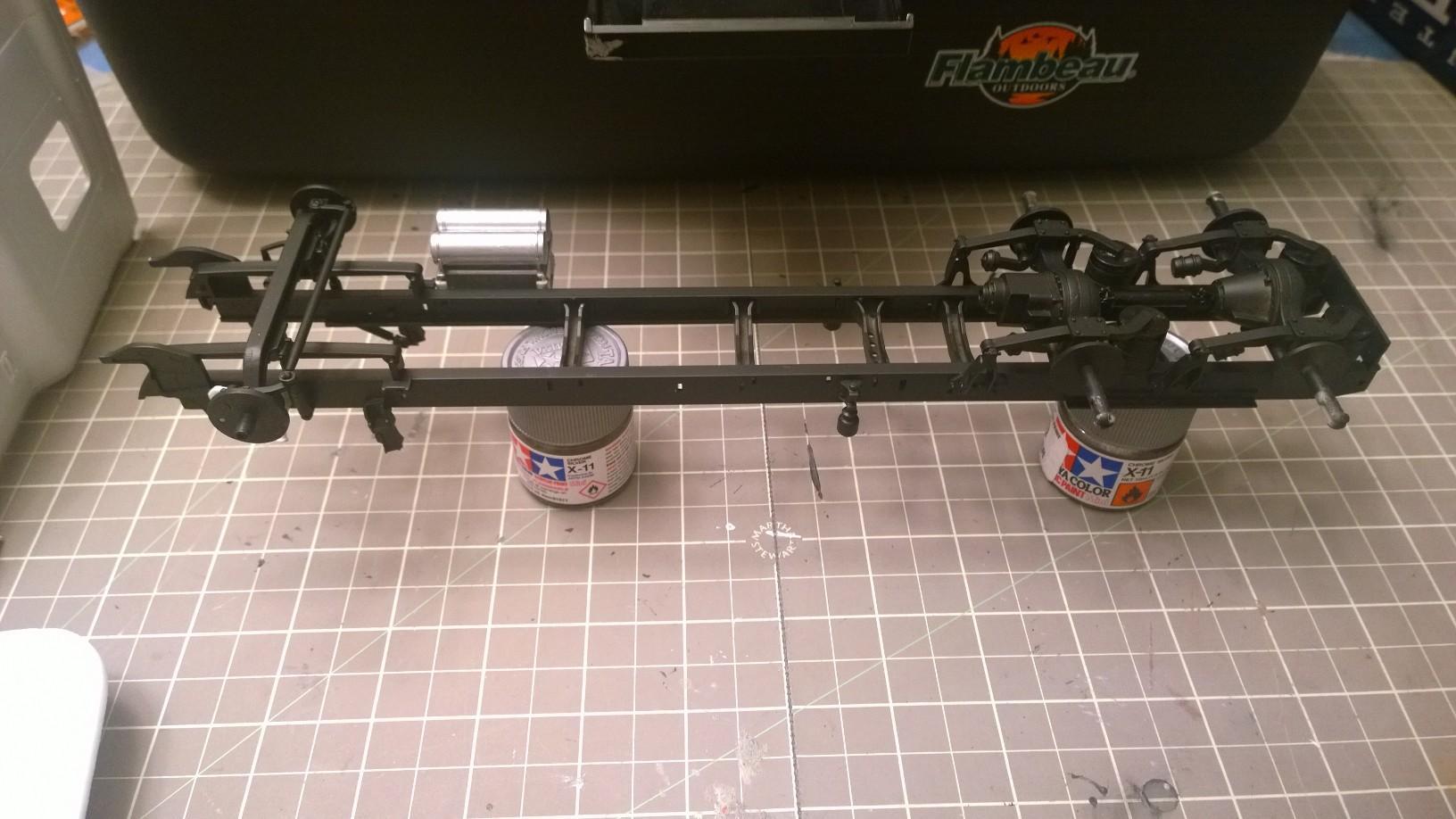

I painted the frame and axles using a semi-gloss engine paint, always had nice results with this stuff.

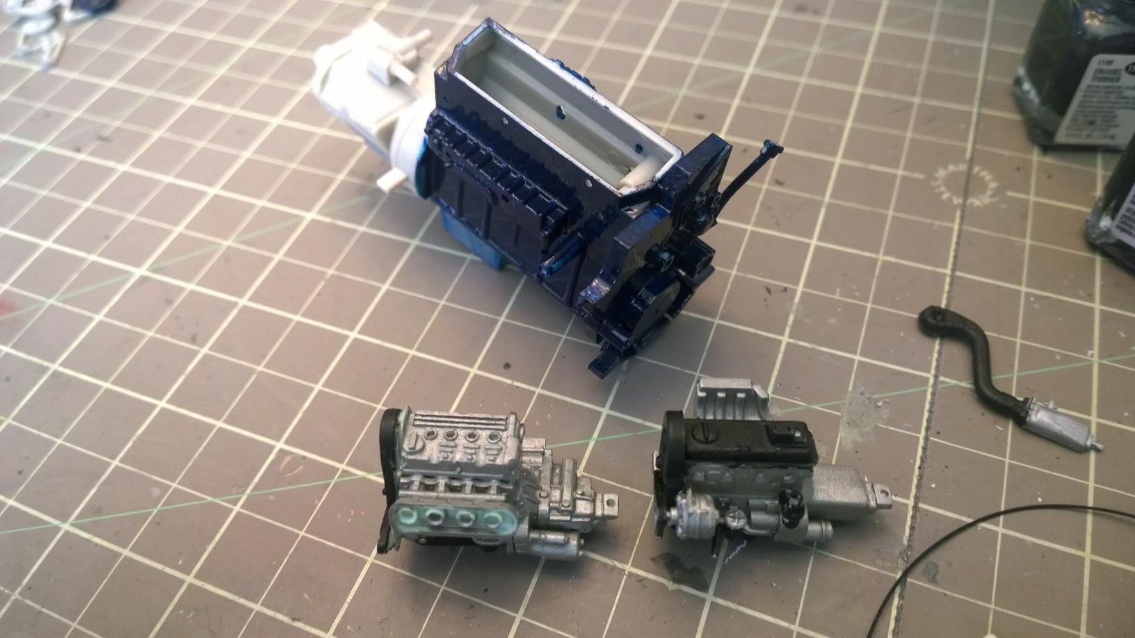

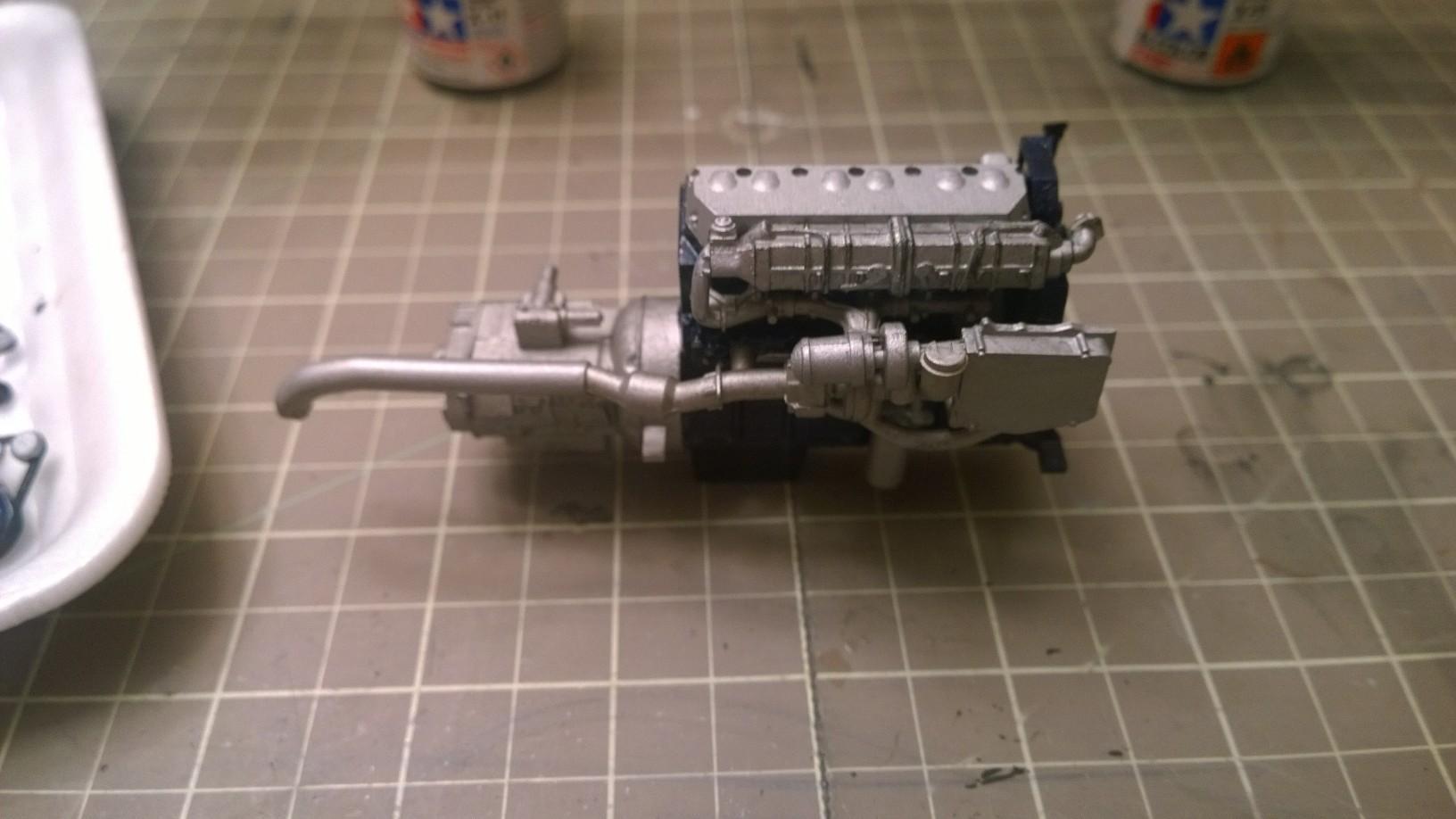

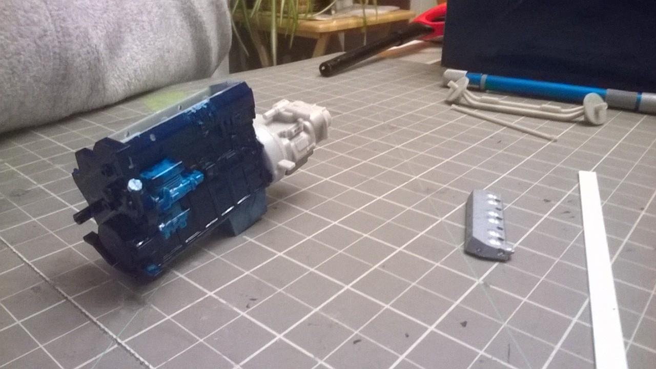

And I got the second coat of blue down on the engine block. Here's a pic of it, with some VW Rabbit engines as a size comparison.
I won't be stretching the frame on this one, as I kind of dig the stubby look. But I do have a second Prostar kit, so might try a stretch on that one. Or on the Lonestar kit.
looking good so far. i built mine per instructions [oil pan situation] and it all fit perfectly. i love this kit, have 3 more in the stash....
I'm just going to leave the pan as per the kit instructions. Wrong or right, I'm not that OCD about it.

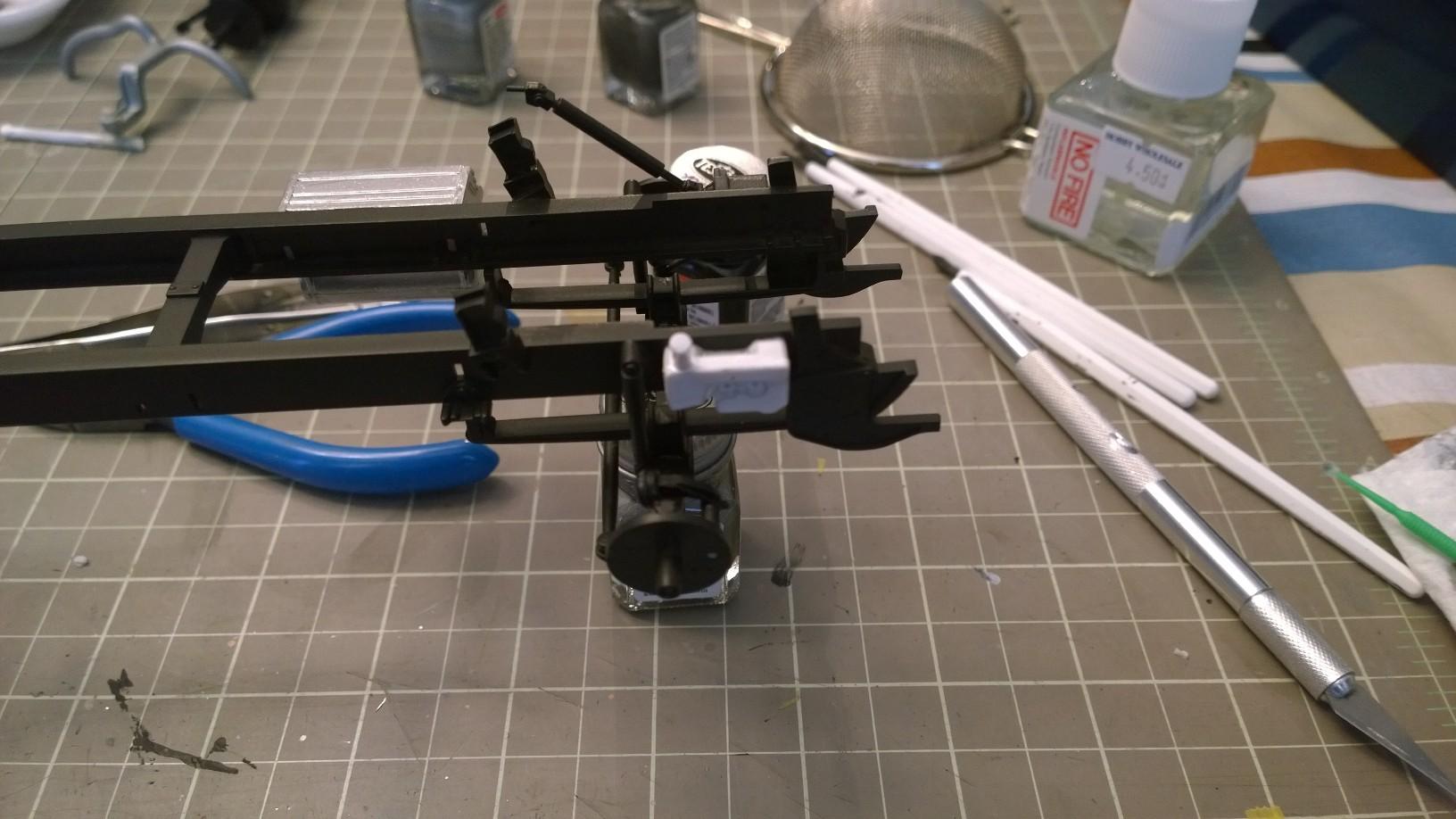

Actually got some work done on the truck this weekend. Still nothing exciting though. Still painting individual components, test fitting, etc. Starting mounting the suspension. Once the suspension is all in place, then I can start working on running air lines. Also got a little more done on the engine. Once I get some detailing done on it, it should look pretty good.
Progress feels slow on this, but I guess there's really no rush.

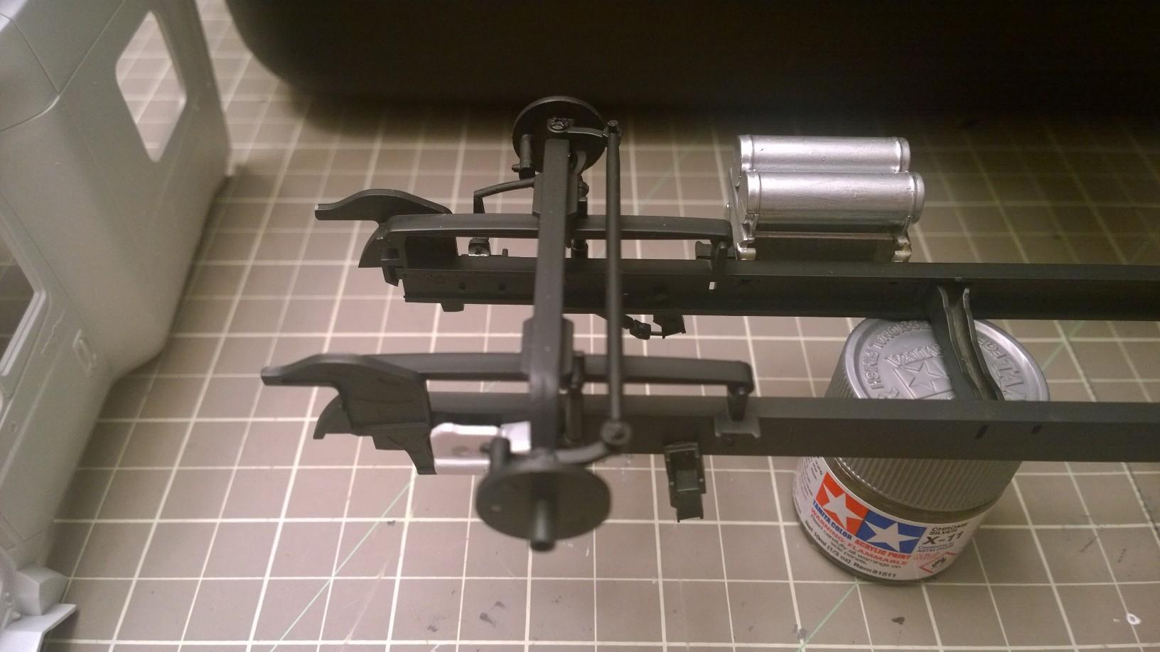

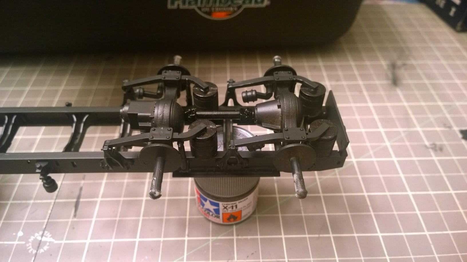

Finally finished getting suspension mounted, and got some more work done on the engine. I'm still really impressed with how well the Moebius kits go together. Very little play when assembling, everything lines up really well. This engine will look really good once I get some weathering and detailing done on it.
"One thing I noticed is that the instructions say to install the oil pan as I have. But every reference pic (see below for examples) of the real thing I've found has the pan on the other way around. For those who have built this one, are the instructions wrong? Will the engine still fit if I flip the pan around?"
Don´t know if it is still in question but the orientation of the oil pan depends on front axle position. If it is set forward (SFFA) the oil pan lower part must be closer to the bell, like in your picture of the model engine. If the axle is set back (SBFA) then the oil pan must be backwards, like in the picture of the real engine. Otherwise the oil pan would get in collision with the front axle.
