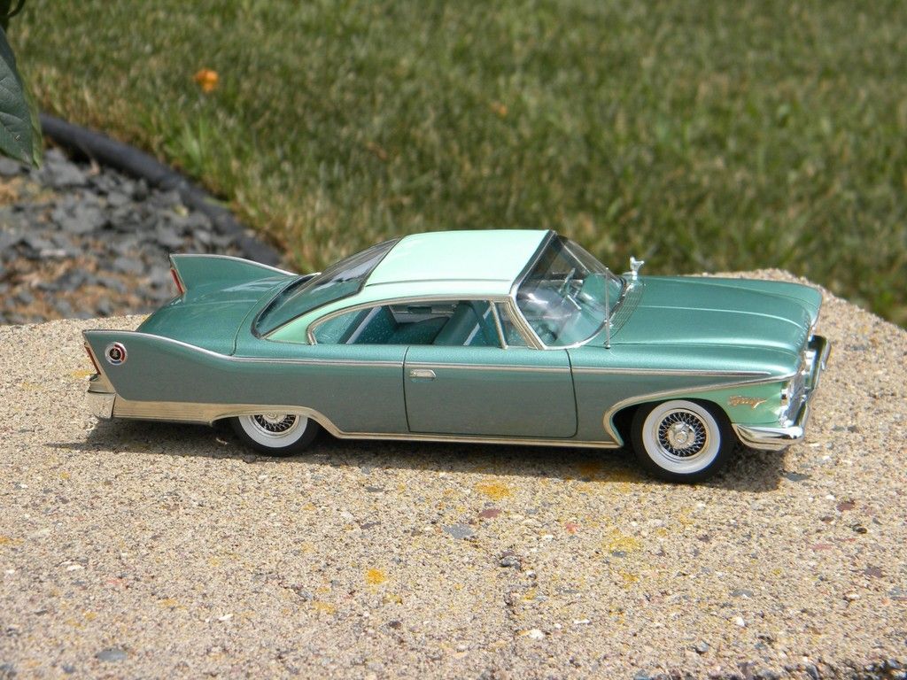

Actually Mike, it's much easier to get that "sand paper" finish with an airbrush than a spray can.
Rattle cans will generally spray a larger volume of paint than an airbrush diminishing the tendency to get that grainy texture.
I've had the same problem on occasion & the remedy for me was just to open the paint flow a little bit & get the brush a little closer to the body when spraying.
Remember, the clear is just a colorless lacquer.
It will do the same thing as the color if you spray it the same way.
I have found that the clear will shrink up & level out a little better than the paint, but it can still do the same sort of thing.
Just to put your mind at ease, I have had paint jobs start with a little of that "graininess" that still turned out well with clear coats & polishing.
I remember having some of that happen on the hood & trunk lid of my '60 Fury, but in the end, it turned out fine.
Steve
Thanks so much for all the great advice Steve and Bill.  I was under the assumption that using an airbrush was the better way to go.  I did take another look at the body and the sand paper finish isn't as bad as I had thought.  It's there but I'm sure with a few coats of clear, from the spray can this time, and polishing should fix the graininess.
Steve, you really did put my mind at ease.  Your '60 Fury is beautiful!
