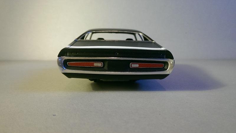

440 6BBL Posted February 2, 2016 Posted February 2, 2016 Outstanding! That would be very appreciated. Thanks! The name 440 6bbl is very re-assuring! Look forward to seeing them. Here it is. I bought this Charger as a chassis donor for MPC´s ´71 Roadrunner. This build is made from the left over parts from the Roadrunner build. A friend owns the 1:1 Charger and I´m doing this model for him. Since he is no rivet counter, I didn´t go for maximum accuracy. Just looking forward to getting it finished quickly while ending up with a solid model for a guy with big fingers who doesn´t know how to carefully handle a model. The bulge in the hood was cut out and replaced with a piece of hood from AMT´s ´70 Monte Carlo. Front and rear bumper units were stripped, modified, painted black and wrapped in BMF. Side markers were puttied and sanded and will be redone with just BMF and clear red and clear orange. Vents in the doors were deleted with putty and I added vinyl roof trim to the body because my friend´s Charger once had a vinyl top. Only the trim remained on his car, it´s quite a beater with dents on all four corners and a pretty lousy paint job. But it has a solid body and runs strong with a refurbished 383. I just cut away what was not needed on the bumper units. Added some sheet and putty and sanded them parts into shape. Hope this helped a bit.
