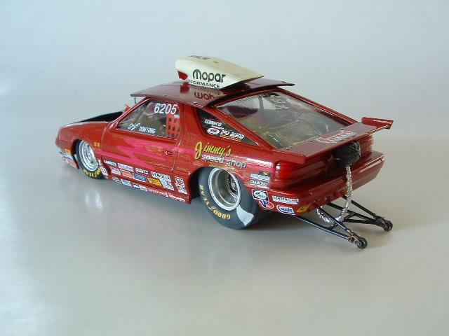

Mister Twister Posted March 27, 2016 Posted March 27, 2016 As Force stated you will probably have to source parts from various kits. I built this Super Gas type car several years ago (its similar to the Omni) and I used a modified Revell Pro Sportsman chassis (shortened and narrowed) with a scratchbuilt cage. There are many ways to go at this build and I hope you find the route that is easiest for you.

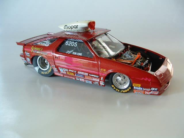

caine440 Posted May 27, 2016 Posted May 27, 2016 This is an older build from 2009 I did using the fire fighter and Omni combo. I intend on doing a Dick Landy Omni now that my skills have improved some.

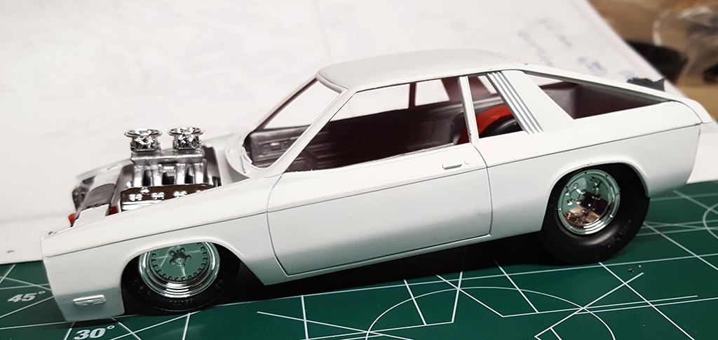

Mahogany Rush Posted June 3, 2016 Author Posted June 3, 2016 That looks awesome caine440! Any more pics? I am stuffing a big dual-plug hemi in mine, like the actual car. I had to bow the body out a little in the rear to fit those meats that came with the Mustang. Below is a working mock for stance. It's coming along. Thanx for your post!
