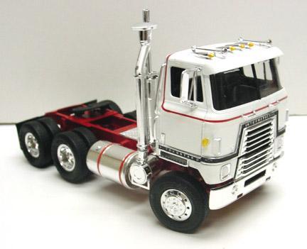

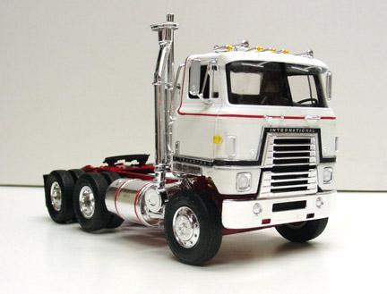

doogie7046 Posted June 5, 2016 Posted June 5, 2016 Its a great kit, one of my favourites. The only thing I would do is move the battery box back about 1/8 inch or so and also move both fuel tanks back as well to keep them lined up. By moving back the battery box it allows the front wheels to be in a turned position without hitting the battery box. Here are a few of mine. The daycab Transcon is actually the Transtar 11 Eagle just back dated as best I could to represent the CO 4070A
gotnitro? Posted June 5, 2016 Author Posted June 5, 2016 X2 !! Thanks everyone for the feedback, and the pics were outstanding! I've been watching the auction sites for one, waiting patiently for a deal! Would love to see someone reissue this one
