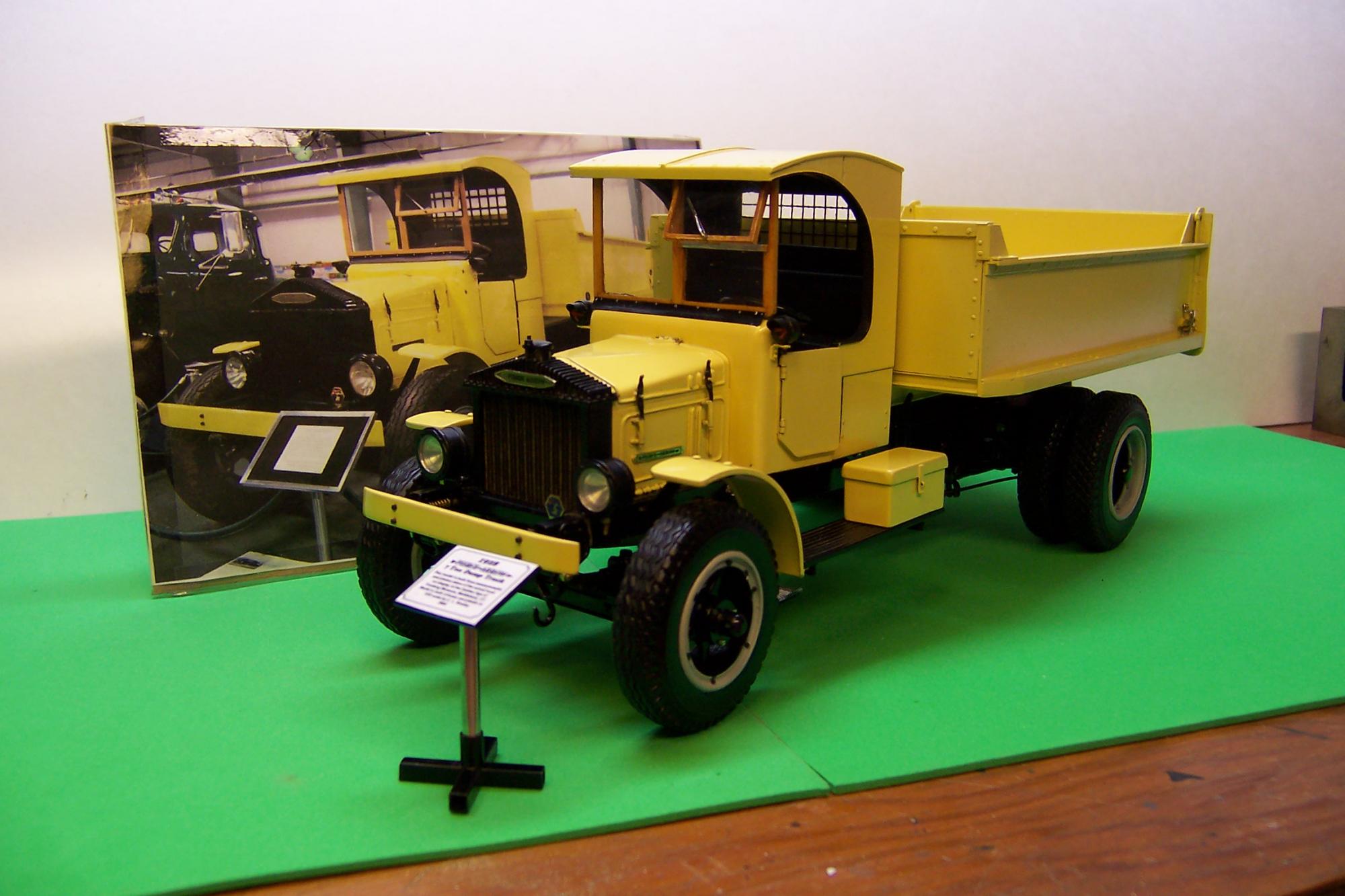

Chariots of Fire Posted June 18, 2016 Author Posted June 18, 2016 Harry: That is a brushbreaker. Our part of the country has a lot of pitch pine, white pine and scrub oak. A truck like this is intended to "break" its way in to the fire and pinch it out by following along the flanks of the fire to put it out. They will take down a 6" tree easily. The whole idea is to go around as many as possible but if and when it is necessary to take one dowm it can be done. Long Island, NY and the Pine Barrens of New Jersey have similar natural cover but they use "stump jumpers" not breakers.Tom: My avatar is a 1928 Pierce Arrow. I will post some pics of it. Way back in the "On the Work Bench" there may still be some in progress pix but I'll post some new ones.
Chariots of Fire Posted June 18, 2016 Author Posted June 18, 2016 Tom if I may answer for Charlie: http://www.modelcarsmag.com/forums/topic/21363-near-final-construction-on-the-pierce-arrow-dump/It t It graced my kitchen island when it went to the NNL last October greg That's the Coleman that is in pieces. The Pierce Arrow is off to the left with the dump body up.

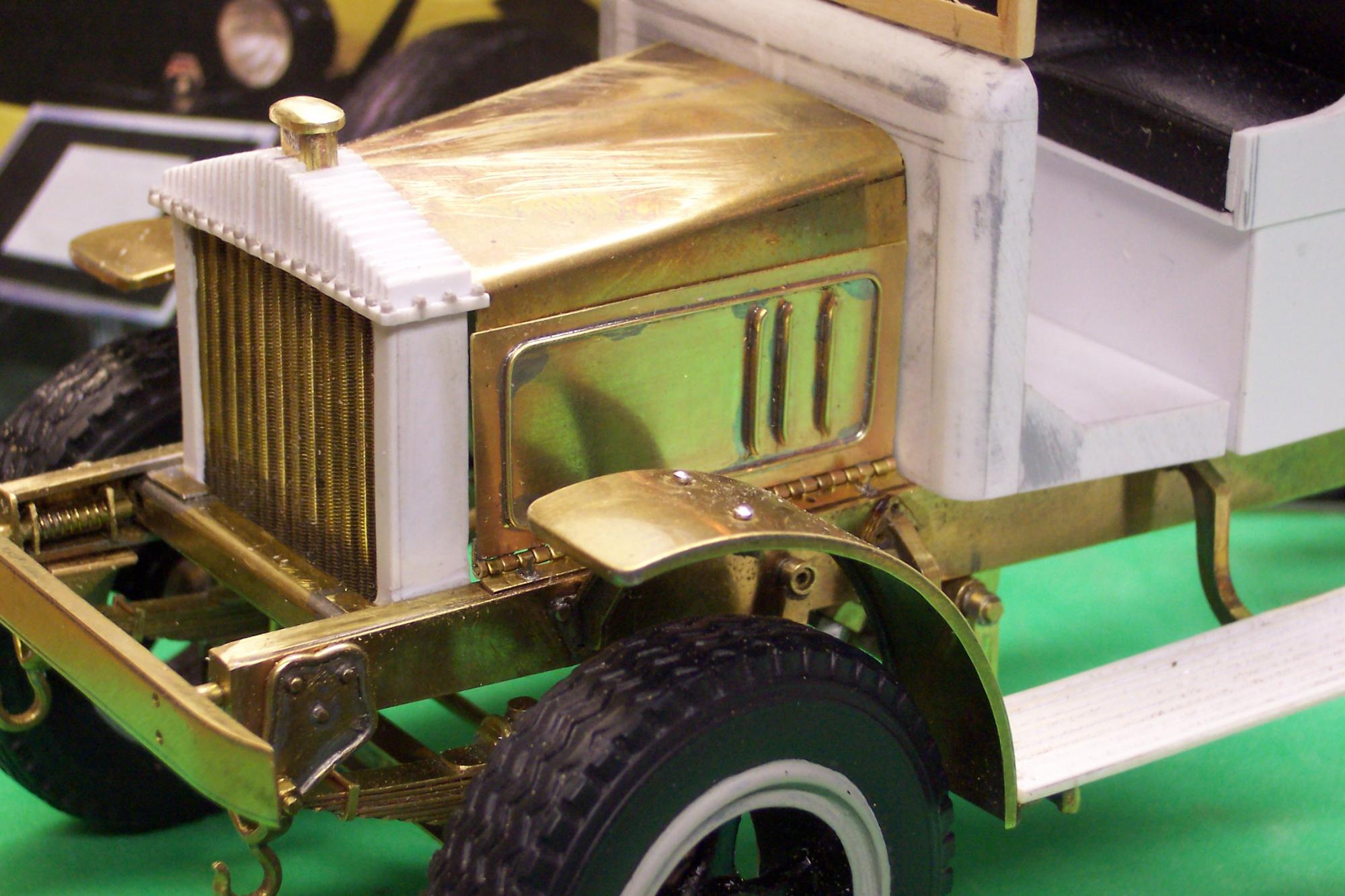

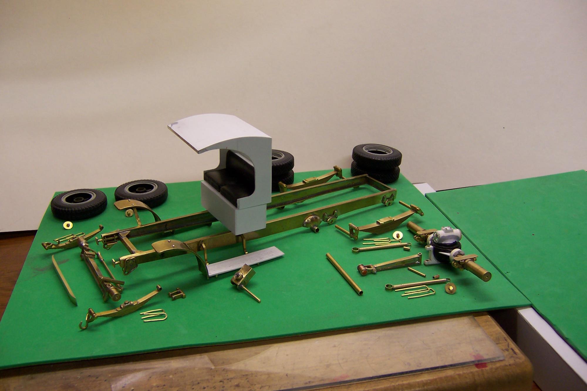

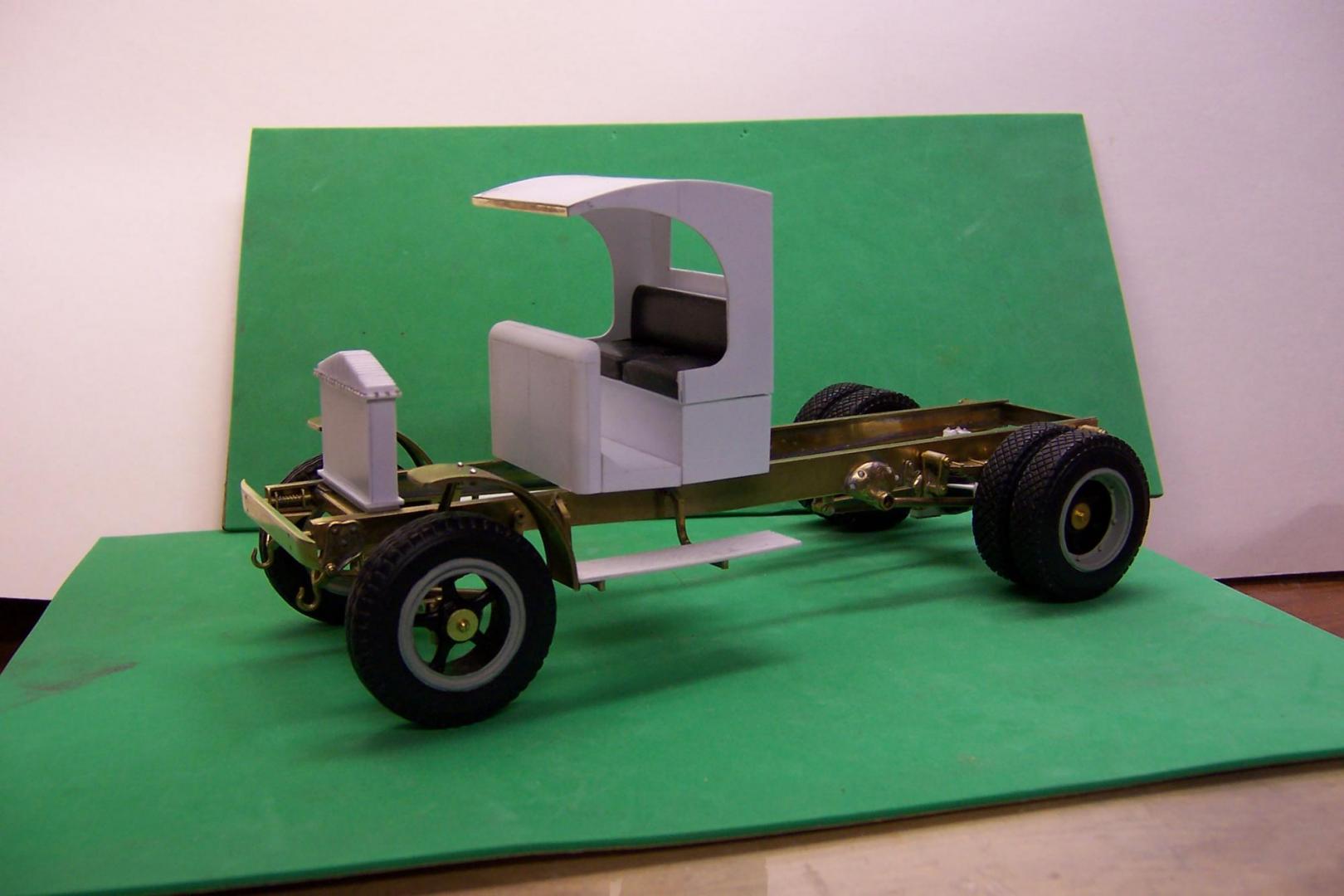

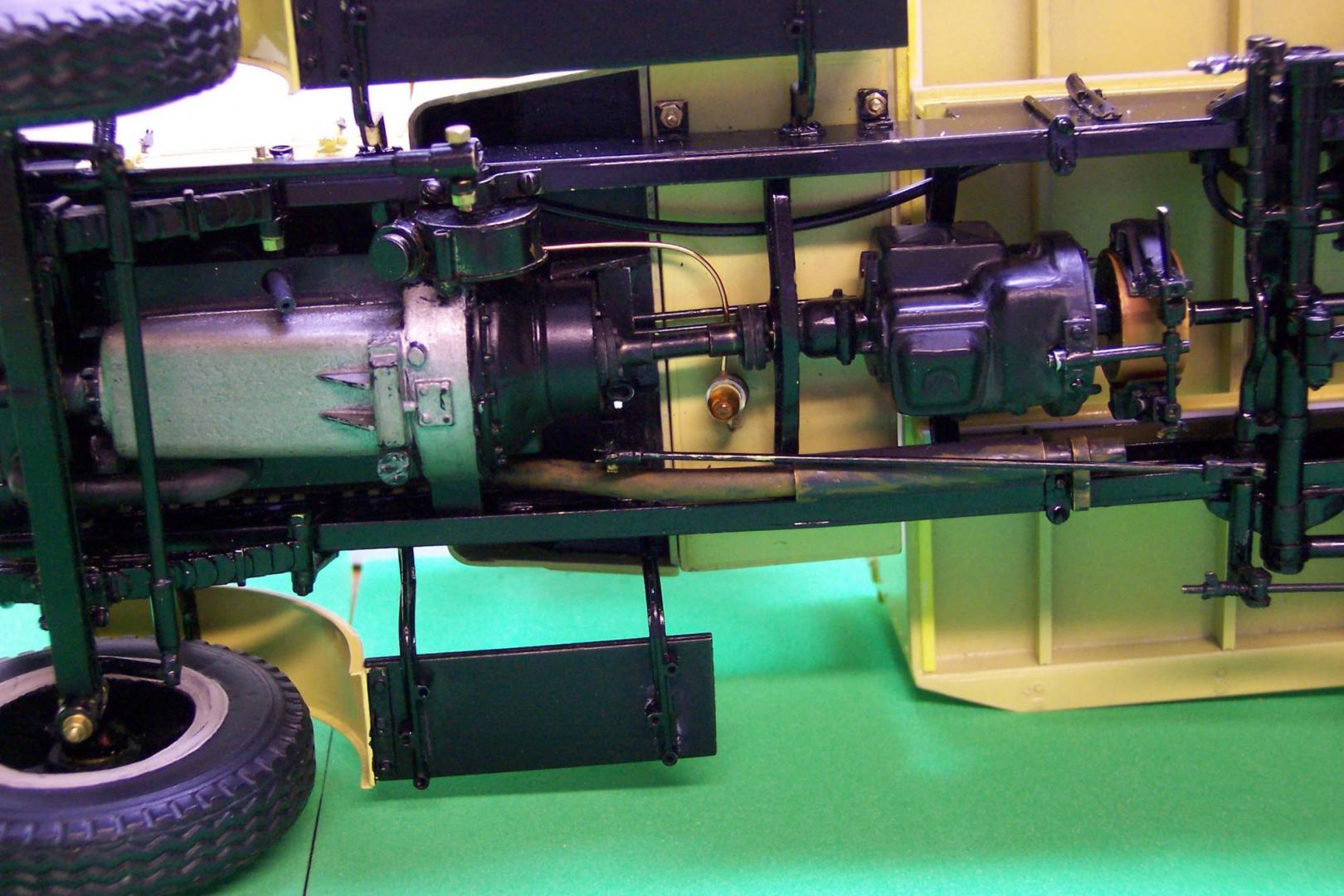

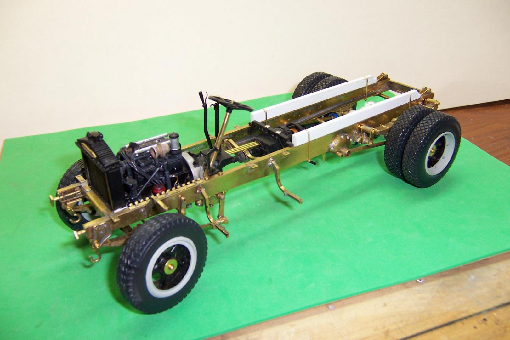

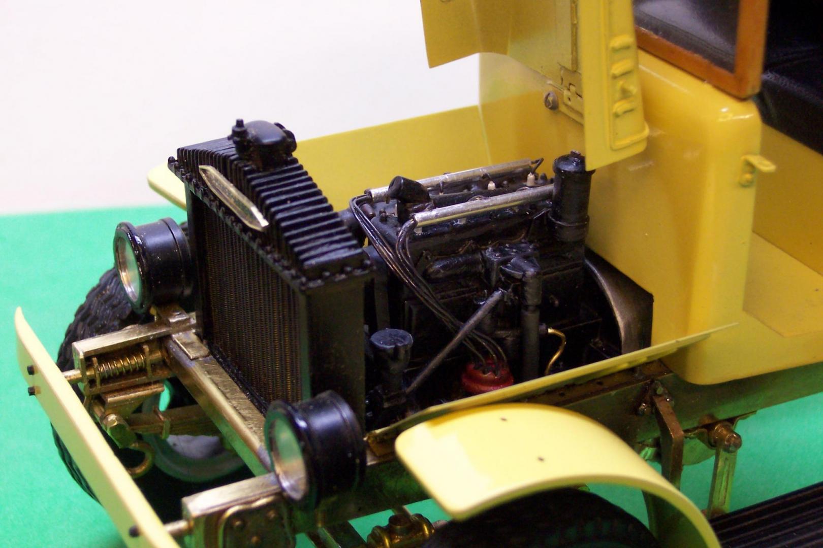

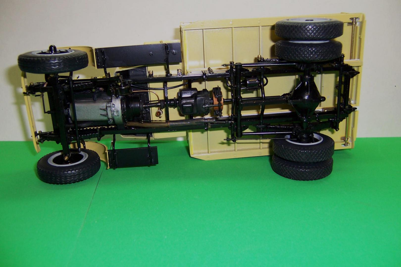

Chariots of Fire Posted June 18, 2016 Author Posted June 18, 2016 (edited) Here are some pix of the Pierce Arrow. The real truck was in a truck museum in Middlebury, CT along with many other trucks of the past. I photographed it and took a lot of measurements on several trips to the museum. Tom Coolidge cast the tires from masters that I made up. Lots of soldered brass strip stock, tubing, structural shapes, nuts and bolts and working steering box. The last photo shows a shot of the real truck with the model in the foreground. Scale is 1/25. Edited June 18, 2016 by Chariots of Fire
