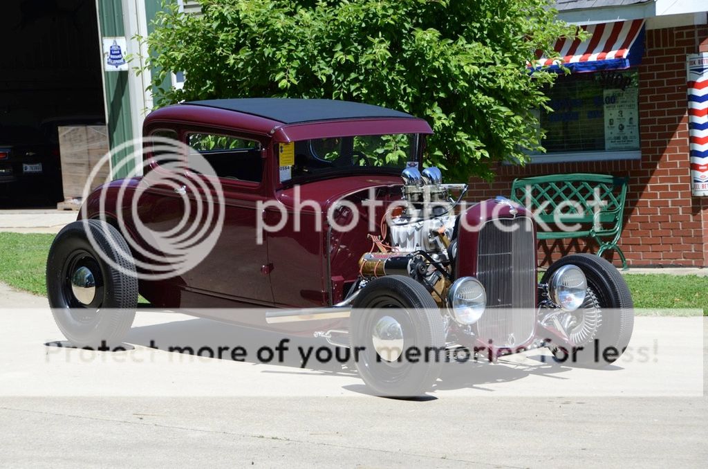

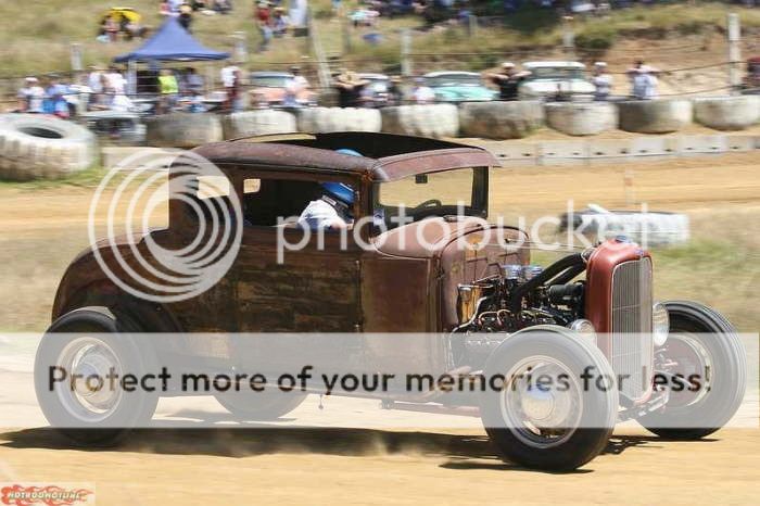

Ace-Garageguy Posted July 11, 2016 Posted July 11, 2016 One more note. The firewall on the '30-'31 body is often recessed behind the leading edge of the cowl to get more engine room...like this. It's an effect you can get EASILY with the new kit, with just a little effort.

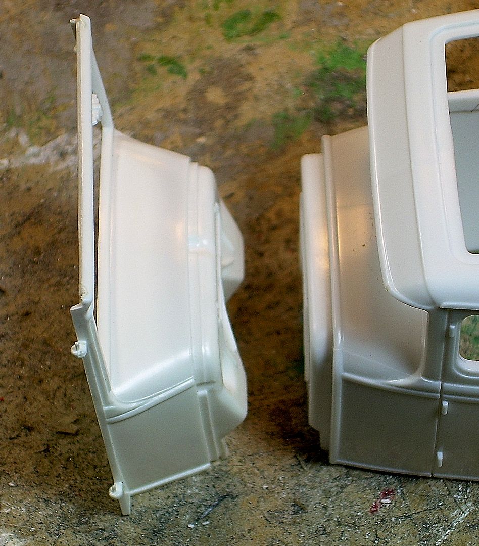

Ace-Garageguy Posted July 11, 2016 Posted July 11, 2016 Another look at the cowl surround, and the relationship of the steps and depth of the firewall to the cowl, as manufactured by Ford.
Spex84 Posted July 11, 2016 Posted July 11, 2016 I just wanted to point out that the recessed grille on that blue car appears to be a flipped firewall--so the raised "X" center stamping is now inverted. A cool period-correct trick that is tough to replicate 100% with plastic parts, but the general "feel" could be achieved easily, as Bill suggests.Yep, that cowl band is way fat, definitely needs to be either foiled to represent the original chrome band or shaved and replaced with a more in-scale band to represent the body stamping.Have one of these in the mail, can't wait till it gets here!!
Jantrix Posted July 11, 2016 Posted July 11, 2016 One more note. The firewall on the '30-'31 body is often recessed behind the leading edge of the cowl to get more engine room...like this. It's an effect you can get EASILY with the new kit, with just a little effort. Hmm..........I probably should have done that with my I6 conversion. Might not have had to stretch the chassis.
tim boyd Posted July 11, 2016 Author Posted July 11, 2016 Not sure if the car pictured above is the one, but several recent '30A Five Window Trad Hot Rod builds have used a '32 (not Model A) firewall in a recessed position as shown. See details in the recent issue of Rodder's Journal that feature a detailed article on four such 1/1 scale rods. Great ideas there....TIM

Greg Myers Posted July 11, 2016 Posted July 11, 2016 No chrome surround, removed, fell off, rusted away.
Greg Myers Posted July 11, 2016 Posted July 11, 2016 (edited) Not sure if the car pictured above is the one, but several recent '30A Five Window Trad Hot Rod builds have used a '32 (not Model A) firewall in a recessed position as shown. See details in the recent issue of Rodder's Journal that feature a detailed article on four such 1/1 scale rods. Great ideas there....TIM Edited July 11, 2016 by Greg Myers
Greg Myers Posted July 11, 2016 Posted July 11, 2016 (edited) Chrome's gone too. Edited July 11, 2016 by Greg Myers

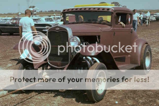

Ace-Garageguy Posted July 11, 2016 Posted July 11, 2016 (edited) Did you guys ever finish that thing ? Yup. I should point out again, I never so much as laid a wrench on this particular car, though it was built by the shop where I built most of two others over several years. This car is built on a frame that's quite similar to the "channeled" frame in the new Revell kit. It's essentially a boxed model-A frame made of rectangular steel tube, built to the longer wheelbase of the '32 Ford...much like the one in Revell's kit. Ford 9" rear end (but on a transverse leaf spring) and a smallblock Chebby crate-motor too.The difference, and an important one, is that besides being zeed in the rear, it's also zeed in front (just behind the firewall, and visible in the unfinished profile shot above) to get the nose down without having to use a drastically dropped axle or a suicide perch. Here's a shot of what the stock roof opening and wooden framing looks like in reality. It's made a couple of covers, including this French mag. Edited July 11, 2016 by Ace-Garageguy

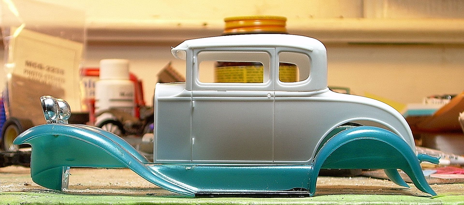

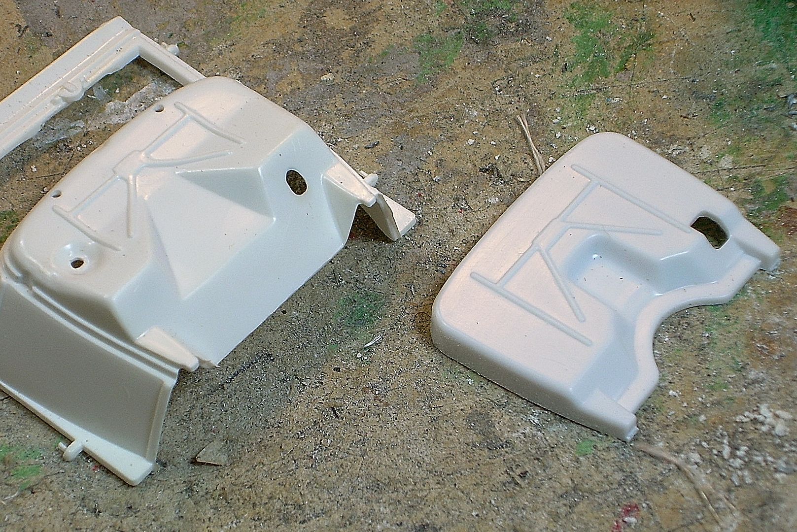

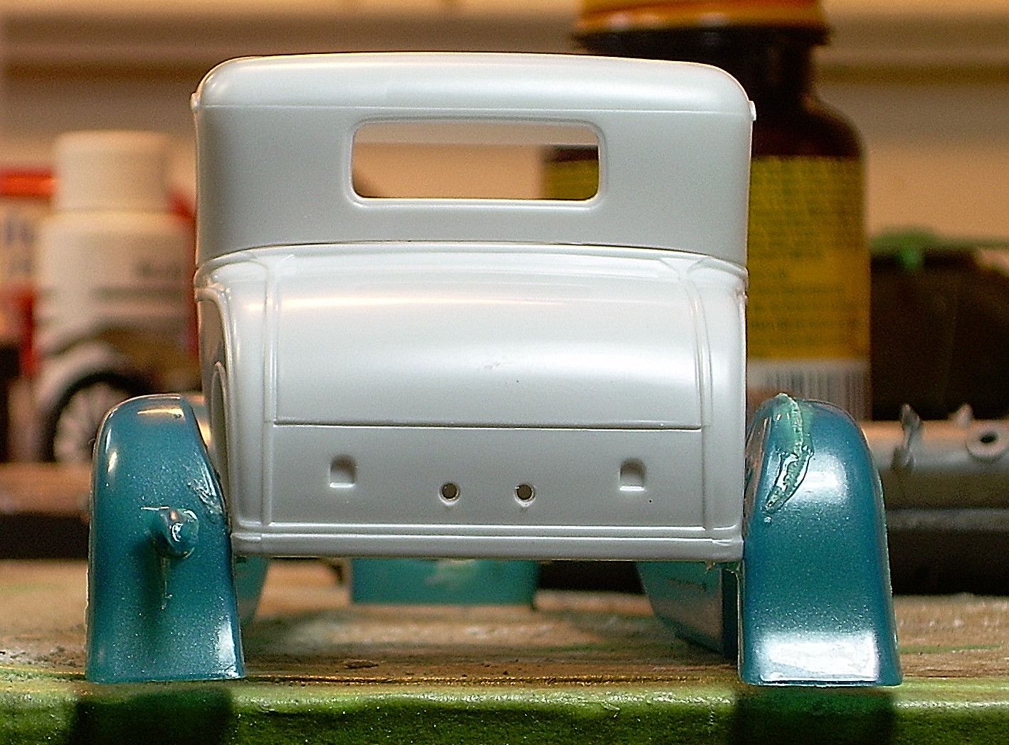

Ace-Garageguy Posted July 13, 2016 Posted July 13, 2016 So...if you want to put this body on the old Revell '30 fenders, you're going to have to fill the sides of the quarters first... Then fill the tops of the fenders in to meet the quarters... The firewall's obviously supposed to represent an aftermarket piece. It's significantly different from the old Revell stocker, but not THAT much. The stock firewall can easily be removed from the woody cowl (shown here) and transplanted. What makes the new-tool firewall look really clunky isn't so much the firewall itself...it's the huge out-of-scale lip that is apparently supposed to represent the bright metal surround of the real car. See above.

Spex84 Posted July 14, 2016 Posted July 14, 2016 For those who don't want to do a full firewall swap, it could be made to look more like a 1:1 with a couple of additions:1. a strip around the perimeter to give it the "stepped" look like the original. Divots could be filed in the sides to match the 1:1.2. sand the heck out of the "crown" of the firewall...right now it's ultra square ( like a square edge with a 2" scale fillet), whereas the 1:1 and the old AMT/Revell firewalls have a more gradual curve. The difference in radius can be seen very clearly in your comparison photographs, so thanks for those!
