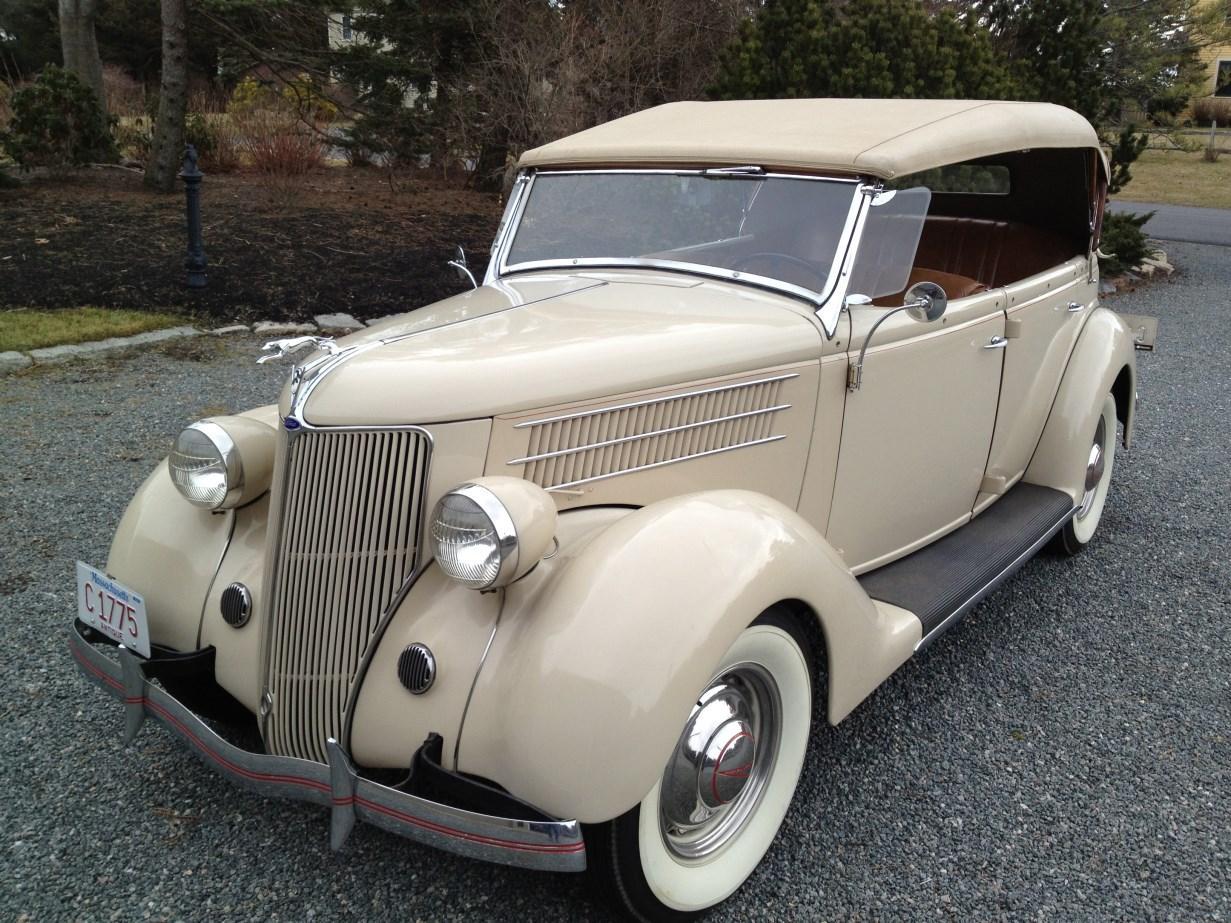

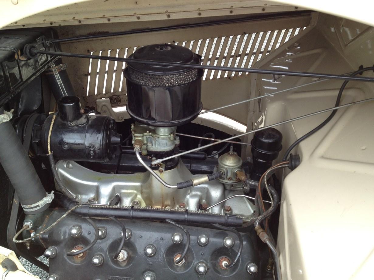

J Witt Posted June 27, 2016 Posted June 27, 2016 I have a full scale 1936 Phaeton and I was delighted to find the Motor City Resin Casters kit for this car. I just received the resin kit, but haven't gotten the AMT donor kit in the mail yet. That part should be here in a couple of days, since HobbyLinc is only about 25 miles from me. Here's a photo of the full size Phaeton. It is an early '36, so has some features that are different than the later cars, mostly in small details of the dash and engine. Many of those details will be irrelevant to a model. If anyone needs reference info on early V8 cars, let me know and I may be able to get pictures for you. I belong to the local EV8 club and they have a wide age range of cars in stock trim. The MCRC kit is very nice quality, no pinholes to speak of and excellent parts fit. I've just started cleaning up the castings and have yet to glue anything together. I'm waiting to get the AMT parts to start in on the trimming and trial fit process before gluing anything. It's going to be nice to have the reference vehicle sitting in the garage. Regards to all, John

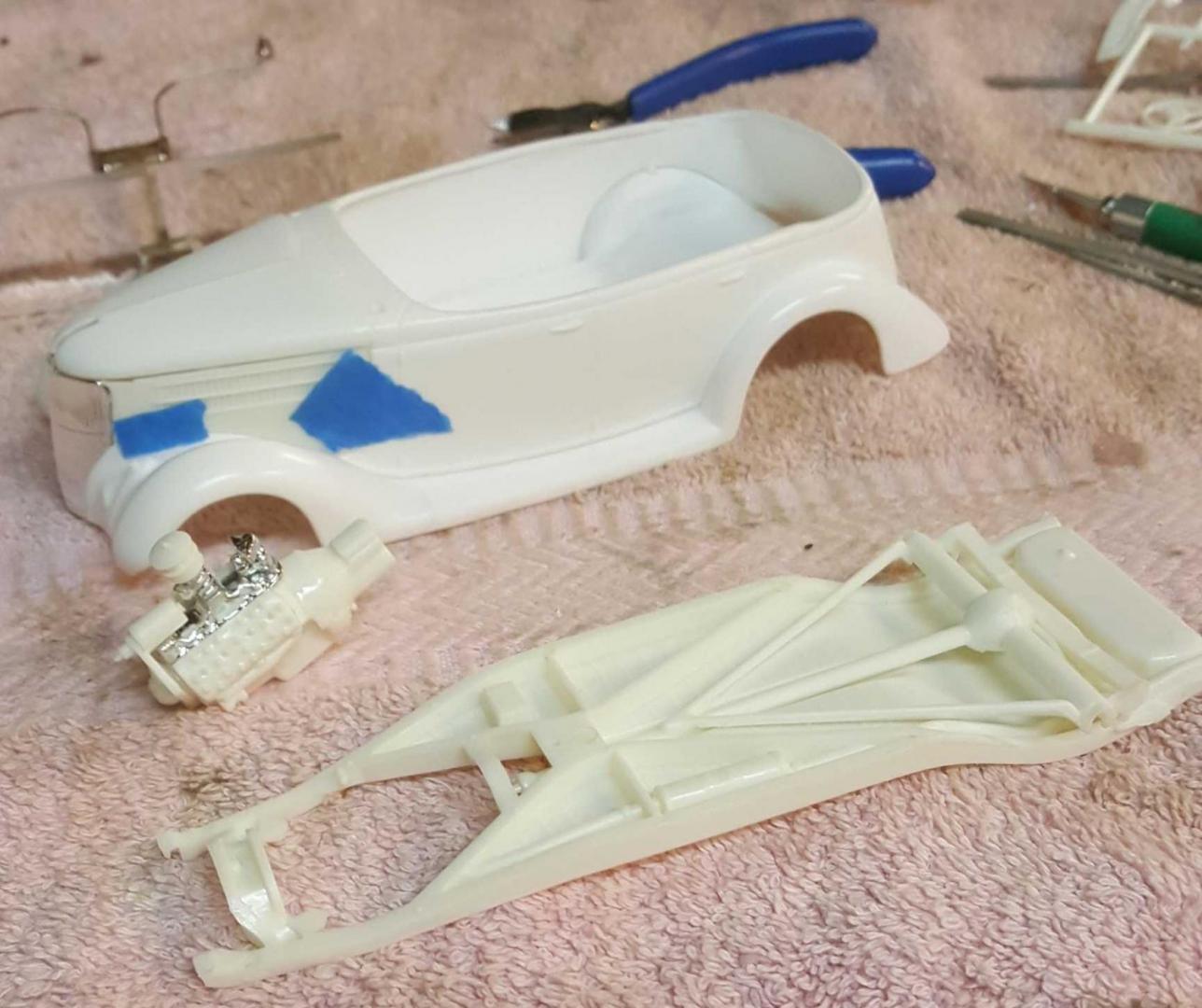

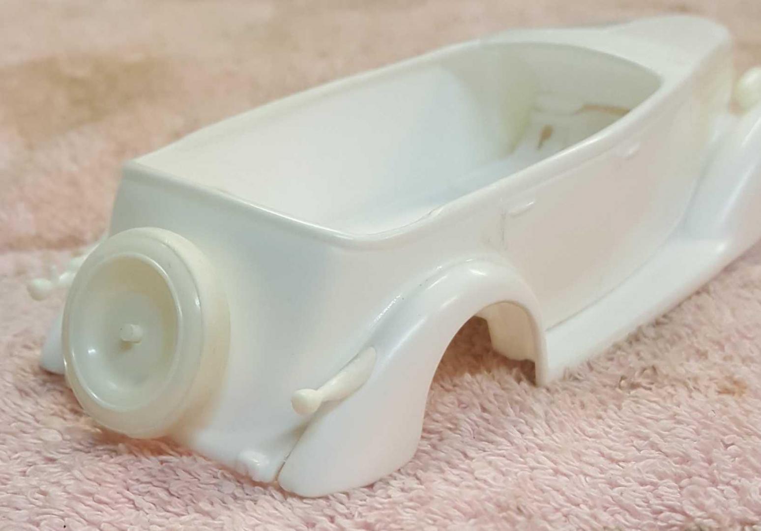

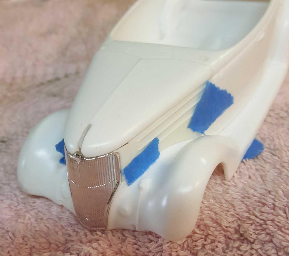

J Witt Posted July 2, 2016 Author Posted July 2, 2016 So the AMT kit arrived and I shook all of the parts out of the box to have a look. On the resin side, the body was assembled to the fenders. This fit was OK, but off a little at the tail end, which was corrected with a few rubber bands. After the glue was set, i taped on the hood and nose parts from the AMT kit and this all was an excellent fit. In fact almost too good. The real car has a gap at the bottom edge of the hood sides. This gap is about 3/8 inch wide. The plastic parts are a flush fit, so will have to sanded a little to have the correct look. This is going to be an OK build I think, having the basic parts fit as they should goes a long way to making the project fun.

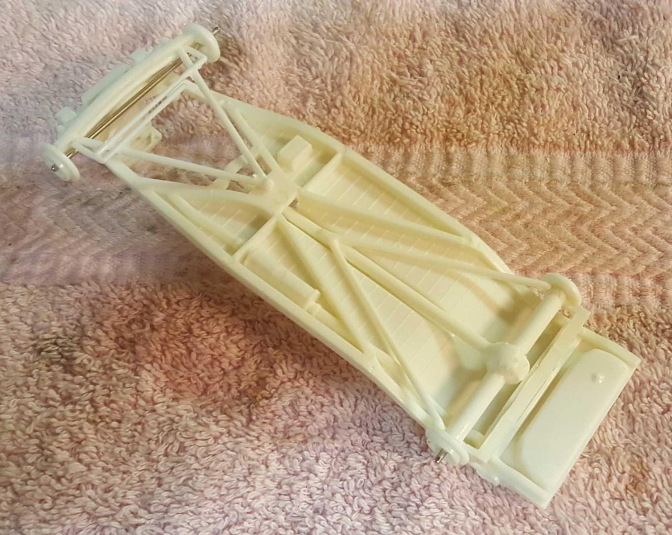

J Witt Posted July 7, 2016 Author Posted July 7, 2016 Got a little more done, just cleaning up and assembling the chassis. I'm trying to decide how much under body detail to scratch build for this model. The real frame has a series of holes in the vertical walls of the frame and a lot of the under body parts are routed through them, like the tailpipe and muffler which are cast on. There are so many discrepancies that the only real way to do it would be to scratch build the whole chassis and I'm not leaning toward the time investment that will require. Almost none will be visible without picking the model up and turning it over. I thought initially I'd at least add the brake rods and some of the front steering detail. My thought now is to paint it black and see how it will look. I think I will spend that time on the interior detail and give the undercarriage a pass.

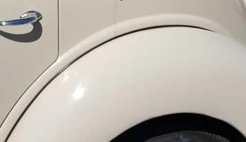

J Witt Posted July 10, 2016 Author Posted July 10, 2016 Here's a question for the crew. This car has black fender welting between all the fenders and body, plus black rubber pads under the tail lights and at the joints of some of the front sheet metal. Does anyone have a good way to model this? I've been thinking along the lines of black thread, or soft wire. The real welting is just over 1/4 inch in diameter, so reduced to 1/25 that is .010 inch wire -- pretty small. A technique I've used before for really small details like badges is to use a small amount of clear enamel or lacquer to hold the item in place and was thinking that might work for this too.
David G. Posted July 11, 2016 Posted July 11, 2016 Like you said John- I would try very fine wire or try to paint the lines in.The wire inside the twist ties that come in almost every box of garbage bags is soft and easy to work with. I frequently use it for fuel and brake lines.The rest of the project looks great, BTW.David G.

Eric Macleod Posted July 15, 2016 Posted July 15, 2016 Once upon a time I used black spark plug wire (1:24 scale of course ) for fender welt on a Cord Sportsman I was building. I think it came out looking spot on. Maybe consider that? The Phaeton is looking excellent.
