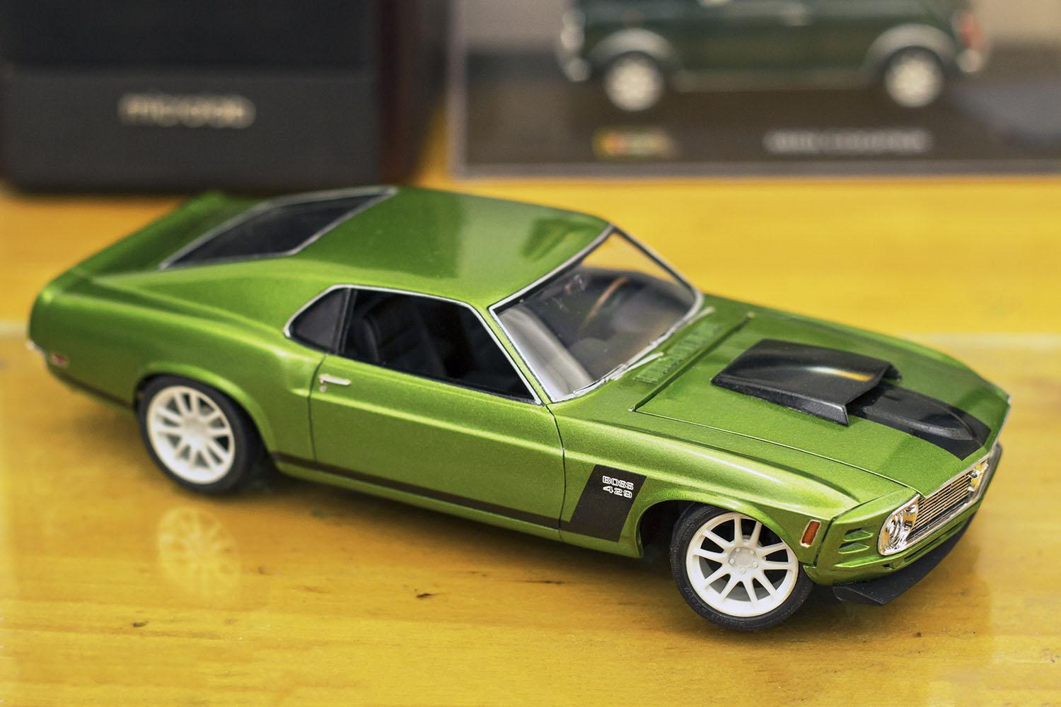

Ah, i see. I've built a few Revell kits. So far all had rolling wheels but they don't quite roll or fit perfectly without a bit of cutting, chopping and rebuilding the mounting points. I'm one of those guys that have a nagging irritation when wheels don't roll. This Mustang for example needed metal pins with flat head drilled into the axle so the wheels hold. Ignore the Enkeis, that's just a mockup. Currently sports stock wheels.
I like what you did on this Boss, Ronny.  I'll be interested in seeing what you do with the Cuda when you build it.
