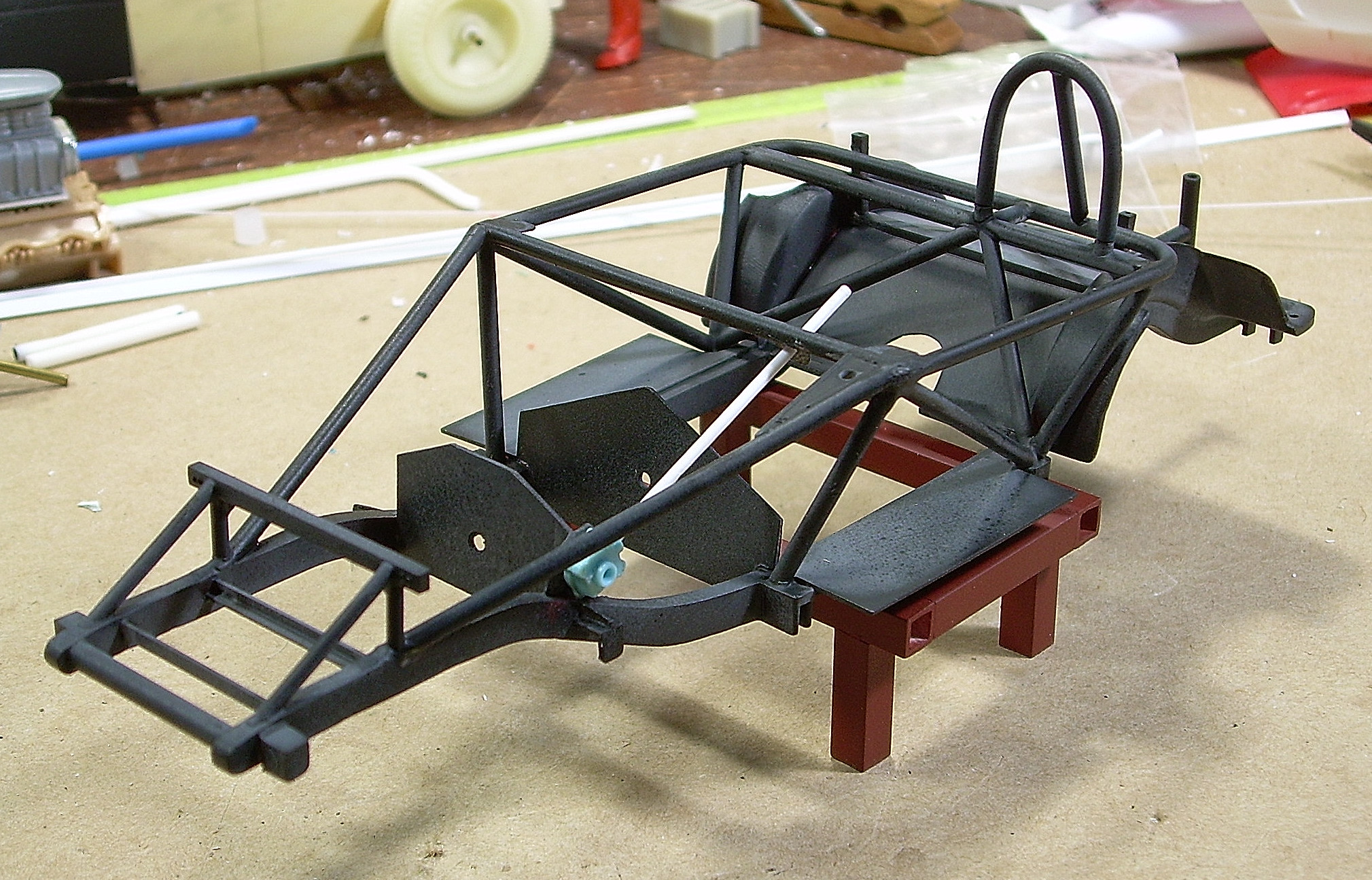

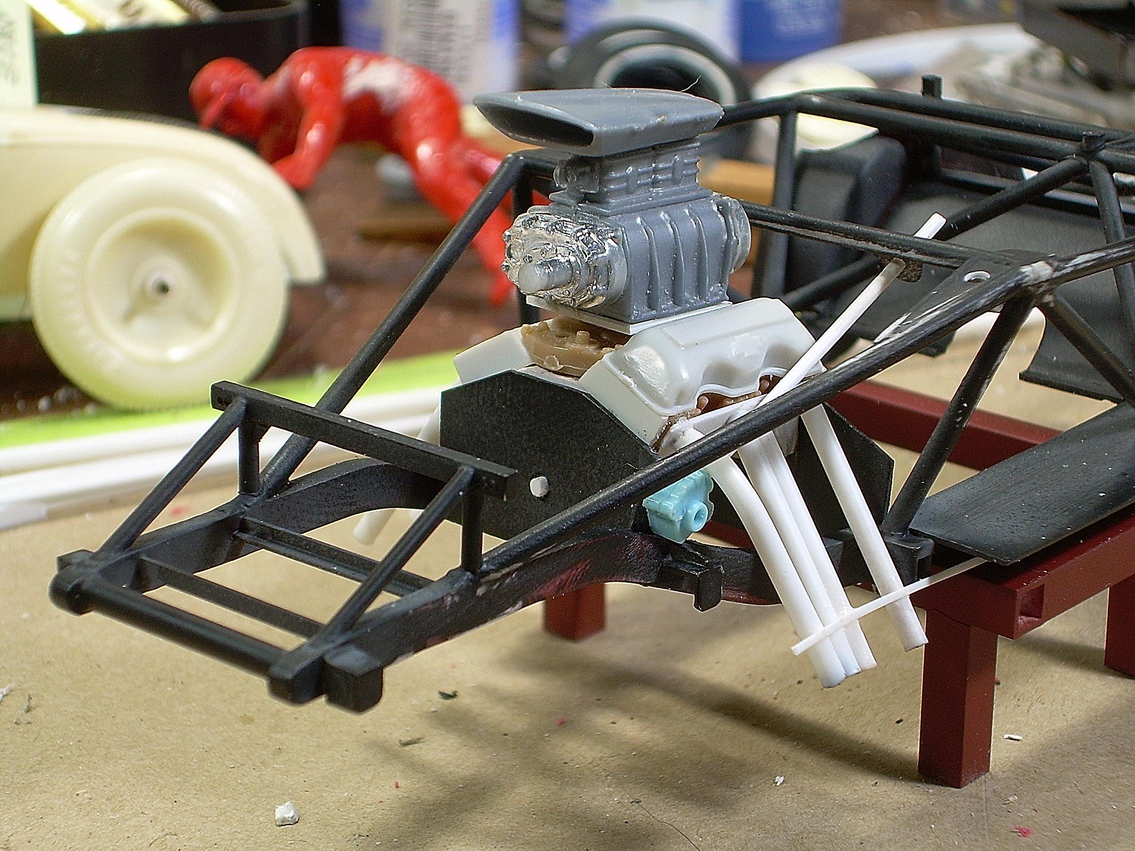

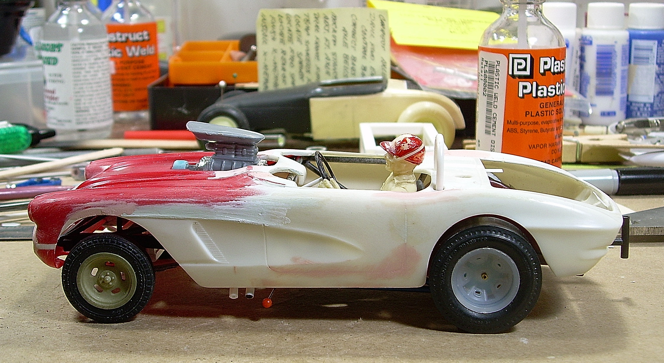

Ace-Garageguy Posted August 10, 2019 Author Posted August 10, 2019 Well then...with the steering mocked up, I was able to get some exhaust pipes in place to make sure I could get them in prior to permanently locating the steering. Two pipes are peeking out under the fender. All of 'em can be straight, except for the forward left (driver's side), which will have to make a little joggle to clear the steering box. The chassis is pretty much done at this point, with the exception of cleaning up some "welds" and final painting. The bracket for the steering box is in, and the Pitman arm will just clear the spring perch, with the drag-link running forward to the spindle. The bracket with the hole in it, in the corner towards the viewer next to the steering shaft, carries the brake master cylinder. From the rear, with the revised rollover hoop (removable so the body can come off for display) and the steering column-drop in place. Steering shaft in the center of the cockpit, and nice fit of the rollover hoop pass-through. Squiggly thing on the left is the brake pedal arm. This little car is going to run front disc brakes (probably junkyard XK-E), so it will need a longish brake arm, as there's no engine vacuum with a supercharger to run a conventional brake booster. Even after being obsessively careful to get the suspension dead square, I noticed a little tendency towards only 3 wheels touching the ground. Most annoying. Turned out I'd drilled the center of one front wheel slightly off. It's been filled with 1/16" rod stock and machined flat. I'll try to hit the actual center next time.
Ace-Garageguy Posted August 10, 2019 Author Posted August 10, 2019 Machined aluminum pulleys for the crank blower-drive and water pump. Locating the water pump drive ahead of the blower drive requires extending the water pump shaft, not the best possible idea, but it's better than running the blower drive way out. Lotsa load on blower drives. Not so much on water pumps. Cylinder heads got their huge gaping exhaust attachment holes filled. Block required some mods to be closer to legit too. It's still not 100% accurate, but it's close enough for what will be visible. And the bellhousing is getting modded to better represent the appearance of something with a torque-converter in it, rather than a flywheel and clutch.

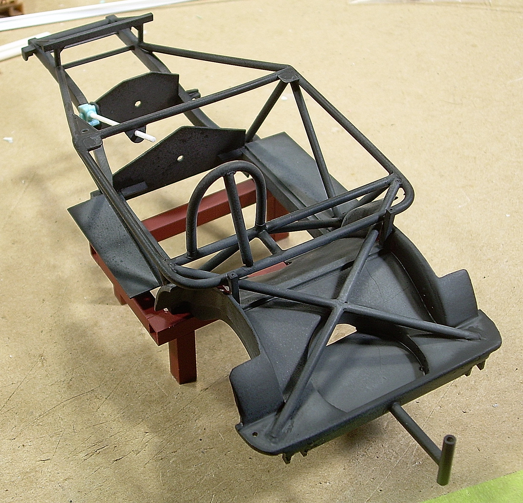

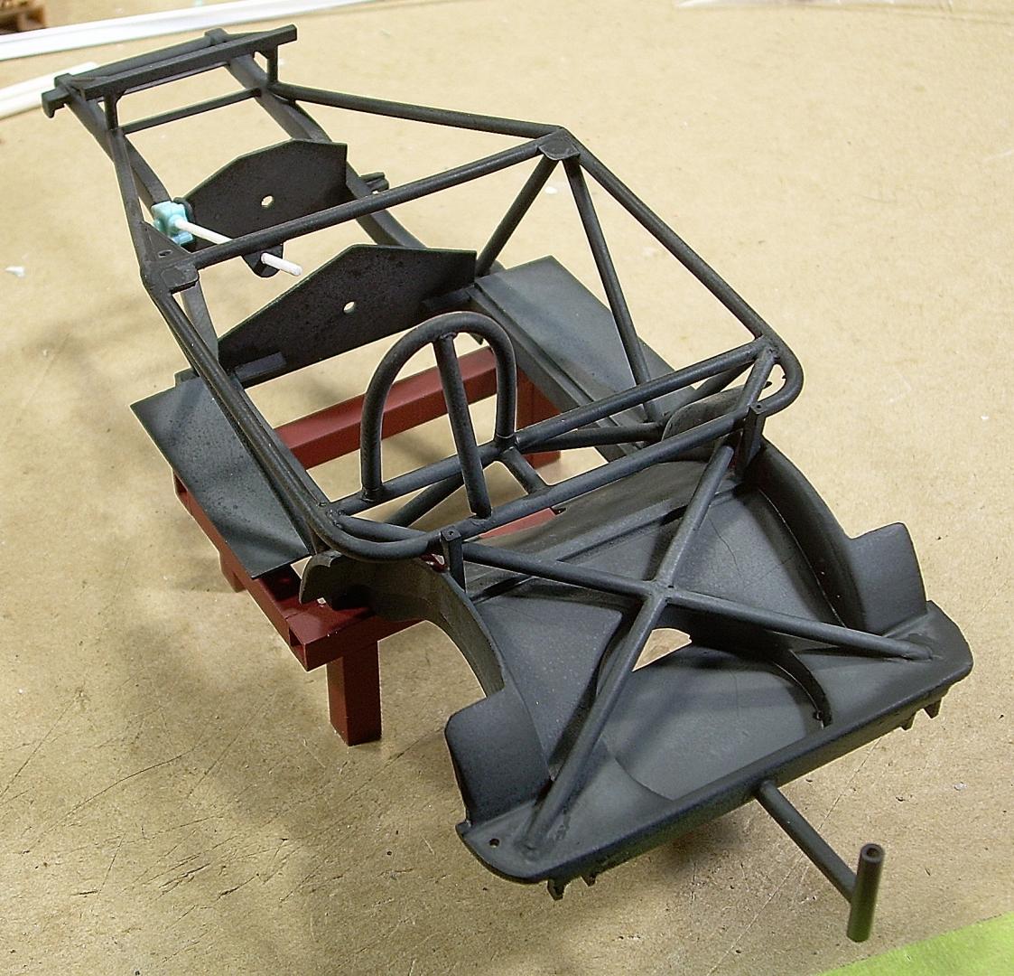

Ace-Garageguy Posted August 12, 2019 Author Posted August 12, 2019 Thanks for your interest and comments, gentleman. Had a little setback on the chassis paint. A gloss dark gray aircraft-engine enamel I've been able to use previously over black etching primer with no issues cracked in several areas over the red MPC portion the chassis is built up on. The chassis is complex, obviously, will be difficult to strip completely, and I'm a little disheartened at the moment. Press on regardless. There is always a solution.
bobthehobbyguy Posted August 12, 2019 Posted August 12, 2019 Bummer on the paint. Hoping you can recover from this setback. Definitely a cool project.

Ace-Garageguy Posted August 14, 2019 Author Posted August 14, 2019 On 8/12/2019 at 6:53 PM, bobthehobbyguy said: Bummer on the paint. Hoping you can recover from this setback. Definitely a cool project. Thanks Bob. She'll be OK eventually, one way or another. I have too much time and effort invested at this point to quit now. I'm always harping on "test on the plastic your model is made of". I've used the SEM self-etching primer on lotsa stuff with no issues, and overcoated it with both lacquers and enamels likewise. But THIS time, the red plastic the old MPC Corvette chassis that's the basis of this model's underpinnings did something weird. I didn't see it coming, at all, and was really REALLY surprised when the topcoat cracked ONLY over the old red MPC plastic. I seem to recall somebody having a somewhat similar problem with different materials not too long ago... But it's just a matter of more work and testing to get it sorted and back on track...and there's plenty of other stuff on this build that I can do simultaneously.

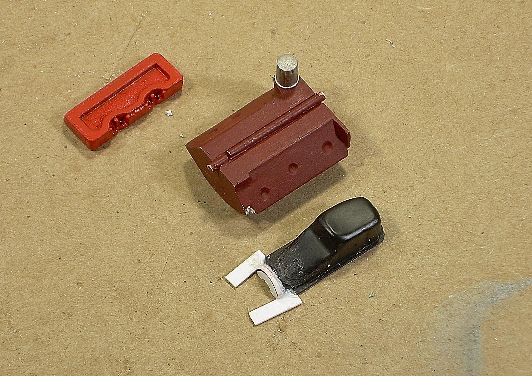

Ace-Garageguy Posted September 10, 2019 Author Posted September 10, 2019 (edited) SEPT 9, 2019 PROGRESS REPORT I did some remedial work on the block, shown earlier, and then realized the valve covers I wanted to use were rather too large for the engine I'm using, which is from an old AMT '57 Chebby kit. As it's kinda late in the game to change engines, and as I really didn't want to split up a better engine to get heads, the best solution was to add .020" stock on 3 faces of each head. This got me in the ballpark, and still works fine with the modified block. With the head situation largely resolved, I went ahead and built some simple headers out of scale 2" rod, drilled on the ends to represent tubing. The flanges are .020" stock, which is kinda fat to be scale-correct, but it looks OK to me (and I'll probably thin 'em just a tad prior to final assembly anyway). I had to make a little joggle in the front pipe to clear the steering box and bracket, and this is why I got the steering mocked up 100% first. The little brace strip at the lower end is .010" X .020", and will be trimmed close to the end pipes. The outlets will also be evened out (actually, they have been, as later build-up photos will show). After finishing, the assemblies were shot in Duplicolor sandable white primer, which mimics the look of the early VHF white nicely. One head finished and shot with real Chebby-orange engine paint, and some shallow holes drilled in the block in appropriate places to suggest freeze-plugs. A nice cast metal oil filter from Curbside Dioramics, though a little large for absolute scale-correct, adds a realistic touch. The oil pan I'm using is from a Revell smallblock Chebby parts-pack engine (the AMT kit pan had a hole for a metal axle and a molded-in oil filter; it also represented a cast, finned alloy job, and I wanted to stay with a modified steel pan). It's the right width for this 409, has a nice overall shape, but needed lengthening and a modification to the front sealing rail that could conceivably work with the engine mount-plate as I have it. Again, .020" stock to the rescue. The modified bellhousing and B&M HydroStick trans, shot in a red that's pretty close to what B&M actually used. A little more work on the oil pan. I decided to add material to represent a modded pan with more capacity, and deep enough in front to house a windage-tray. Edited September 10, 2019 by Ace-Garageguy

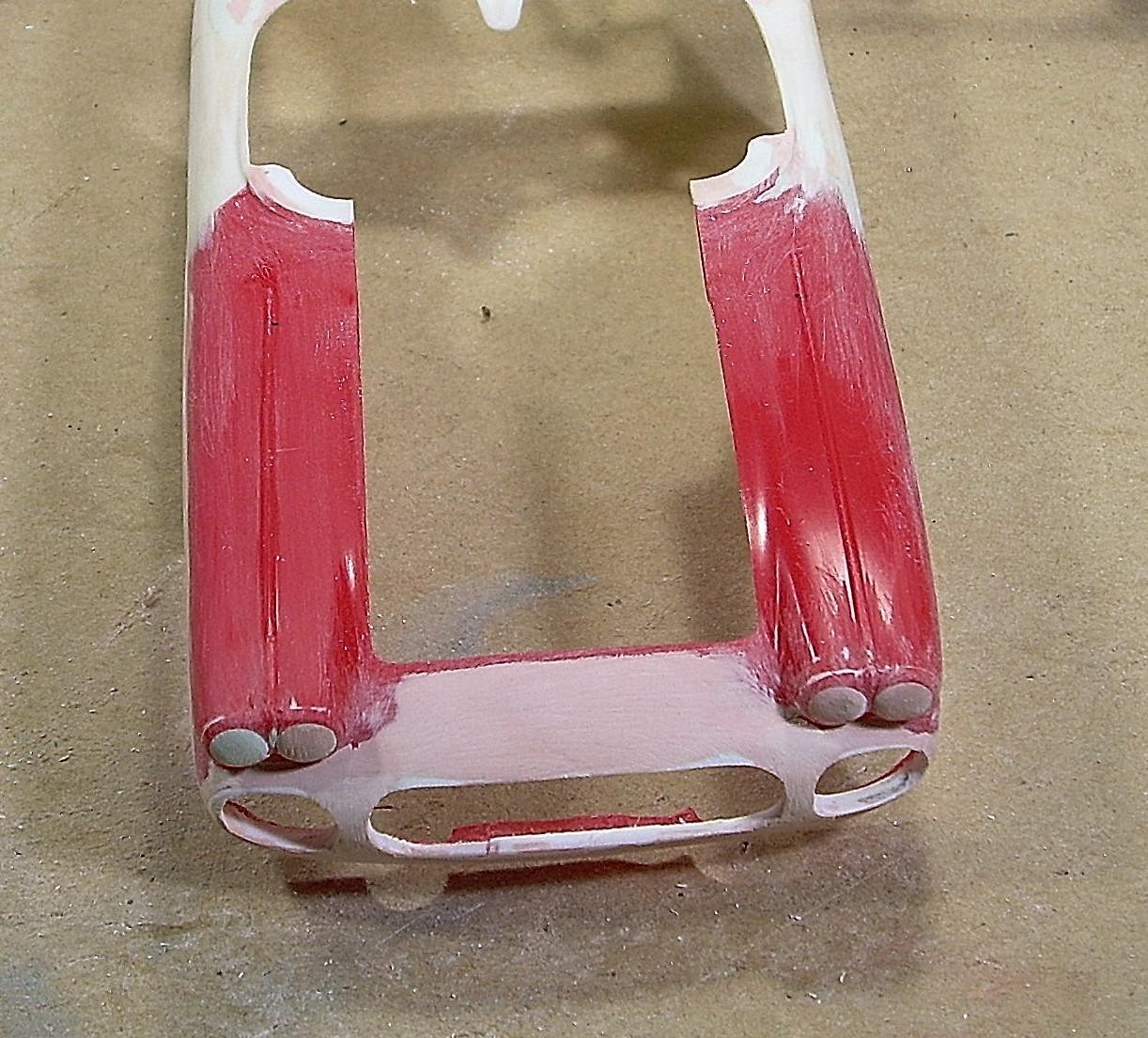

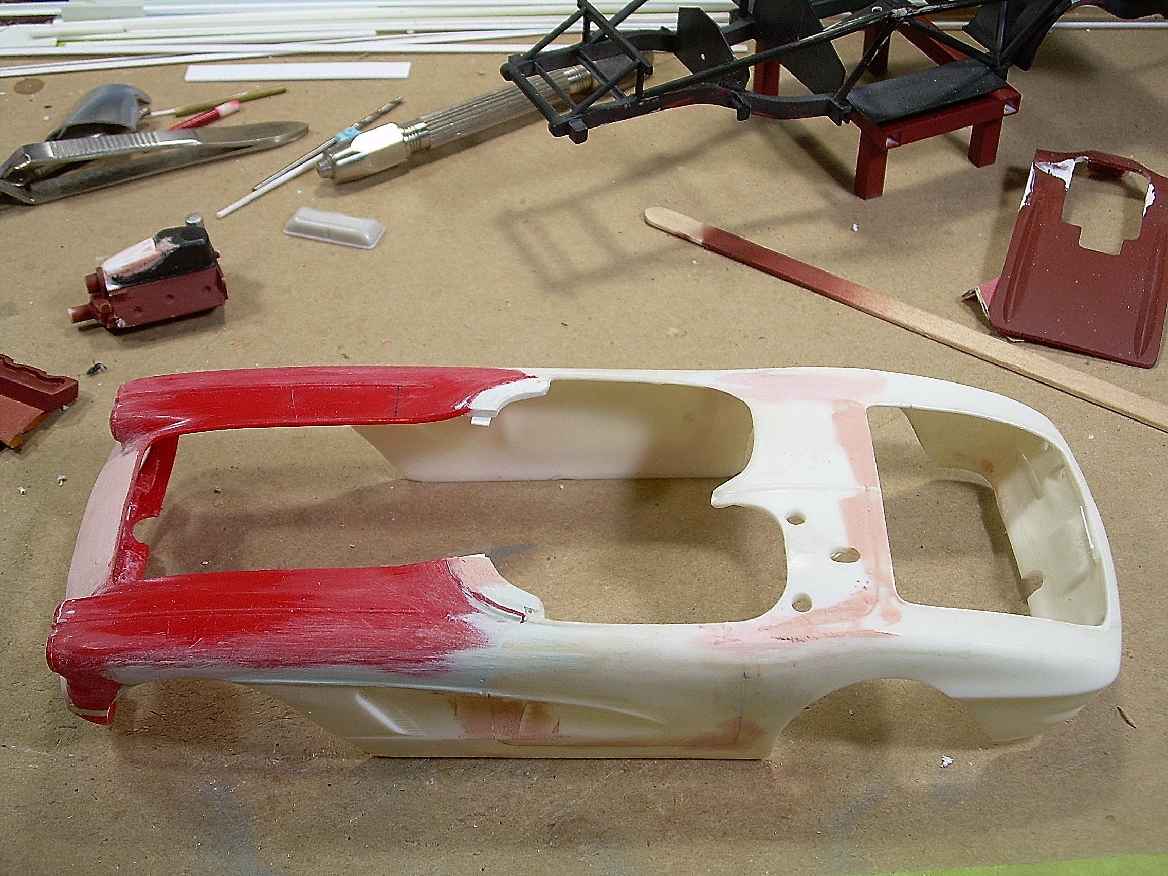

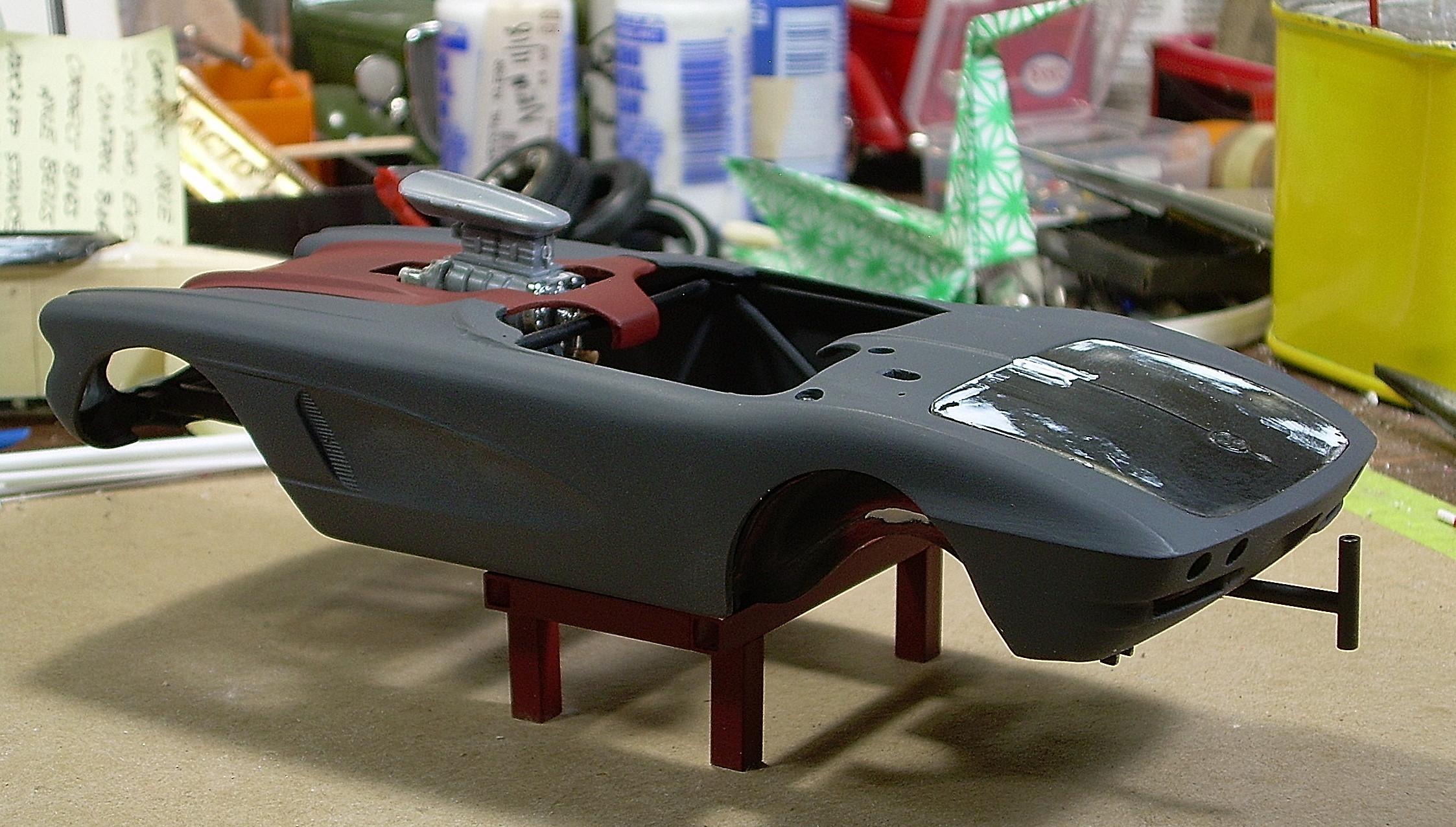

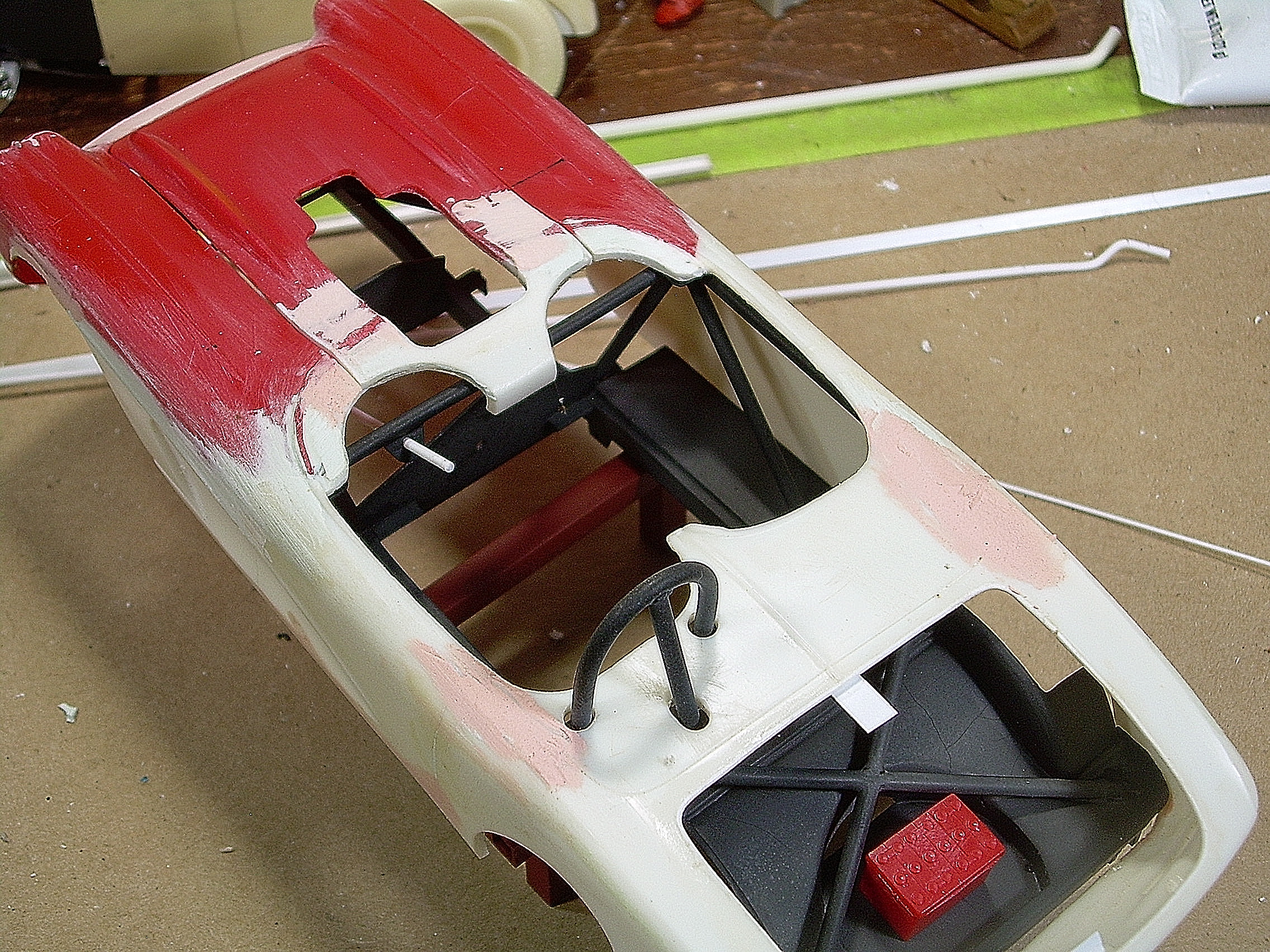

Ace-Garageguy Posted September 10, 2019 Author Posted September 10, 2019 (edited) SEPT 9, 2019 PROGRESS REPORT cont'd. There was a fair bit of bodywork to get it looking like I envisioned, including filling most of the panel lines (as it represents a one-piece clone body shell). One of the more challenging aspects was getting the shapes right at the headlight locations, and correcting the flat-faced look common to the AMT 4-eyed Corvettes. This is an ongoing process. Getting there, but still a fair bit of work needed to get the body right. It's all about caring enough to do what it takes, as many times as it takes...to satisfy myself. Bondo "Professional" two-part polyester glazing putty for the heavy fills, Tamiya white putty for small corrections. Duplicolor "hot rod gray" and "red oxide" sandable rattlecan primers. EDIT: The reason for using different colors of primers on the removable body parts is primarily to help make fit issues jump out. It works quite well. Edited September 10, 2019 by Ace-Garageguy 1

Ace-Garageguy Posted September 13, 2019 Author Posted September 13, 2019 On 9/11/2019 at 7:28 PM, bobthehobbyguy said: ...Have you gotten the paint issue fixed on the chassis? Thanks for asking, Bob. I've sanded all the bad cracking and crazing off, as I just didn't want to dip-strip it and risk having all those little roll-cage joints come loose. It looks like it'll be OK, but I'm really hesitant to shoot it again until I'm 100% certain the next stuff will work right. I'm going for a gloss dark gray on the chassis, my choices aren't great, and all of them will require some experimentation before I risk screwing the thing up again. I've also decided to add a few things to it, like an instrument panel, a bracket for the brake pedal to swing on, and probably a frame for a windscreen, just on the driver's side. I'll most likely make up all the fuel and hydraulic lines before painting too, so I don't scratch it in the process.
STYRENE-SURFER Posted September 13, 2019 Posted September 13, 2019 4 hours ago, Ace-Garageguy said: I'm going for a gloss dark gray on the chassis, my choices aren't great, and all of them will require some experimentation before I risk screwing the thing up again. Glad to here you got that little disaster sussed out. How about spraying it with Acrylic? Just a thought?
Ace-Garageguy Posted September 14, 2019 Author Posted September 14, 2019 22 hours ago, STYRENE-SURFER said: Glad to here you got that little disaster sussed out. How about spraying it with Acrylic? Just a thought? Thanks. That's probably a good idea. But never having worked with acrylics, water-based anyway, I don't know if I want to get into another learning curve just to get this one done. On the other hand, it might be the best way to avoid a real PITA if I get lifting and crazing again with "hot" paints. Hmmmm...definitely something to consider. I really appreciate your input.
OldNYJim Posted September 14, 2019 Posted September 14, 2019 I’ve always found acrylic to be WAY easier than most automotive products to get right with a minimum of fuss...I bet someone with your experience would find it pretty easy too. Love this build! I’ve really been enjoying this thread, as I do all of yours - thanks for the detailed and interesting posts you always publish on your projects!
