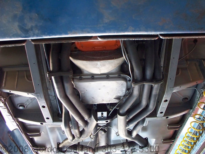

Here I come out of nowhere to stick my nose in the conversation!:huh:
The photo below depicts the exhaust system that would have come on a factory assembled Race Hemi car in1964 and 1965. This is documented! Yes, they do look very similar to the "Petty" headers! Were they exactly the same? I can't answer that but they sure are close.
I have seen photos of original A990 cars from 1965 and these are definitely what those cars came with. The single exhaust and muffler are also correct for those cars. It would seem to make sense that Chrysler would use parts that they had previously developed (NASCAR headers) in order to save time and development costs.
These headers were quickly replaced on drag cars for a couple of reasons, They were heavy, they were complex, difficult to r&r, and it was extremely difficult to service the transmission!
The restoration of the Texas Rattler in the link was an extremely thorough and high dollar effort. There is no reason to expect that they would go through all the trouble and expense to install an incorrect (and expensive) exhaust system on the car. As far as the headers being different from those in the dyno pic, headers used on a dyno are often not the headers that will eventually be installed in the car.
Regarding "where'd they get "good ones" from!", they can be reproduced and they are quite costly!
