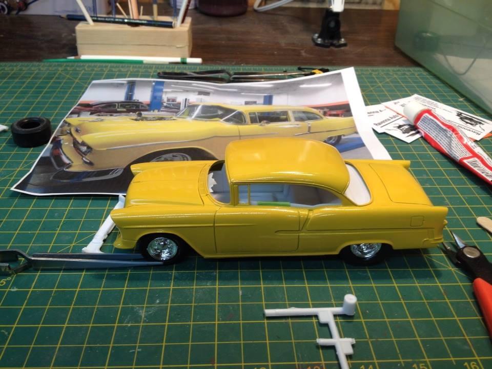

ratdoggy Posted December 9, 2016 Posted December 9, 2016 Doing a '55 Bel Air..The chrome strips that run from the door to the bumper is making me nervous ..How would you glue that on and not get glue all over the paint..Iwas thinking of using blue tape to protect it but I backed off that idea for now
Snake45 Posted December 9, 2016 Posted December 9, 2016 I'd use white glue like Elmer's or Tacky, just a few spots of it, not a lot, and if any ooshed out when I pressed the thing in place, I'd lick my finger and wipe it away. Not a problem--not at all.

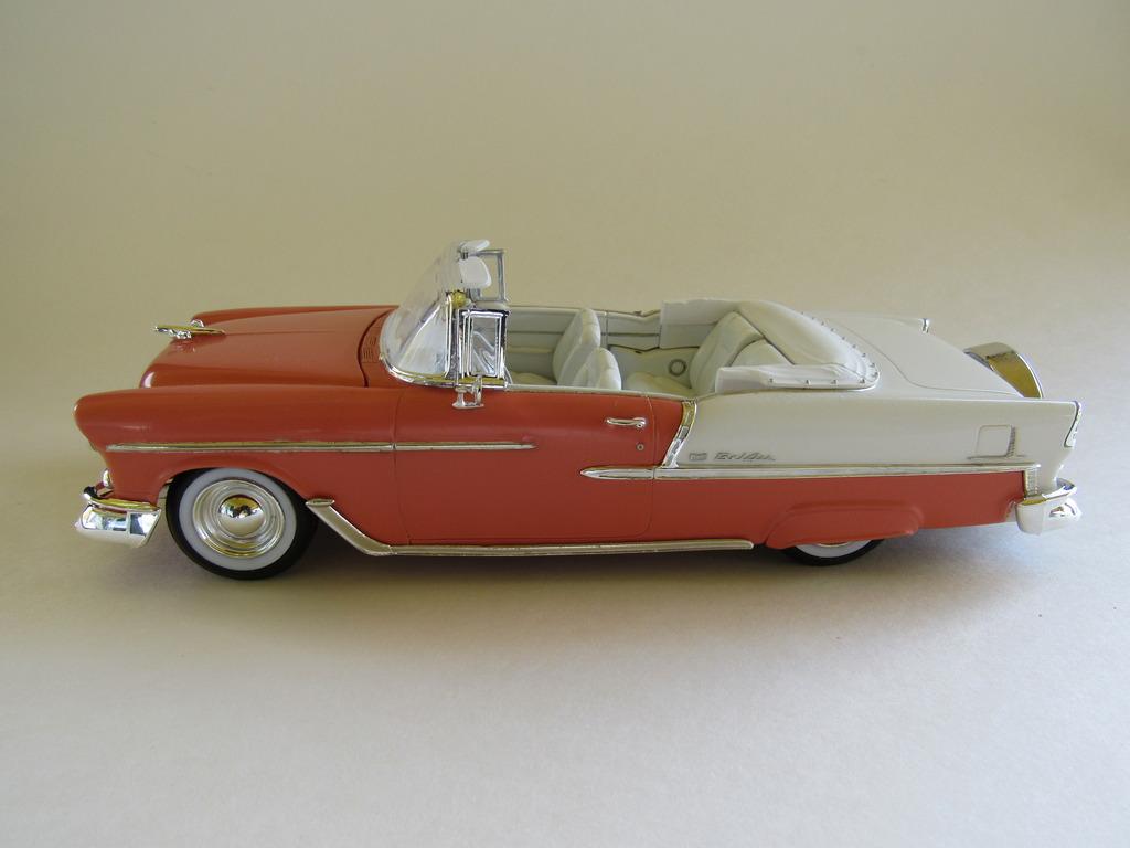

Perspect Scale Modelworks Posted December 9, 2016 Posted December 9, 2016 I put a drop of CA on a block of wood and used a fine brush to run a line down the center of the trim cavity on the body and then installed the trim. That way there were no globs of glue to ooze out.
