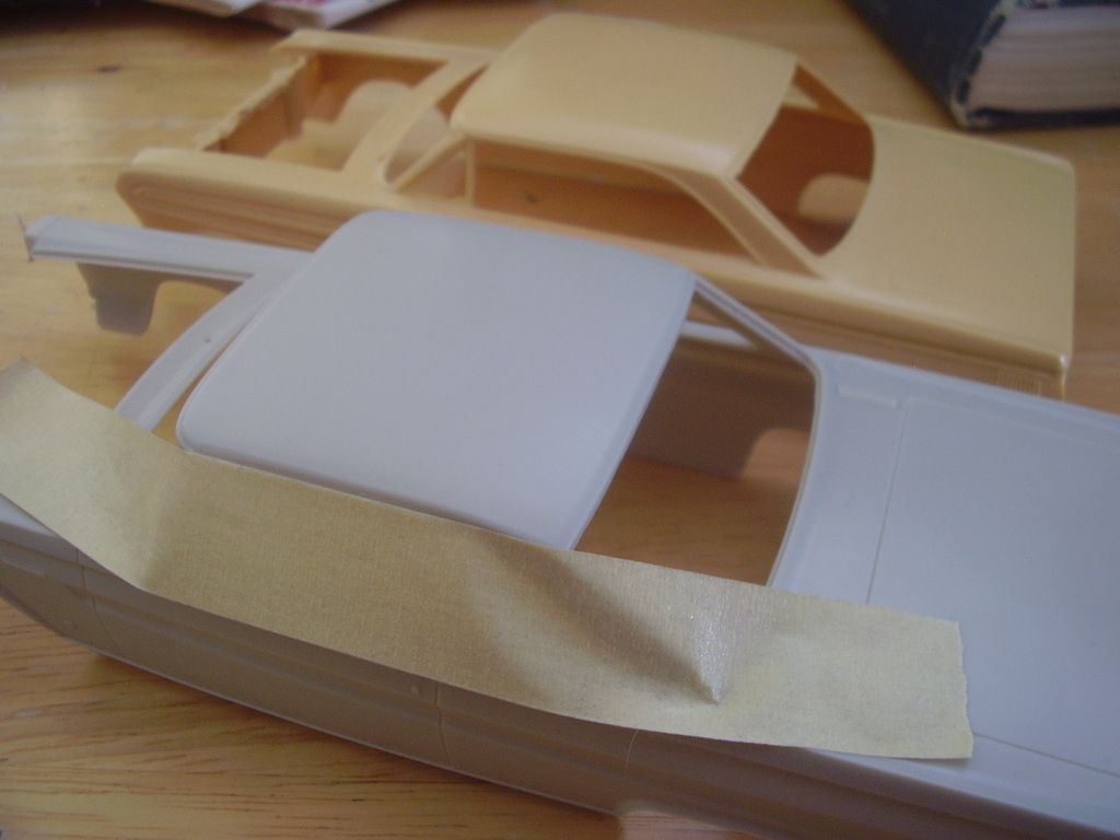

RancheroSteve Posted January 10, 2017 Author Posted January 10, 2017 A little more done. Now that I've got the roof to where I can live with it, I made a few other body modifications. This isn't going to be a replica stock build - more of a resto-mod I believe - so I'm at liberty to make a few changes. I've never cared for faux vents and the port holes on the Comet's fenders have always puzzled me a little (this isn't a Buick, right?), so off they went: Likewise, the fake vents behind the back window:
espo Posted January 10, 2017 Posted January 10, 2017 I have to agree with the cleaner look. Sometimes designers used to just put to much glitter on an otherwise good design.
afx Posted January 10, 2017 Posted January 10, 2017 I like the cleaner look as well Steve - good choice.
mk11 Posted January 10, 2017 Posted January 10, 2017 (edited) Sure looks good, Steve. On mine, I also shaved that inner ledge on the top of the rear window opening as it could be seen from outside. Just looking at another angle on the issue, note the light-catch along the roof ... ...notice the margin above the drip rail on the '64 Comet and Falcon... carefully blending the edge on the '65 into the roof crown, thereby dropping the margin and straightening the line, may make a noticeable improvement. mike Edited March 18, 2018 by mk11

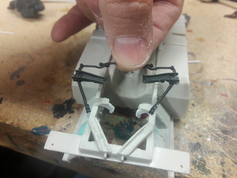

mk11 Posted February 3, 2017 Posted February 3, 2017 Great inspiration Steve. While Moebius did a fairly decent job of reworking the surface features of the adopted '66 comet chassis, they left the newer style tunnel (made for accommodating big blocks with C6 transmissions) alone. Like you say, it builds up just fine and few will notice the things a real Ford nut will want to tweak.Dave, the front subframe/suspension is a common design to all these cars based on the falcon platform and the amt '67 mustang chassis seems to have the best detailed parts. A builder can go either way and still have a good looking model with this kit. mike

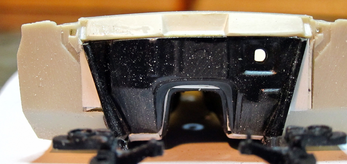

RancheroSteve Posted February 6, 2017 Author Posted February 6, 2017 I wanted to keep the original location and dimensions of the Comet firewall, so I glued the side and top sections of the firewall to the chassis, and then fit the Mustang firewall into the center. Plenty of gaps here & there, and the toe boards don't line up exactly, but some scrap plastic will fix all that. After these photos were taken, I applied a generous coat of Tamiya putty. More soon . . .

RancheroSteve Posted February 14, 2017 Author Posted February 14, 2017 Now that the Mustang inner fender aprons/shock towers are cut to the right length, I'm removing the molded in upper a-arms. The Moebius Comet has separate upper arms, so I'll be "bolting" those the shock towers in a more prototypical fashion. While work continues on the shock towers, I've decided on a power plant and closed in on the "theme" of this build. I'm going to be using the 5.0 small block with an AOD transmission from the Revell '32 five window kit, with the modern fuel injection and the finned valve covers. The oil pan comes from the Moebius kit, shortened a little to fit the Revell block. Here's a mock-up for fit: The block and trans have been painted bronze/gold; the heads painted silver (to represent aluminum) and holes drilled for plug wires.The headers from the '32 kit don't look like they'll work in the Comet, so I started scrounging through my un-built parts kits and found that the shorty factory headers from the Monogram '94 Mustang looked like they'd work. And who knew? The engine block and heads in the '32 Ford is the same casting as the Monogram '94 Mustang! Figures, I guess.
RancheroSteve Posted February 21, 2017 Author Posted February 21, 2017 I've been spending way too much time getting the Mustang inner fender panels and shock towers to fit the Comet, but I'm almost there. A little more fine tuning and I'll be ready to drop these in: Holes are for the upper a-arms. Top edges will get trimmed to match the Comet fenders.

RancheroSteve Posted May 13, 2017 Author Posted May 13, 2017 Making a little progress - I've finalized the engine bay: The shock tower brace is a combination of the Comet kit part and the Mustang, so my Comet uses Mustang upper shock mounts - a modification that actually works in the real world. Was it all worth it? Who knows, but fun trying. On to the next steps - hopefully more straightforward from here on.
